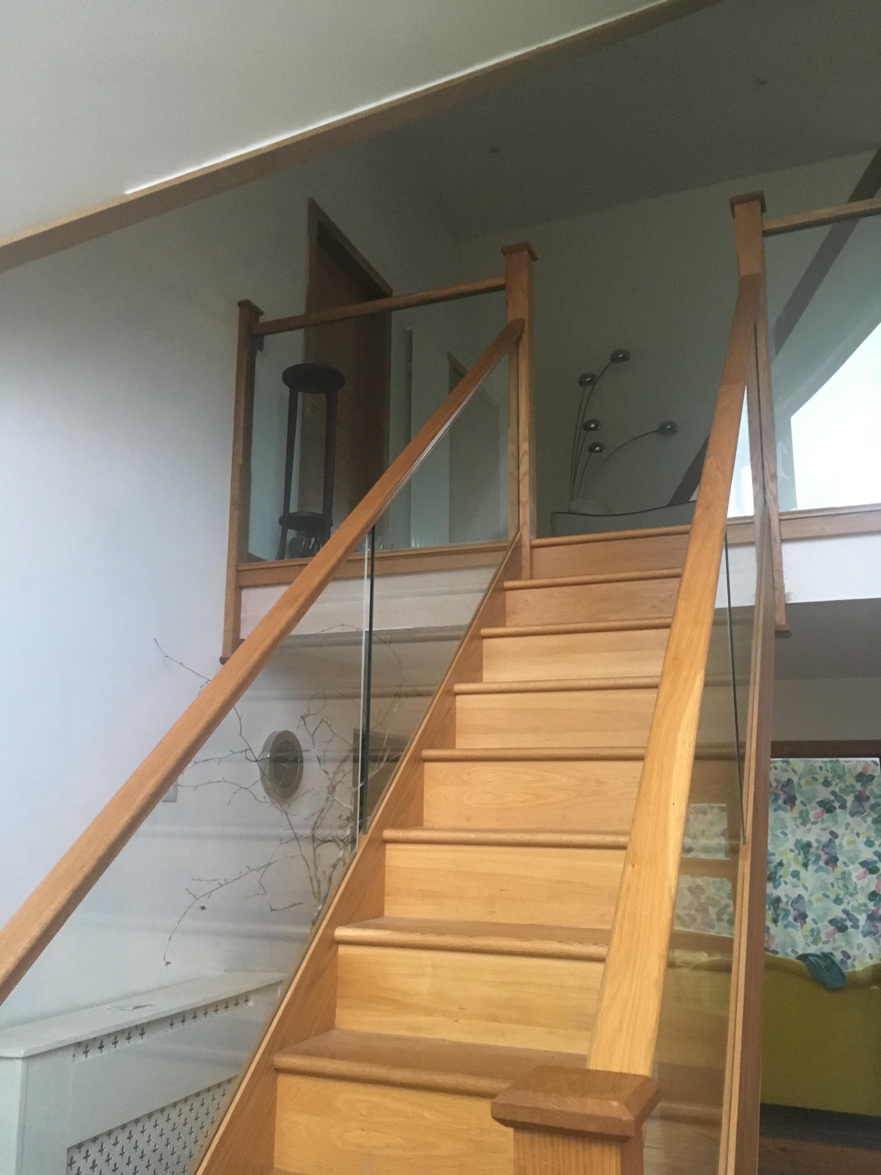

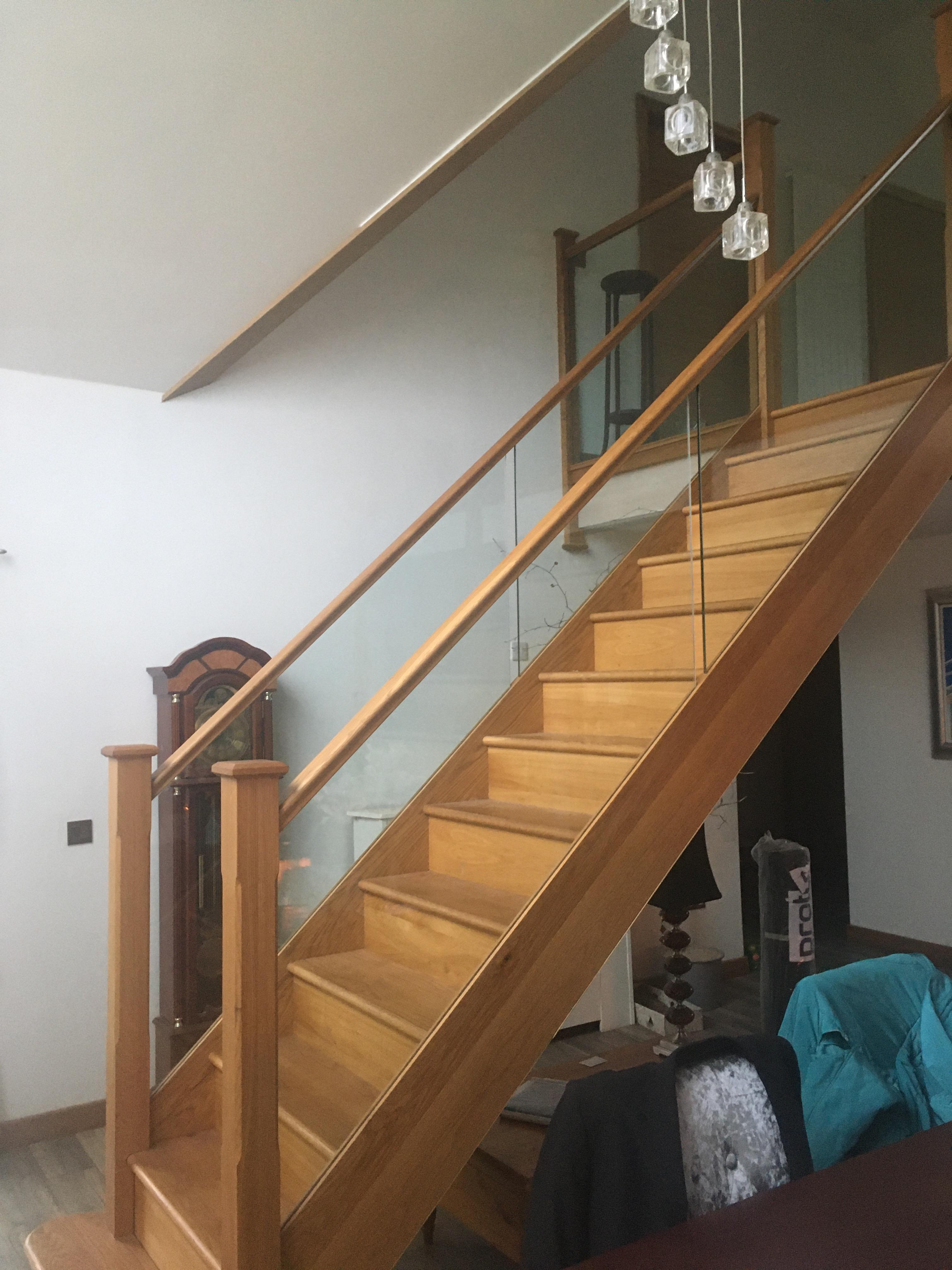

recoveringbuilder Posted February 20, 2020 Share Posted February 20, 2020 This is the elephant in the room as far as our new house goes and it is quite literally an elephant in the room. I’ve mentioned this before as some of you may remember but it’s one of these things that won’t go away and is really bugging me. So when we were building and came to the stage where we were getting measured up for the staircase ( which we had paid as part of the kit) the staircase company discovered that the staircase could not be situated where the architect had it on his drawings, not as a straight flight anyway. The architect became very nervous and paid several visits trying to work out something that would work and eventually came up with a design which would keep it starting against the wall then turning and ending up half way along the mezzanine so it would not encroach into the room . The staircase company did plans for this and all looked as if it would come to a satisfactory conclusion however once it was priced up they were looking for another £5.5k, now as I said at the start we had already paid for the staircase that should have been installed so I went to the architect and told him I expected him to foot the bill for the extra over however he was having none of it and said that if he’d designed the proper staircase to begin with we would have had to pay for it anyway but as I tried to tell him I probably wouldn’t have paid £11k for a staircase and would have gone for a cheaper option but now 7 months down the line with all the other oak doors and finishing all in situ it would look odd to put in a cheaper staircase. we were getting nowhere with him and quite frankly didn’t have a spare £5.5k so we got him to look at other options. Eventually he decided if we brought it out 1200mm from the wall we would get the desired headroom and he agreed to pay £1100 for the extra glass balustrade and oak handrail that would be required ( at this point I threatened him with legal action if he did not) I agreed to this as I was getting fed up waiting for the staircase and it seemed the only way to get it all sorted. so we’re now a year on from the staircase being installed, quite frankly it looks ridiculous and has reduced the usable space in the room by 2 metres and it’s really putting me off the whole house. the house isn’t signed off yet as our garage is on the same building warrant (another mess he’s made) and I’ve been looking for solutions to this. I had the engineer out to see it and he agreed it wasn’t right and suggested I get another architect to look for a solution. When the other architect came out he wasn’t happy with it either and he was of the opinion that it still didn’t meet building regulations and suggested I got the building control officer to come out and check it. I did this and got a rather whether or not chap who didn’t have a tape measure (!!) to check it, I offered to get him one but he mumbled something about it not being that simple and concluded that he would pass it as it stands. We needed to get a temporary habitation certificate and for this we needed an amendment to warrant in respect of the staircase and I contacted the original architect to do this which he did immediately without charge. we had decided that we would then wait until the garage is finished and all signed off then we would revisit the staircase problem however I had occasion to speak to the other architect the other day and he asked how I had gotten on with bco, when I relayed everything to him he said we would be silly to let it go and that we should ask for another visit from the head of bc and insist that he measured it. I’ve done this and await a visit from him next week, should he agree that it is not compliant we intend to go to litigation with the architect, I’m not looking forward to doing this but as I’ve been told he will have insurance to cover this I feel it’s the only way to go other than us having to fork out for another staircase, several visitors have remarked they wouldn’t buy this house with the staircase the way it is and I feel we haven’t got the house we’ve supposed to have. Any views on this please? Link to comment Share on other sites More sharing options...

recoveringbuilder Posted February 20, 2020 Author Share Posted February 20, 2020 He didn’t do sectional drawings to my knowledge anyway @ProDavealtough maybe he did and we just never saw them, it has been said that because he hand draws his plans this is why it happened, if he’d done cad drawings we believe it would have flagged up at the beginning that it was never going to work. I’m not being petty about this, the position of the staircase is horrible and when you walk into the room you only see the back of it which looks like a shute in a play park, at some point whether we win this or not we are going to have to change it, it’s also very steep 42.5degrees, so much so that I won’t allow the grandkids to go up there.The ideal outcome would be to install the one he designed (along with the staircase company) that had the turn in it, I just feel that it would be a bit rash of us to fork out all this money without trying to get him to take responsibility for his expensive mistake. There’s no way that the original position could ever be achieved and I just wonder if he really didn’t understand how his roof design was going to be built and the angles that would be there thus interfering with the headroom 1 Link to comment Share on other sites More sharing options...

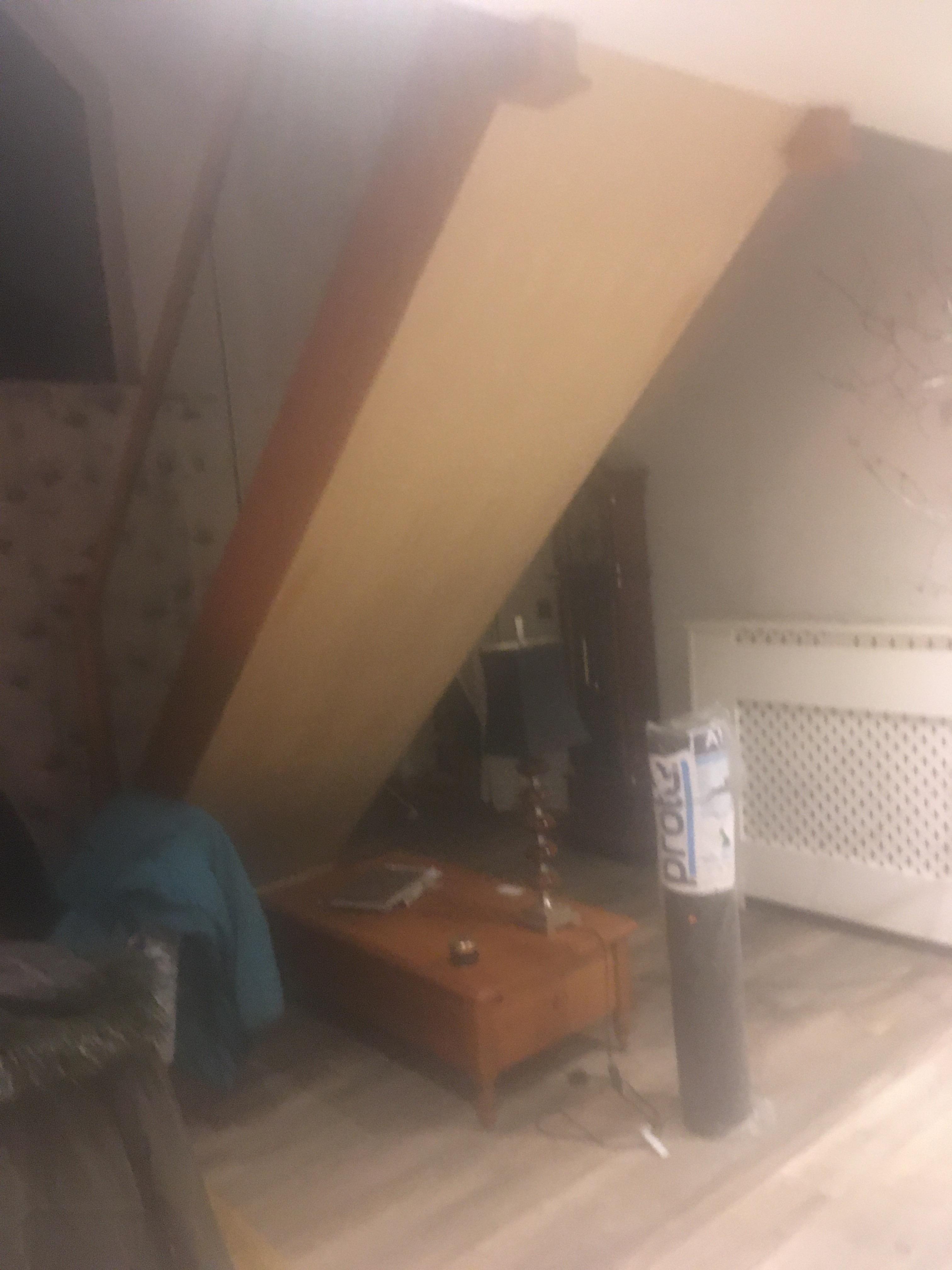

recoveringbuilder Posted February 20, 2020 Author Share Posted February 20, 2020 It has no turn at all , just straight up, it should have been next to the wall and had a cupboard under it for the ufh manifold but as it is we’ve had to cover the manifold with a radiator cabinet, I don’t know what he thought about the ceiling, it’s cathedral but has a lot of angles going on and therein lies the problem, the picture I put on is what you are faced with when you walk into the room , which is meant to be a dining room, we have the pellet stove on a feature wall and the space from this to the staircase being reduced by around 2 metres now means when you sit at the dining table you either can’t get your chair back very much at the stair side and at the other side if the stove is on your getting roasted ! Link to comment Share on other sites More sharing options...

Stewpot Posted February 21, 2020 Share Posted February 21, 2020 That is, well... it's a bit of a shocker, isn't it? To be fair I can't see the whole of the room, to see its full effect, but it's hardly a decorative centrepiece. Is it possible to post the floor plans of the two floors, so that we can see it in context? Stairs can be a bugger, because you need to visualise them in 3D. What works well on one floor might not on the next. I'm guessing that you have a sloping ceiling on the first floor, which restricts headroom and prevents you from putting the stairs in the position you first wanted. But ProDave is right to ask what you want the outcome to be - that should be the first question you ask before any litigation. If you want the original option, well, it seems that that is impossible, so no amount of suing will get you that. Often, the outcome of any legal action, is that both parties end up being disappointed. Which is not to say that you don't merit some form of compensation. I'm no fan of spiral staircases, but could that be a solution? Because you are effectively dealing with a cylinder, you have some control over which way the top and bottom treads are facing, which may help. And it'd be prettier than what you've got. Or have you thought of asking the second architect (or some other architect) if he could find an alternative solution? Sometimes creative types can see a way round problems that us normal people though was impossible. Link to comment Share on other sites More sharing options...
Onoff Posted February 21, 2020 Share Posted February 21, 2020 Wtf? Fugly and impractical! Surely it should have started against that wall with the window then turned 90 deg? Looks a steeper angle than regs allow? Link to comment Share on other sites More sharing options...

Onoff Posted February 21, 2020 Share Posted February 21, 2020 @Christine Walker have you actually done a simple triangle to know it's 42.5deg? Must be the camera angle but looks steeper. 1 Link to comment Share on other sites More sharing options...
ProDave Posted February 21, 2020 Share Posted February 21, 2020 Can we see a picture looking up the stairs so we see the roof structure that is causing the problem? Link to comment Share on other sites More sharing options...
Big Jimbo Posted February 21, 2020 Share Posted February 21, 2020 I would rather have 3 turns, or whatever it takes, than look at the back of that. Perhaps if you were to paint the underside in white, or to match the wall colour, it would help to make it less in your face. Link to comment Share on other sites More sharing options...
recoveringbuilder Posted February 21, 2020 Author Share Posted February 21, 2020 I have checked the register as suggested and he is still registered, pictures attached, second architect suggested spiral which I definitely don’t want as I’ve a friend with one which causes problems for getting furniture up and down. Looking back on communication with the staircase firm it seems it is 41.92degrees but it looks and feels much steeper Link to comment Share on other sites More sharing options...
ProDave Posted February 21, 2020 Share Posted February 21, 2020 So, if you pushed the stairs over to be against the wall where the grandfather clock is, how much headroom would you have? i.e. how far short of meeting regs would it be? Link to comment Share on other sites More sharing options...

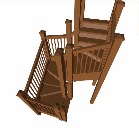

PeterW Posted February 21, 2020 Share Posted February 21, 2020 Something like this would give you more open space I’ve just lashed it together on Pears Stairs btw so don’t get too critical ..!! 1 Link to comment Share on other sites More sharing options...
