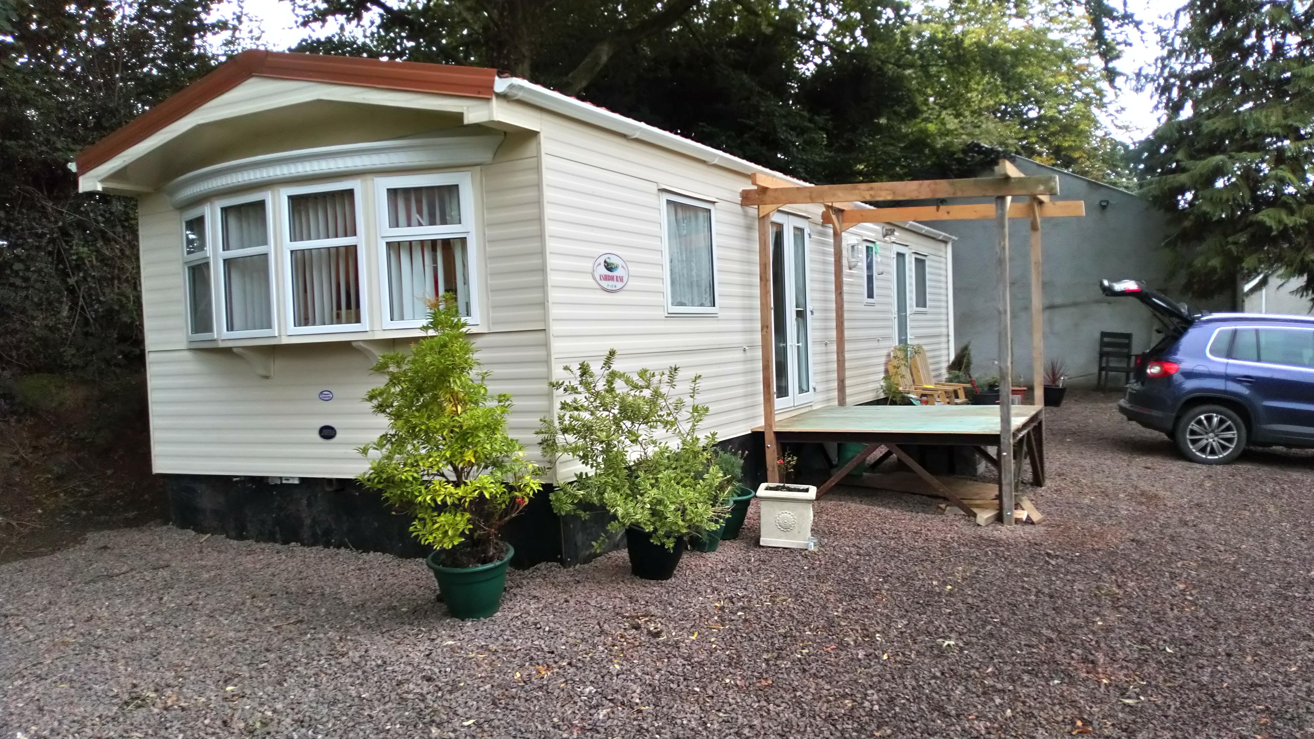

StevieD Posted February 17, 2020 Share Posted February 17, 2020 Hi, I have been living in a static caravan adjacent to our plot for the past few months. I have a wife and two girls and we have been managing fine for the past few months. There are a few tips I would share. Cite your caravan in a sheltered area from the wind and rain, fortunately we have a large outbuilding to our south side, an embankment to the east and trees to the north and west. We have heard but not felt the past two storms. Additional insulation where possible, I added 2 inch foiled insulation board to the underside of the static home (keep vent paths clear) and added a thick skirting to the caravan. This stops the winter draft sapping the heat from the under side of the caravan. We also put rubber matting over the tin roof above the sleeping quarters. Rain and hail amplify off the tin roof! My wife is a light sleeper and found this beneficial. Space is obviously a premium. Take in things you essentially need. We downsized significantly, including clothes. Use as you need, try and keep it down to 1-3 pairs of everything each (cept skivvies, need several). If you can, add a sizable sheltered porch area, we have a 2m2 one but could have don'e with a bigger one. We have a retractable washing line, cat box and seats out in it. Very handy. Static homes can have a few draughty spots, esp with built in furniture. Find and insulate as you see them. Because they are draughty, you may get moisture build up inside. A 2kw plug in de-humidifier will be essential. it will keep furniture, clothes, carpet dry. Keeps the RH of your caravan down, which if you are staying for a long period is essential - I wood burner will help do this too. Thankfully we can wash and dry clothes nearby which saves a lot of set up. If you can, you could use an ex-site office iso container - it will have connections for light, heat, water and foul waste. a used 20ft one can cost 2-3k. We have two children in one small room - it used to have those skinny single beds and room for not much else. We took those out and put in small bunk beds, slots in nicely and left more room for ikea storage furniture for toys/clothes. If I remember any more il post them. Good luck, it definitely is an experience - always remember its only temporary and its for a greater goal. Don't let cabin fever set in! 6 Link to comment Share on other sites More sharing options...

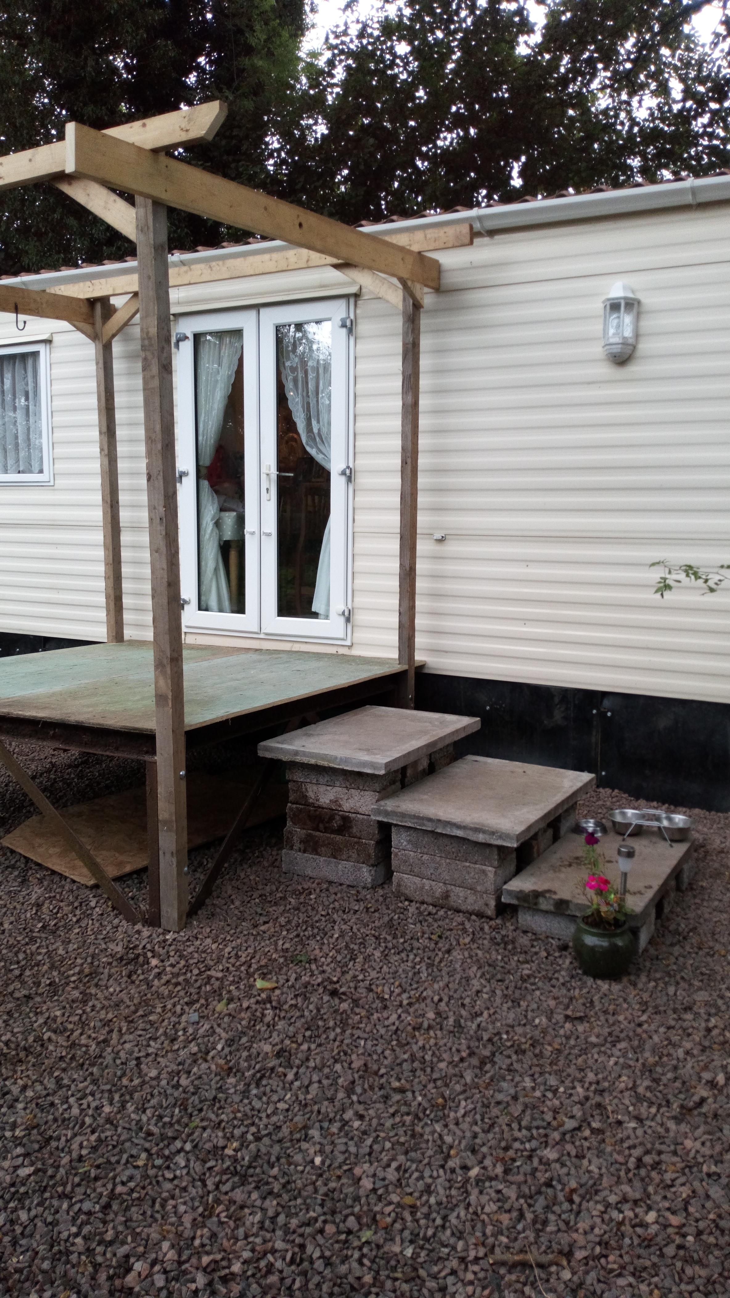

Gem77 Posted February 19, 2020 Author Share Posted February 19, 2020 On 17/02/2020 at 15:26, StevieD said: Hi, I have been living in a static caravan adjacent to our plot for the past few months. I have a wife and two girls and we have been managing fine for the past few months. There are a few tips I would share. Cite your caravan in a sheltered area from the wind and rain, fortunately we have a large outbuilding to our south side, an embankment to the east and trees to the north and west. We have heard but not felt the past two storms. Additional insulation where possible, I added 2 inch foiled insulation board to the underside of the static home (keep vent paths clear) and added a thick skirting to the caravan. This stops the winter draft sapping the heat from the under side of the caravan. We also put rubber matting over the tin roof above the sleeping quarters. Rain and hail amplify off the tin roof! My wife is a light sleeper and found this beneficial. Space is obviously a premium. Take in things you essentially need. We downsized significantly, including clothes. Use as you need, try and keep it down to 1-3 pairs of everything each (cept skivvies, need several). If you can, add a sizable sheltered porch area, we have a 2m2 one but could have don'e with a bigger one. We have a retractable washing line, cat box and seats out in it. Very handy. Static homes can have a few draughty spots, esp with built in furniture. Find and insulate as you see them. Because they are draughty, you may get moisture build up inside. A 2kw plug in de-humidifier will be essential. it will keep furniture, clothes, carpet dry. Keeps the RH of your caravan down, which if you are staying for a long period is essential - I wood burner will help do this too. Thankfully we can wash and dry clothes nearby which saves a lot of set up. If you can, you could use an ex-site office iso container - it will have connections for light, heat, water and foul waste. a used 20ft one can cost 2-3k. We have two children in one small room - it used to have those skinny single beds and room for not much else. We took those out and put in small bunk beds, slots in nicely and left more room for ikea storage furniture for toys/clothes. If I remember any more il post them. Good luck, it definitely is an experience - always remember its only temporary and its for a greater goal. Don't let cabin fever set in! Thanks so much for this - I am loving the bunk bed option and the rubber matting as I am too a light sleeper! Good luck for the rest of your build. Would you mind letting me know what you used for the porch area? Is it simply an awning? Link to comment Share on other sites More sharing options...

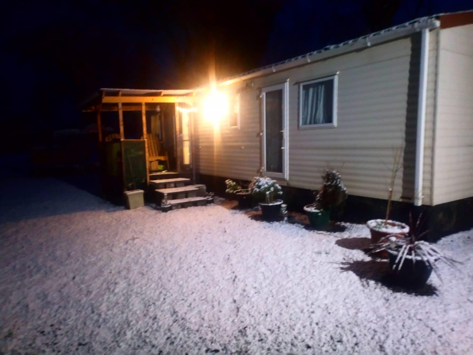

StevieD Posted February 19, 2020 Share Posted February 19, 2020 57 minutes ago, Gem77 said: Would you mind letting me know what you used for the porch area? Is it simply an awning? Hi, See photos below. For the porch, I reused a vat tank base as our porch base (a timber frame base would work just as well), then bolted on 3''x3'' timbers for uprights and various timber for the rest. Only thing I had to buy was the clear corrugated sheets for the roof. Later I added handrails, rubber matting (anti slip)and some green hedge mesh for a wind/rain breaker. I couldn't do without it, I just wish I had made it bigger. I could but id rather invest my time now on the build! You can see the rubber skirting too, I added a timber frame underneath and fixed the rubber skirting to it. (It was reclaimed unused conveyor belt stock). For the bunkbeds, we sourced ours from Wayfair online as they suited the dimensions we needed - as it was bespoke we needed two new mattresses too. They are suitable for children under ten but definitely not teenagers! They are light wooden frame so it doesn't but too much loading on the floor. We have a buy back option from our cabin supplier at roughly 20% under of what we paid for it (depending on condition of course), given we will be residing in it between 18-24months, the cost saved from renting is invaluable. I cant stress siting your cabin in a sheltered area enough (unless you like getting rocked to sleep in the storms). Also, look at water run off paths and shoring - this will help prevent your cabin/paths/driveway from flooding, rutting and keep it fairly dry and firm during wet periods. Hope this helps. 1 Link to comment Share on other sites More sharing options...
epsilonGreedy Posted February 19, 2020 Share Posted February 19, 2020 43 minutes ago, StevieD said: Hi, See photos below. Another self builder with potted plants on site well ahead of a finished house. Swmbo keeps asking me to move the ugly building stuff out of the way because it spoils her plant pot display. I concur with the issue of shelter though in my case my skirting is structural and this made the caravan feel much more stable in high winds. Yes heavy rain on the roof is a problem, sometime we have to crank up the TV volume up to deal with the noise. Link to comment Share on other sites More sharing options...
