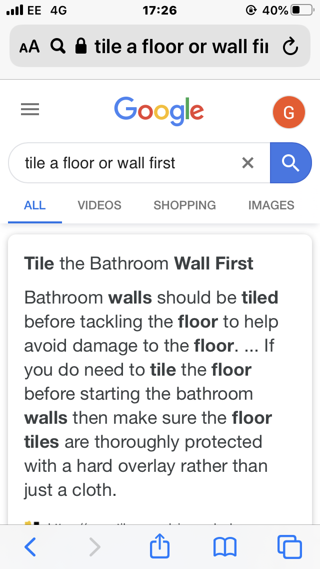

nod Posted February 9, 2020 Author Share Posted February 9, 2020 Even good old google will tell you floor last main reason being If anything moves it will be the floor and damage to the floor while doing the wall Think I’ve said before If I started a tiler and he tiled the floor first he would get chance to tile the walls Link to comment Share on other sites More sharing options...

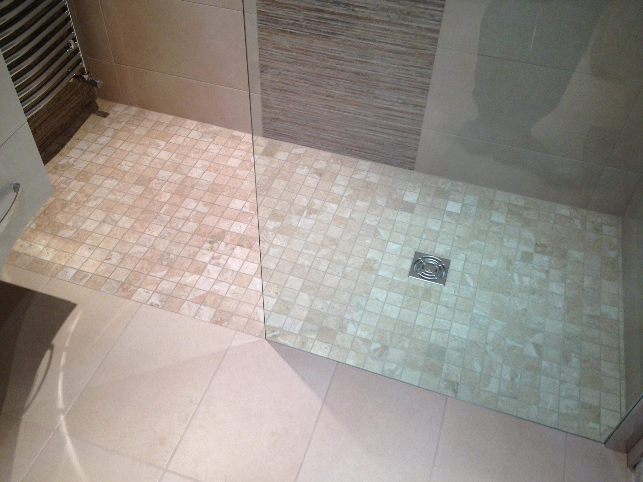

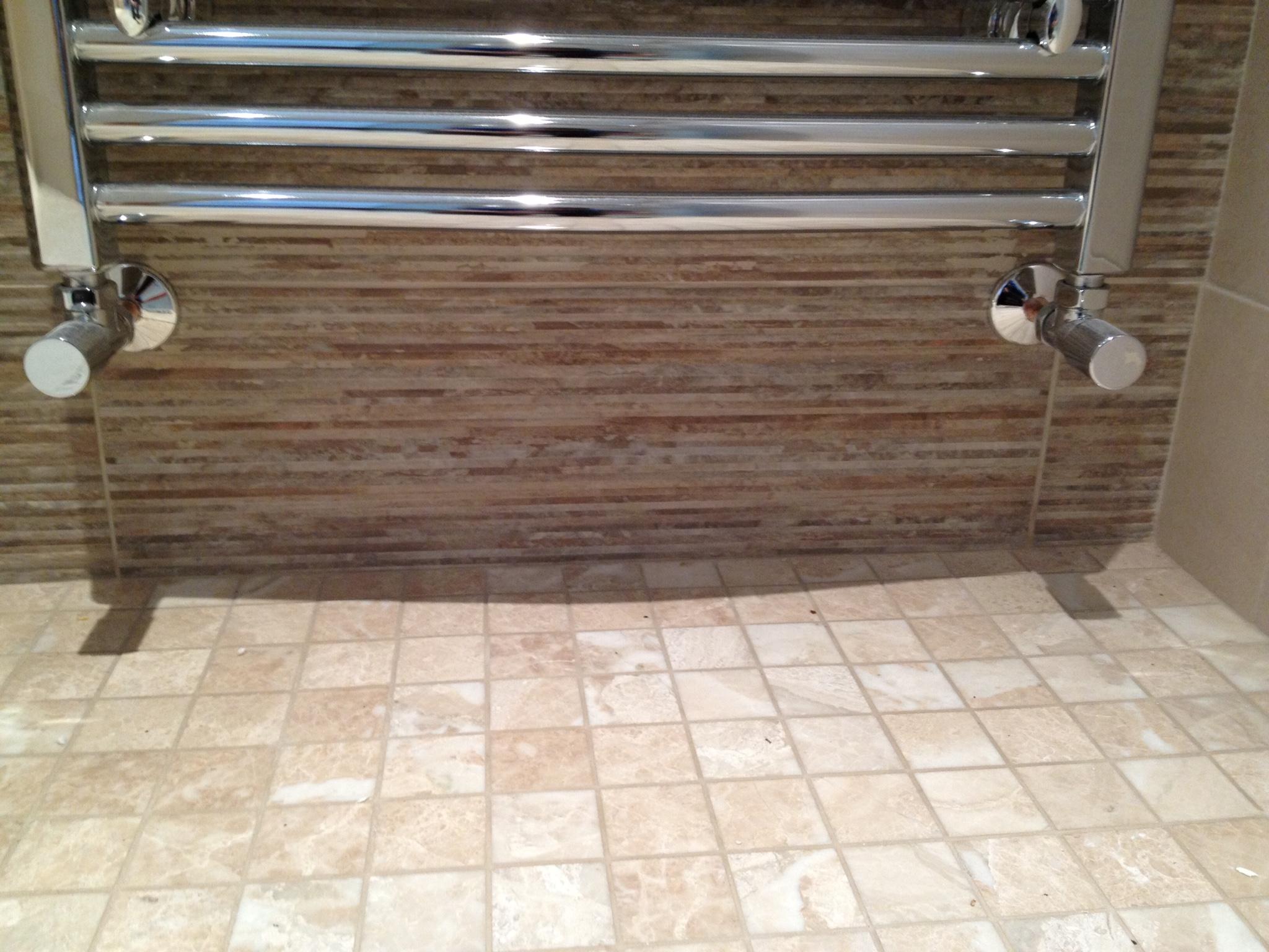

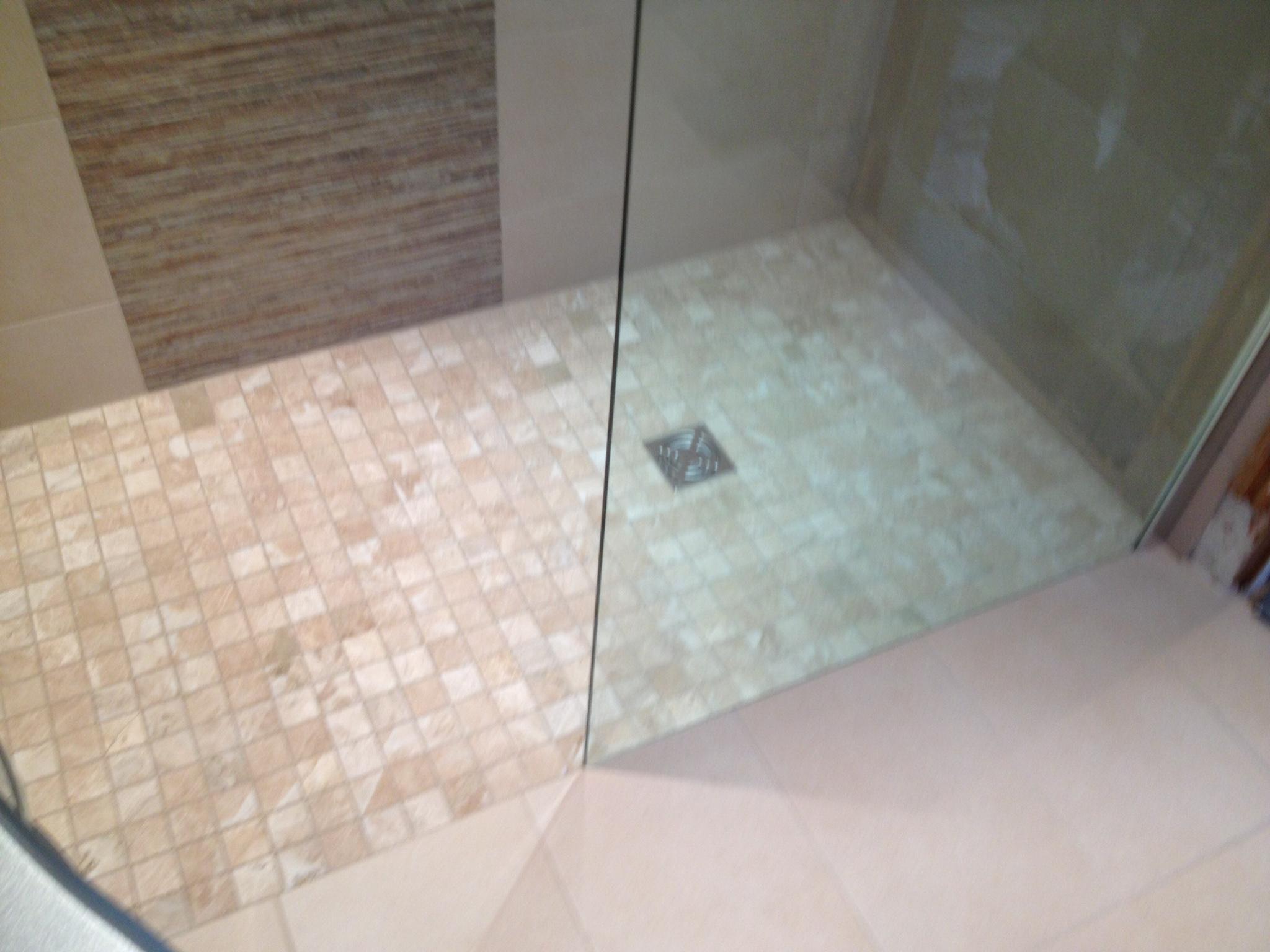

Nickfromwales Posted February 9, 2020 Share Posted February 9, 2020 2 minutes ago, nod said: DIY ? B&Q is my co-pilot. Link to comment Share on other sites More sharing options...
Nickfromwales Posted February 9, 2020 Share Posted February 9, 2020 Link to comment Share on other sites More sharing options...
Nickfromwales Posted February 9, 2020 Share Posted February 9, 2020 Floor first baby. ? 1 Link to comment Share on other sites More sharing options...

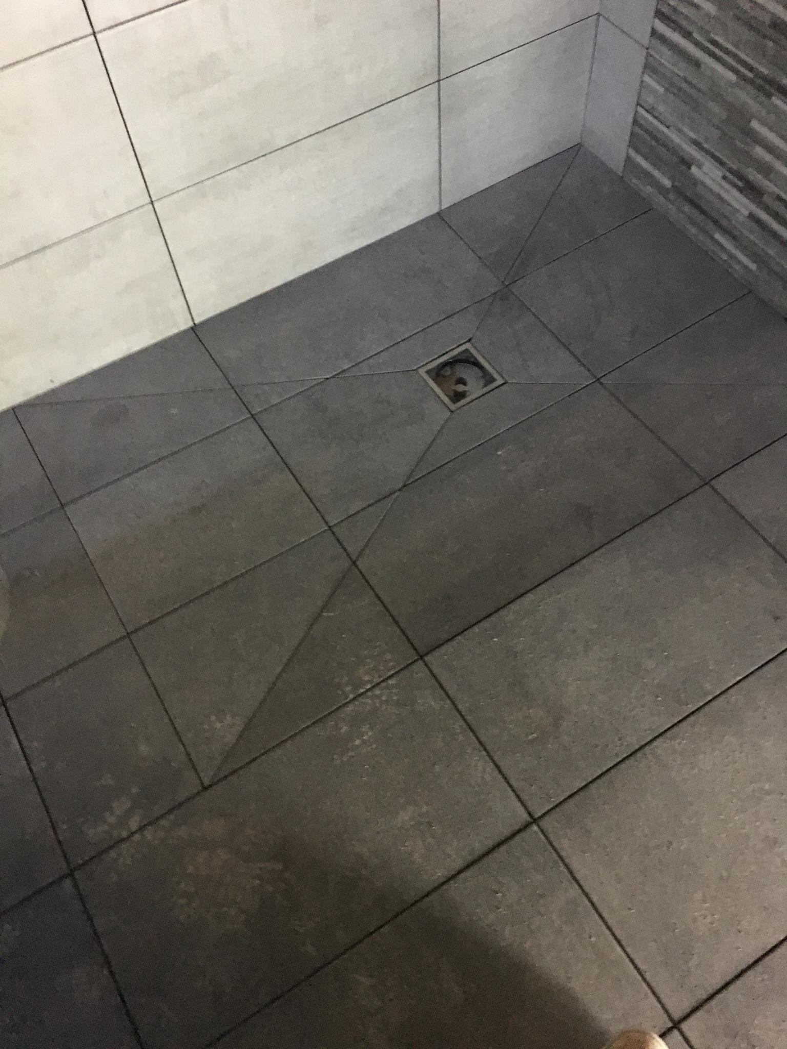

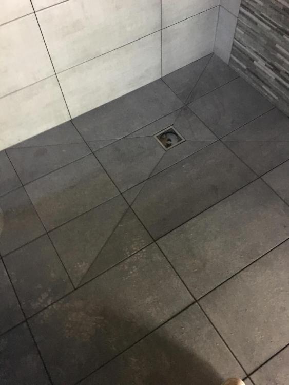

Pete Posted February 9, 2020 Share Posted February 9, 2020 (edited) Not wanting to take sides but if using one of these trays then they recommend you do the walls first to get the right position of the tile in relation to the linear drain, just saying!! Edited February 9, 2020 by Pete wrong link Link to comment Share on other sites More sharing options...

Nickfromwales Posted February 9, 2020 Share Posted February 9, 2020 3 hours ago, Pete said: Not wanting to take sides but if using one of these trays then they recommend you do the walls first to get the right position of the tile in relation to the linear drain, just saying!! That’s what tape measures are for ? You don’t plonk a house down and draw around it for the foundations Link to comment Share on other sites More sharing options...
