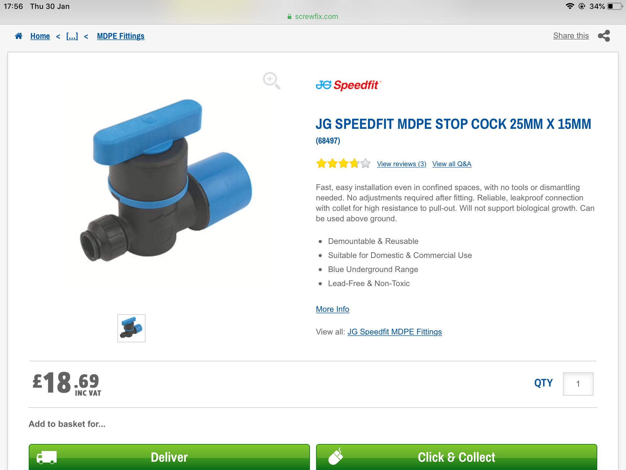

ToughButterCup Posted January 30, 2020 Share Posted January 30, 2020 Connect 25mm MDPE with (say) 15mm HEP2o eh? Answer me that oh Internet Sages (all) An hour's digging unearthed this from Mr Wavin (not drowning) Quote I would like to joint my Cold Water Blue MDPE Pipe with 15mm Hep2O barrier pipe for an outside tap. Is it okay to use? Hep2O is for internal use, however if it is used externally it will need to be protected from frost and UV light. Please note we do not have a connection between 15mm Hep2O and 20mm or 25mm MDPE. https://blog.wavin.co.uk/push-fit-hep2o-your-plumbing-faqs-answered/ accessed today. Oh yes Mr Wavin you do . You do a Stop Tap 25mm MDPE to HEP Give me one good reason (one that passes the joint @SteamyTea, @Temp, @Jeremy Harris, @Ed Davies, @ProDave test) why they don't do that. Oooooh, I got cross, so I rang their Help line (on the 01 number not the PayThroughTheNoseNumber) Tech support: "We dont do it, because we don't do it" + burble about using it outside Muggins: "Do you assume that Plumbers would be stupid enough to use it outside then?" Tech support: tied himself in knots. Muggins: So what's to stop a Plumber fitting the 25MDPE to HEP Stop Tap outside then, eh? Tech support: tied himself in double knots. Plumbers cannot be held by Wavin in sufficient contempt to assume that they would use HEP outside ---- would they ---- would they? Mmmmm. Thats a head scratcher innit? So, it's Tee off into copper and then onwards and upwards in HEP then? Link to comment Share on other sites More sharing options...

Russell griffiths Posted January 30, 2020 Share Posted January 30, 2020 Is this what you mean. Link to comment Share on other sites More sharing options...
pilgrim Posted September 19, 2022 Share Posted September 19, 2022 I am trying to solve this same problem at the moment. Is there a better solution for this now? Does fitting the Hep2o pipe in this JG stop cock work? Thanks Link to comment Share on other sites More sharing options...

Nickfromwales Posted September 20, 2022 Share Posted September 20, 2022 (edited) 2 hours ago, pilgrim said: Ok thank you, so best to use a section of copper to link the MDPE to the Hep2o, Sorry I didnt say this is inside the house, I've got the 25mm MDPE coming inside from the water meter. no external plumbing for me yet! If it’s internal, then it’s ok to use pushfit immediately from that fitting. However, you cannot ( should not ) put JG into Hep2o and vice versa. So, use a bit of copper as you say, and a Hep2o straight connector and then onto Hep2o pipe to be 100% kosher. Edited September 20, 2022 by Nickfromwales 2 Link to comment Share on other sites More sharing options...
