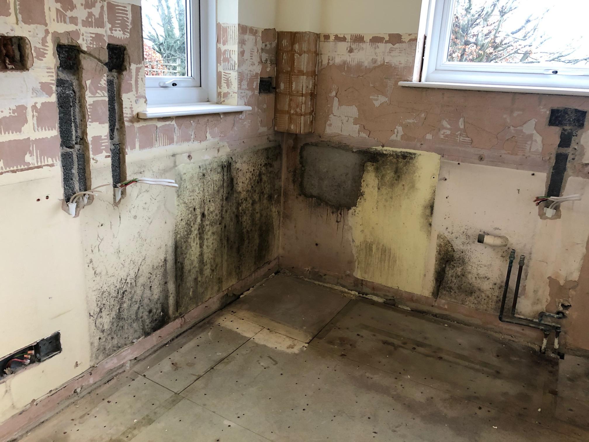

Barney12 Posted January 27, 2020 Share Posted January 27, 2020 Oh bother....damp is sooo annoying. Just taken out the utility room in the bungalow I’m currently working on to find that behind the units the walls are damp. I had a suspicion they might have had previous issues as there was celotex tucked into the back of the units. 1980’s build, cavity wall (filled with insulation from early 90’s). My guess is that it’s simply being caused by condensation but I’m not entirely certain. Perhaps the previous owners were a little mean with the heating? Units going back in the same positions so now I’m trying to decide on the best course of action? Any wise thoughts? Link to comment Share on other sites More sharing options...
nod Posted January 27, 2020 Share Posted January 27, 2020 I would just bleach them Then give them a coat of oil based undercoat It does look like condensation Link to comment Share on other sites More sharing options...
Onoff Posted January 27, 2020 Share Posted January 27, 2020 Could it be the cavity wall insulation causing the issue? Is the outside wall finish good/intact? No render up over the dpc then damp bridging the insulation? Bleach it all as above. Maybe fit some vents to thd new plinths to get some increased ventilation round the back? Link to comment Share on other sites More sharing options...
ProDave Posted January 27, 2020 Share Posted January 27, 2020 I would say typical of a 1980's build low insulation house. A kitchen is always going to be a damp room and with poor air circulation behind the units it is always going to be cold there and condensation will form and mould will grow. The fact there is no sign of that above the units where air can circulate and the walls will be warmed much better suggests it is not a serious problem. If you are going to internally insulate the walls to stop the problem you need to ensure the insulation is sealed to the walls so moisture cannot get behind. Some loose insulation poked down the back of a kitchen unit before the worktop goes on won't do much. Link to comment Share on other sites More sharing options...
Barney12 Posted January 27, 2020 Author Share Posted January 27, 2020 26 minutes ago, Onoff said: Could it be the cavity wall insulation causing the issue? Is the outside wall finish good/intact? No render up over the dpc then damp bridging the insulation? Bleach it all as above. Maybe fit some vents to thd new plinths to get some increased ventilation round the back? Outside render is all good and dpc appears intact. Suspended floor too and wall vents are unblocked. vents is a good idea. Link to comment Share on other sites More sharing options...
Barney12 Posted January 27, 2020 Author Share Posted January 27, 2020 47 minutes ago, nod said: I would just bleach them Then give them a coat of oil based undercoat It does look like condensation Ta. That mirrors my thoughts. Link to comment Share on other sites More sharing options...
Barney12 Posted January 27, 2020 Author Share Posted January 27, 2020 1 minute ago, ProDave said: I would say typical of a 1980's build low insulation house. A kitchen is always going to be a damp room and with poor air circulation behind the units it is always going to be cold there and condensation will form and mould will grow. The fact there is no sign of that above the units where air can circulate and the walls will be warmed much better suggests it is not a serious problem. If you are going to internally insulate the walls to stop the problem you need to ensure the insulation is sealed to the walls so moisture cannot get behind. Some loose insulation poked down the back of a kitchen unit before the worktop goes on won't do much. Good advice. The thin celotex was just shoved behind so not even in contact with the wall. There’s another cold/condensation point at the other end of the house in one of the bedrooms. I wonder how badly the cavity wall insulation has been pumped in.? Link to comment Share on other sites More sharing options...
gravelld Posted January 27, 2020 Share Posted January 27, 2020 Are you sure the wall is filled at that point? Link to comment Share on other sites More sharing options...
Barney12 Posted January 27, 2020 Author Share Posted January 27, 2020 1 minute ago, gravelld said: Are you sure the wall is filled at that point? It’s a good question. I guess I could drill out a core lower down and see what it revels? Link to comment Share on other sites More sharing options...
Declan52 Posted January 27, 2020 Share Posted January 27, 2020 I had similar issues in my last house when I removed the old kitchen. It was a 1960s high tech example of housing that had the cavity pumped with beads 20 years on. Over the years these beads moved and left gaps resulting in cold spots. My fix was to bleach and clean the inside to sort these issues. On the outside I put a tumble dryer vent to try to get the wall to dry out. If it is cold spots in the cavity there ain't really a cheap fix. Your only option is to try to get rid of the damp air by better ventilation. Link to comment Share on other sites More sharing options...
Ed Davies Posted January 27, 2020 Share Posted January 27, 2020 2 hours ago, Barney12 said: The thin celotex was just shoved behind so not even in contact with the wall. I'd think that was at least part of the problem - making the wall colder but not keeping the water vapour away from it. Link to comment Share on other sites More sharing options...
Miek Posted January 28, 2020 Share Posted January 28, 2020 10 hours ago, Barney12 said: It’s a good question. I guess I could drill out a core lower down and see what it revels? You could possibly (if you have one) look at the house from outside with a thermal camera while the heating is on inside. But you would expect insulation gaps at the top of walls or under cills not at the bottom of the wall. Link to comment Share on other sites More sharing options...
tonyshouse Posted January 28, 2020 Share Posted January 28, 2020 It looks to me like condensation, the corner has become colder than the other walls in the room so moisture is “pumped” there driven by pvp and can’t evaporate again as there is no air movement Link to comment Share on other sites More sharing options...
