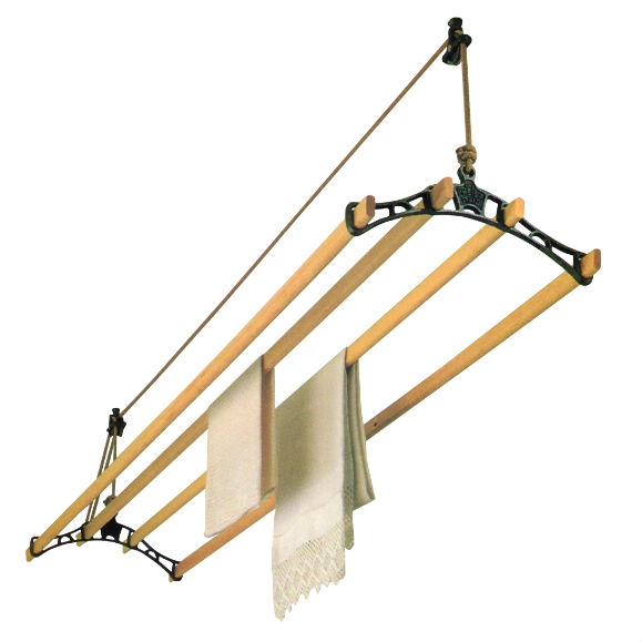

Russdl Posted November 6, 2016 Posted November 6, 2016 (edited) Joe, I'm guessing not (re lazy Susan) because I think that's one of those spinny round things that you put your condiments on. I'm going for one of these, rescued from the bungalow we will (hopefully) be demolishing soon. I reckon this, and maybe a little fan heater should do the trick. As ever, waiting to be corrected. Russ. Edited November 6, 2016 by Russdl Because I can't even up load images, how am I ever going to build a house! 1
ProDave Posted November 6, 2016 Posted November 6, 2016 That's what we have and it works very well. contrary to what everyone says, in a moderately well insulated house, it does not cause condensation and mould. 1
Stones Posted November 6, 2016 Posted November 6, 2016 We used one of these airers in our last house and very effective it was to. Our new utility room has an area of vaulted ceiling specifically so we can put two airers up out of the way (above 2.4m high). The utility room extract has been strategically positioned in this area as well.
Ferdinand Posted November 6, 2016 Posted November 6, 2016 (edited) 2 hours ago, joe90 said: I have told my swmbo that we are NOT having a tumble drier in our new air tight build but a " lazy Susan" ( is that correct) in the conservatory. Many on here and other forums talk about how MVHR units dry washing very effectively. Yes - Lazy Susan is a turntable for the table. The pulley is called a Lyons Maid ;-o ! Ferdinand Edited November 6, 2016 by Ferdinand
Barney12 Posted November 6, 2016 Posted November 6, 2016 13 minutes ago, Ferdinand said: Yes - Lazy Susan is a turntable for the table. The pulley is called a Lyons Maid ;-o ! Ferdinand LMAO. NO that's an icecream!! Try Kitchen Maid 1
