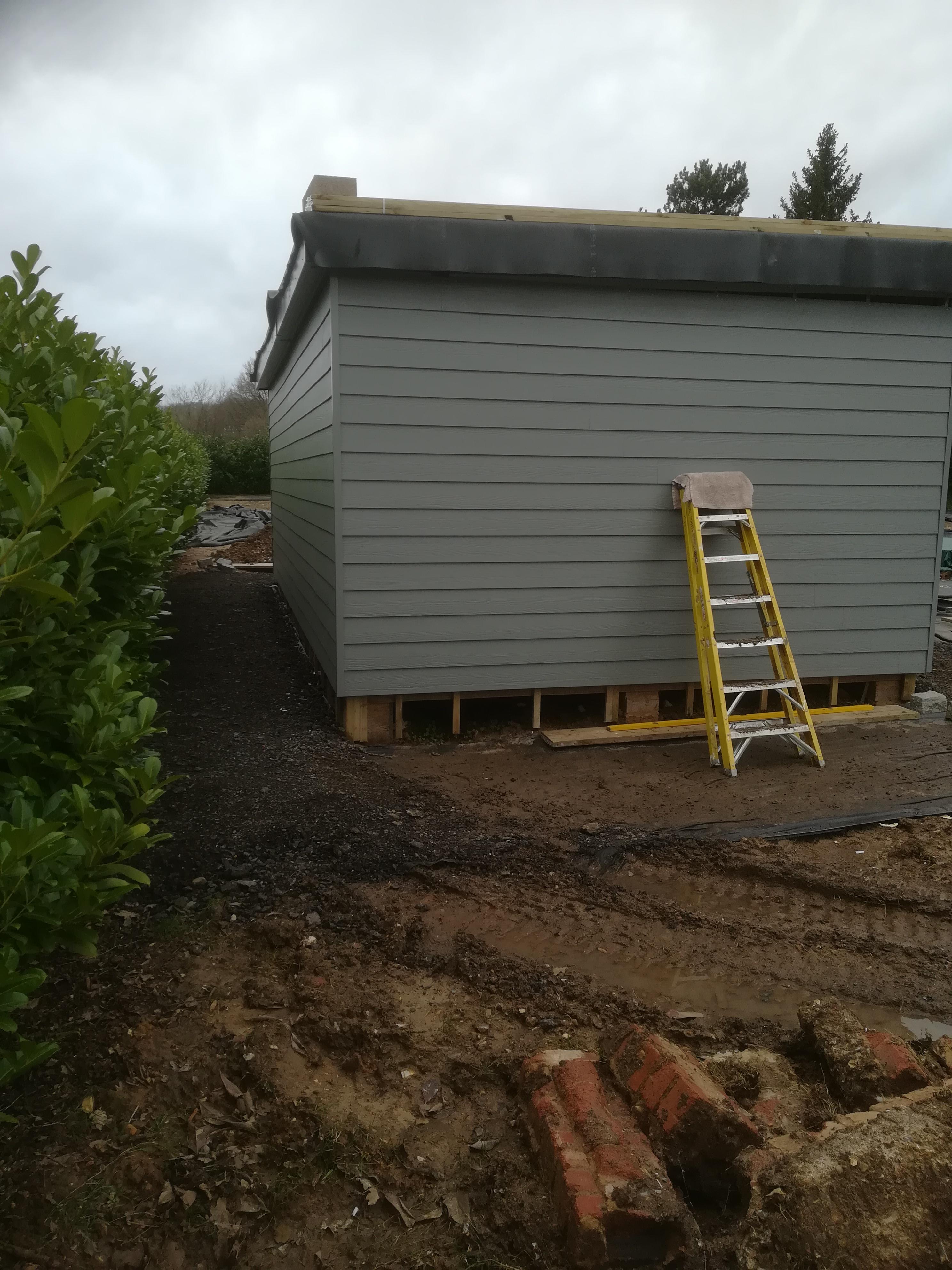

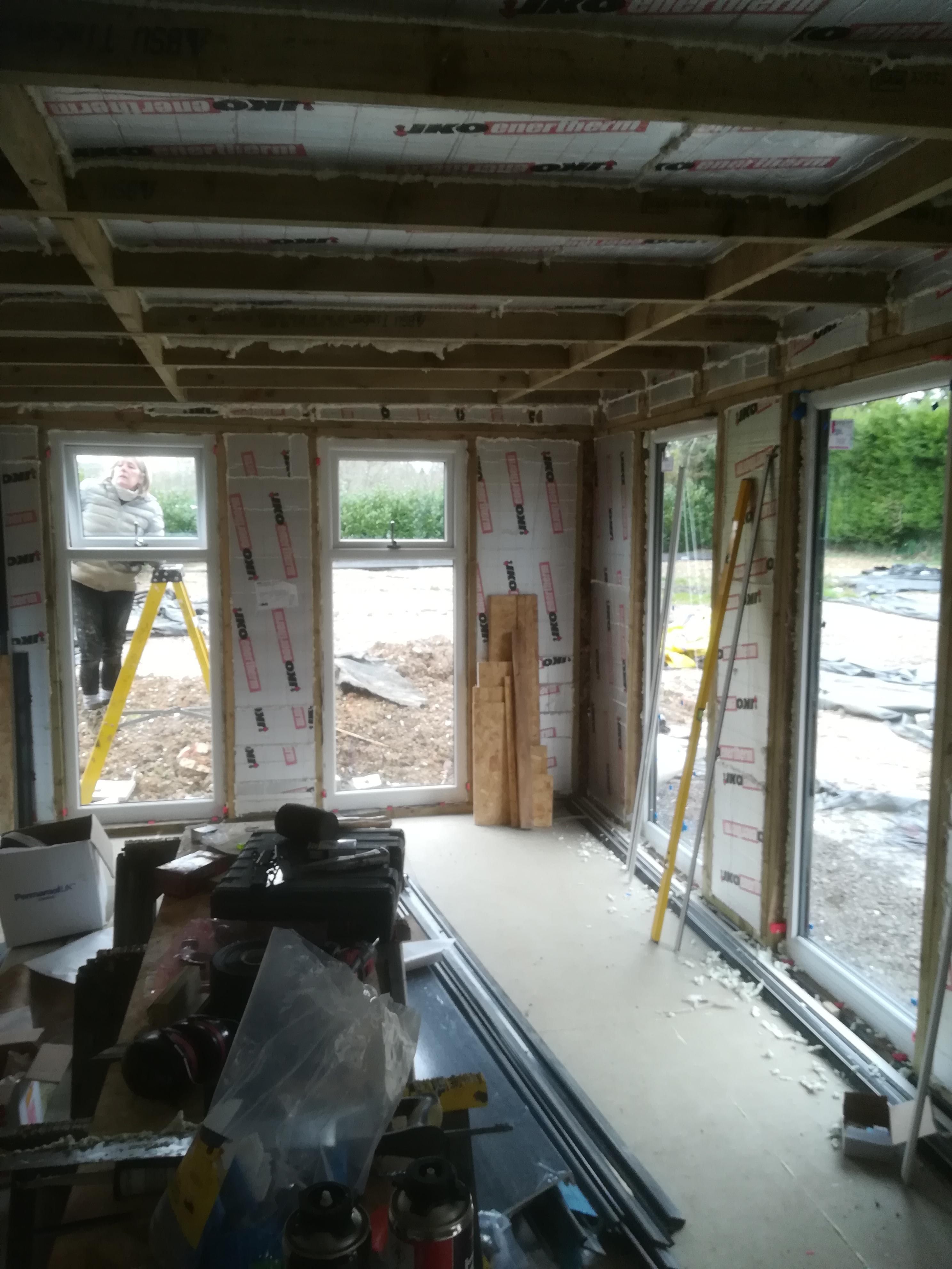

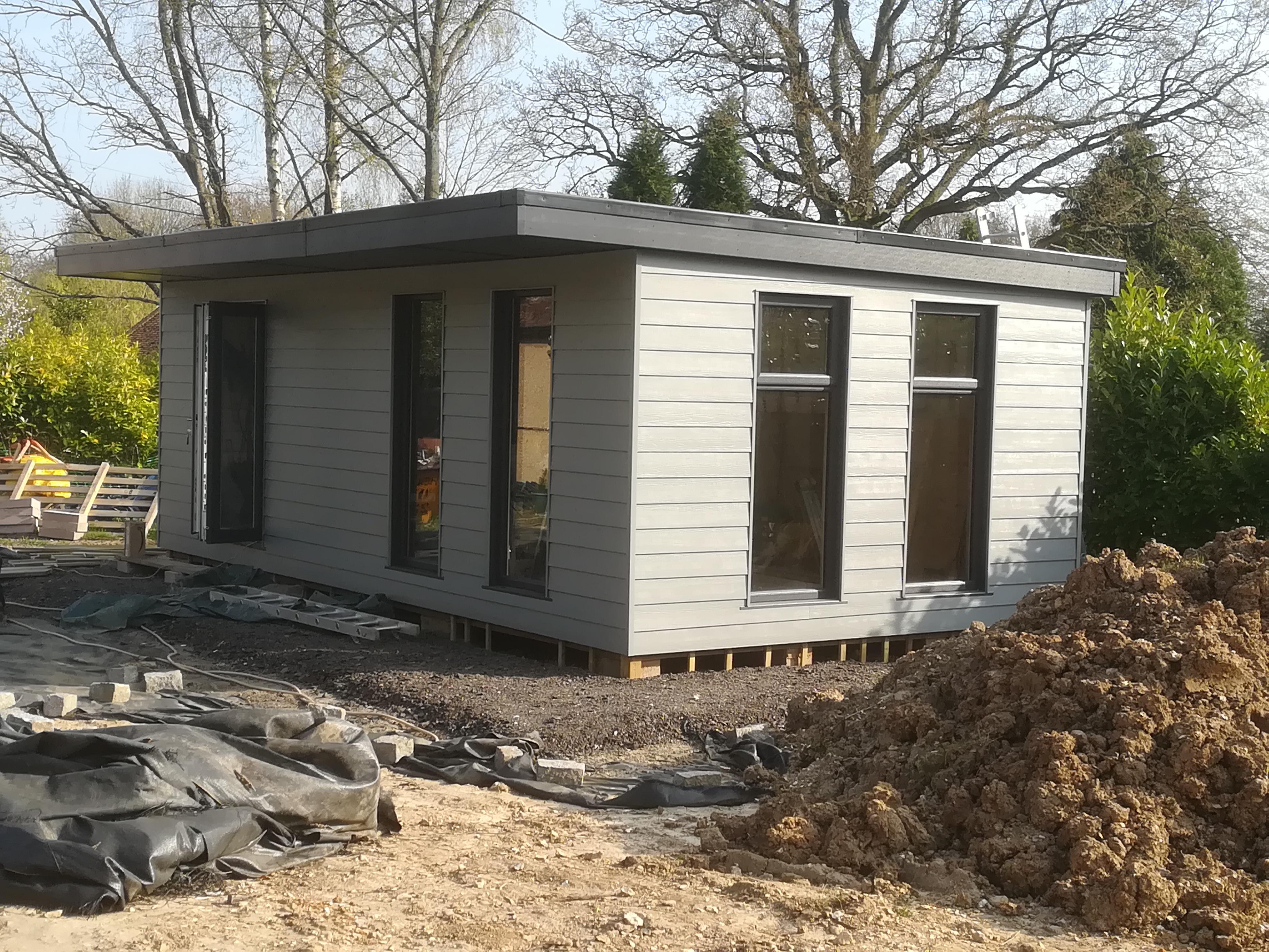

Big Jimbo Posted January 31, 2020 Author Share Posted January 31, 2020 Insulation all done.,and a quick pick of the outside. 900mm overhang to the roof so I won't get soaked when I'm opening the doors. 1 Link to comment Share on other sites More sharing options...
Temp Posted January 31, 2020 Share Posted January 31, 2020 Looks great. Make sure everything is well fixed down. We had a shed roof blow off once. Took out neighbours fence. 1 Link to comment Share on other sites More sharing options...
Big Jimbo Posted January 31, 2020 Author Share Posted January 31, 2020 28 minutes ago, Temp said: Looks great. Make sure everything is well fixed down. We had a shed roof blow off once. Took out neighbours fence. 8 x 1mt bend straps burried down into the concrete. Plenty of straps on roof to walls. I am quite exposed here. Don't want to loose it like the One in Slough recently. 1 Link to comment Share on other sites More sharing options...
ProDave Posted January 31, 2020 Share Posted January 31, 2020 There is an old derelict log cabin building at the top of our road, a former pub. Not long after it was built in the 70's , the roof, complete with the top 7 rows of logs from the walls blew off. IT was rebuilt with even longer tie down straps. 1 Link to comment Share on other sites More sharing options...

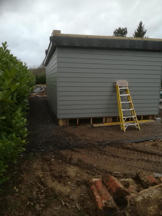

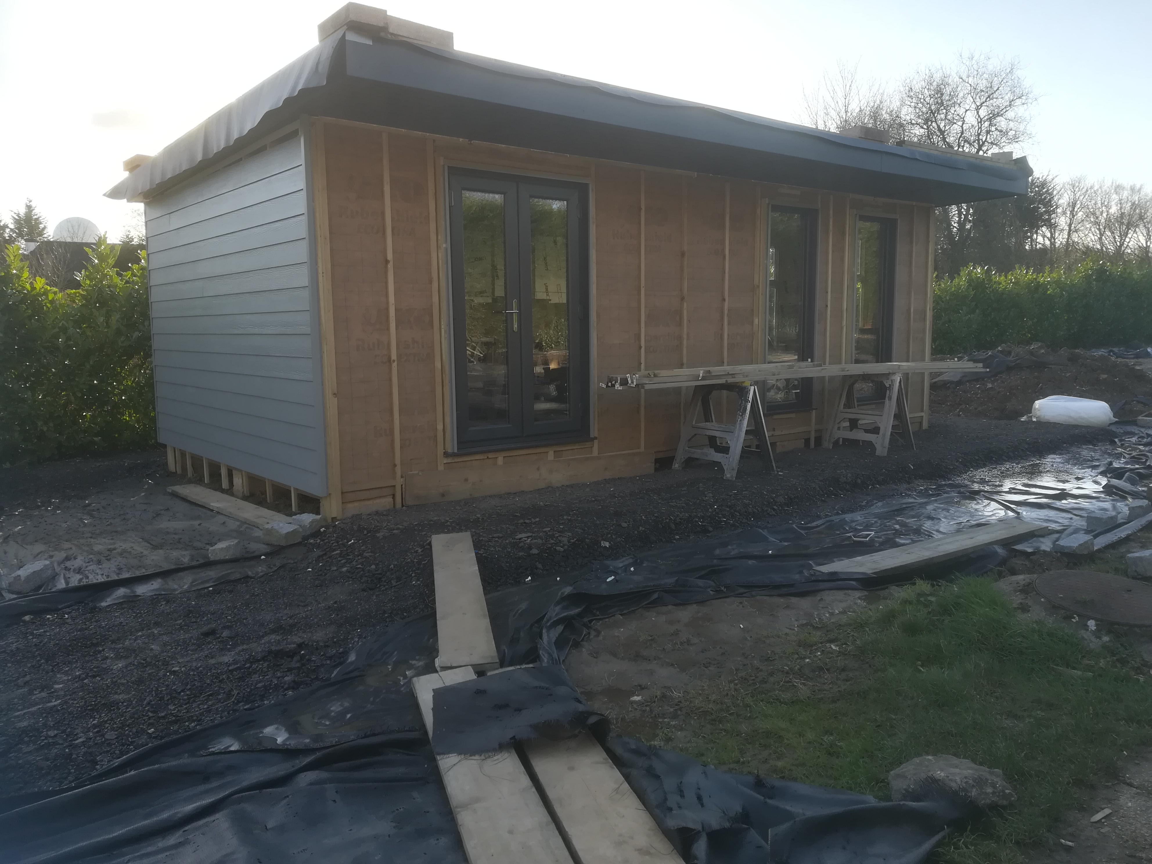

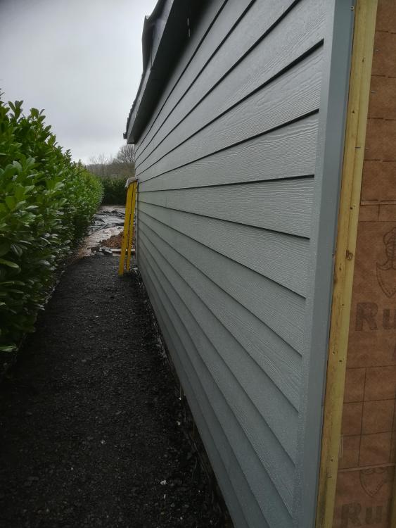

Big Jimbo Posted February 19, 2020 Author Share Posted February 19, 2020 Started a bit of cladding on the posh shed, despite the rain. 1 Link to comment Share on other sites More sharing options...
Big Jimbo Posted February 19, 2020 Author Share Posted February 19, 2020 As some of you may remember, i got permission to extend my bungalow in the Green belt from about 500sq ft to 3000sq ft. I then went back into planning to see if i could get Two instead of the One large. That was refused by L.A. and refused on appeal. The permission i obtained took away my class E permitted devl rights. I spoketo the planning officer re a "posh shed" and he said build it before i started work, and i would not need to apply. This is what i have done, and what you are starting to see in the pictures. Now, i have decided that my extended house when built, will be too big (I added it up the other day, and the internal floor area is about 3200sq ft. ) I have decided that i am going to go back into planning for a knock and build with a smaller house of about 2500 ish sq ft. What i am not sure of is. If i apply to replace existing house, will this cover me for the demolish part ? I don't want to have to apply for that on it's own. The second thing is under the same application can i apply to live on site during construction. Ie; either in a caravan, static, or my man shed ? and do i have to state which ? Thanks for your help as usual. Link to comment Share on other sites More sharing options...

Big Jimbo Posted February 21, 2020 Author Share Posted February 21, 2020 Bit more cladding done. Doors and windows arrive Monday. One of these days, I'll stick the rubber down. Link to comment Share on other sites More sharing options...

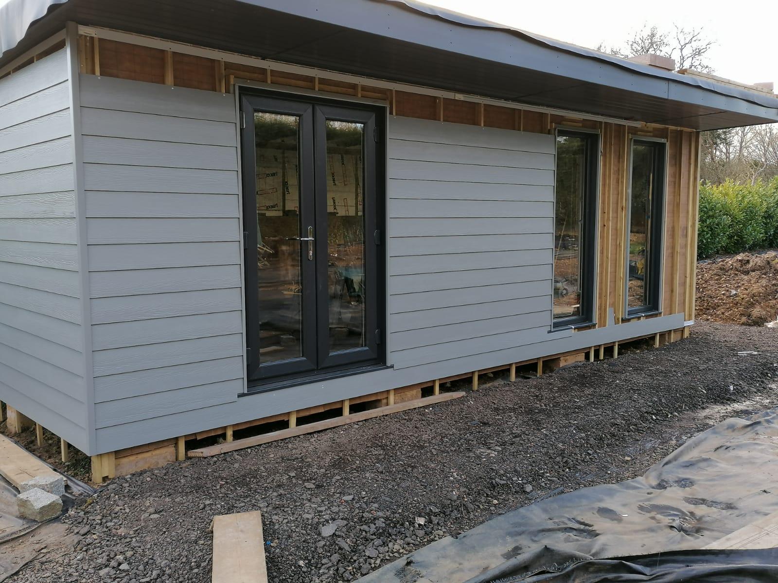

Big Jimbo Posted February 25, 2020 Author Share Posted February 25, 2020 Chucked some double glazing in today, and French doors. Let there be light 1 Link to comment Share on other sites More sharing options...

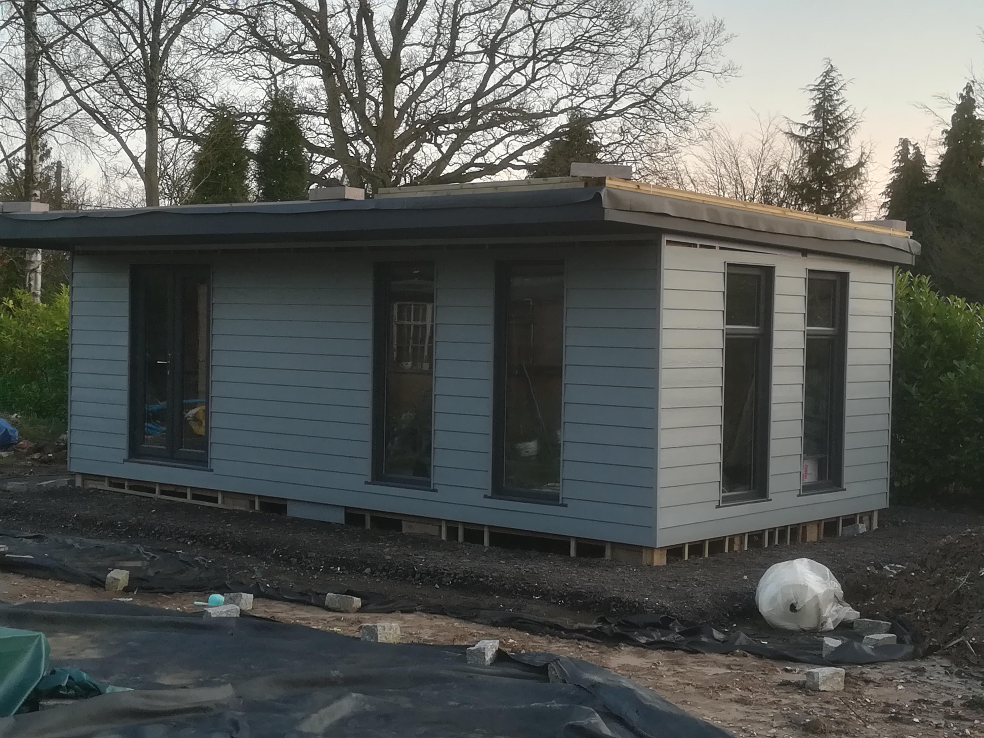

Big Jimbo Posted February 27, 2020 Author Share Posted February 27, 2020 Outside reveals on a few of the windows, and doors done, and started to batten out for cladding. 2 1 Link to comment Share on other sites More sharing options...

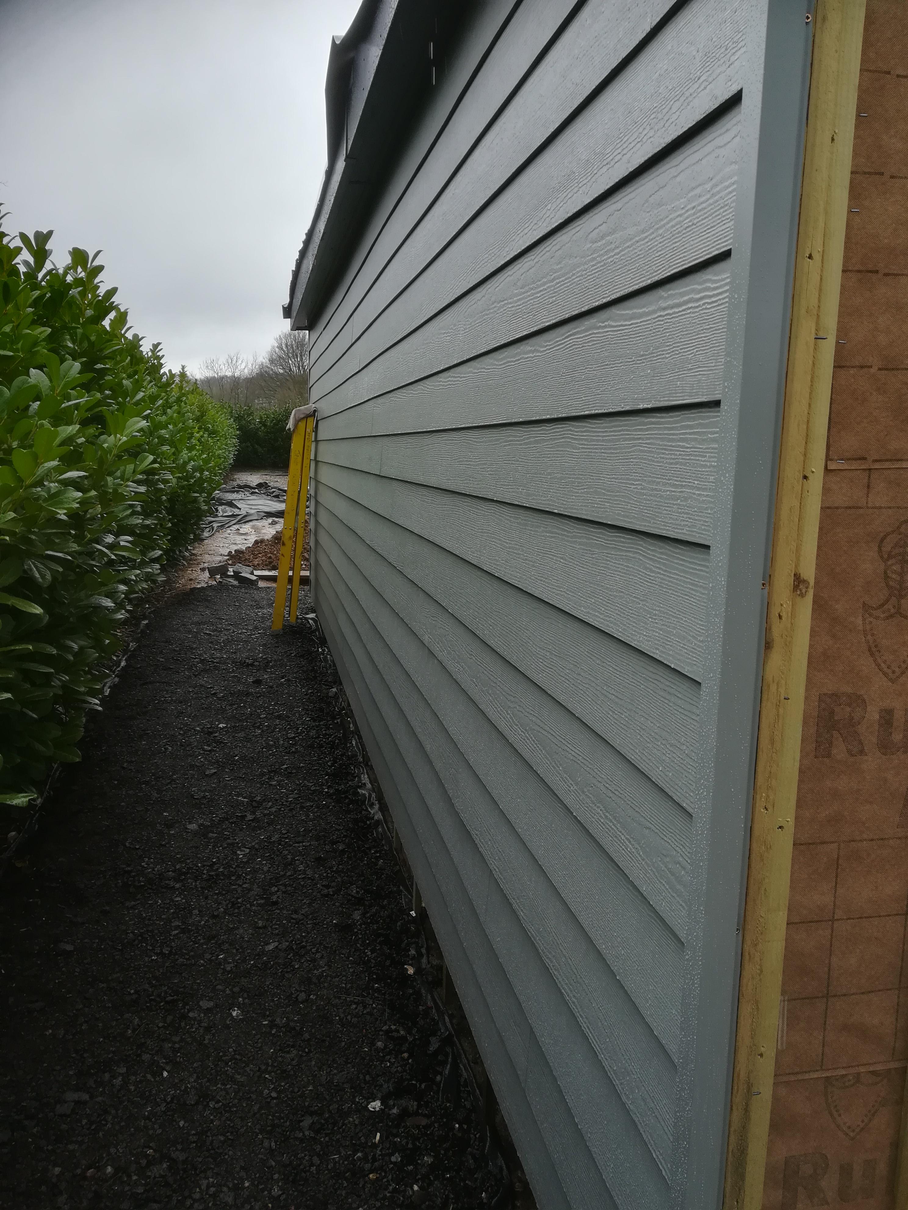

Big Jimbo Posted March 1, 2020 Author Share Posted March 1, 2020 Not raining, so a bit more cladding done. Pleased with the contrast between the cladding and the doors and windows. 2 Link to comment Share on other sites More sharing options...
Onoff Posted March 1, 2020 Share Posted March 1, 2020 On 31/01/2020 at 15:30, Big Jimbo said: Did you clad then cut the cladding to suit the doors / windows? Link to comment Share on other sites More sharing options...
Russdl Posted March 1, 2020 Share Posted March 1, 2020 @Big Jimbo it does look good. What is that cladding? Is it Cedral (or something like that?) Link to comment Share on other sites More sharing options...
Big Jimbo Posted March 1, 2020 Author Share Posted March 1, 2020 2 minutes ago, Onoff said: Did you clad then cut the cladding to suit the doors / windows? Nah, just winged it. So far no cladding waste. Link to comment Share on other sites More sharing options...
Big Jimbo Posted March 1, 2020 Author Share Posted March 1, 2020 2 minutes ago, Russdl said: @Big Jimbo it does look good. What is that cladding? Is it Cedral (or something like that?) James Hardie. Sooooo much cheaper than Cedral, and comes with a 10 year paint G/tee unlike Cedral. 1 Link to comment Share on other sites More sharing options...

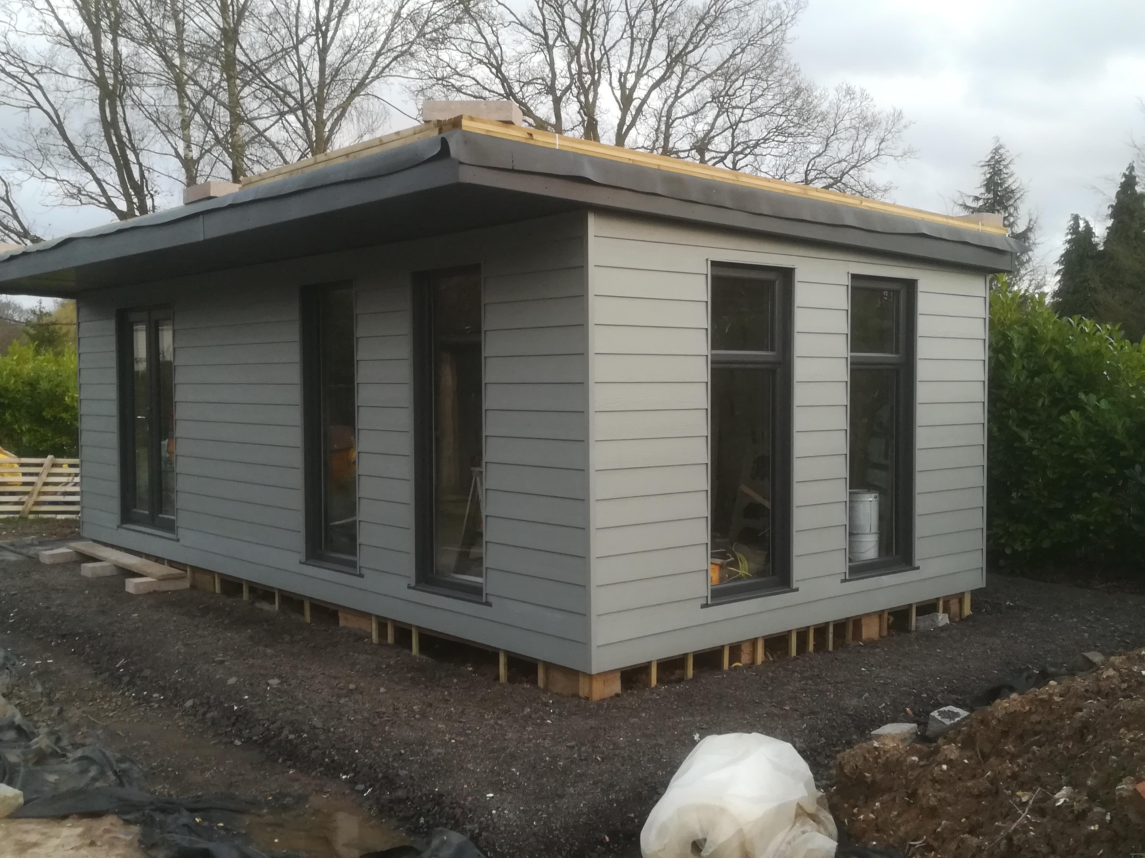

Big Jimbo Posted March 6, 2020 Author Share Posted March 6, 2020 Bit more done. Starting to look like a mobile home rather than a posh shed. 1 1 Link to comment Share on other sites More sharing options...
Onoff Posted March 6, 2020 Share Posted March 6, 2020 1 hour ago, Big Jimbo said: Bit more done. Starting to look like a mobile home rather than a posh shed. Stick some mock wheels and a tow bar on it? ? A bit of decking, some strategically placed potted conifers, a few down lights... Link to comment Share on other sites More sharing options...
Big Jimbo Posted March 6, 2020 Author Share Posted March 6, 2020 23 minutes ago, Onoff said: Stick some mock wheels and a tow bar on it? ? A bit of decking, some strategically placed potted conifers, a few down lights... Well although i'm dead posh. Born in Hampstead. I am entitled to an Irish Passport due to my ancestry. So you could have a good point.? Link to comment Share on other sites More sharing options...
Big Jimbo Posted March 11, 2020 Author Share Posted March 11, 2020 Finally got the sloping top bits of my cladding cut and fitted. Still got to stick the roof down, and do the skirt around the bottom, which I think I will do in black. Top half of my house will be clad the same, so pleased to have had the chance to practice on the posh shed 2 Link to comment Share on other sites More sharing options...

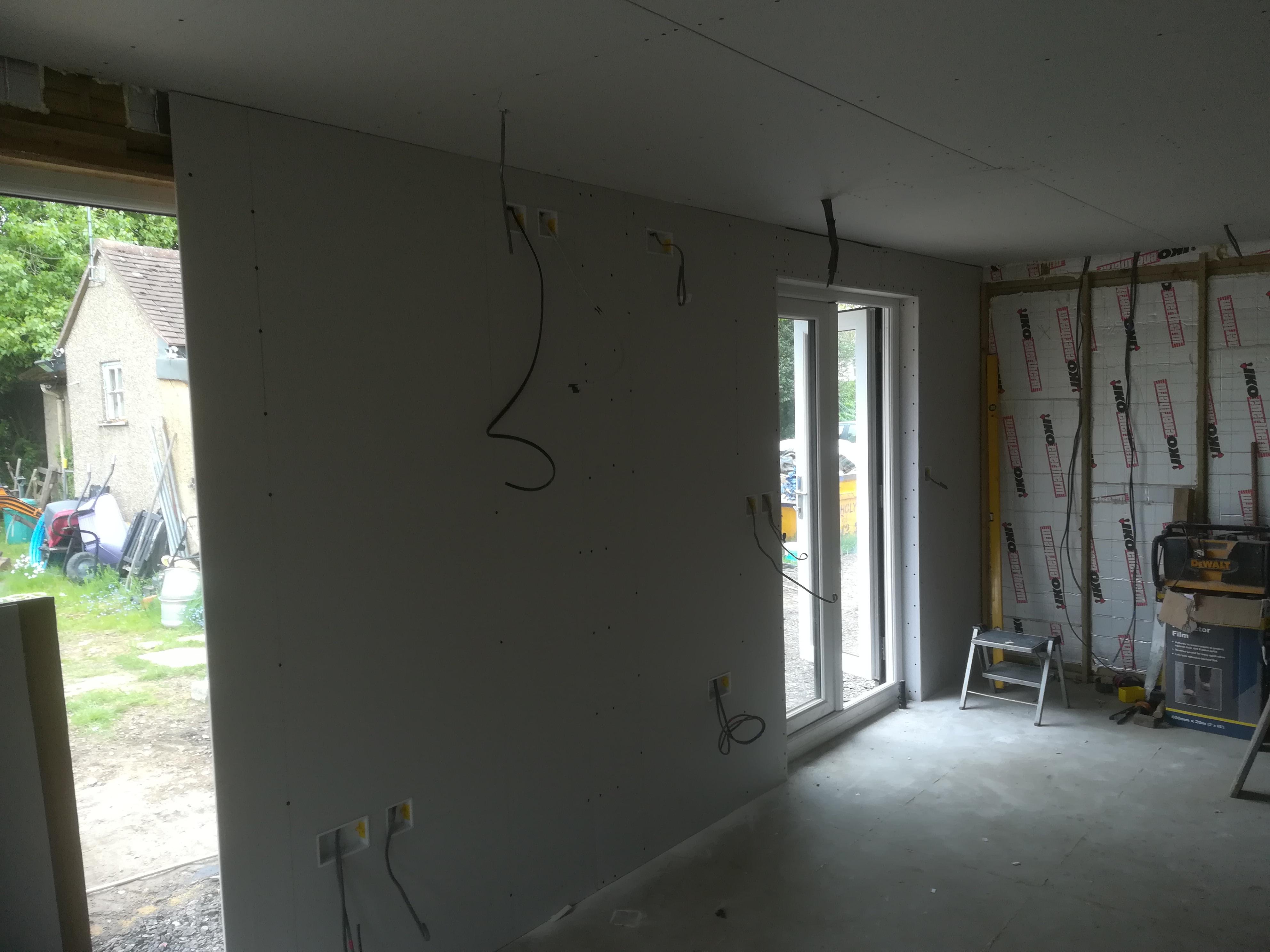

Big Jimbo Posted May 3, 2020 Author Share Posted May 3, 2020 Started a bit of plasterboarding in the posh shed 2 Link to comment Share on other sites More sharing options...
