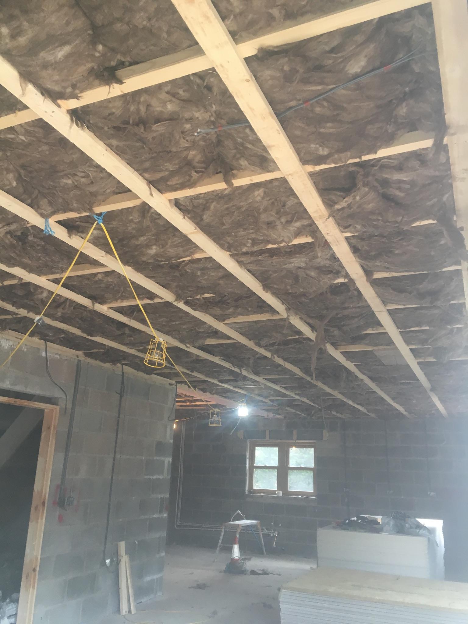

MikeSharp01 Posted January 2, 2020 Share Posted January 2, 2020 Time to order the first floor floorboards. 18mm is structurally enough on 400mm centres of our I-joists but I was wondering what the advantage of 22mm might be if it isnt structural. Link to comment Share on other sites More sharing options...
