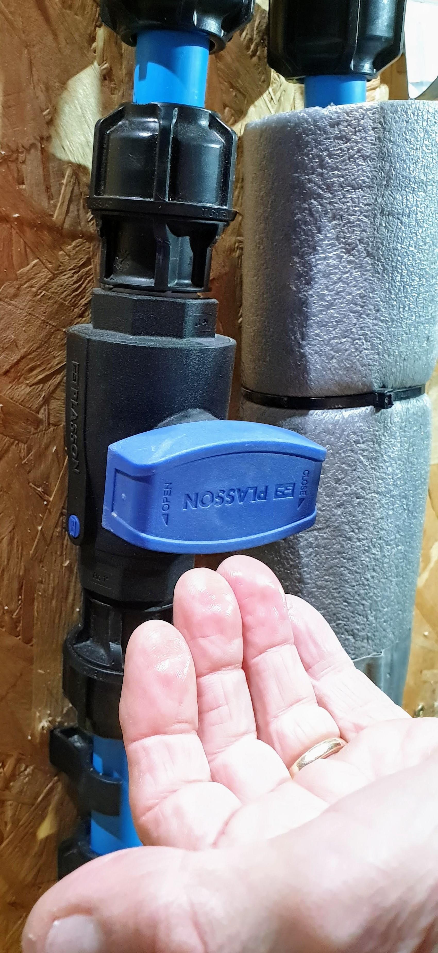

ToughButterCup Posted November 25, 2019 Share Posted November 25, 2019 Why @Russell griffiths, why does it always happen to me? Tell me, why? This is the approved United Utilities design for a new connection. Before we had the work done, an inspector came out to see if I had done the work as per the diagram. We had indeed. The keen-eyed among you will see that there is no external stop-tap. Can you see where this is going yet? The internal Plasson stop tap (fitted by me) is dripping from the stalk: not much - about an egg-cup full every night I had a mate come round and confirm my suspicion - I thought I was going a bit mad - the valve is indeed leaking from the stalk. The lovely, expensive Plasson valve has a leaky stalk. Easy, mate he said, Turn the outside stop tap off and we'll replace it he said. Aint got one I said. Cue earthy Lancastrian disbelief. Here it is - ever so faint, but here the leak is...... 'Nother fine mess I got myself into eh? Wot's next then folks? Link to comment Share on other sites More sharing options...

ToughButterCup Posted November 25, 2019 Author Share Posted November 25, 2019 36 minutes ago, ProDave said: Are you SURE you don't have [...] Yes. 100 %. I dug the ditch, laid the pipe, stopped the end, and that was inspected by the inspector. All OK. 39 minutes ago, redtop said: [...] guess it depends where exactly its leaking from? Its leaking from the stalk: you have to dig your fingers in behind the blue Plasson valve handle (its hollow) and smear your finger along the stalk to get your finger wet. Link to comment Share on other sites More sharing options...

ToughButterCup Posted November 25, 2019 Author Share Posted November 25, 2019 Just now, ProDave said: I am now confused. What is this for then? Is that not your outside underground meter and stop tap? If no outside stop tap, how did they connect your tail? Did they fit a stop tap where they made the connection? Go on humour me and have a look. Hi Dave, No, that image is the valve inside thebuilt in wall meter box. Thats the second of two stop valves. The blue one ( above) is inside our piggery. I stood and watched as they connected my 'tail'. There is no external stop valve. Big, fat, smelly promise. 3 minutes ago, Mr Punter said: [...] you may be better using a squeeze off tool [...] ? Why me? Why? Link to comment Share on other sites More sharing options...

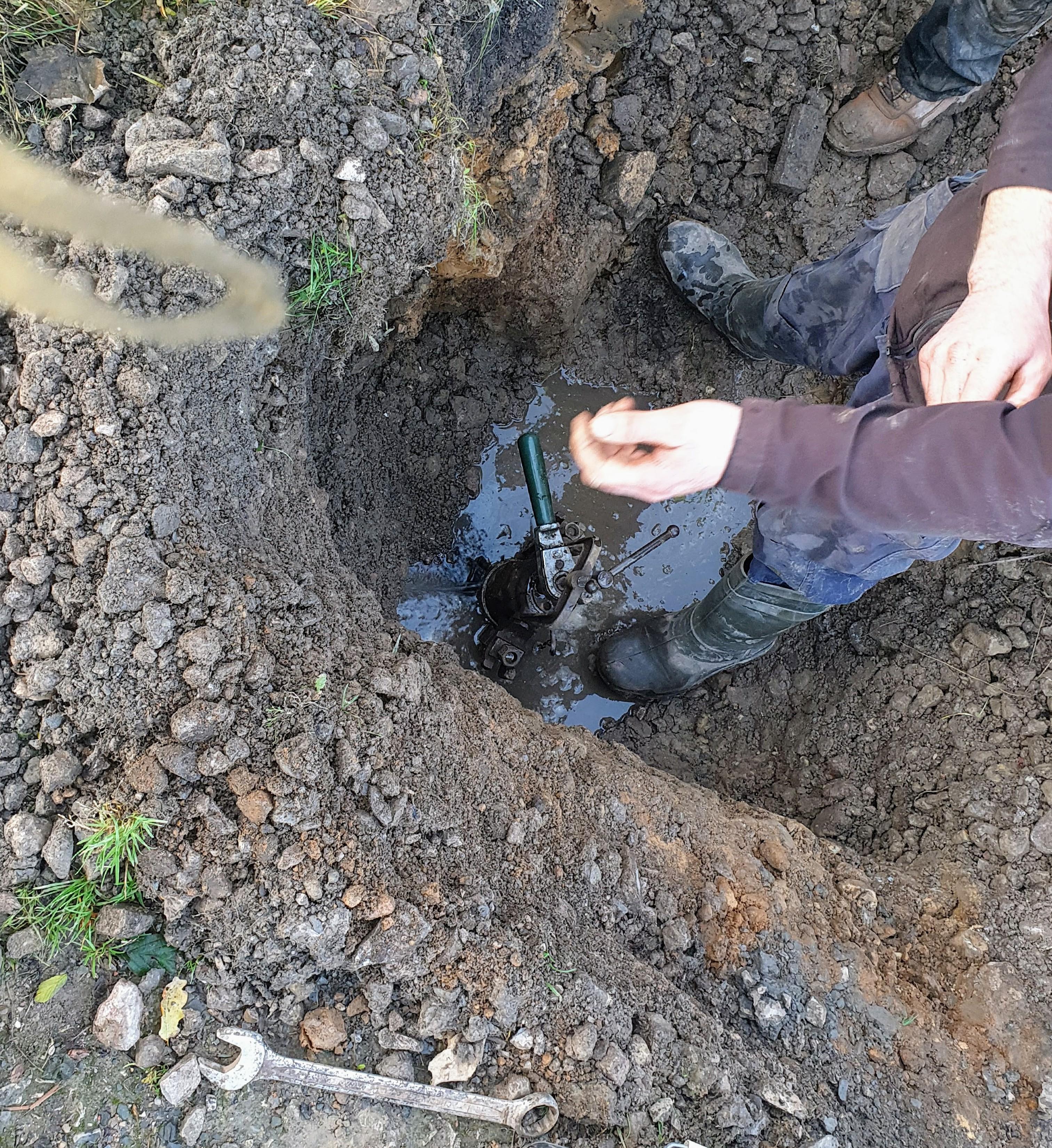

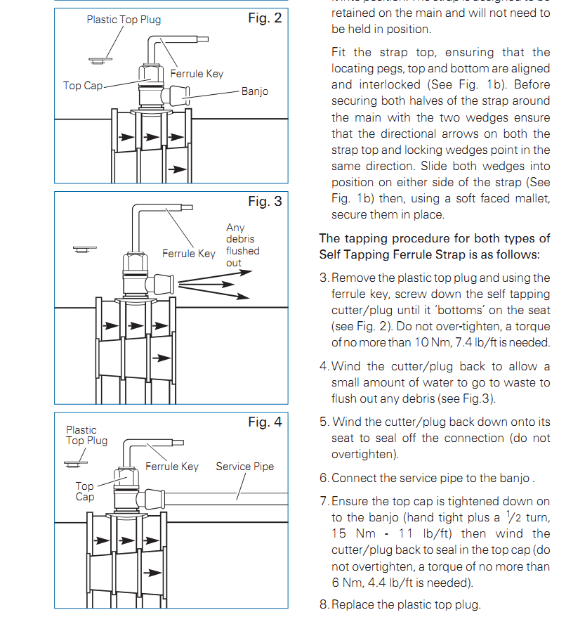

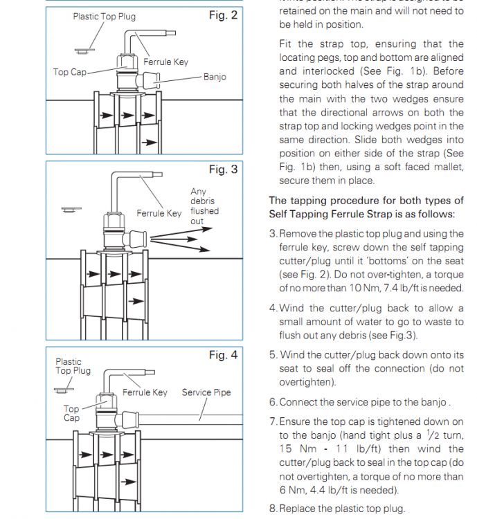

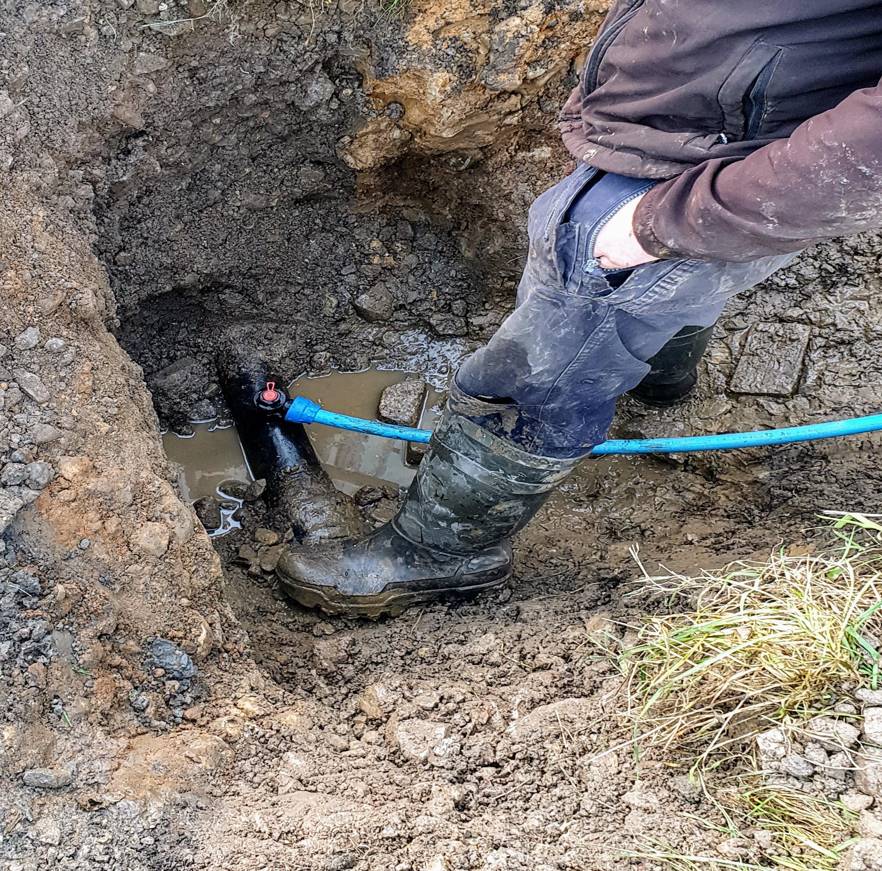

Conor Posted November 26, 2019 Share Posted November 26, 2019 13 hours ago, AnonymousBosch said: If I HAD inserted a stop valve, then the inspector could have refused the work because I would not have followed the diagram. Same feed, the piggery is closer to the road. They used a Talbot Compression Tool. It forces a threaded connector into the main like this ... once made, this assembly is screwed on top of the main. And that was that, nothing else done - back fill , tea, medals. Holy crap. That's terrible design. They should have stuck a boundary box on to the initial connection tail. And the piggery comes of this same connection? Where does the ownership change from UU to you? Usually, it's at the aforementioned boundary box... Who's responsible for a leak on that connection? Link to comment Share on other sites More sharing options...

RandAbuild Posted November 26, 2019 Share Posted November 26, 2019 Ian - it looks like you've got one of these connectors on the mains supply pipe, see page 27: http://www.mains2meters.ie/docs/Talbot_Product_Guide_May08.pdf What it doesn't say is what happens if you pull off the red tab - is there a valve inside? A quick call to the Talbot people might tell you 1 Link to comment Share on other sites More sharing options...
Jeremy Harris Posted November 26, 2019 Share Posted November 26, 2019 There's a shut off valve under the red cap. You need a key to shut it off by the look of things: Link to comment Share on other sites More sharing options...
Conor Posted November 26, 2019 Share Posted November 26, 2019 1 hour ago, Jeremy Harris said: There's a shut off valve under the red cap. You need a key to shut it off by the look of things: Usually a 10mm hex key. They are not designed for frequent operation... I wouldn't go near it, because if it goes wrong, you're in a world of hurt. If it were me, I'd dig down near the connection, and install a Toby box. Squeeze the pipe off, cut and connect. 2 Link to comment Share on other sites More sharing options...
