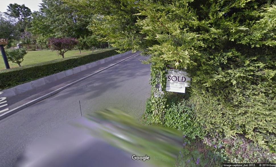

Mulberry View Posted November 9, 2019 Share Posted November 9, 2019 (edited) Before we submit full plans, I'm trying to go armed and ready to address the only real standout reason our project may not get approval. The plot is accessed from a shared drive, which currently serves 3 fairly large properties. Ours would be the 4th. The drive joins the highway in a 20mph zone, with speed bumps and pinch points. At the junction with the highway, there is a fence to the right (the 'critical direction') which has been lowered and now enjoys good visibility. To the left there is a 1.4m high wall which definitely does impair the view of traffic from the non-critical direction. I've used the drive for years as it's a family home we're potentially subdividing, I tend to approach the end of the drive on the right-hand side, giving the best possible view to the left, but you still need to edge forwards once you've checked to the right. Highways have already indicated a distaste and unless I can come up with a pragmatic solution, in my own mind at least, I can't see much point in moving things forwards. They suggested speaking with the owner of the wall about lowering it, but the wall looks 100 years old. It's not in a great state of repair, but I just can't see that as being a practical solution. Given that most people object about new developments and change, I can't see any motivation for them to do this to facilitate something that they'll probably ultimately object to. At our end of the road, there is a footpath on the far side only and no other real challenges apart from the wall. The road intensifies further along, away from our driveway, the road gets even narrower, the footpaths disappear and there are cars parked on the road on both sides. The road has a number of tricky driveways, many exit directly onto the road with no turning space and several already have convex traffic mirrors. Could this be a sensible solution to our problem? Edited November 9, 2019 by christianbeccy Link to comment Share on other sites More sharing options...

joe90 Posted November 9, 2019 Share Posted November 9, 2019 4 hours ago, christianbeccy said: At the junction with the highway, there is a fence to the right (the 'critical direction') which has been lowered and now enjoys good visibility. Link to comment Share on other sites More sharing options...

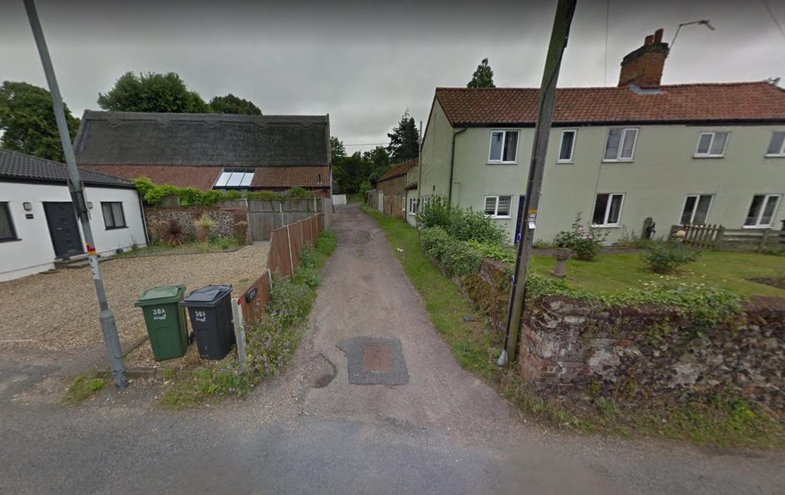

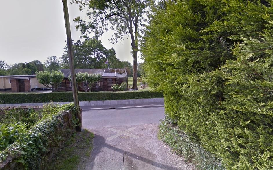

Mulberry View Posted November 10, 2019 Author Share Posted November 10, 2019 There is the driveway in question. As you can see, the wall is very aged. I can't even imagine offering to rebuild the wall will be sufficient based on what @Sensus said above. There isn't a realistic prospect of getting the owner of that wall to enter into a legal agreement to prevent them, or the future owners of their property from increasing the height or adding a hedge, so this would mean that any solution along those lines is merely to satisfy highways for the 5 minute inspection visit, which seems ludicrous. The lack of pavement is annoying in this case, with a pavement there, you'd be further forwards when you arrive at the junction, perhaps enough to give the required level of splay visibility. One solution would be to raise the height of the driveway, then taper it off to meet the highway, although whether this could be done from a practical stand-point and whether it would just create an annoying hump is subject to some debate. Link to comment Share on other sites More sharing options...
ProDave Posted November 10, 2019 Share Posted November 10, 2019 That wall is nowhere near as high as I expected from your description. How high is it exactly? And it is not right on the edge of the highway, it is set back by a grass verge. What is the distance from the wall to the tarmac of the road? and I don't just mean at that corner say a couple of metres from the driveway? Up here, the visibility is measured from a point 2.4 metres back from the edge of the road, and 1.05 metres high. If that wall is only marginally above 1.05 metres high there might me mileage in your idea to raise the level of the drive slightly and then slope it down to meet the road. 1 Link to comment Share on other sites More sharing options...

Mulberry View Posted November 10, 2019 Author Share Posted November 10, 2019 2 hours ago, ProDave said: That wall is nowhere near as high as I expected from your description. How high is it exactly? And it is not right on the edge of the highway, it is set back by a grass verge. What is the distance from the wall to the tarmac of the road? and I don't just mean at that corner say a couple of metres from the driveway? Up here, the visibility is measured from a point 2.4 metres back from the edge of the road, and 1.05 metres high. If that wall is only marginally above 1.05 metres high there might me mileage in your idea to raise the level of the drive slightly and then slope it down to meet the road. A highways officer popped by there last week to take a look, it wasn't arranged, so i guess he was just in the area at the time. He measured it as 1.4m. It would be entirely practical to raise the driveway up to this height, but to lose the 400mm addition height over the remaining 2.4m of driveway would just be too steep and with it's own set of problems. The grass verge is minimal in depth. If you look carefully at the verge on the side where the telegraph pole is, just behind that is a water meter cover. That's set at the height that the driveway would need to be at to stand a chance of meeting the stated requirements. I'm really curious about the other property that was developed there in recent years. It was first converted to residential in the late 90's, then done properly and made into high-spec living accommodation about 5 years ago. When the rework was done 5 years ago, the site notes declared 'no highway issues'. I think the fence on the other side was lowered when it was done in the 90's, I wonder why only one side was required to be altered? I need to see that file I reckon, to see what the stipulation was and how it got through... Link to comment Share on other sites More sharing options...
