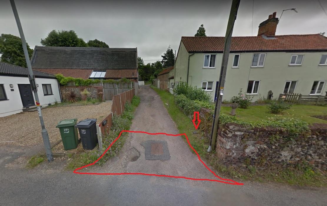

Furthermore, in this badly MS Paint amended photo, what I have aimed to show is what I deem to be the most practical solution.
The arrow points to the water meter cover that appears to be set at the height that we'd need to raise the driveway to, in reality it'd swallow up most of the grassy area on both sides. We'd be adding 400mm at that point, tapering it off up the drive. But we'd have to lose the 400mm as it heads back towards the highway and, I guess, without making it horrible to use and without a tricky hump.
I wonder if they'd give us a bit of scope with blending it into the highway (as shown) a little more widely to help with this?
Do you think 400mm sounds like a lot to lose over 2.5 ish metres?
This work would clearly be a benefit to the existing users of the driveway, probably adding points in our favour from a planning standpoint. We might all be able to share the costs to an extent and get the whole thing resurfaced while we're at it, although this will be secondary for sure.
Could the council, at that point, enforce that the owner of the wall agree to not add to the height on that corner, perhaps @Sensus could add his expertise here?
One potential snag with raising the level may be the maximum allowable gradient at the initial part of the access road.  We were initially given a standard condition that the initial gradient of our drive at the approach to the lane would not exceed 1:15 for the first 4.5m back from the lane.  We couldn't achieve this, due to a conflict with the minimum level AOD of the garage and parking area, but our planning officer just allowed the steeper gradient, on the basis that conditions from the EA apparently trump those from highways.  Whether this was just his opinion, or whether it's embedded in policy somewhere, I've no idea, I was just grateful to see common sense being used.
