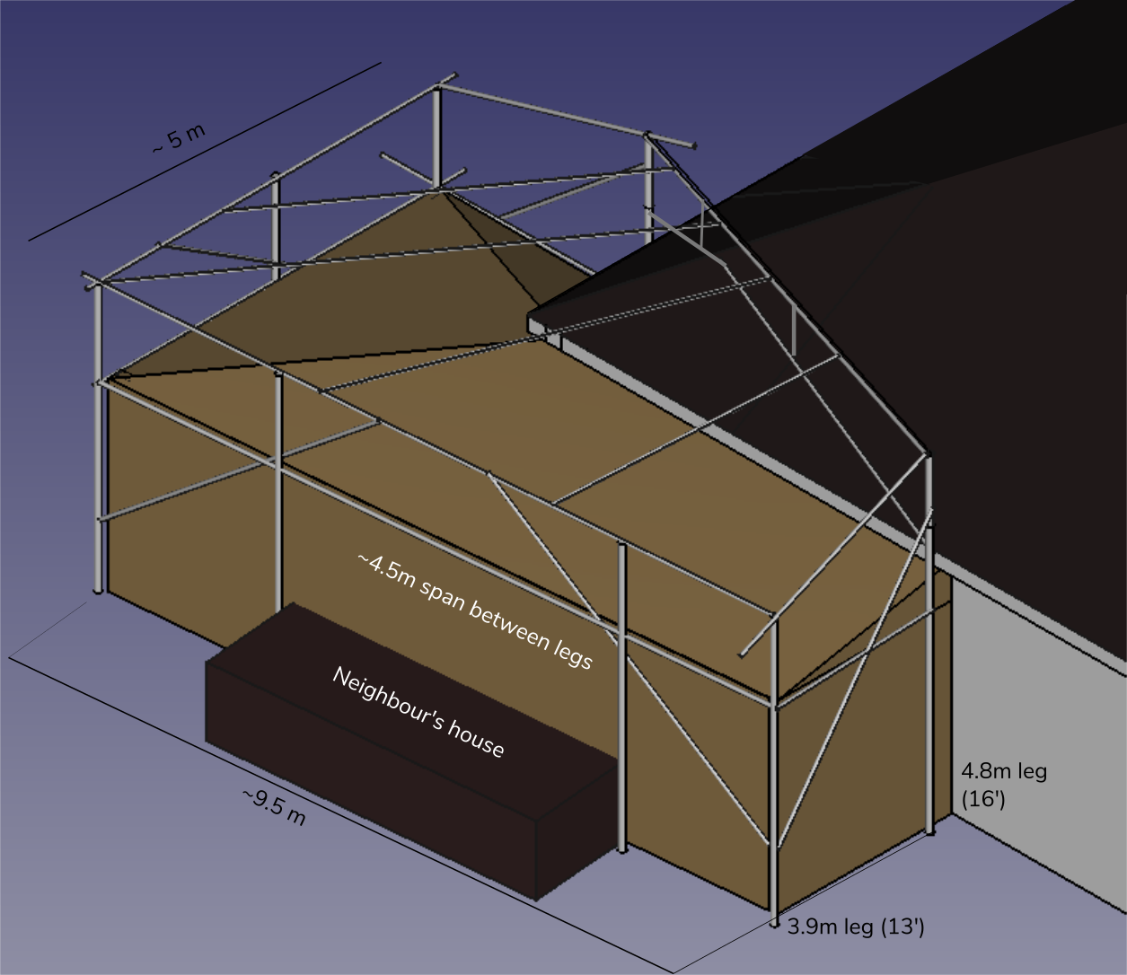

So, following the latest instalment in the ongoing saga of my GRP roof I've been thinking more about trying to enclose it in a temporary tent so it can dry / I can break the increasingly depressing dependency on the weather. The BBC reckon it's now going to rain here most days for at least the next fortnight, and it is getting progressively colder and darker.
I'm aware there's loads of high-end temporary roof structure systems, but I'm not really up for getting a contractor / paying that kind of money. Just need to cover it for a fortnight or so so I can get this bit done then move on.
My thinking is a fairly basic scaffolding tube structure, with a sheet of clear polytunnel plastic stretched over the top / sides, stapled to / clamped between lengths of scrap timber around the bottom edges. I can get the polytunnel sheet big enough to cover the whole thing in a single piece, and good thermal / sunlight properties.
Here's a very rough mockup sketch of the idea. The garage is an L shape round the corner of the house, so one side of the structure would have to sail over the corner of our roof hip - probably with a bottom member resting on it on some foam / PIR offcuts to protect the slates.
The legs would be secured to the building, possibly with scaffolding eyes, short tube, clamps, or possibly with eyebolts and rope / ratchet straps (depending on what I can cobble together easily).
Have kept the outer legs to 3.9m to keep the wind-exposed faces smaller, would still have about 4 - 5 foot of head height inside the tent, enough to comfortably crawl about to work.
The idea would be to get the bottom edges of the sheeting close enough to the walls / house roof that between a fan heater and solar gain I could get the temperature up a wee bit above ambient to help the decking dry, and subsequently to be a bit warmer for the actual GRP process. Thinking once I have the structure weatherproof I can afford to leave it a week (or more) till the boards are all properly bone dry and then do the laminating / topcoat when it suits rather than having to try and grab a weather window and hope it doesn't unexpectedly bucket down as it has half way through the last two "good weather days".
Obviously scaffolding doesn't need to be loadbearing, tho don't want it to collapse under self-weight / any water that ponds on the sheeting (which it shouldn't do too badly if pulled tight). And equally obviously don't want it to blow away / covers to rip off in a storm and soak it all again. Have built quite a lot of basic scaff structures over the years, tho mostly indoors without need to worry about wind loading etc.
Questions:
  • Has the weather and frustration driven me stark raving mad?
  • Any thoughts on strength / stability?
  • Have found a couple of local companies that will dry-hire scaffold tube & clamps but only with a trade account which is proving a hurdle - anyone know of a supplier that will hire to self-builders (in or able to deliver to Central Scotland)? It's not a massive order, reckon 30ish lengths of varying lengths of barrel and a couple of crates of clamps.
  • Or would I be better buying the tube and then selling it on second hand? Have found a few companies selling used tube online for not much less than brand new - anyone got tips for a firm that would buy it back after, or am I going to be sat with it on the drive till I find a private buyer (which would probably drive SWMBO even more round the bend than the current lack of roofing progress)?

The structure:
  1. You've not got anything to bear the load across the structure from the top-left to the bottom-right. If you are going to do this,  use a triangular
  2. Your longest horizontal pole is about 5-6m? You'll want to use a truss or support that in the centre. I'd want to use trusses for all of the roof portion if I was you.
  3. You need a decent fall from one side to the other, at least 10% if not more, for rain runoff.
The Idea:
  1. Water will pool between your poles, even with a fall. That can lead to a lot of weight unless you stay on top of it.
  2. Water runoff looks like it'll strike your neighbour - suggest some plan to deal with that.

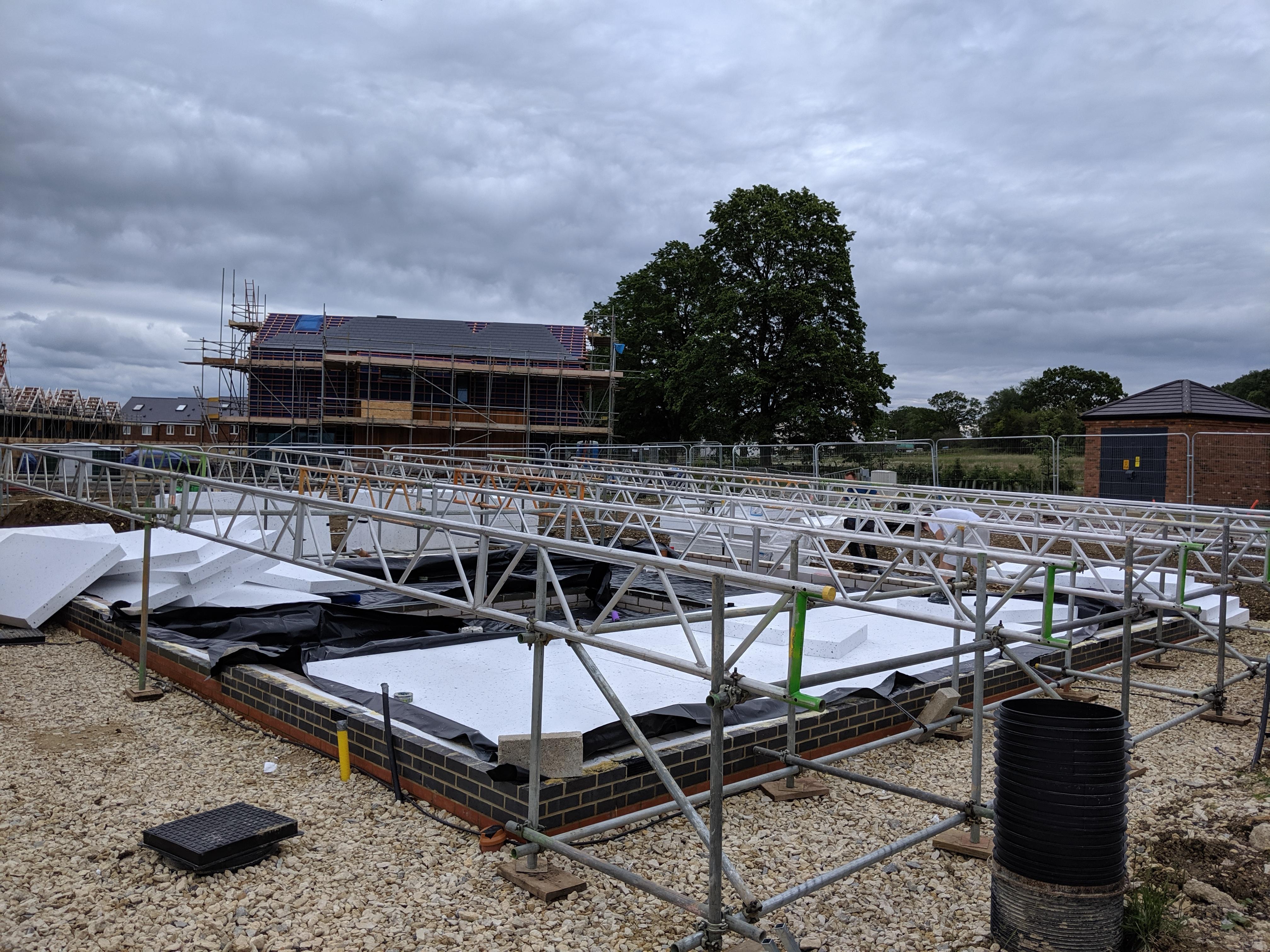

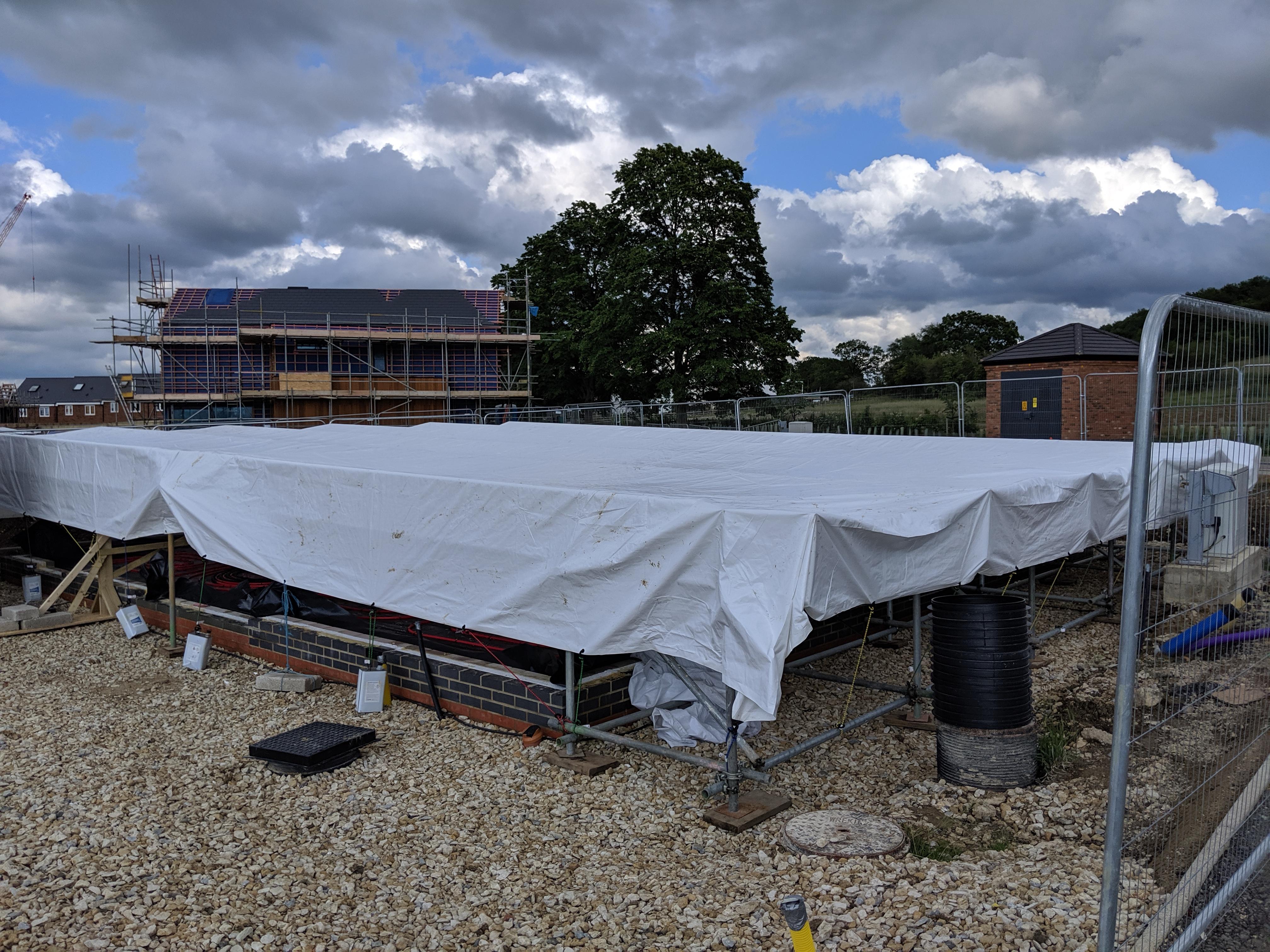

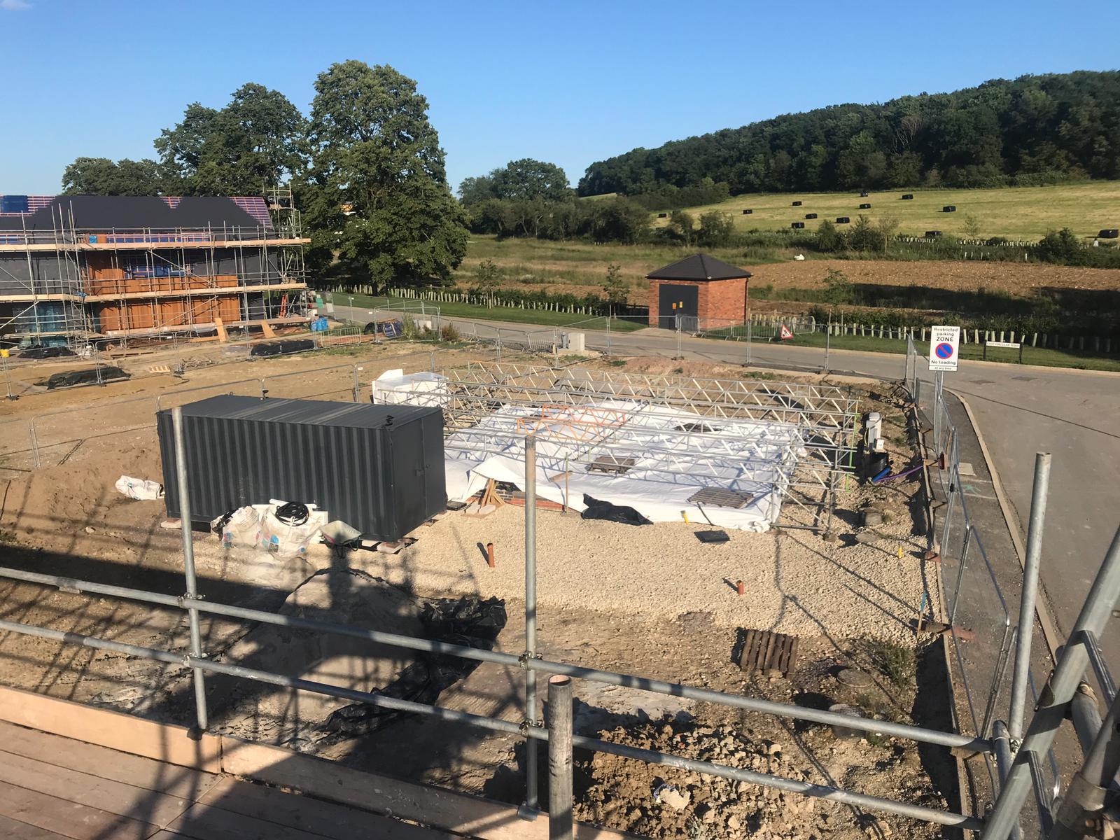

High note of caution from me who has done something similar; wind is frightening at that scale with a tarpaulin.
We spent £500 for a similar setup to cover 11x11m, and £250 for a 12x16m tarpaulin.
It did the trick, but you can see the setup was very heavy duty and even so the tarpaulin received a lot of damage in the process, with bungees snapping and the poles ripping into the wind driven tarp.
How a polytunnel will hold I don't know.

@Visti Hugely helpful, thanks.
* Longest horizontal pole around then edges would be the 4.5m span over the neighbour, which I'd thought of supporting with the diagonal bracing though realise a truss would be a lot better if I can source.
* Longest horizontal over the top is 4.8m and yes had been thinking that really would be pushing it without bracing/truss.
* On current idea the fall would be about 12 degrees, 20ish %
* Yes have been finding water pooling on the current tarps (which are only ~ a foot above the deck and supported on catenaries slung between a few timber blocks round the edges, had to get something up as a quick cover). Would expect to be up regularly pushing it out.
* The join isn't actually to neighbours house but to their box gutter installed over the gap between the two of us when they did their extension and (by agreement) fixed to our wall. So no issue with our rainwater dropping down into that short term, they're happy with that.
* Should clarify the area is sheltered immediately either side by the two houses (bit more than half a storey taller), less so front to back but the house over the road and trees at the bottom of our garden do seem to break the wind up a bit most of the time. Have had various combinations of breather membrane held down by timber / bricks just sitting
on deck and draped over rooflight upstands, tarps floating over the top through a mix of tying off to sides and a few ropes underneath etc for more than a month now including through some reasonable storms and although it's got a bit flappy sometimes (and done a fair bit of damage to the tarps, on second set now) it's not seemed at risk of actually ripping eyelets out / ropes off fixings. Appreciate raising it further above the roof and putting sides on will increase wind exposure.
I'm not entirely clear how polytunnel would hold up either, tho thinking a) it is designed to be stretched over a fairly open frame in a field for years so presumably fairly robust and b) if it was a bit weaker than tarp that wouldn't be a bad thing as would rather thin plastic ripped and flew away than the whole structure went with it if it got really wild?
Was your £500 for the trussing supply only or did that include labour? How long did you have it / did you find it easy enough to source?

£500 for the entire scaff setup you can see in the photos. Cash deal with labour to install and strike down 2 months later. They had us for the scaffold for the whole house, so I had some leverage of future business with them.
Key point of note was that we were warned not to tie the tarpaulin to the scaffold itself, but to weigh down the tarp as best we could independently. You can see we did what we could, but in some cases we did tie it to the scaff.
