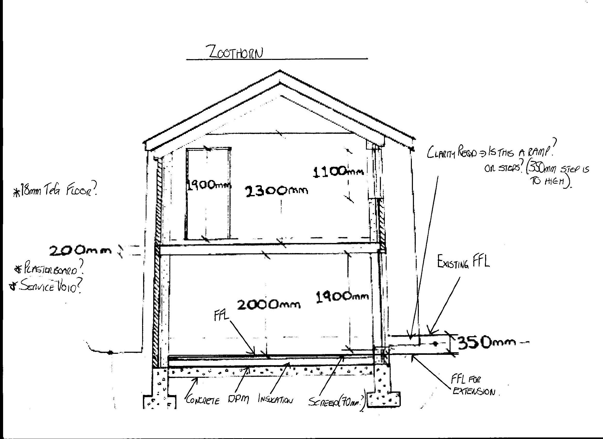

zoothorn Posted October 17, 2019 Author Share Posted October 17, 2019 Can someone tell me what usually happens on a typical groundwork ground floor for an extention. Just a standard build. I get the 2x 9" block perimeter ontop of the moat of founds. This I understand. Its between this work & the FFL.. can someone please tell me the typical layers to expect. One of the layers is 100mm polystyrene. This I understand (but where its to be found I do not). Link to comment Share on other sites More sharing options...

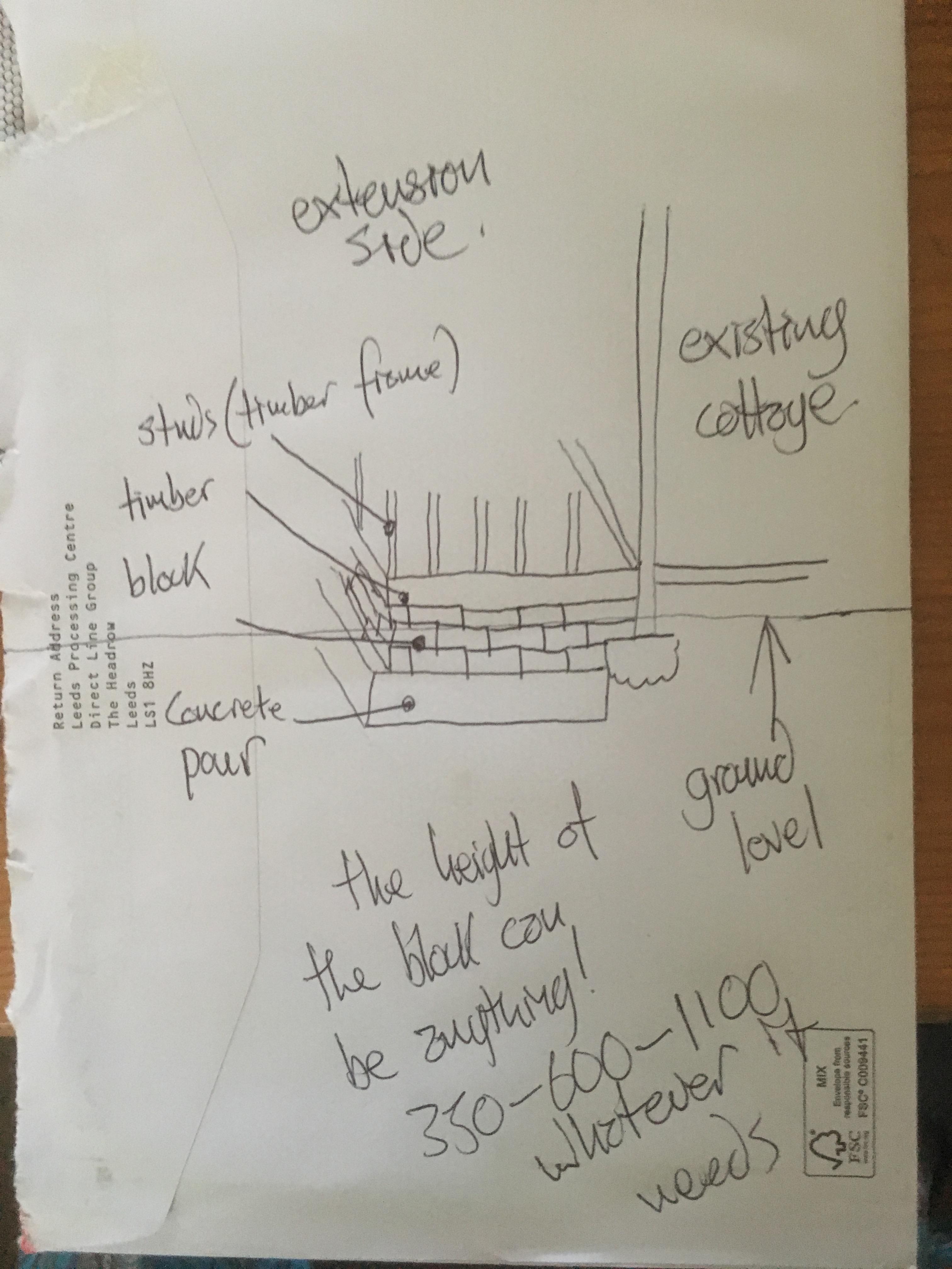

Tennentslager Posted October 17, 2019 Share Posted October 17, 2019 Not being funny but maybe you don’t know what’s planned to come next and you are over thinking and getting in a panic heres a back of an envelope sketch that shows one possibility of how it could work i don’t think the trench you see will remain like this, it will all be back filled 1 Link to comment Share on other sites More sharing options...
andyscotland Posted October 17, 2019 Share Posted October 17, 2019 15 minutes ago, zoothorn said: Can someone tell me what usually happens on a typical groundwork ground floor for an extention. Just a standard build. I get the 2x 9" block perimeter ontop of the moat of founds. This I understand. Its between this work & the FFL.. can someone please tell me the typical layers to expect. One of the layers is 100mm polystyrene. This I understand (but where its to be found I do not). It completely depends. There are lots of different "standard builds". The insulation can be below or above the slab. If it is above the slab, it's not always considered part of the groundworks and it's not uncommon to build the shell first, get a roof on, then do insulation and screed later rather than get it all wet and ruined. Again, you are asking us to guess what might be happening, and forming your own definite opinions and midnight certainties based on "clues" like one trade apparently being finished on site, but it is entirely possible you are misinterpreting all of this. And no amount of us telling you the variety of things it might be is, at this stage, going to help you establish what it actually is. Draw a line on the wall for the FFL you want, then talk to your builder (and from a point of "I'm confused, have I misunderstood?" not "your groundworks guy is obviously a fkn idiot and got this totally wrong, how are you going to fix it"). Link to comment Share on other sites More sharing options...

zoothorn Posted October 17, 2019 Author Share Posted October 17, 2019 8 minutes ago, jamiehamy said: Okay - as I say, it's only my view for consideration. I'm trying to find some stuff I drew for my floor build up - we built on our own but I did some drawings to make sure I had it right - shows the full build up from beams, insulation, screed etc. If I can I'll post, it should be helpful. Thank you Jamie, but Full Plans are A) not what I did/ was expected to do/ or asked by builder1 to do, B) I had a set given to me by builder1 to go by anyway I still have them & I went by them too, to draw up my condensed/ simplified 'Build Notice' he asked for, C) its too late now. On these Full Plans, the existing floor levels within the main house are designated -only- by broken lines, without even labels saying "existing floor level" so the assumption was to me (& never questioned by builder1 or said 'what's that line?' in fact to the contrary I asked him if he understood the broken lines to be clear indication of existing floor levels? "yes") that broken lines indicate existing floor levels. I remain of the opinion, in this build & from the very plans HE gave me to then work from.. this to be simply the case. Link to comment Share on other sites More sharing options...

ToughButterCup Posted October 17, 2019 Share Posted October 17, 2019 @zoothorn, have you read @Russell griffiths post? Re-posted (reformatted) here [...] [...] mark on the wall finished floor height, not a dot or a mark on the render, a [...] straight line. get builder on site and ask him how he [...] will get your floor up to [the marked] height Outcome 1. builder agrees to get floor to [the marked] height at his cost, [...] Outcome 2. He tells you it’s your fault and he won’t do anything, [and then] pay him for his time so far [...], get another builder. [...] and then follow @jamiehamy's advice above. 1 Link to comment Share on other sites More sharing options...
jfb Posted October 17, 2019 Share Posted October 17, 2019 Zoothorn - i have tried to read this whole thread but it is hard to see the whole picture. I'll only ask this. Have you spray painted the FFL you want on the existing building yet? If not is that because you aren't sure where the FFL level is because of how the foundations have gone? Because in my mind that is a bit of very useful advice that has been offered on this thread repeatedly but at no time have I seen you come back and say you have done it. Link to comment Share on other sites More sharing options...

zoothorn Posted October 17, 2019 Author Share Posted October 17, 2019 I just spoke to my nice BCO. Thank goodness he's approachable & friendly (if I had the other chap..). Ok now he doesn't have my plans (no need to), so cannot concur with me about reason for 350mm extra D. Ok understood. What he did say was insulation is yet to be added, & that either chipboard or scree top. So, 100mm of insulation + 25mm of top. It matters not a fart for this conversation what materials used. It only matters that ontop of my 2x 9" blocks.. will be ONLY an inch or two max. So my 350mm extra is a certainty as to its an error. So I need to approach my builder1. Very tricky. He reassured my slightly with regard to my main concern the area of exposed ground below adjacent orig wall footings.. but only slightly. He said ideally it does need covering (I fkn did this last night as best i could/ pretty much all still exposed), but can be 'blocked' up later to sure it up. Even the word 'underpinned' he used which sends shivers down me re. cost. Still it remains that a whole 1ft x 6 yds area of ground bang next to shallow 1830 founds has been unneccessarily excavated due to builder2 error. Fact. I'm furious & this aint the frame of mind to tackle my builder, especially if even I put my concern that a mistake's been made timidly, he'll shut up shop & leave me in the lurch for weeks with this exposed area so vulnerable. So I have a battle. And this is appalling situation to be in at such an early stage. Link to comment Share on other sites More sharing options...

redtop Posted October 17, 2019 Share Posted October 17, 2019 please send us a photo of the wall painted with a FFL line. Then if its higher than the builder expected because they added up wrong a simple extra block course and some thicker insulation will easily make up the difference Link to comment Share on other sites More sharing options...

zoothorn Posted October 17, 2019 Author Share Posted October 17, 2019 2 minutes ago, redtop said: please send us a photo of the wall painted with a FFL line. Then if its higher than the builder expected because they added up wrong a simple extra block course and some thicker insulation will easily make up the difference That's perfectlu reasonable as to a suggestion, but it doesn't address any of the main problems. The internal H now is irrelevant in terms of a problem. The exposed old area, the trench dug around, the height of the top of the 2x 9" block as it is relative to adjacent ground all -cannot- be remedied by this. Only if another block course + concrete pour to remedy the situation, could some of these be addressed. My builder will no way on earth do this by 1st agreeing that its an error (bc he's decades of experience knowing how to play such an argument, knowing full well already that a mistake has been made so expecting the conversation/ primed rready with ab or c excuse, playing it that no not them but rather IM fully responsible.. just like some on here seem unfathomably to think). Its an asbsolute disgrace. Link to comment Share on other sites More sharing options...
