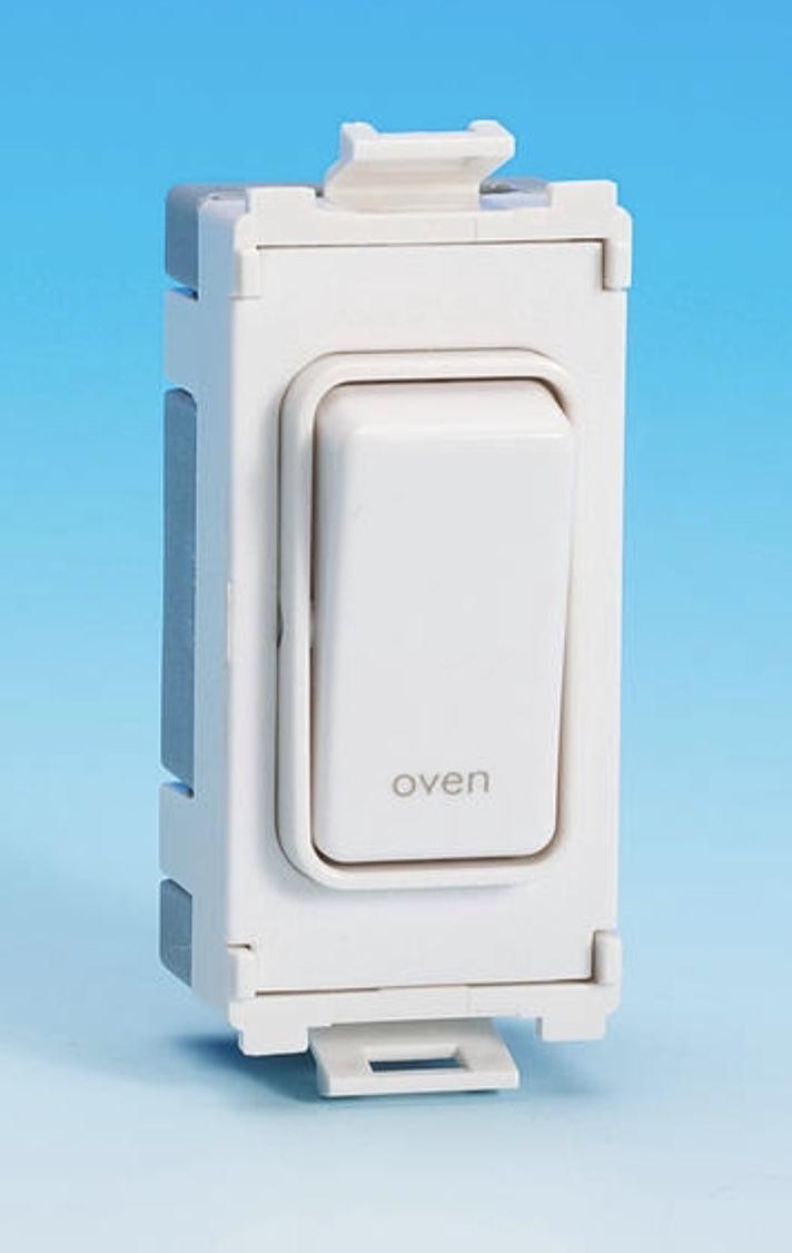

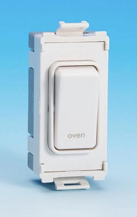

ToughButterCup Posted October 8, 2019 Author Posted October 8, 2019 14 minutes ago, Onoff said: Grid switches on a plate. Ahhhh! 15 minutes ago, jack said: Is there an adjacent room you can bung them all in? Yes. 15 minutes ago, PeterW said: Grid switch in a larder cupboard with 20A marked Schneider switches, all run to either the dedicated socket they manage or a spur for stuff such as ovens.[...] I suppose 20Amp Scolmore Click Modes will do? Like this, but on a 4 Gang (Dishwasher, Oven, Hob, Extractor) yoke and plate
PeterW Posted October 8, 2019 Posted October 8, 2019 @AnonymousBosch I’ll take a photo but it’s made up of these https://www.tlc-direct.co.uk/Manufacturers/Schneider_Ultimate/Ulimate_Grid_White/index.html The Scolmore ones are the same - from memory it’s : Oven Oven Fridge Freezer Microwave Dishwasher Fan (boosts the MVHR) Sparky hated me as it was in the back of a larder unit so he had 12 cables to fight with .... all in a confined space ..!! Looks good now it’s done though ..!

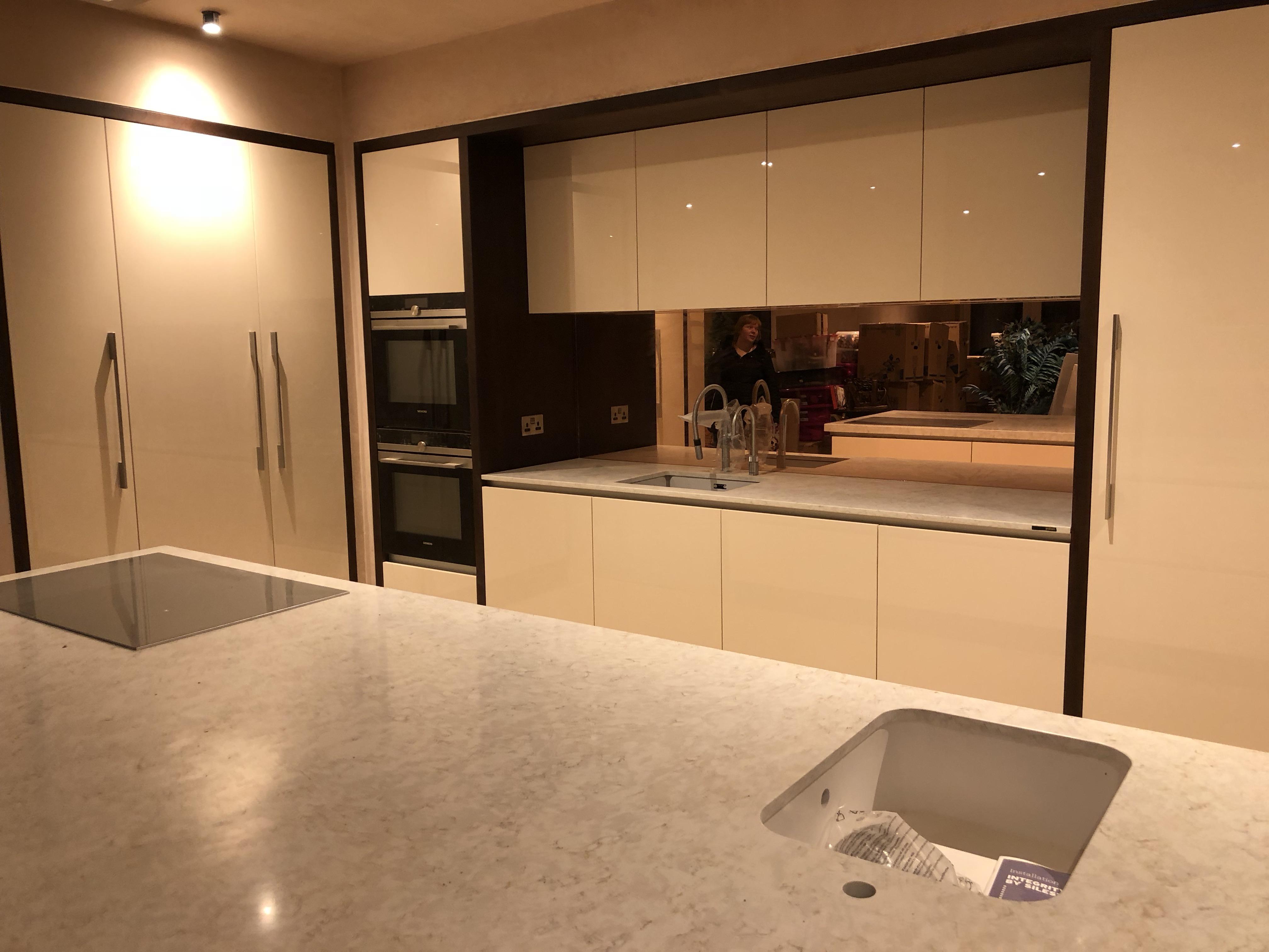

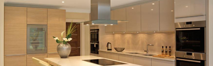

AliG Posted October 8, 2019 Posted October 8, 2019 (edited) I hate the idea of putting switches in my lovely clean glass splashback so I had the switches put in the carcus of the cabinets at each end of the row (the sides of the ovens above). This also makes the switches a lot less obvious when looking at the kitchen and makes the splashback easier to install. In general, unless they had to be in a specific place, I tried to install switches in rooms where they could not be seen, e.g. on the far side of a chimney breast seen when you enter the room. Our isolators are all in the back of a larder cupboard in the main kitchen, but in other places they are too high up to reach without a step/stool. The big multigrid switches or even worse heavy duty hob/oven switches that we used to have are something I would rather not have on display. As mentioned using the main board is probably easier to use anyway, the ovens etc are clearly marked, but this is a good point for my parents' house if/when we get permission. Edited October 8, 2019 by AliG 1

ToughButterCup Posted October 8, 2019 Author Posted October 8, 2019 6 hours ago, SteamyTea said: If you put isolators in a cupboard, how will anyone find them when they are needed?[...] Yes. Like this .... 7 hours ago, AliG said: [...] so I had the switches put in the cacass of the cabinets at each end of the row (the sides of the ovens above). [...] Tops! @AliG ! SWMBO wants ......... (No more photographs OK?)? 1
Barney12 Posted October 8, 2019 Posted October 8, 2019 Just like @AliG there was no way I was having switch acne in my shiny new kitchen. Rather than hiding them at the back of a cupboard I created a panel inside a tall cupboard (at the top). This does compromise a bit of shelf space but makes them very accessible for when there is the need for isolation after someone’s got their head stuck in the dishwasher ?.
