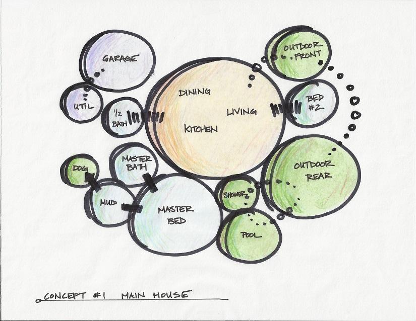

Speaking as an architect, I'd very much agree with this. I can see an awful lot of individual trees there, but I'm not seeing a good idea of your forest, and it could take a lot of conceptual design work (hence cost) to find it for you.
Also, architects tend to think visually. A great deal of what you've tabulated on that spreadsheet could be distilled into a bubble diagram that shows how the spaces should relate to each other. My first step, if presented with your spreadsheet, would be to do just that - but it would take me several hours (£££) to do so, before I was even ready to move on to initial conceptual design, and you could save me the trouble, and yourself the cost, by doing the bubble diagram for me... and it might help clarify things in your own mind too.:
That'a super helpful. As I said earlier I think I lack the awareness of such tools to clarify things.. this helps a ton. Any other ways to 'sketch the forest' you reccommend?
One fact is that we don't truly have an idea of what we want connected to what, we figured that was the Arch's job to optimize? No?

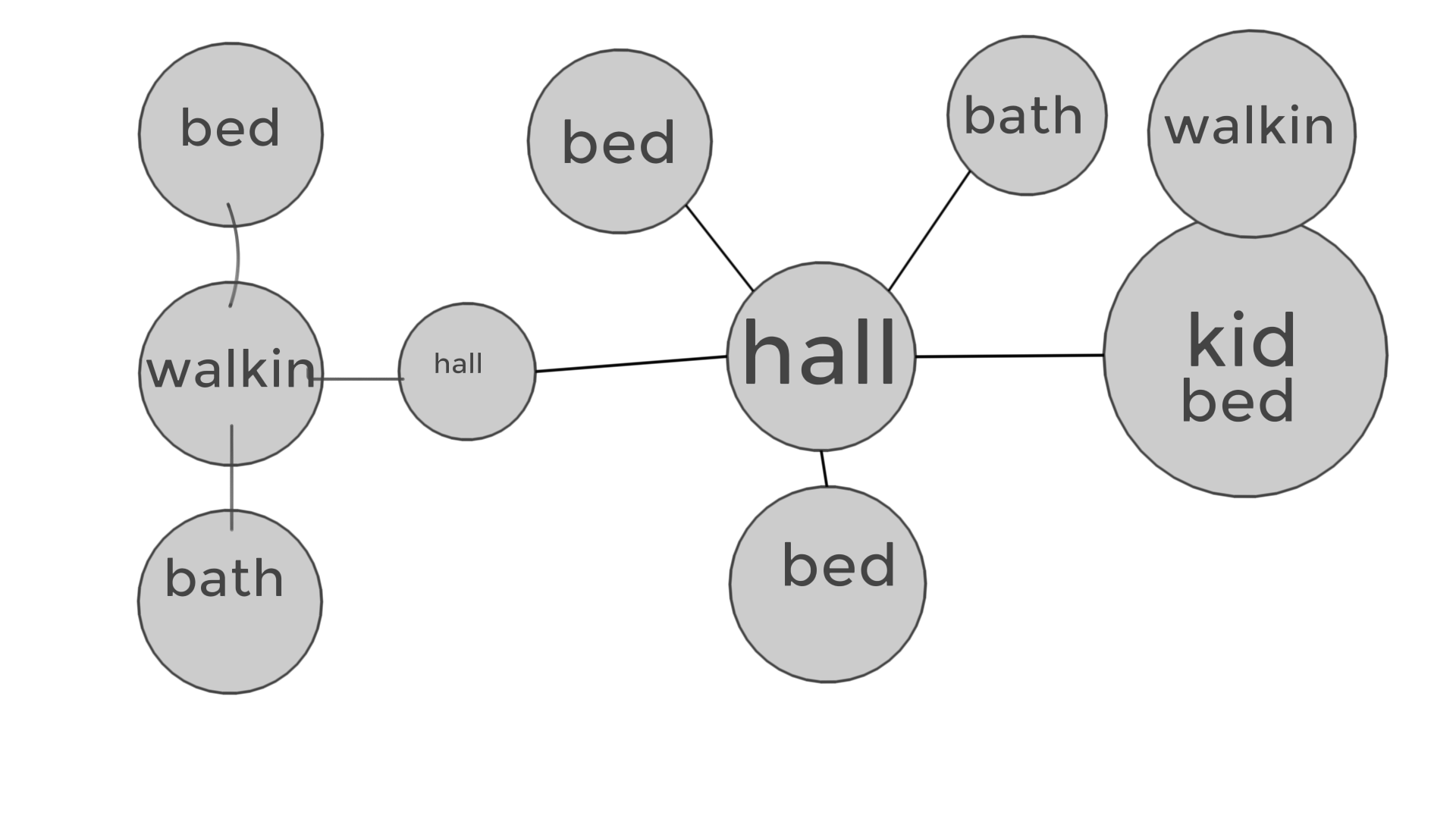

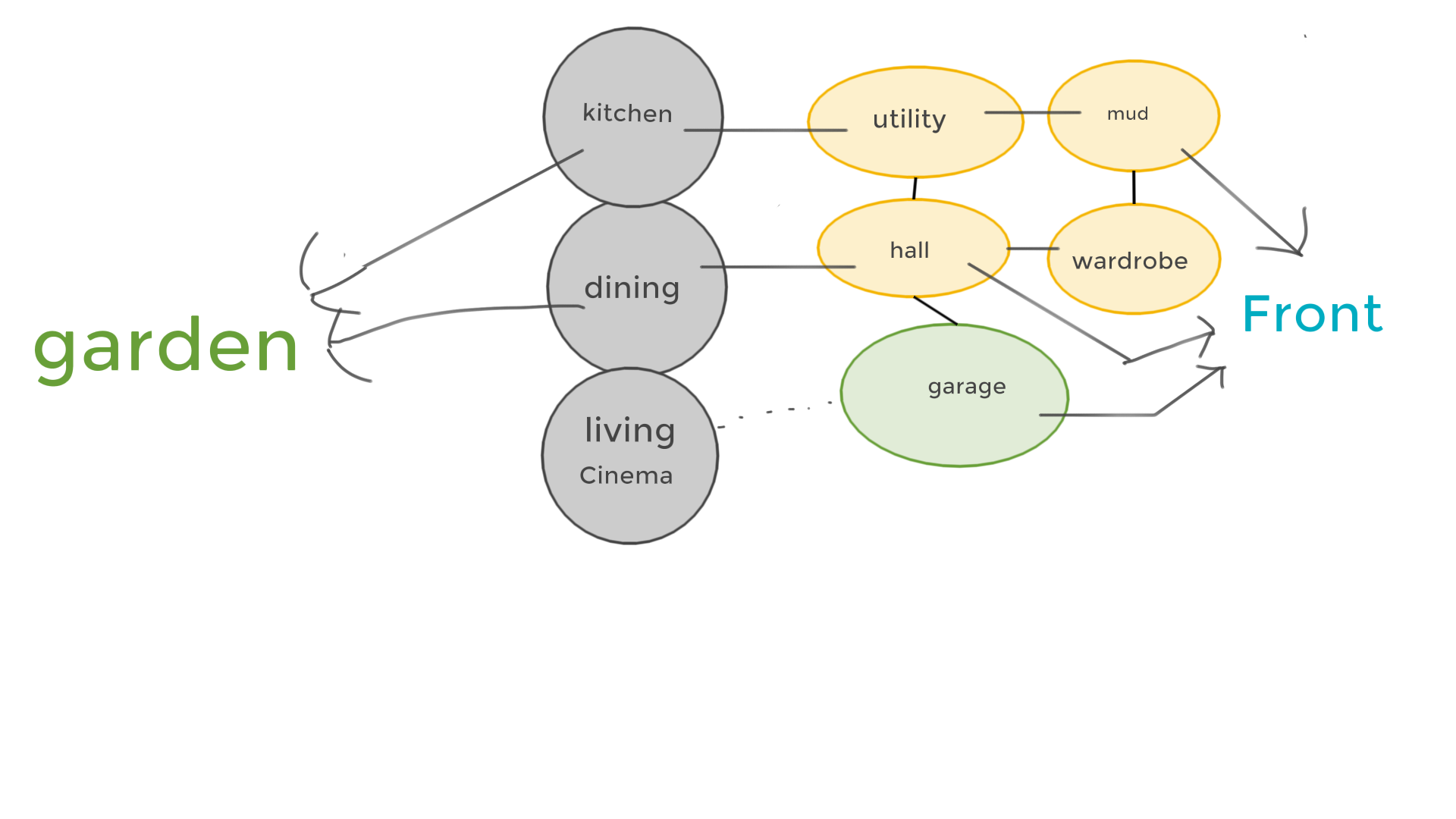

You're not wrong but that's exactly what we wanted to do - set only the guardrails - we tried to be as specific as we could on things we value, but left as much as we could up to the artist, for example the shape and size of the rooms are completely open. As @Sensus suggested, the graph is great to have, but I'm not sure we should be the ones creating it.
More in particular, perhaps I'm wrong but part of the Architect skillset is understanding how often people need to go from room A to room B and under what circumstances etc, versus for example the benefits and downsides of having a walk-in closet vs a bigger bedroom etc.
Anyway I did sketch suchlike now, but I'm not quite sure this is just my idea vs if this really is not the remit of the artist?
