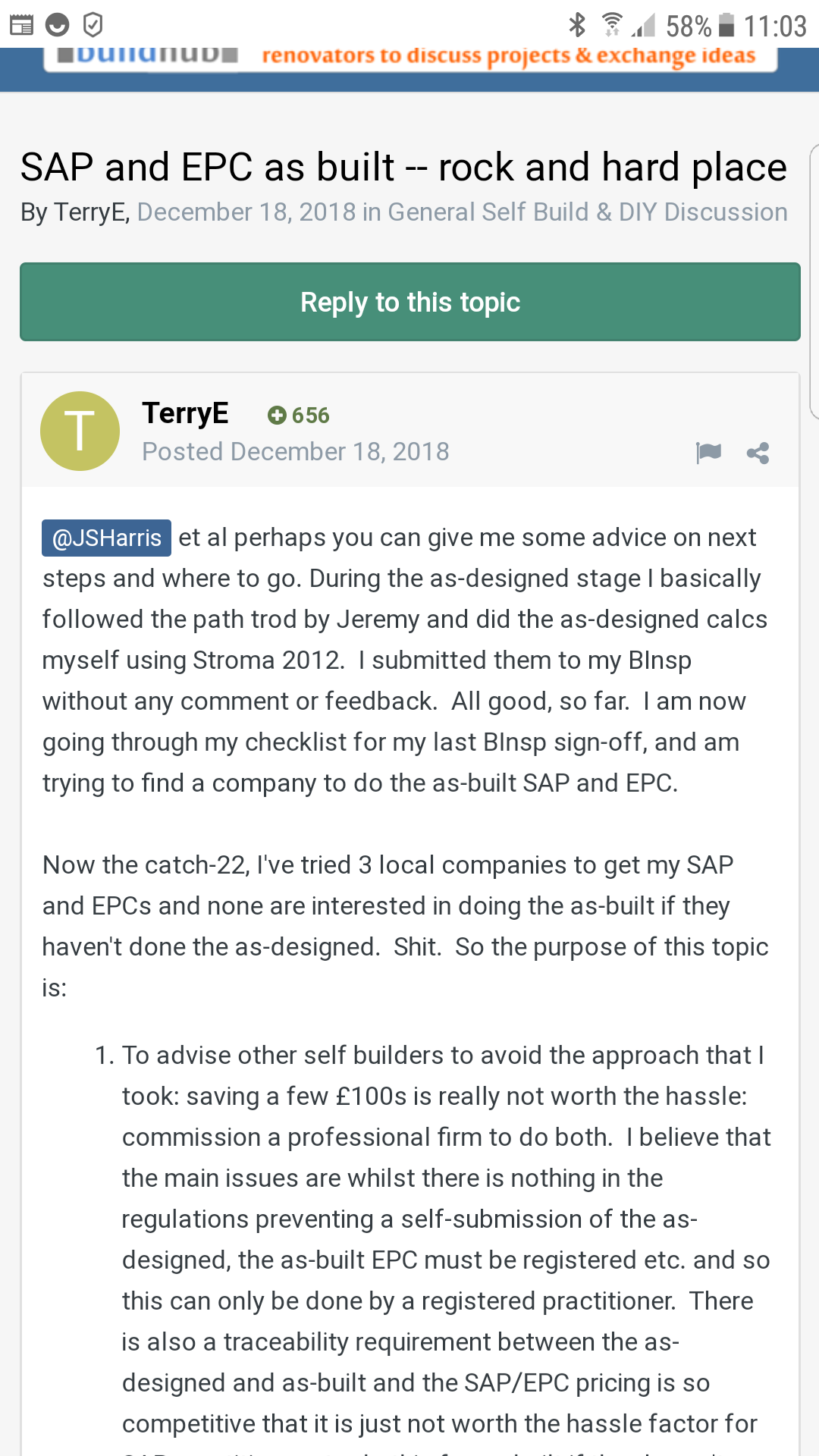

LA3222 Posted September 20, 2019 Posted September 20, 2019 I may be misremembering but iirc I am sure I read somewhere on this thread that a member who had done the design SAP their self was having dramas finding a professional to do/lodge the as built SAP as they weren't willing to do that without having done the first bit - I'm sure it was one of the long time members who had this issue??? I have it in my head that there is no point doing the design SAP yourself however easy due to the later problem this creates. In the grand scheme of things SAP reports aren't particularly expensive regardless of how we all feel about whether they are worth the paper they are written on.
Jeremy Harris Posted September 21, 2019 Posted September 21, 2019 We had no problem doing this. I used the free version of the Stroma FSAP software to check the design and produce the design stage assessment, and I just updated this to reflect the as-built changes and emailed the file to an assessor who checked my work, produced the as-built assessment, lodged it on the database etc. The fee for the as-built only work was modest, about £100 plus VAT. There's no requirement for an assessor to do the design stage assessment, I get the feeling from chatting to BC that it's primarily a sensible check done at the start to be confident that the design meets or exceeds the requirements, so really an assurance tool (albeit a very important one). Nothing happens to the design stage assessment, it doesn't get filed or lodged on a database anywhere, as fas as I'm aware. It's only the as-built assessment that has to be done by a registered assessor and lodged on the database as a record of the performance of the house when it was completed. The big advantage of doing the design stage assessment yourself is that you get to learn a fair bit about how SAP works, what makes a significant difference to the outcome, and what doesn't have much impact. That makes it a really worthwhile exercise, as it's usually relatively painless to change a few things at the design stage, whereas that may not be the case later on in the build. 1

LA3222 Posted September 21, 2019 Posted September 21, 2019 (edited) 1 hour ago, JSHarris said: We had no problem doing this. I know you had no problem doing this Jeremy, I have read numerous threads where you have talked about it. It's all well and good telling people how you did things and how it all worked for you but there is then the danger you are giving them a bum steer and putting them onto the path to future problems. I did a Google search and found the thread but don't know how to link it - it was @TerryE who had the problems getting the final bit done after doing the initial bit himself. Quote from the thread I refer to: " So the purpose of this topic is: To advise other self builders to avoid the approach that I took: saving a few £100s is really not worth the hassle: commission a professional firm to do both. " I think you should maybe have a bit more caution and caveat the advice you give Jeremy, as due to the fact you are clearly very competent, people may just take it as gospel and assume what worked for you (a few years ago now too) will also work for them. Edited September 21, 2019 by LA3222 To add quote in and clarify they are not my words! 1
Patrick Posted September 21, 2019 Author Posted September 21, 2019 32 minutes ago, LA3222 said: So the purpose of this topic is: To advise other self builders to avoid the approach that I took: saving a few £100s is really not worth the hassle: commission a professional firm to do both. I think everyone should be treated as adults here, so giving advise doesn't eliminate using ones own brain (does this advise apply to me). The PURPOSE of THIS THREAD was To find alternative programmes for SAP calculation for anyone interested to do it him/herself. Your advise of hiring professionals instead of saving "a few 100£" applies to pretty much everything in life. do you get your brake pads changed at the garage or do you do it yourself. Do you buy package holiday or do you organise every step yourself...... It is a matter of opinion when it s worth it to hire professionals and when you should (can get away with) do it yourself. I'm on Jeremy's side with doing as much as possible myself. You think it is better to have professionals doing jobs for you. None of these opinions are "the truth", so being careful voicing an opinion seems a silly advice. 1
LA3222 Posted September 21, 2019 Posted September 21, 2019 7 minutes ago, Patrick said: I think everyone should be treated as adults here, so giving advise doesn't eliminate using ones own brain (does this advise apply to me). The PURPOSE of THIS THREAD was To find alternative programmes for SAP calculation for anyone interested to do it him/herself. Your advise of hiring professionals instead of saving "a few 100£" applies to pretty much everything in life. do you get your brake pads changed at the garage or do you do it yourself. Do you buy package holiday or do you organise every step yourself...... It is a matter of opinion when it s worth it to hire professionals and when you should (can get away with) do it yourself. I'm on Jeremy's side with doing as much as possible myself. You think it is better to have professionals doing jobs for you. None of these opinions are "the truth", so being careful voicing an opinion seems a silly advice. Regardless of the 'purpose' of the thread @Patrick It, like many many other threads on here has evolved from the original content and for future readers my comments very much apply. I have read 90% of this forum now and am currently working through Windows - I am reading threads from 2016. Without a shadow of a doubt people will read this thread 4,5 yrs down the line and take advice from it. Therefore a balanced view should be presented. Secondly, the quote you ascribe to me is one I ripped from the thread I mention in that comment - it wasn't said by me, rather it was a long standing contributor to this forum who used those words.
