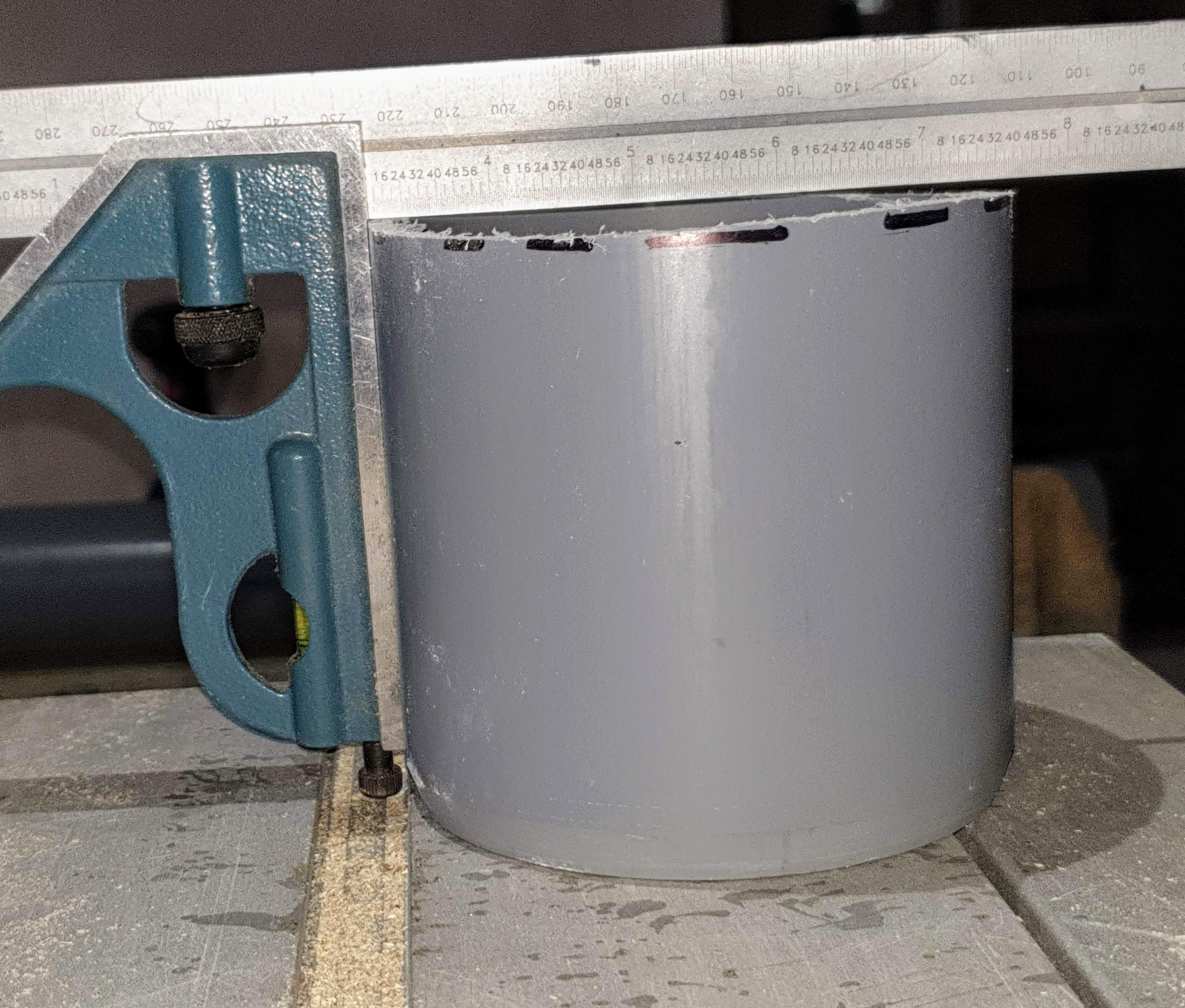

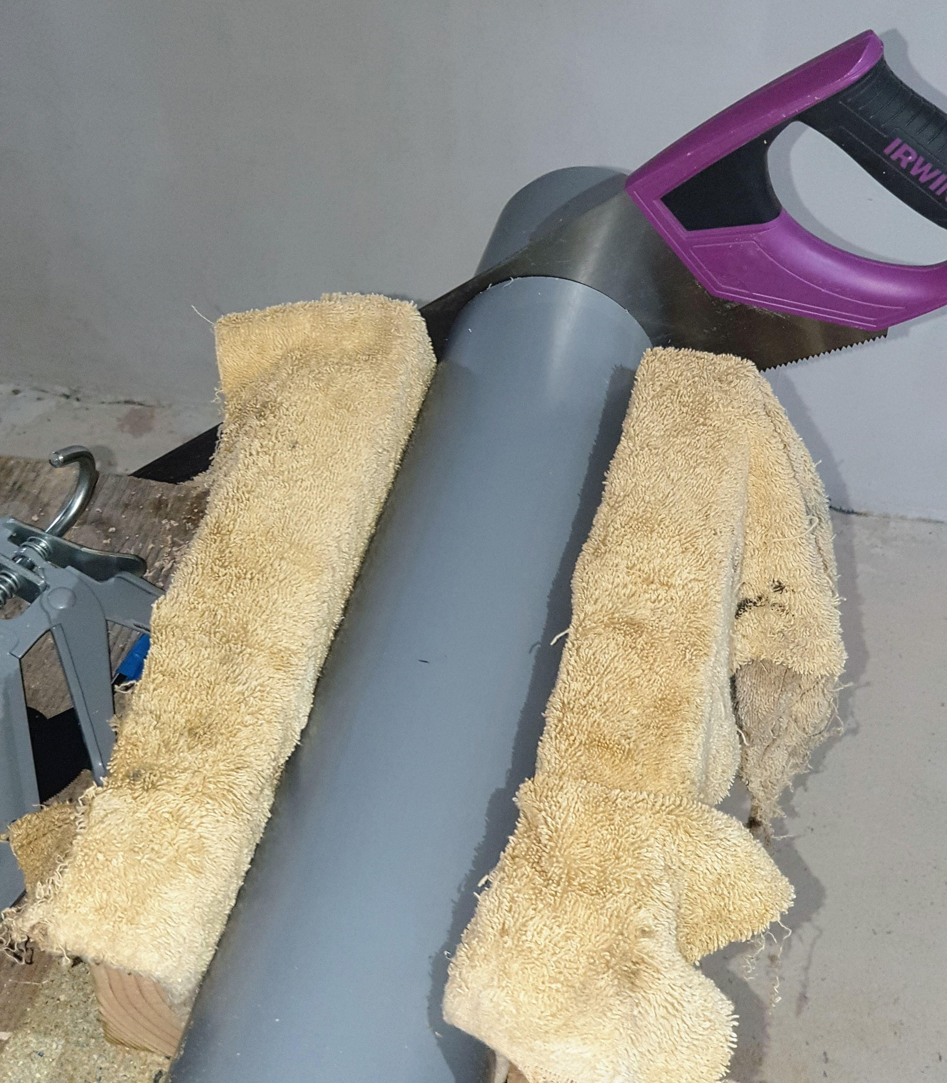

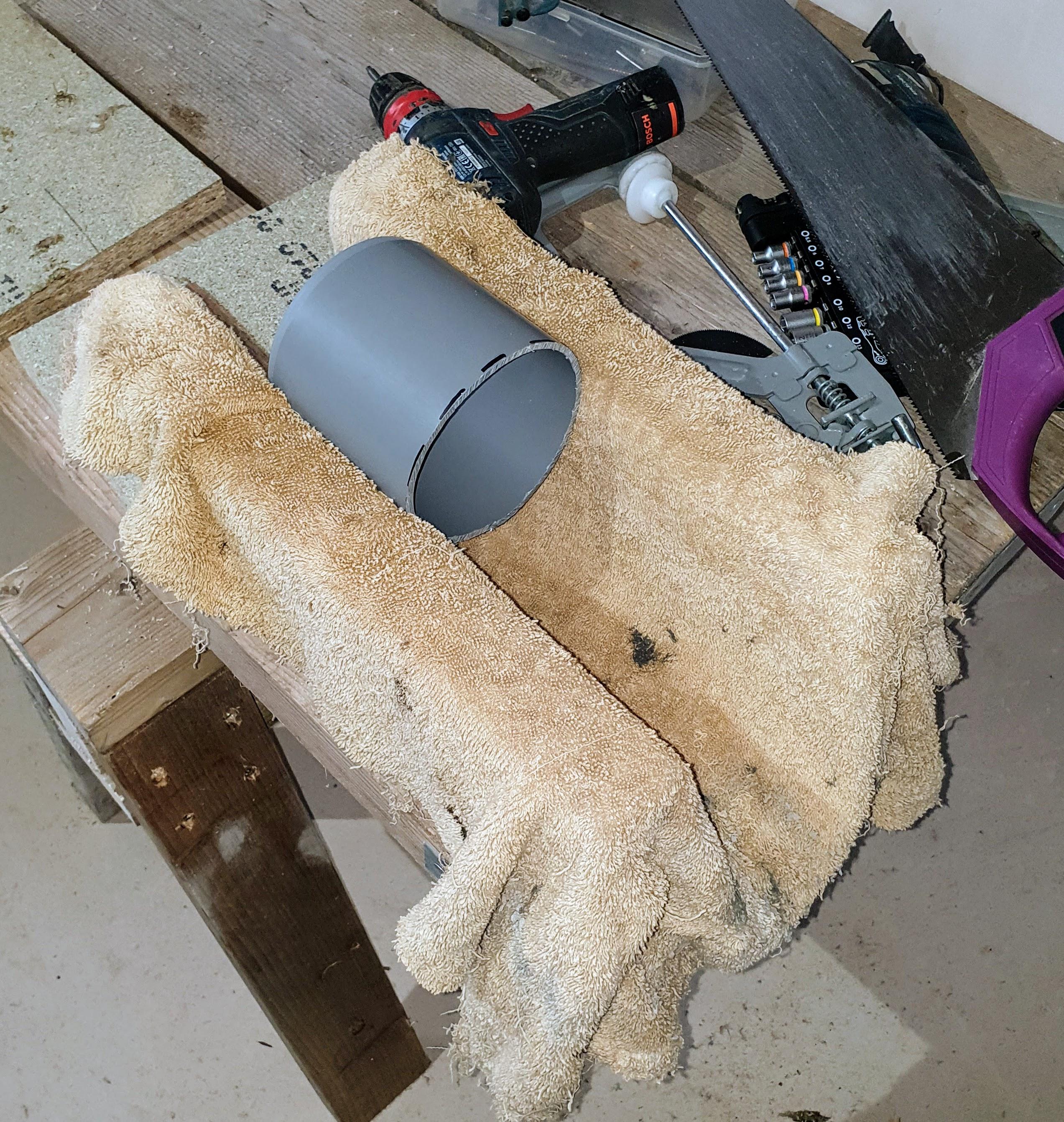

ToughButterCup Posted September 2, 2019 Posted September 2, 2019 My hands aren't what they used to be; so in cutting 110 soil pipe, I need to make some sort of jig to hold it. I came up with this jig - and I'm hoping some of the nerd herd ( @Onoff's term not mine -but it's a good one) who have done this task a lot will put me right. Two bits of 4 by 2 a little over 110 mm apart, fixed to a bit of 9 by 2. That in turn is screwed to the bench top (a scaffold board). It's a bit wider than 110 to allow me to grip the pipe so it doesn't turn. My hands just won't / haven't got enough 'spread' or power to grip the pipe any more. This is the jig The old dressing gown enables the pipe to be gripped a bit ... But this is the wobbly result .... maybe a different type of saw would help? I suppose I could file the end smooth and square - I was very tempted to put the pipe through the crosscut saw: cowardice or caution -- not sure which stopped me.

Russell griffiths Posted September 2, 2019 Posted September 2, 2019 Use a fine tooth saw used for cutting laminate flooring, very sharp and fine, then use the pipe end bevelling tool to smooth end, look up my topic on it, or use a flap disc in an angle grinder. 1
joe90 Posted September 2, 2019 Posted September 2, 2019 Yes after nearly losing my thumb (don’t ask) I have a lot less grip. The jig is good, my only comment is make the 2x4 , 2x5 and cut a square slot in it (like a mitre block) to get a square cut and line it with rubber mat to grip the pipe. 1
Russell griffiths Posted September 2, 2019 Posted September 2, 2019 (edited) If you cut an off cut of pipe neatly, then cut a slot in it you can use this as a template to mark a neat line all around it. Not it sure that makes sense, cut a piece of pipe 100mm long, then split it with a cut up its length so it is springy, you can then spread it and slide it over your other pipe and use it as a template, hope that makes sense. Or or else do as Declan said and use a 1mm disc in the grinder. Edited September 2, 2019 by Russell griffiths 2
Onoff Posted September 2, 2019 Posted September 2, 2019 Buy a soil pipe wall bracket and clamp it on. Use that as a guide for your handsaw. Or keep an offcut of pipe with a split and use that to draw around or as a guide for your multi tool. Like I did on this pipe to cover the water meter: Or use a mitre block (& Bacho saw). This is the £4.99 block from Screwfix: Use 4 bits of 4"x2", cut dead square. 2 each side, set the saw blade width apart.
