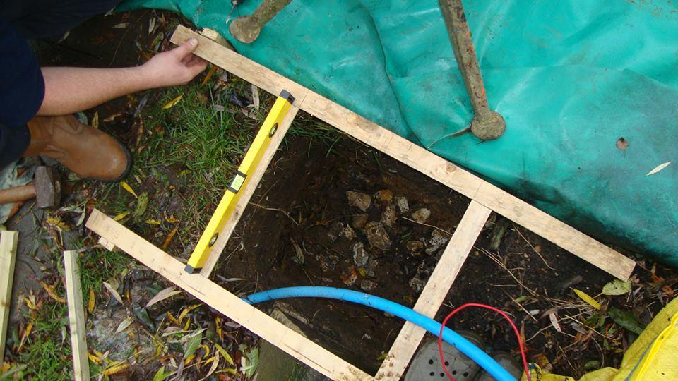

PeterW Posted August 25, 2019 Share Posted August 25, 2019 If they need anything it will be shuttering around the tops which you can make from a £1 B&Q (other retailers are available) black bucket. Take the handle off , turn it upside down and use a jigsaw to cut the bottom out around the base ring. Now set it where you want the top of the post, dig it in and level it and just build up soil around to hold in place. Now do a a 4:1 wettish mix, tip into the “bucket form” and tamp it as you go with a bit of timber. Smooth over the top and let it go off for a couple of days. Then it’s just a case of pull the soil back and lift off the bucket and you have a nice neat cast top. Link to comment Share on other sites More sharing options...
Onoff Posted August 25, 2019 Share Posted August 25, 2019 (edited) If your soil is firm enough and you can dig a hole accurately enough size wise then the soil sides will contain the concrete. Go oversize with your hole of course and you might underestimate your quantities. My brother hand dug a hole for his astronomy pier about 3 feet deep and I reckon it was near perfectly square. That's in clay though. Stems from digging holes in the Army I imagine! Edited August 25, 2019 by Onoff Link to comment Share on other sites More sharing options...
