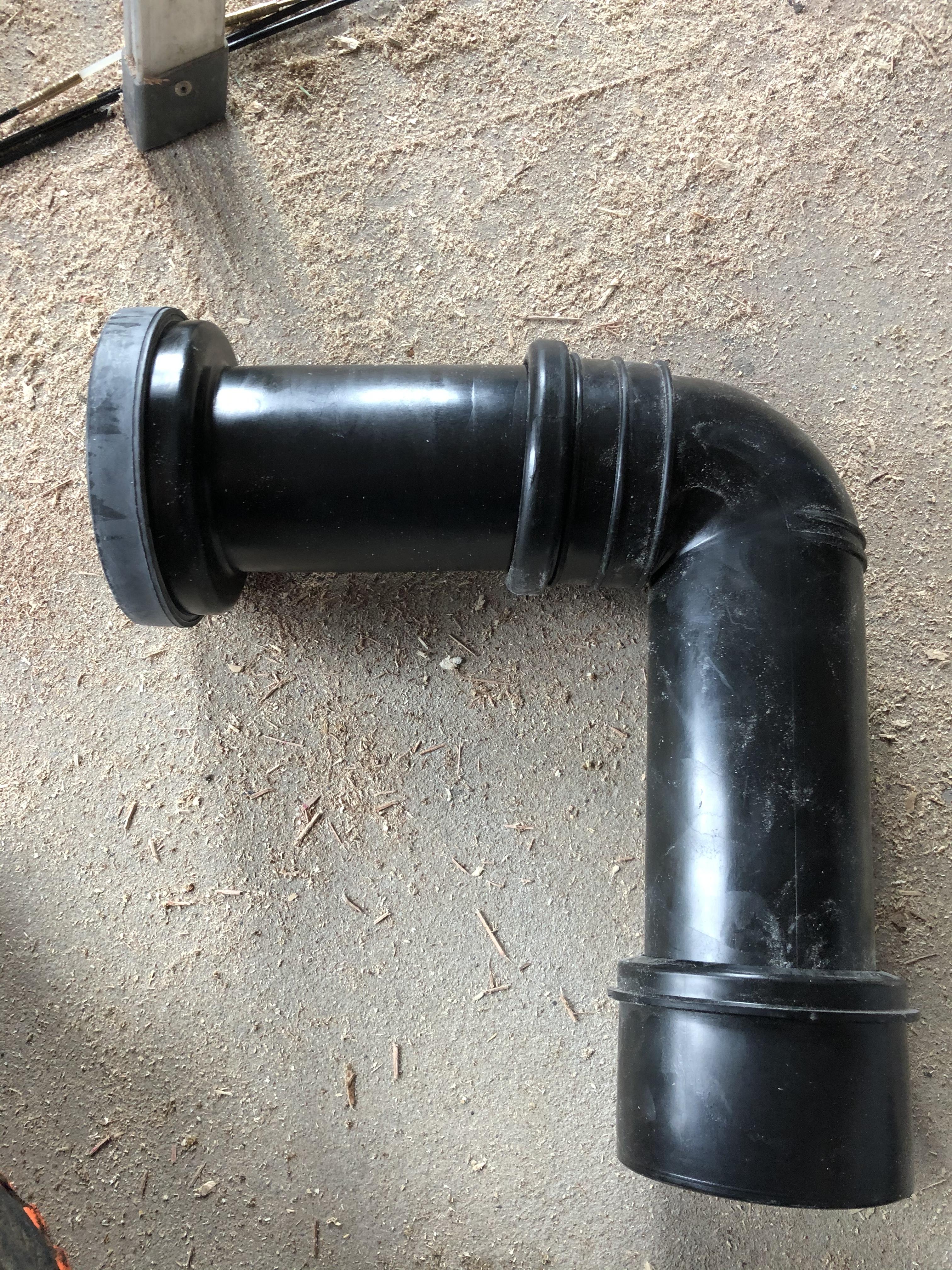

I think it’ll go !
Am I correct on the underside I just glue a 3” ( or whatever the geberit pipe size is ) onto it vertically -that’s it ?
Posted (edited)
42 minutes ago, pocster said:
I think it’ll go !
Erm... that black elbow isn't glueable type pvc (I don't think). It's HDPE.
The elbow goes into an adapter that comes with the Geberit then that push fits into a 110mm female.
The 3 black fittings are all Geberit:

Maybe these if you need to extend the pipe without making the slab/beam hole too much bigger:
Geberit 366.887.16.1 Hdpe Straight Connector
£21.48
Tax included
Geberit 366.887.16.1 HDPE Straight Connector
  • 90mm - 90mm
  • Ring seal socket
Or
Geberit 367.887.16.1 Hdpe Straight Connector
£21.48
Tax included
Geberit 367.887.16.1 HDPE Straight Connector
  • 90mm - 110mm
  • Ring seal socket
  • As used with Geberit WC frames
Edited by Onoff

Mega helpful !
I was deliberately being thick ! ?
I’ll check the parts in the kit tomorrow.
I just grabbed the elbow because it looked right . Will report back soon !

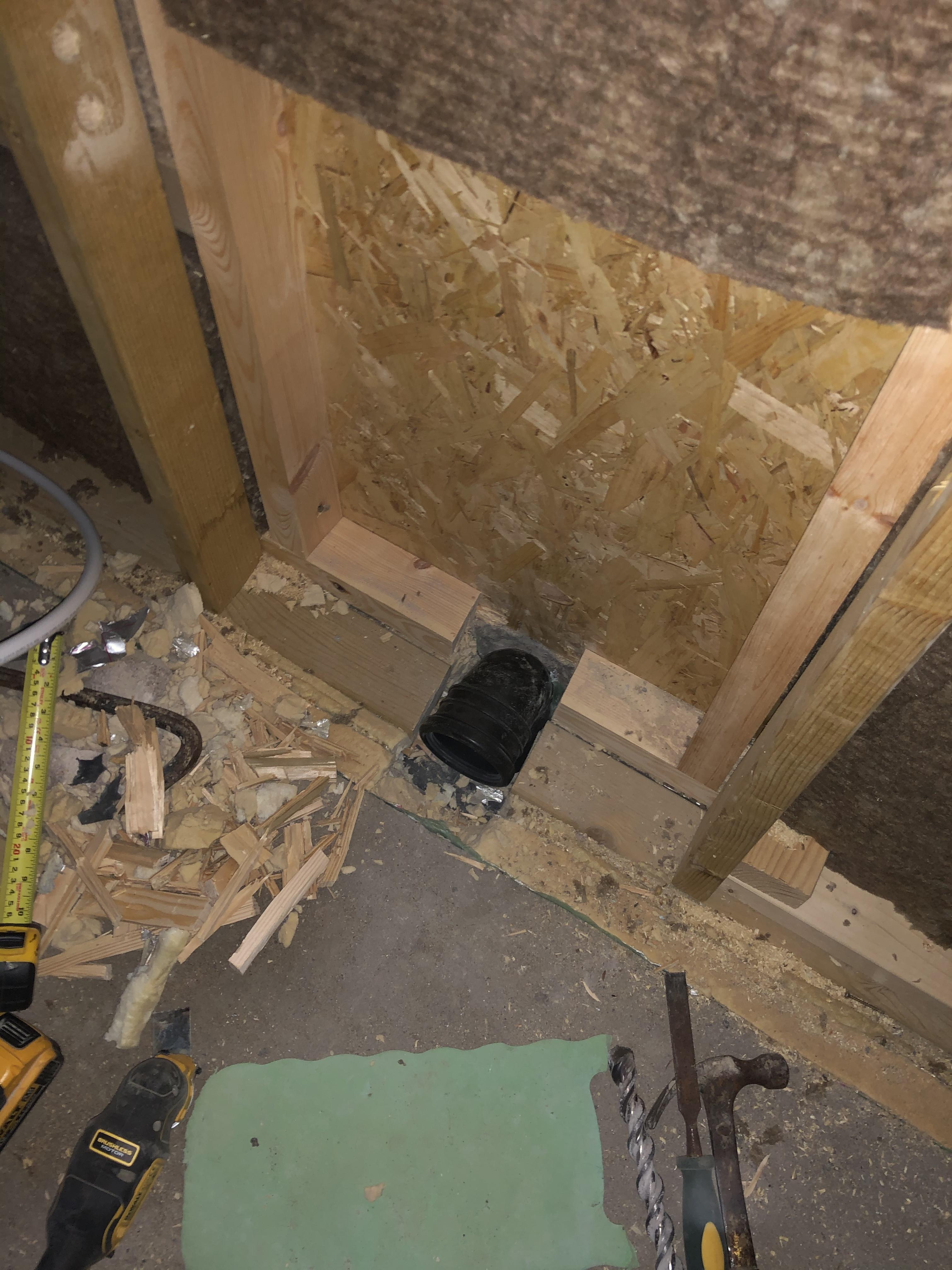

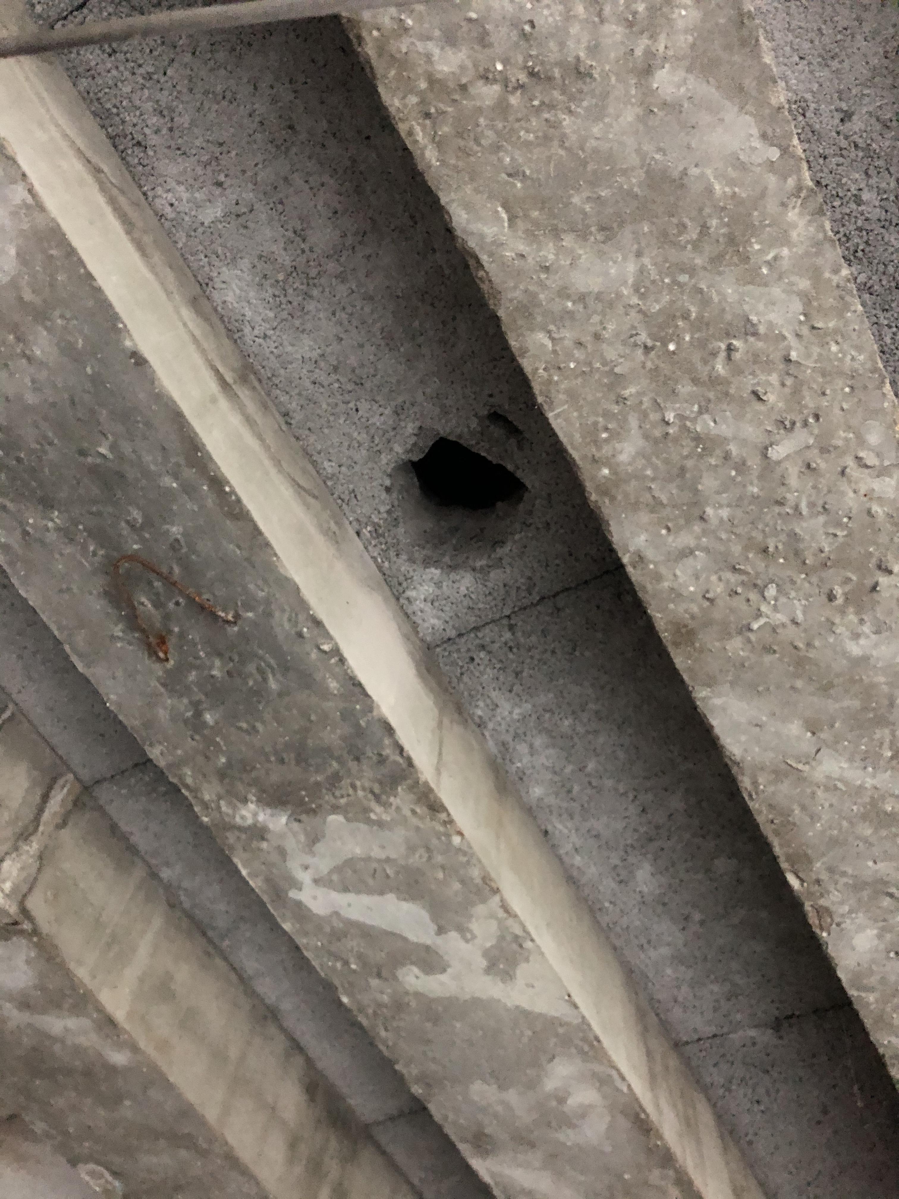

I do indeed !
So need to extend my vertical with one of those you link to . 90 degree tee then push fitted on that ( below ceiling )
@Onoff you may not know the answer but assuming I run the brown ( standard ) soil pipe fitting to my main ceiling suspended drain - do I use all push fittings ?
What about shower / bath waste ? Assume that was all the glued white plastic . Does that need a glued boss strap on the main drain ? Or everything into the main ceiling drain all push fit ?
Edited by pocster

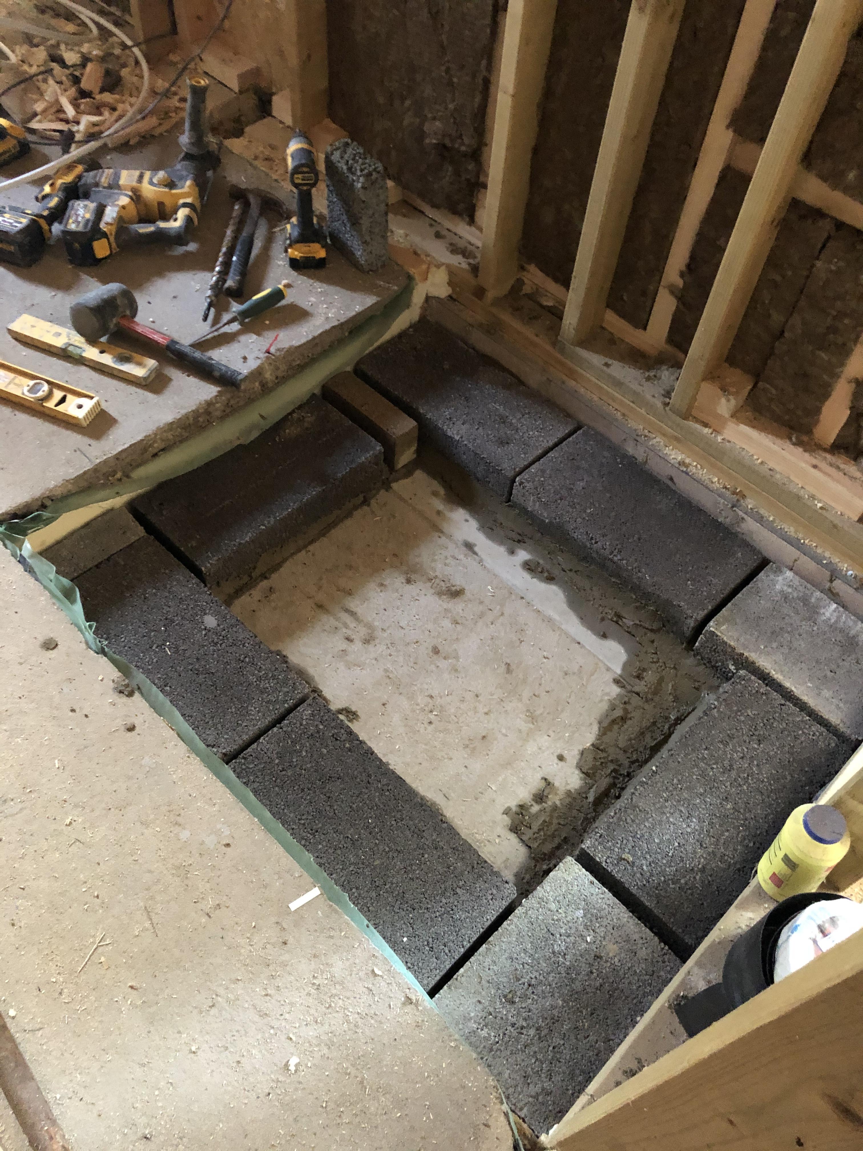

Shower concrete block support
Probably put an extra block across the middle for support once I know where the shower waste is going

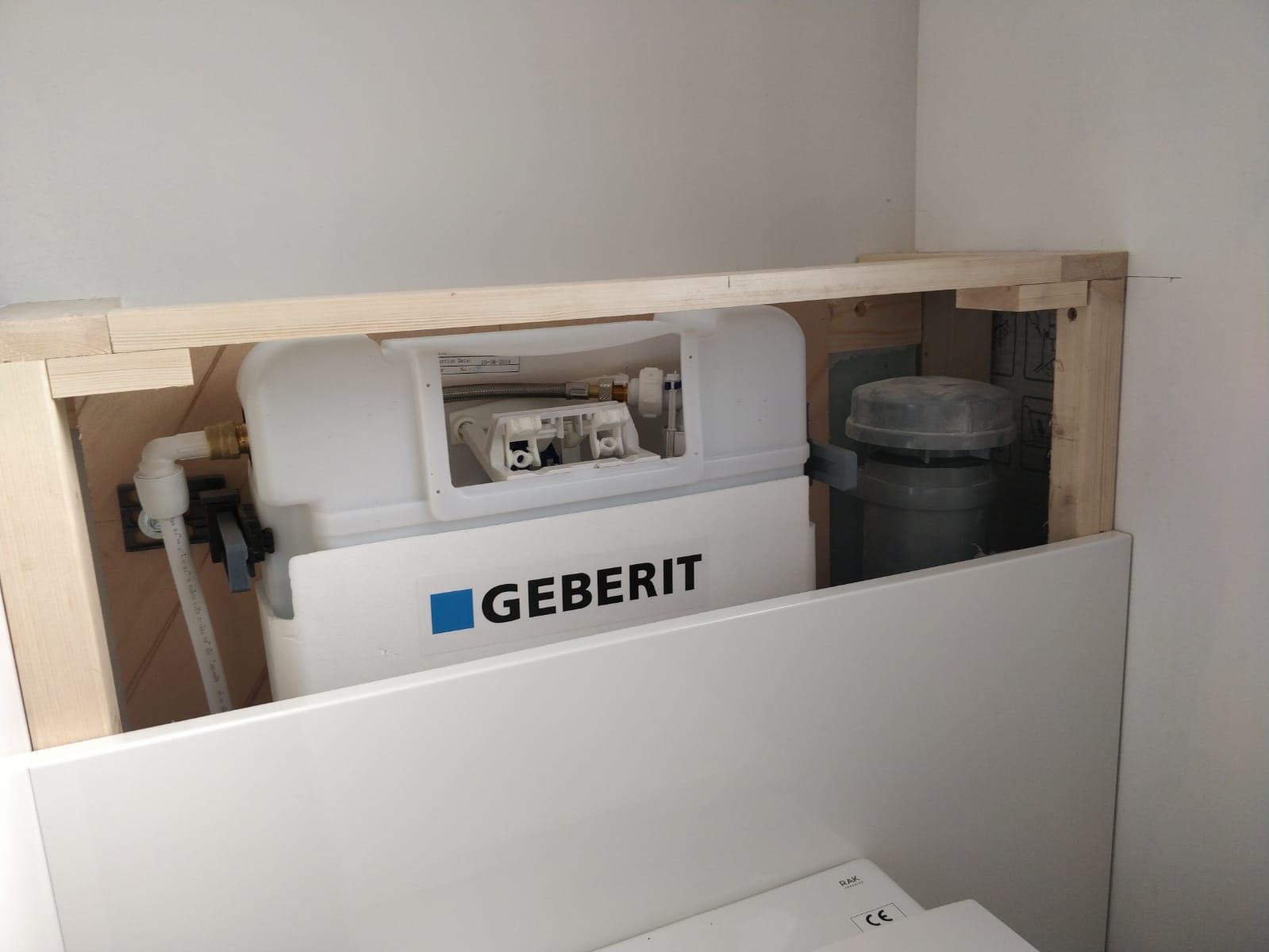

Put the cistern in place . Funny really I built a double stud wall to ‘relieve’ noise from the bathroom . Now I’ve moved the geberit into the wall there’s no sound insulation behind it !!

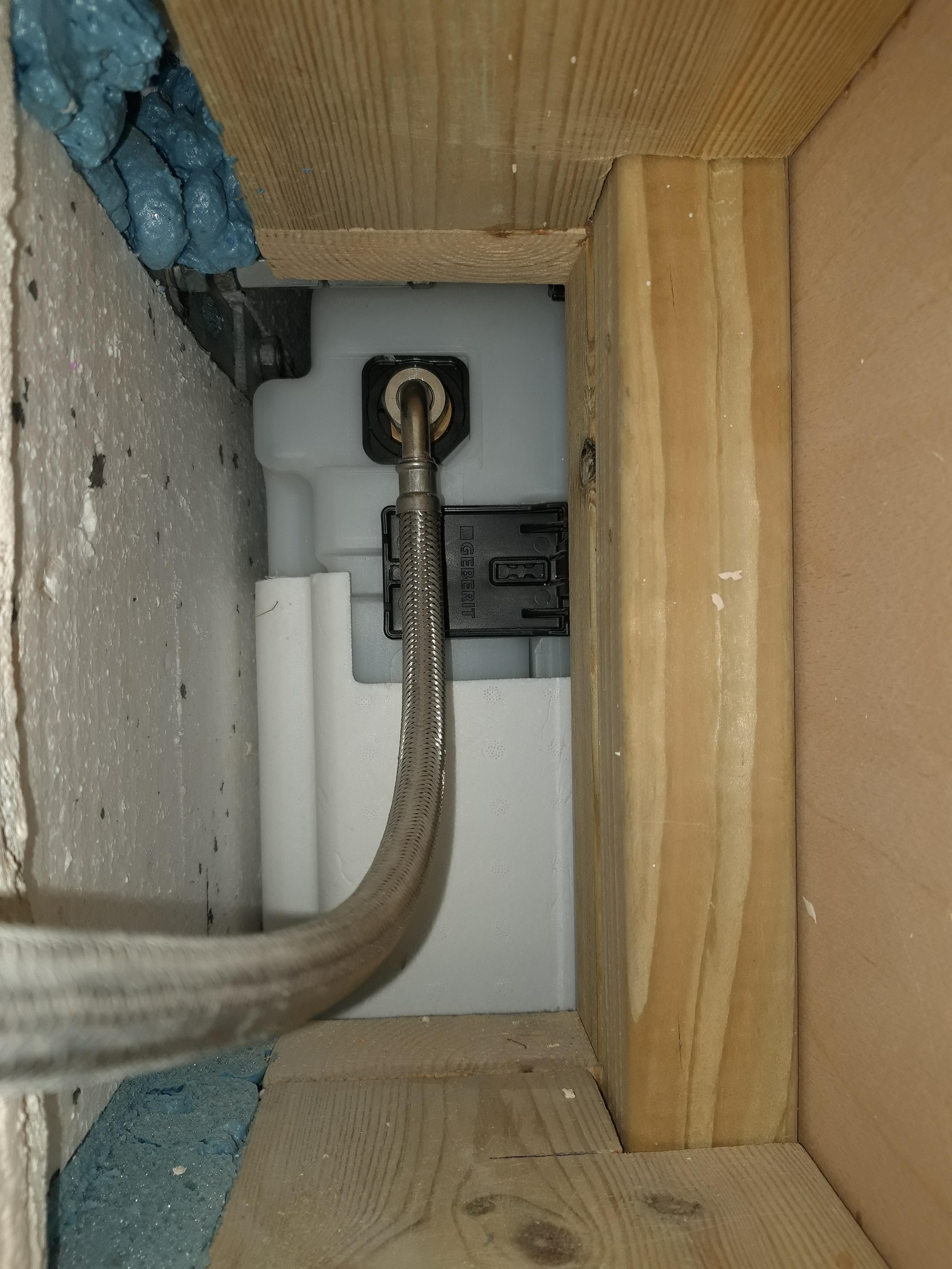

Time to sort out how the water feed to cistern is done
Posted
I've fitted 3 of these frames now and each time I've use the Hep2o bent tap connectors. 1/2" BSP I think. Got a small rubber washer inside so theres no need for tape.
Last one I did was not a wall hung toilet.
  • Thanks 1
Posted
Ah yes ! Thanks . I think that’s what I need . Just maybe my hep20 pipe is long enough . ?
Posted
Used one of these, a 500mm B&Q flexi. In the words of he who must be obeyed.
"A bit more than hand tight is usually ample. Say 1/2 turn or so".
2017-03-05_02-12-26
It's easily accessible through the back of the (still unfinished ? ) cupboard:
Posted
2017-03-05_02-12-26
Hmmmm, mine will never be accessible!
Posted
Does it matter my inlet via that Hep2o elbow will never been accessible??
I assume from your photo that particular one will be ....but mine ....... ?

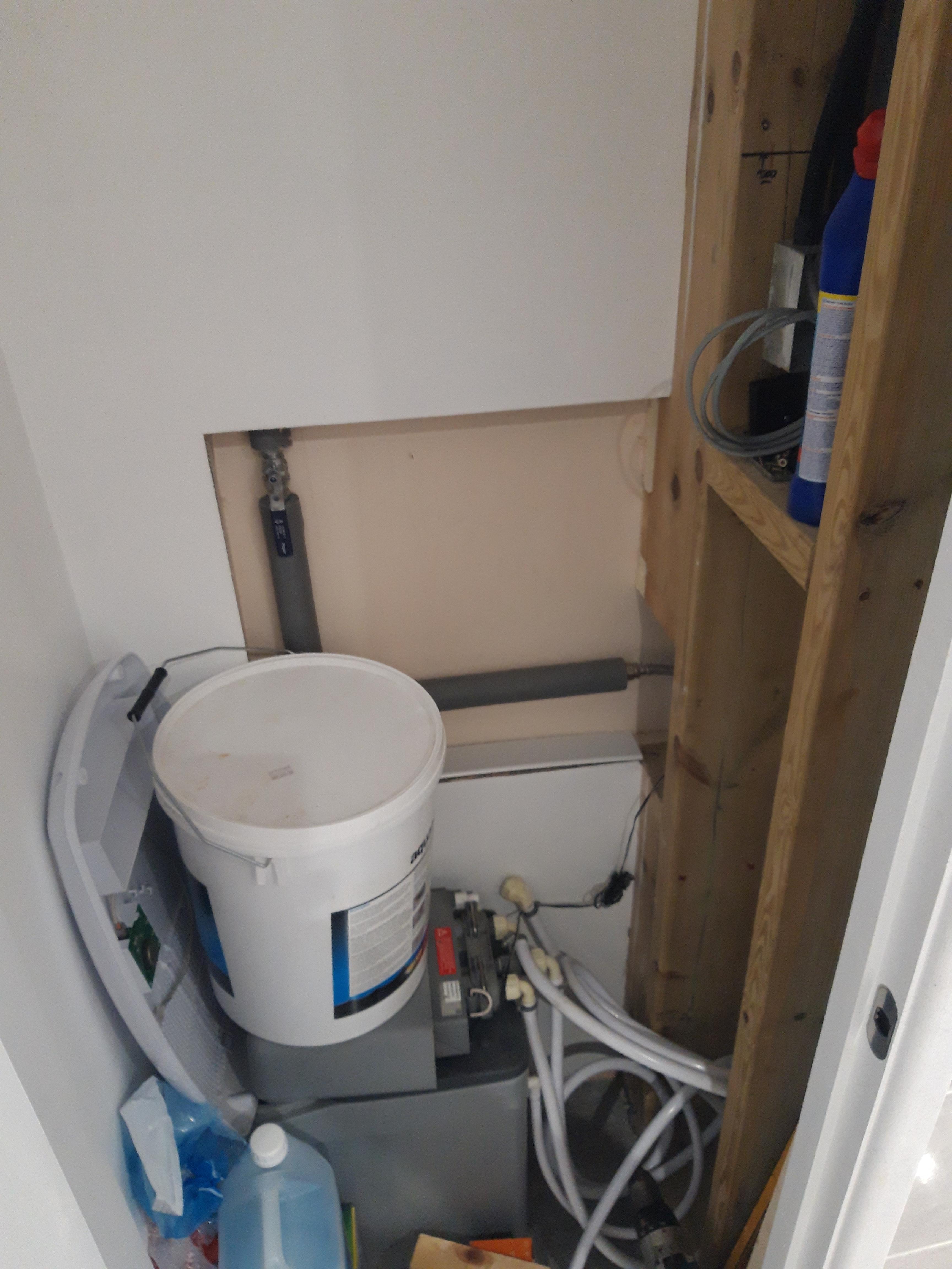

Hole for ensuite waste . Mock up of what I intend . JTM plumbing ( no I don’ t work for them ! Used them before ! ) , are brilliant ! Explain my dumbness - tell them what I am trying to achieve and they send me a parts list - top service !!
Posted
Yes I can access it from the front by pulling off the panel. Previously I've plaster boarded the framework up. But you could easily cut through it to fix it.
Just how inaccessible will yours be? I would guess that the worst case would be tiles on cement board in front of it.
I always try to make things accessible, but in reality its not always possible. Second best option would be to be able to see it via a endoscope/camera. I've yet to have a leak from a hep2o, I would be more worried about having a brass connector in there.
This is my shower setup. consisting of several compression fittings on to hep2o pipe and 4no. 3/4" to 1/2" bsp reducers.  This is 100% inaccessible or visible. I do wonder a lot of the time as to whether its dripping away behind there or something. All I can do it try to take comfort in the fact that I left it pressurised for 24h without a sign of leaking.
But at the end of the day, if it does leak, I have the ability to fix it and finally get rid of the bloody P-Bath.
