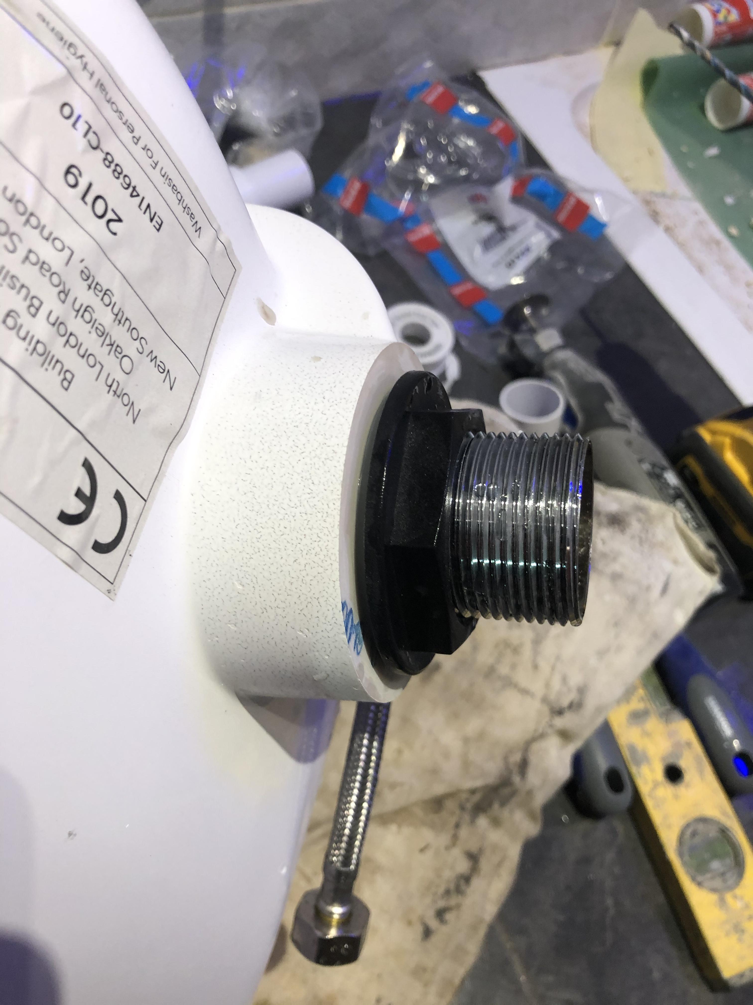

Pocster Posted January 15, 2021 Author Share Posted January 15, 2021 (edited) Few extra questions Assume best to fix taps to sink then install sink ? The supplied flexi hoses just hand screw into the tap ? - there appears no possible way to get any tool in there to tighten .... Edited January 15, 2021 by pocster Link to comment Share on other sites More sharing options...

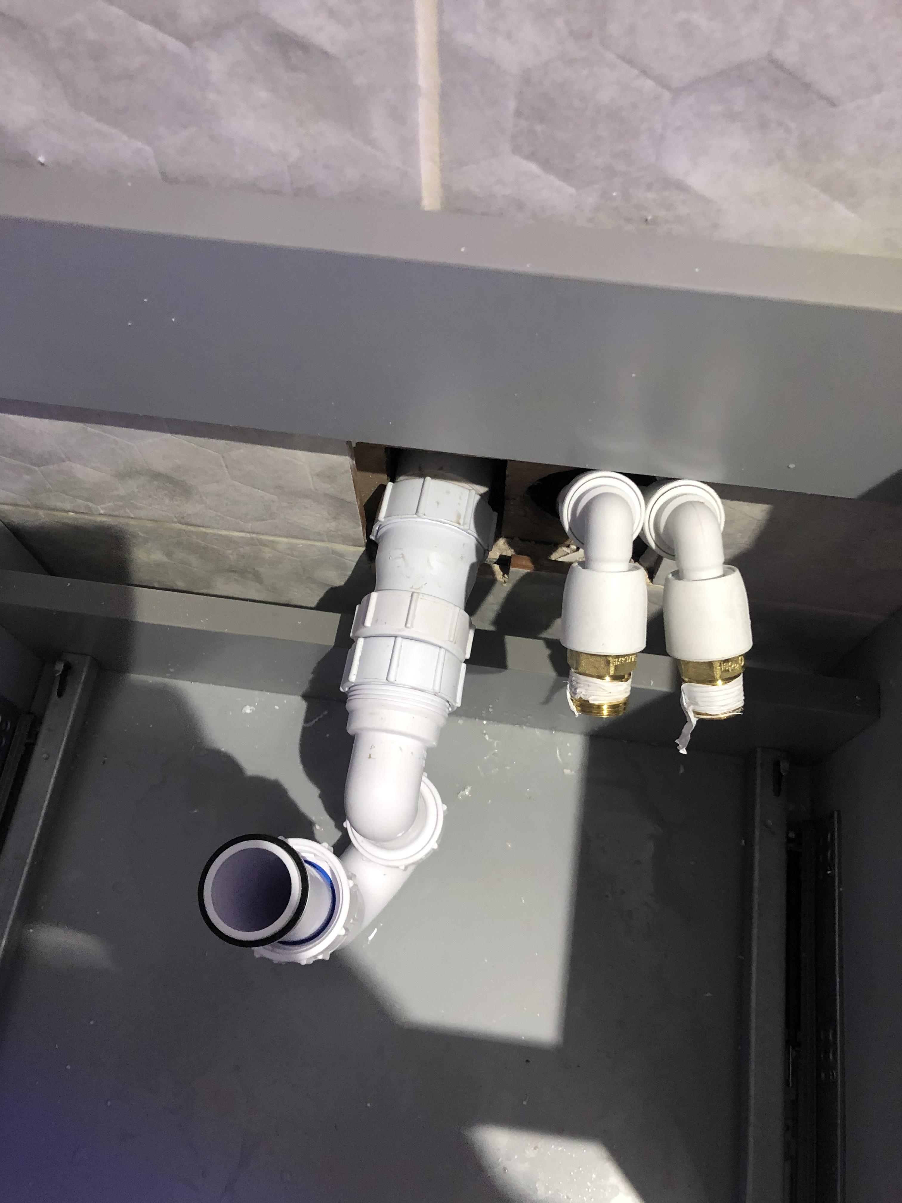

Pocster Posted January 15, 2021 Author Share Posted January 15, 2021 Ok ! Believe the tails to Hep2o I need https://www.jtmplumbing.co.uk/john-guest-speedfit-c432/john-guest-speedfit-brass-fittings-c171/john-guest-speedfit-brass-male-coupler-p3324 To align the trap to the waste I need https://www.jtmplumbing.co.uk/pipe-fittings-c433/mcalpine-multifit-waste-c136/mcalpine-flexcon-flexcon-p18063 How do I know all this ? Because I’m awesome ? no Because JTM plumbing are ace !!! Link to comment Share on other sites More sharing options...
ProDave Posted January 15, 2021 Share Posted January 15, 2021 The sink doesn't move. Why not plumb the waste in rigid? Link to comment Share on other sites More sharing options...
Pocster Posted January 15, 2021 Author Share Posted January 15, 2021 36 minutes ago, ProDave said: The sink doesn't move. Why not plumb the waste in rigid? Because it’s going to be tricky to get it all aligned . I think at the moment I’ve got the wrong trap - so that doesn’t help ? Link to comment Share on other sites More sharing options...
wozza Posted January 15, 2021 Share Posted January 15, 2021 2 hours ago, pocster said: Assume best to fix taps to sink then install sink ? Yes, but not the end of the world depending on the fixing type. 2 hours ago, pocster said: The supplied flexi hoses just hand screw into the tap ? - there appears no possible way to get any tool in there to tighten .... Yes - only hand tight - if you overtighten the rubber o ring will be forced out and they will leak. 1 Link to comment Share on other sites More sharing options...
Gone West Posted January 15, 2021 Share Posted January 15, 2021 Can't you plumb the waste rigid with a longer telescopic U bend? 1 Link to comment Share on other sites More sharing options...
Pocster Posted January 15, 2021 Author Share Posted January 15, 2021 24 minutes ago, PeterStarck said: Can't you plumb the waste rigid with a longer telescopic U bend? Yes . I found one lying around but it’s 1 1/2” ; need quarter inch . Ordered it will try that first ? 1 Link to comment Share on other sites More sharing options...

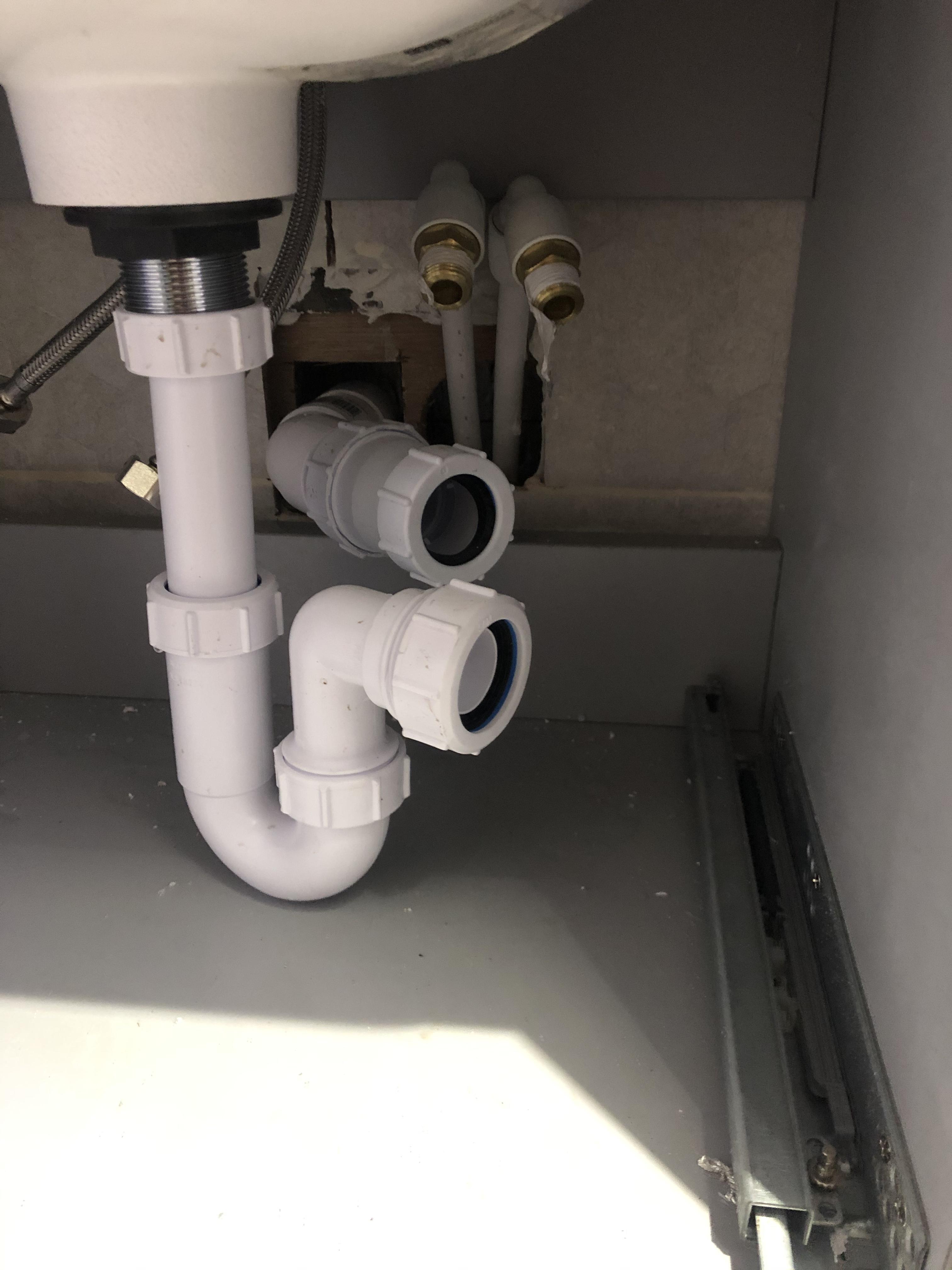

Pocster Posted January 18, 2021 Author Share Posted January 18, 2021 For reasons unknown I installed the sink waste as 40mm rather than 32mm . So adding a compression reducer makes it all rather awkward Link to comment Share on other sites More sharing options...
Onoff Posted January 18, 2021 Share Posted January 18, 2021 14 minutes ago, pocster said: For reasons unknown I installed the sink waste as 40mm rather than 32mm . So adding a compression reducer makes it all rather awkward You do like to make things hard for yourself. 1 Link to comment Share on other sites More sharing options...
Onoff Posted January 18, 2021 Share Posted January 18, 2021 (edited) Why can't you spin the U bend round so it faces the waste pipe then reduce there? Is it all solvent weld at the back? Edited January 18, 2021 by Onoff 1 Link to comment Share on other sites More sharing options...

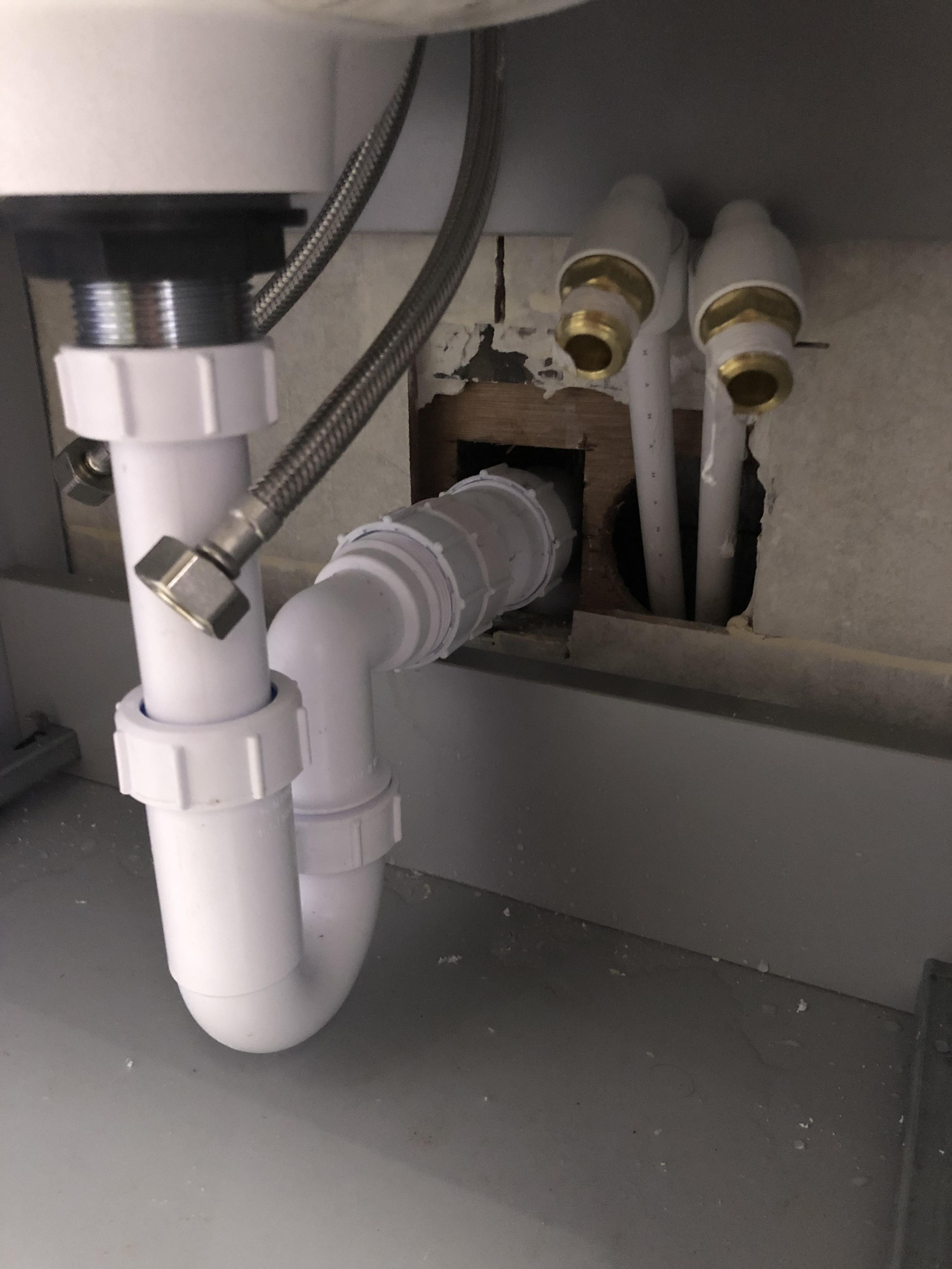

Pocster Posted January 18, 2021 Author Share Posted January 18, 2021 Managed to get the compression reducer on the back . All rather tight but I think ok Link to comment Share on other sites More sharing options...

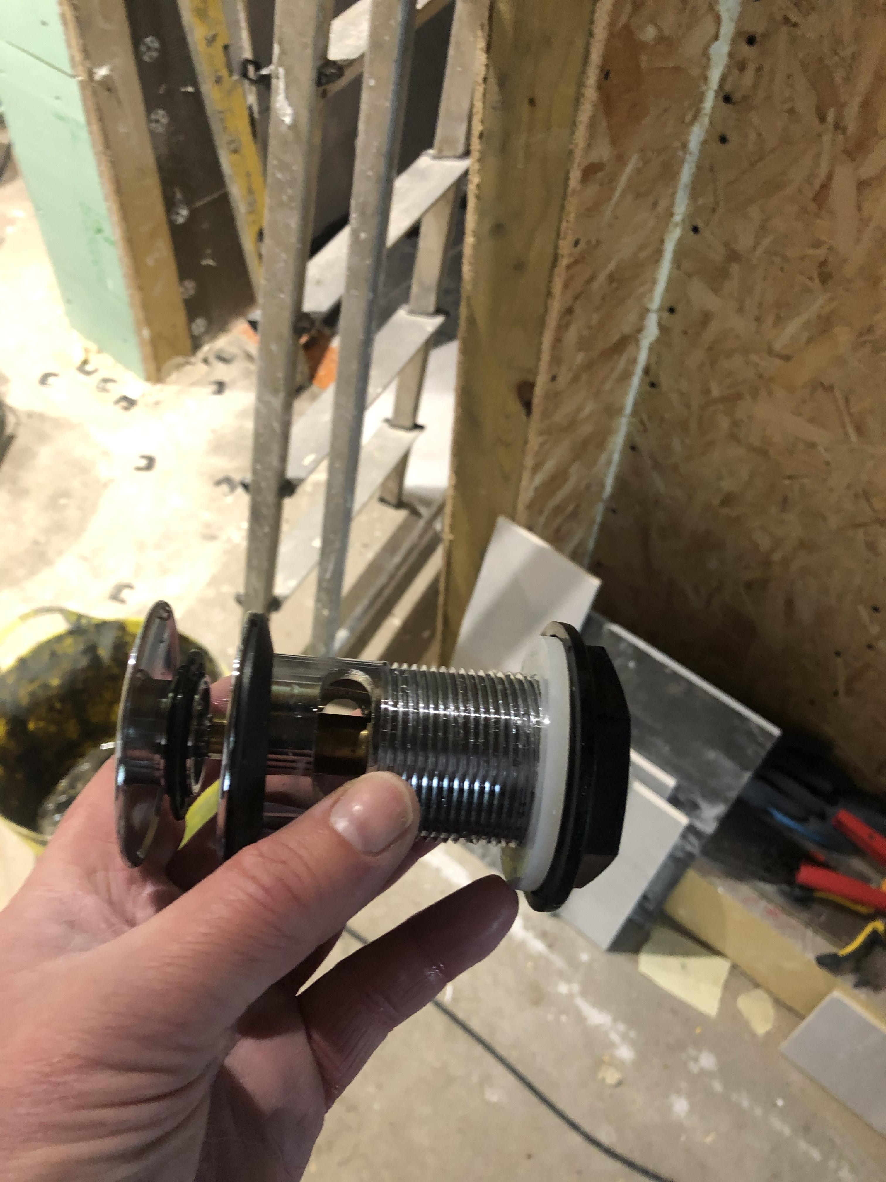

Pocster Posted January 18, 2021 Author Share Posted January 18, 2021 Well ! Water test and it leaks but around the sink waste . Don’t understand the sink plug . When open to drain water will run out those side gaps surely ? . Only 2 washers . 1 in sink , 1 underneath. Can’t see anything else wrong Link to comment Share on other sites More sharing options...
Pocster Posted January 18, 2021 Author Share Posted January 18, 2021 2 minutes ago, pocster said: Well ! Water test and it leaks but around the sink waste . Don’t understand the sink plug . When open to drain water will run out those side gaps surely ? . Only 2 washers . 1 in sink , 1 underneath. Can’t see anything else wrong Googling I see the slots are for the overflow to run into . But of course water through the plug hole will find that gap anyway . Rather crap design I think ! . Ptf tape around the upper part of the thread where the washer is ?? Link to comment Share on other sites More sharing options...
Pocster Posted January 18, 2021 Author Share Posted January 18, 2021 A trillion turns of plumbers tape and it might be ok ? Link to comment Share on other sites More sharing options...

Pocster Posted January 18, 2021 Author Share Posted January 18, 2021 (edited) Still leaks !! Silicone ?? Edited January 18, 2021 by pocster Link to comment Share on other sites More sharing options...

Onoff Posted January 18, 2021 Share Posted January 18, 2021 I'd do away with the washer on top, they tend to be a bit generic, one size squashes to fit "all". I'd put a big slug of BT1 etc around the waste. Similar principle to how I did my bath waste. Ditched the top washer, kept the one underneath. The top, baby wiped to finish: Same on the washer underneath: Tighten but do not let the top turn even if it means SWMBO standing above. You want to compress rather than "smear" which will kick it all out of the joint (so @Nickfromwales said). Link to comment Share on other sites More sharing options...
Onoff Posted January 18, 2021 Share Posted January 18, 2021 9 minutes ago, pocster said: Still leaks !! Silicone ?? Exactly where is it leaking? Around the black nut or where the white waste screws on? Link to comment Share on other sites More sharing options...
Pocster Posted January 18, 2021 Author Share Posted January 18, 2021 Just now, Onoff said: Exactly where is it leaking? Around the black nut or where the white waste screws on? Underneath . Where you just have the crap white washer then the black fixing nut . It’s really crap as water runs out from those overflow holes in the sink plug and therefore run down outside the mechanism . Link to comment Share on other sites More sharing options...
joe90 Posted January 18, 2021 Share Posted January 18, 2021 I always use plumbers mate for these fixings https://www.screwfix.com/p/evo-stik-plumber-s-mait-750g/14477?tc=SB6&ds_kid=92700055281954514&ds_rl=1249404&gclid=CjwKCAiAgJWABhArEiwAmNVTB3LfJojSp9qyF9MufDHVbn5wb31Tm9SGXpblOuiue_aNX3QGQzNf6RoC5fgQAvD_BwE&gclsrc=aw.ds 9 in stock in avonmouth ? 1 Link to comment Share on other sites More sharing options...
Onoff Posted January 18, 2021 Share Posted January 18, 2021 5 minutes ago, pocster said: Underneath . Where you just have the crap white washer then the black fixing nut . It’s really crap as water runs out from those overflow holes in the sink plug and therefore run down outside the mechanism . I see I used Sikaflex on the sink waste. Tbh think I did on the bath too: 1 Link to comment Share on other sites More sharing options...
Nickfromwales Posted January 18, 2021 Share Posted January 18, 2021 Drop the nut and plastic washer, big bead of CT1, and wind it back up. Put loads on, and clean the excess off with wipes. Don’t let it go up as far as the slots for the overflow runoff. 1 Link to comment Share on other sites More sharing options...
Pocster Posted January 18, 2021 Author Share Posted January 18, 2021 (edited) 4 minutes ago, Nickfromwales said: Drop the nut and plastic washer, big bead of CT1, and wind it back up. Put loads on, and clean the excess off with wipes. Don’t let it go up as far as the slots for the overflow runoff. Ok Uncle Nick - doing it now . Will test tomorrow ? Edited January 18, 2021 by pocster Link to comment Share on other sites More sharing options...
