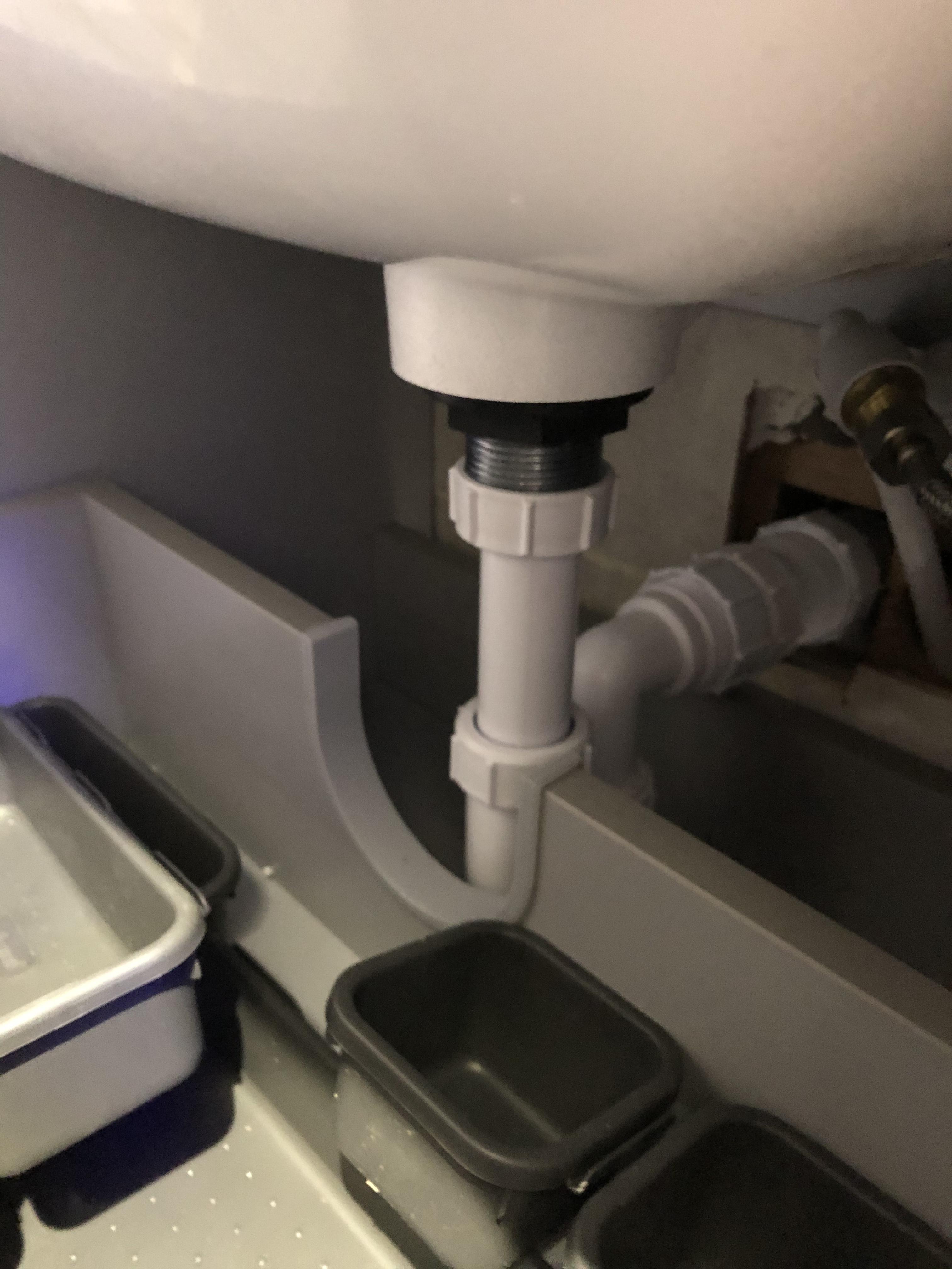

January 19, 20215 yr Need to take it all apart, open up the wall, modify the drain pipe so it comes out higher up the wall and re assemble. It's "little" things like this that on another thread I said there is a LOT more to being a successful tradesman than knowing the regs.
January 19, 20215 yr Author 1 minute ago, ProDave said: Need to take it all apart, open up the wall, modify the drain pipe so it comes out higher up the wall and re assemble. It's "little" things like this that on another thread I said there is a LOT more to being a successful tradesman than knowing the regs. No way - I’d have to bust tiles / ply etc. ??? Is there not a shallower trap I can use ??
January 19, 20215 yr Author This ???? https://www.toolstation.com/viva-magna-self-sealing-waste-valve/p82878?store=I6&utm_source=googleshopping&utm_medium=feed&utm_campaign=googleshoppingfeed&gclid=CjwKCAiAo5qABhBdEiwAOtGmbrFZi2H_0gIsy54sv_lRQ69SBiiDA_jUpNr5S_UN0YuCsnEs0Bw7xxoCVHIQAvD_BwE
January 19, 20215 yr Author 20 minutes ago, pocster said: This ???? https://www.toolstation.com/viva-magna-self-sealing-waste-valve/p82878?store=I6&utm_source=googleshopping&utm_medium=feed&utm_campaign=googleshoppingfeed&gclid=CjwKCAiAo5qABhBdEiwAOtGmbrFZi2H_0gIsy54sv_lRQ69SBiiDA_jUpNr5S_UN0YuCsnEs0Bw7xxoCVHIQAvD_BwE Ordered ! Jtm plumbing don’t do this and said it would work . Their previous suggestion was hack the cabinet ? Edited January 19, 20215 yr by pocster
January 19, 20215 yr 52 minutes ago, pocster said: Oh ffs ! Now the drawer won’t clear the trap !! By how much? Can you lower the U shape cutout with an appropriate diameter Starrett (for a neat job) and retrim it? Guessing not...or:knock up a dead neat 3 sided piece in melamine, screw from the back of the drawer.
January 19, 20215 yr 42 minutes ago, pocster said: This ???? https://www.toolstation.com/viva-magna-self-sealing-waste-valve/p82878?store=I6&utm_source=googleshopping&utm_medium=feed&utm_campaign=googleshoppingfeed&gclid=CjwKCAiAo5qABhBdEiwAOtGmbrFZi2H_0gIsy54sv_lRQ69SBiiDA_jUpNr5S_UN0YuCsnEs0Bw7xxoCVHIQAvD_BwE That looks longer than might fit...
January 19, 20215 yr Author 7 minutes ago, Onoff said: By how much? Can you lower the U shape cutout with an appropriate diameter Starrett (for a neat job) and retrim it? Guessing not...or:knock up a dead neat 3 sided piece in melamine, screw from the back of the drawer. Yeah I could do all that but you know ! At the moment it’s a choice of lesser of evils ! I always prefer more than 1 option ...
January 19, 20215 yr Author 6 minutes ago, Onoff said: That looks longer than might fit... I thought that . Might be able to stick a flexcon on it if it won’t fit .

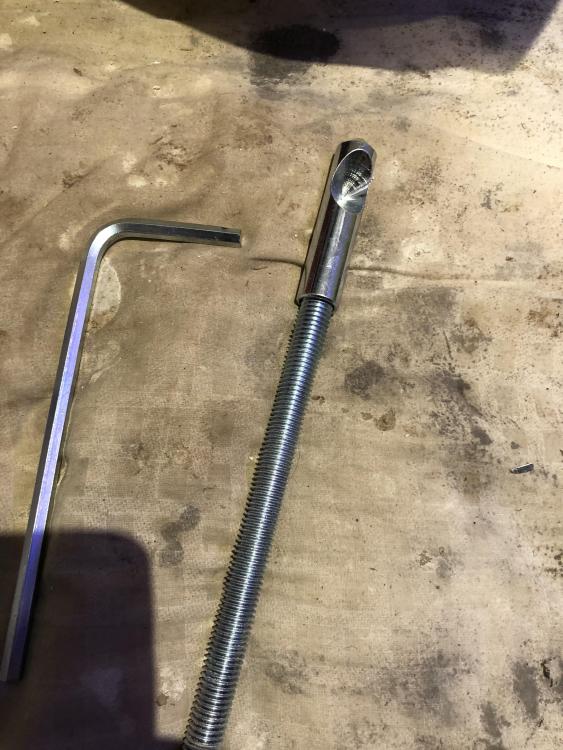

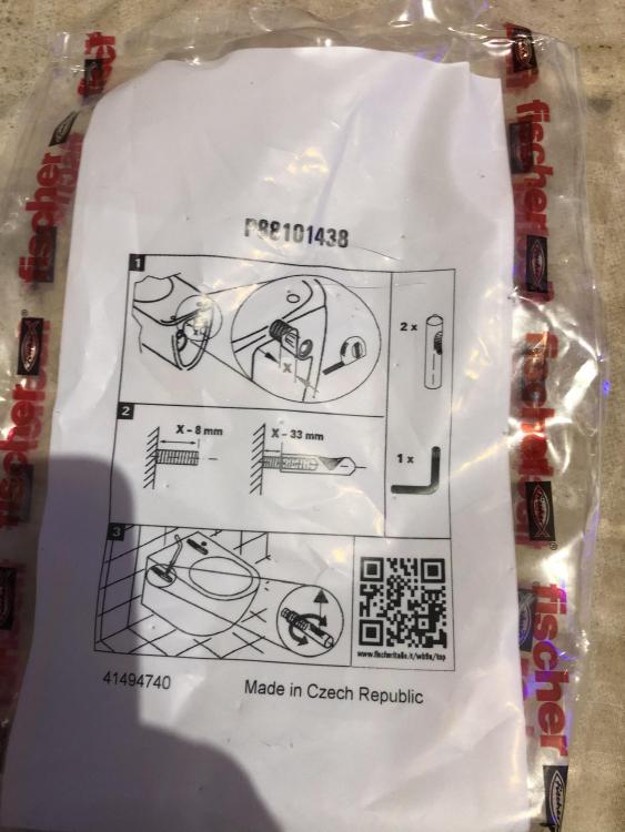

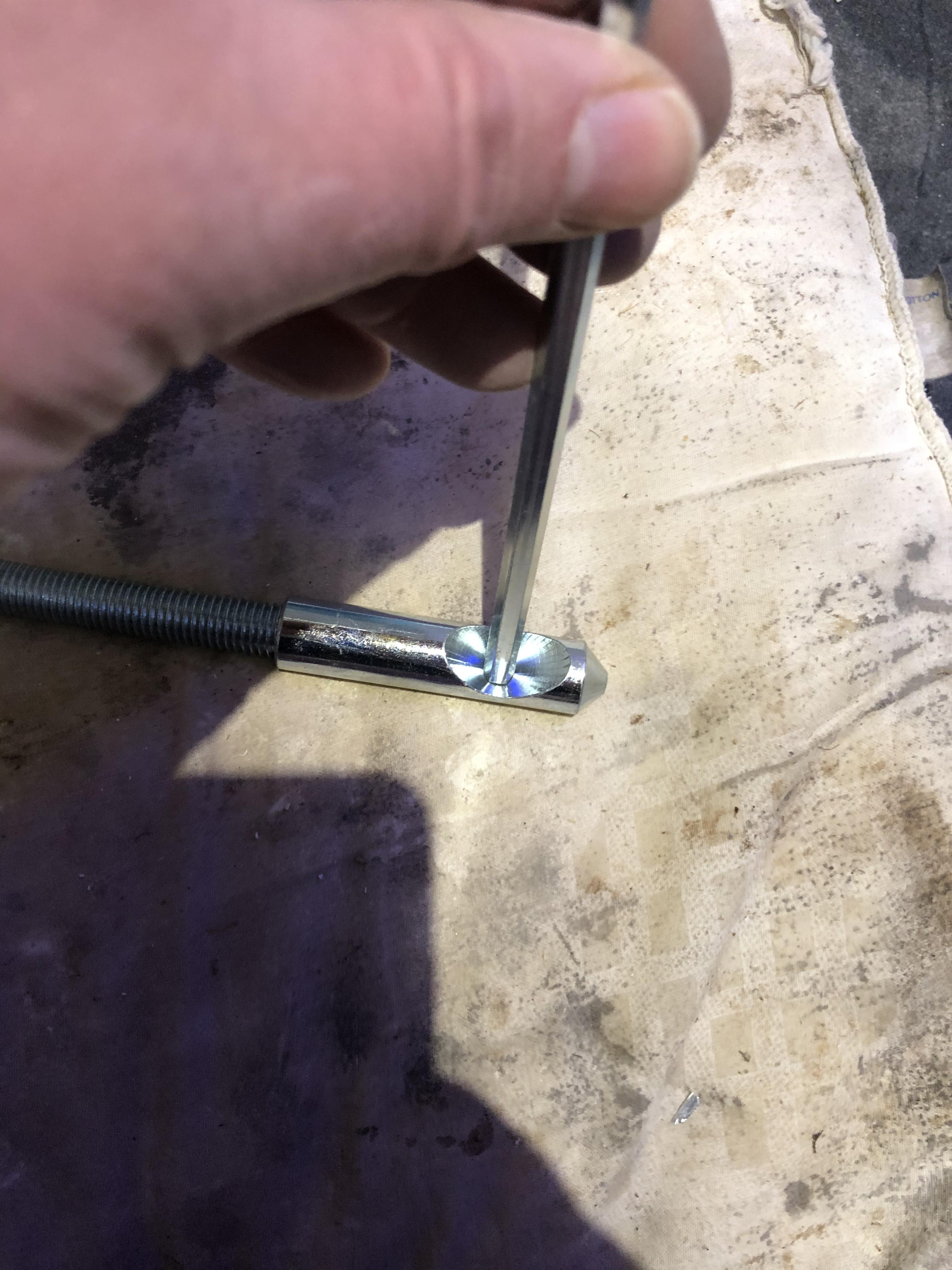

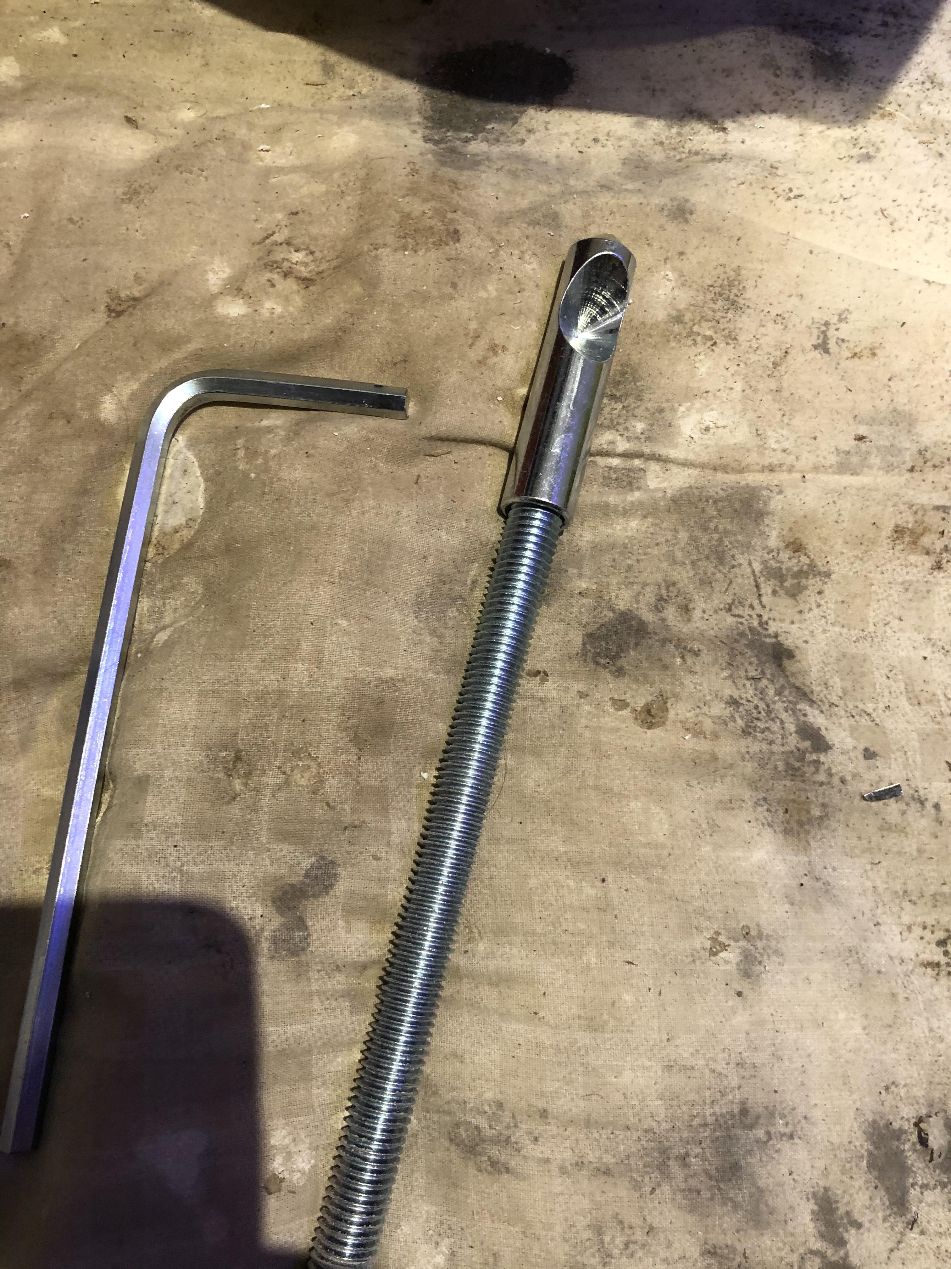

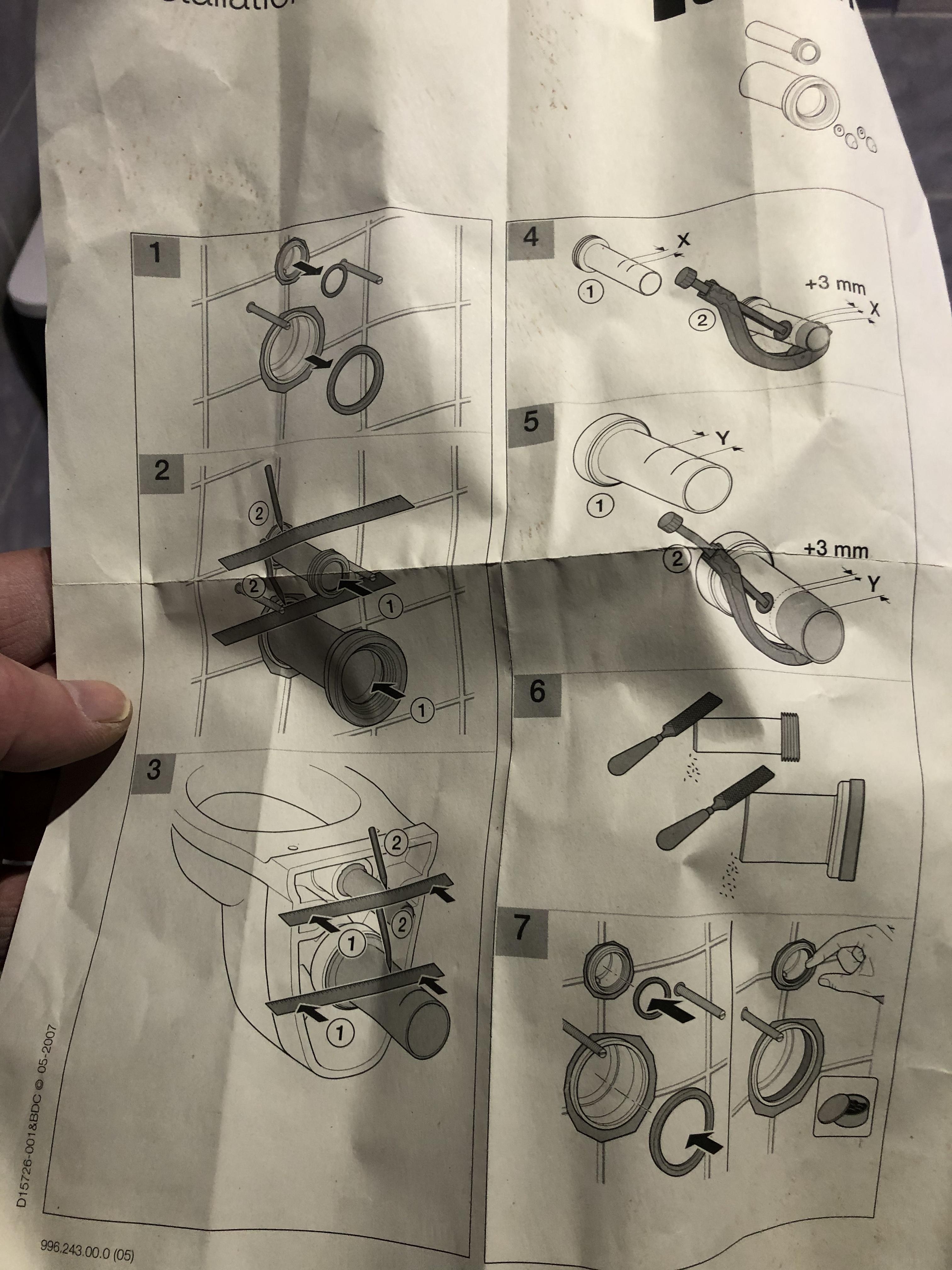

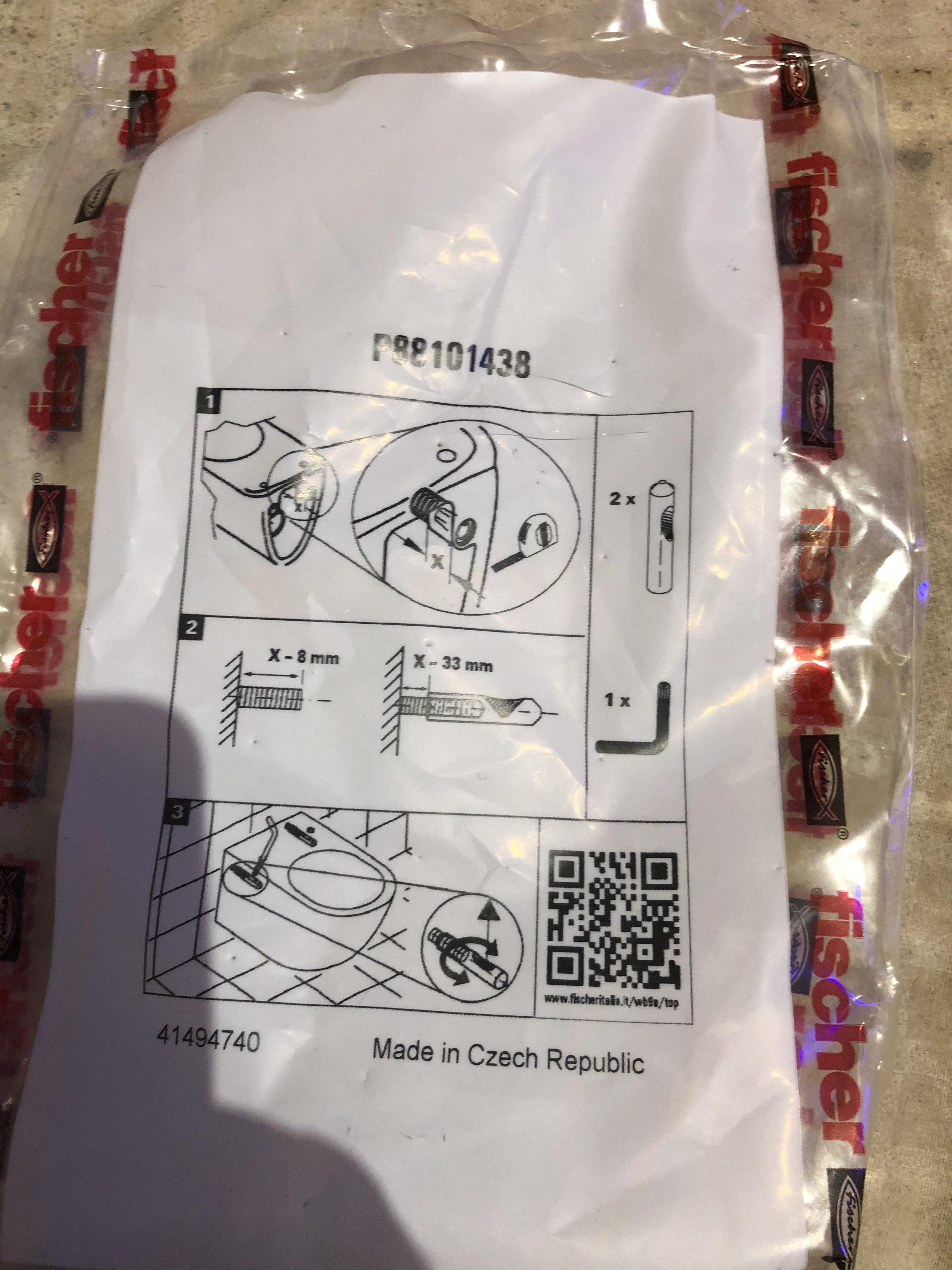

January 19, 20215 yr Author Whilst I wait / ponder over the basin trap decided to look at the geberit pan . Hmmmmm - confusion !! ( not my day today ) . Can’t see how you tighten those bolts with the supplied Allen key - must be mis understanding something !!
January 19, 20215 yr Author Just now, Onoff said: Skip to 3m50s: Yeah I watched that exact video I’m obviously having a (expletive deleted)ing thick as sh*t day ( blame being a LL for that ) - I just can’t see what the Allen key connects into ( no hex receiver ) to tighten it
January 19, 20215 yr 3 minutes ago, pocster said: Yeah I watched that exact video I’m obviously having a (expletive deleted)ing thick as sh*t day ( blame being a LL for that ) - I just can’t see what the Allen key connects into ( no hex receiver ) to tighten it Isn't there a big plastic assembly in the back of the pan? The screw on bullets go into that...
January 19, 20215 yr Those bullets don't look like Geberit tbh? Milano? https://www.amazon.co.uk/Milano-Wall-Hung-Toilet-Fixing/dp/B07QX5VMJM/ref=asc_df_B07QX5VMJM/?tag=googshopuk-21&linkCode=df0&hvadid=309957120848&hvpos=&hvnetw=g&hvrand=10449256194739964687&hvpone=&hvptwo=&hvqmt=&hvdev=c&hvdvcmdl=&hvlocint=&hvlocphy=9045888&hvtargid=pla-741154526128&psc=1
