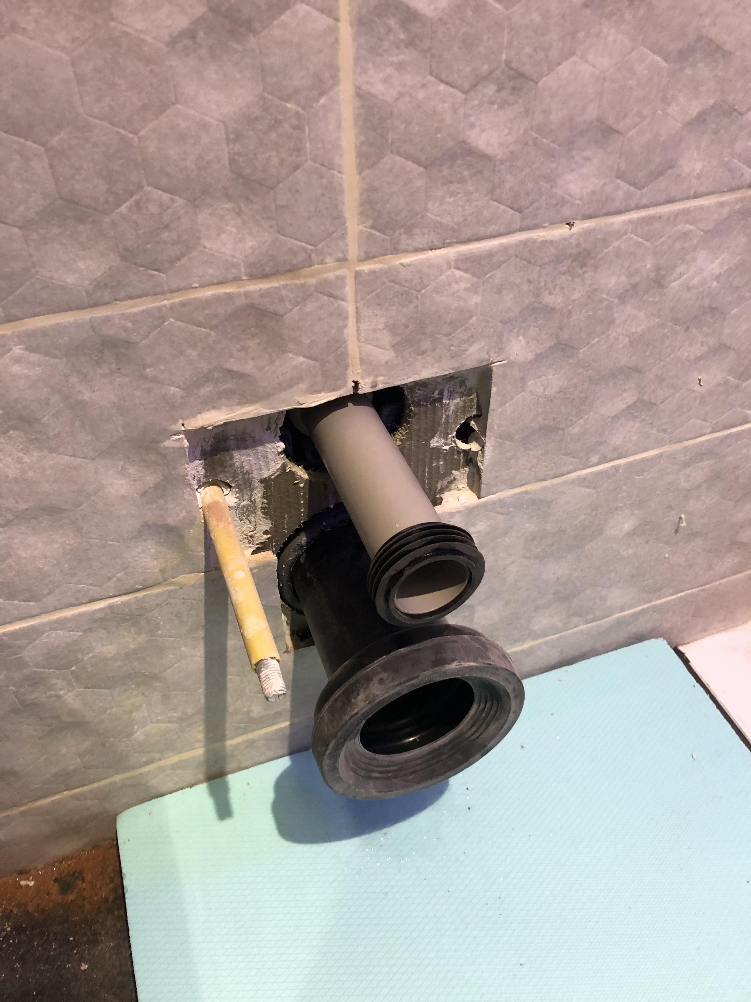

Is the pan Geberit?
Yep . These are the bolt end attachments. There’s no way you can tighten with an Allen key

Ok ! Phone call to geberit ! Apparently there’s an embedded grub screw in the fitting which is embedded in the pan ! I shall now go and look for it !!

You want to be sticking that pan to the tiled wall with clear CT1 then leaving for 36 hours before planting your ar$e on it.
Put the pan on, mask the wall then back off and pump in the good stuff. Tighten up and baby wipe the excess. Remove the tape. Go over with a silicone of your choice.

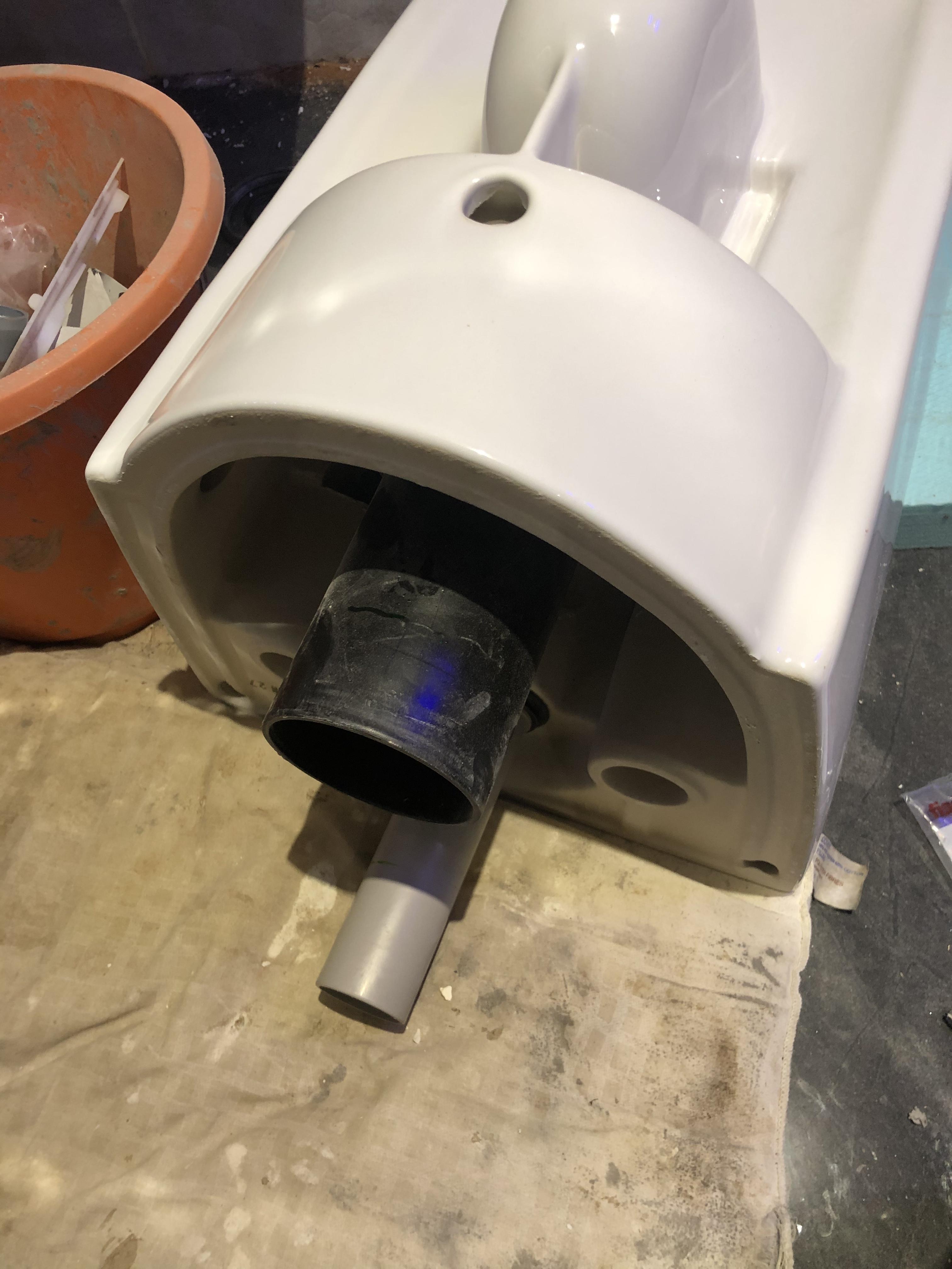

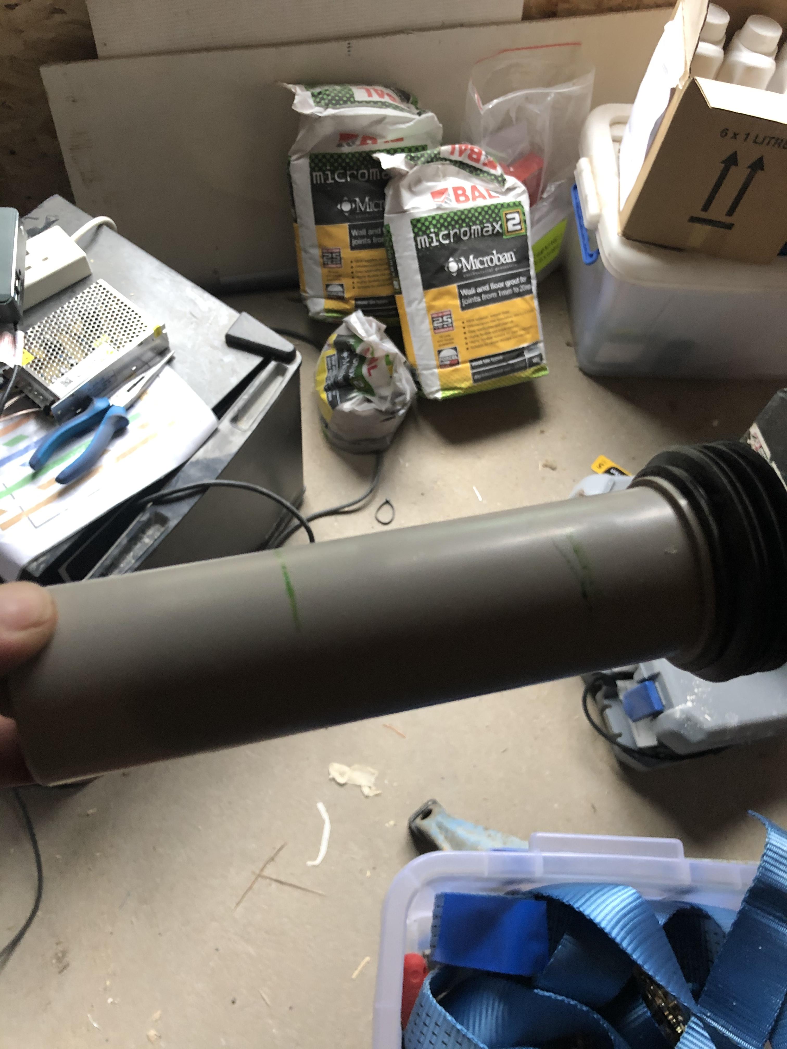

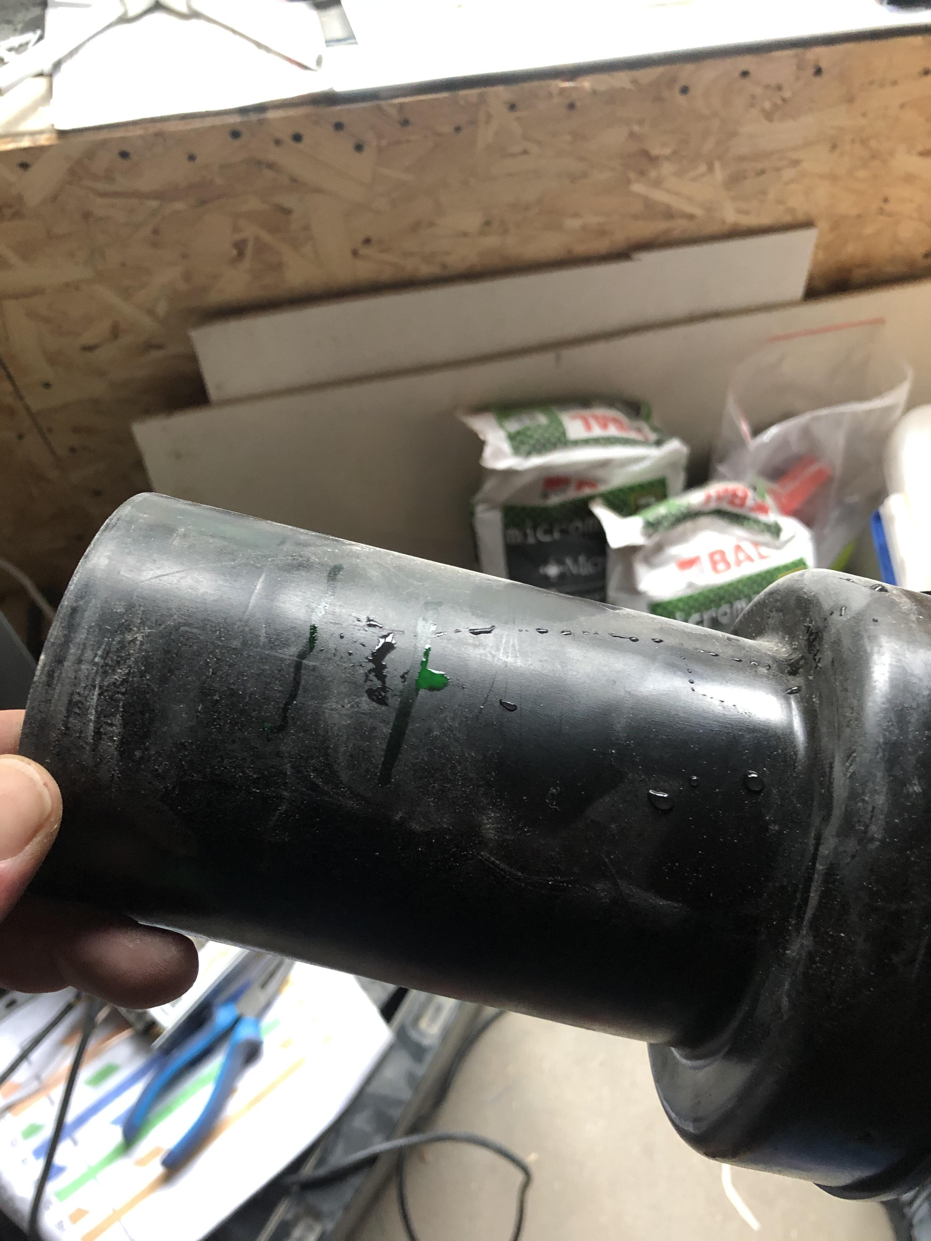

Going to do it all dry first . Now need to read ( well look at pics ) for cutting the waste and supply pipes to the correct length . Plenty of opportunities for fs still ?
Assuming if I fit it all dry I flush it and make sure no leaks . Then take it off ,ct1 , clean it up , leave it for 3 days
Edited by pocster
Ok ; seems simple enough .
Measure distance of pipe off wall . Measure distance of pipe off wc .
Cut that difference off the end + 3mm
Plenty of lube on the flush pipe before you push the pan on, ive had the rubber gaskets/seals slide down the pipe instead of going into the pan. one was so persistent i had to wrap tape around the pipe behind the seal to stop it popping over the pipe end and sliding back.
Been there, done that, plenty o' lube and remove the burrs.

Fittings on wall first . Then tried fittings on pan first ( at least you can just about see pipe alignment) . It’s still fighting me though !!
Its a bit of a struggle on your own: are you using the Geberit cardboard support frame so you can just slide the pan up to the fittings .... ?
Erm no ? Don’t remember ever seeing such a thing
For both mine, the bowl came in cardboard packaging: you take the top off the package and the bowl is sitting on a cardboard framework....... Maybe yours is a different model. Mine's Tuma Classic.
Can't remember how I got mine on! Got a feeling I used a trolley jack. I know I had the pipes on the pan then fed them into the wall:
