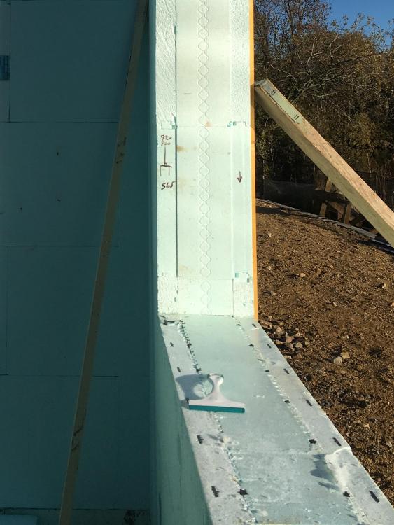

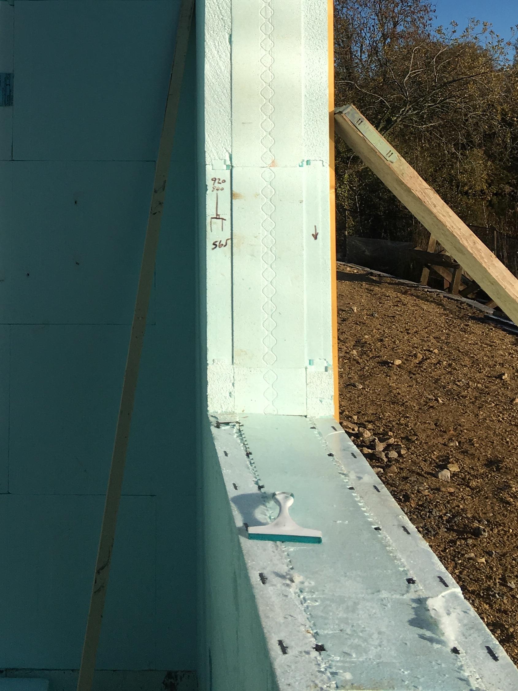

Russell griffiths Posted August 5, 2019 Share Posted August 5, 2019 Evening all. So fitting windows in a icf wall. My cill area is made up using the cavity closer system from the icf manufacturer (nudura) so I end up with a concrete core and 50mm of eps on top which closes the cavity and forms a no cold bridge type of design, super dooper however im concerned over the weight of the windows sitting down onto this eps insulation, will they sink over time?? im thinking I need something to spread the load over the eps, something like a cement board, or even a sheet of upvc or something, I have considered removing the closer and replacing it with a higher density xps type insulation. Please see pic. 1 Link to comment Share on other sites More sharing options...

willbish Posted August 5, 2019 Share Posted August 5, 2019 I've got same ICF cavity closer set up as you although in a different colour. I plan to install windows in an 18mm ply box, primarily to set the windows a bit closer to the outside as I've got 200mm outer EPS. If fixed on 4 sides through to concrete core I don't see the windows dropping. 2 Link to comment Share on other sites More sharing options...

Russell griffiths Posted August 6, 2019 Author Share Posted August 6, 2019 1 hour ago, Conor said: Won't the windows be installed with straps attached to the core that will take the majority of the load? What are you planning for sills? I'll be doing the same in about 6months time. They will be attached to straps, but I cannot see how a strap attached at 90 degrees to the load stops the load going downwards, yes the straps hold the windows in place, but a couple of hundred kilos of glass must need support from underneath ???? meeting with a couple of window suppliers this week, I will ask them. Link to comment Share on other sites More sharing options...
Jeremy Harris Posted August 6, 2019 Share Posted August 6, 2019 15 minutes ago, Russell griffiths said: They will be attached to straps, but I cannot see how a strap attached at 90 degrees to the load stops the load going downwards, yes the straps hold the windows in place, but a couple of hundred kilos of glass must need support from underneath ???? meeting with a couple of window suppliers this week, I will ask them. Just work out the compressive load on the insulation by dividing the weight of the window with the supported area under the cill. For example, if the window weighs 100kg and has a support area under the cill of 2m x 0.1m, then the compressive load is 500kgf/m² (100kg / (2m x 0.1m)). Converting that to units of force (Newtons) gives a force per unit area of about 4.9kN/m². EPS 300 (at 1% compression) is rated for 100 kN/m², so would be overkill. Even EPS 100 (rated at 45 kN/m² at 1%) is massively stronger than needed. Check what Nudara use (I doubt it's going to be less than EPS100) and then do a quick calculation to see how things look. (To convert from kg/m² to kN/m² just multiply by 0.00981) 2 Link to comment Share on other sites More sharing options...

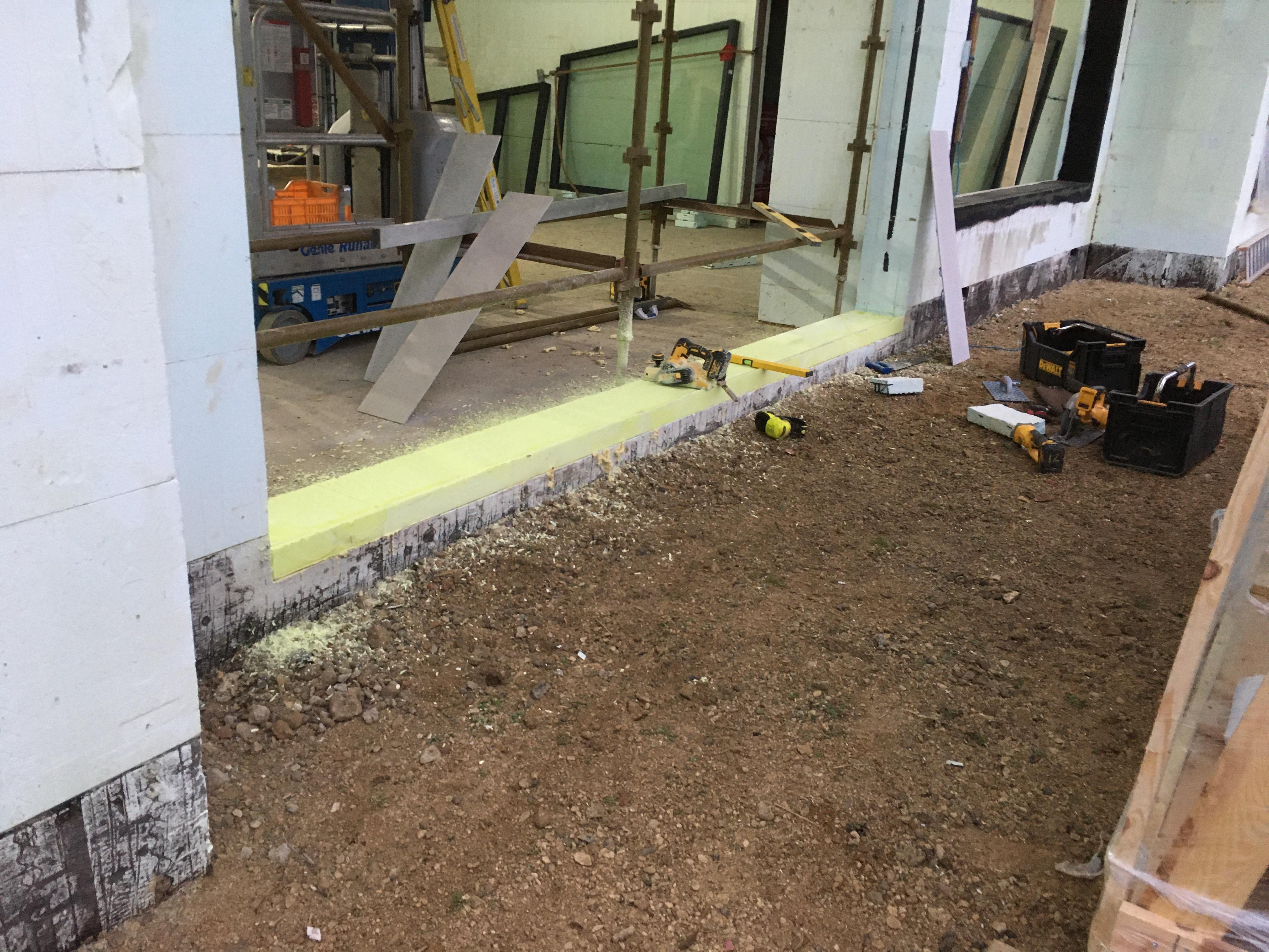

Russell griffiths Posted September 5, 2020 Author Share Posted September 5, 2020 under my sliders 460kg I used strips of xps500 cut to the width of the wall, the door sits directly on this, rock solid stuff £70 a pack has done one slider and two doors. Under the windows I just fitted them straight on top of the icf cavity closers, after Jeremy’s mathematics it looks like there is t that much load, my big windows are 240kg. 1 1 Link to comment Share on other sites More sharing options...

Russell griffiths Posted September 6, 2020 Author Share Posted September 6, 2020 its All about force over area isn’t it. If you put your best high heels on and stand on that eps you will make a big hole in it, but if you stand on a chunk of 4x2 your weight will not have an impact. I also slid a 6mm cement board on top of the XPS, forgot to mention that, just to help with any point loads that the door might have. Link to comment Share on other sites More sharing options...
