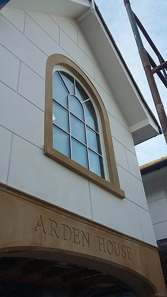

DavidFrancis Posted July 29, 2019 Share Posted July 29, 2019 A house near us got some new flush windows about three years ago. Liked the look of them, so called in to see where they got them from. It was only when I got to about three feet away that I could tell they were not wood and that was only because of the glazing bars. They were Residence 9. 1 Link to comment Share on other sites More sharing options...

soapstar Posted July 29, 2019 Author Share Posted July 29, 2019 1 hour ago, DavidFrancis said: A house near us got some new flush windows about three years ago. Liked the look of them, so called in to see where they got them from. It was only when I got to about three feet away that I could tell they were not wood and that was only because of the glazing bars. They were Residence 9. Seem to be hearing a lot about these Residence 9 windows - looks like its worth investigating further. Get a feeling they are expensive! 1 hour ago, Ralph said: Unfortunately we are yet to break ground, we ended up starting from scratch this year with a new design about a month from starting (it was just costing too much). We're currently specifying aluclad Rationel for this build. I think the windows we looked at before were https://www.internormbyscotia.co.uk/ They do UPVC and UPVC Aluclad and http://www.ecowindowsscotland.co.uk Once we get started, hopefully Sept/Oct you're more than welcome to have a look at anything we're doing.Where about is your bulid? We're not too far from Brechin. Thanks for the links. I do like AluClad, very clean looking. However from what i hear they are not the best for coastal locations. We are based in the Stonehaven area, hopefully looking to start next year. Thanks for your offer we may take you up on that! Nothing beats seeing something up close and personal, only so much a picture can give you and i certainly wouldn't make my decision without seeing the final product. Link to comment Share on other sites More sharing options...

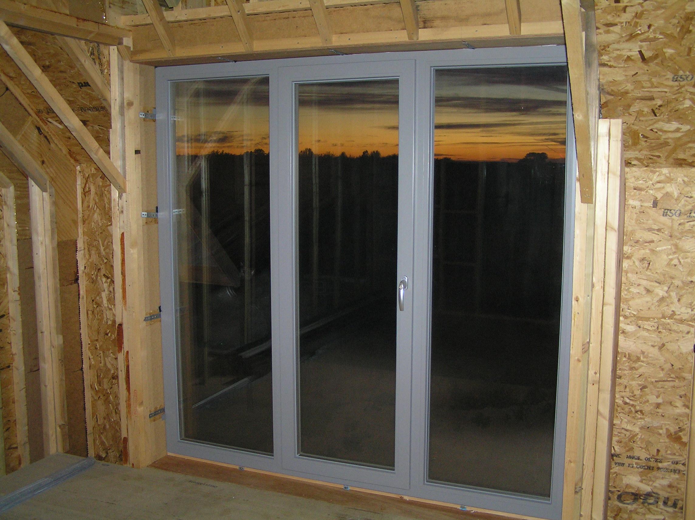

Gone West Posted July 29, 2019 Share Posted July 29, 2019 @soapstar We live a couple of miles from the sea. We have Rehau Geneo fibre reinforced uPVC frames which are insulated and the thermal performance is better than timber. We had the corner welds filled before the frames were sprayed and so far everybody who has commented thinks they are aluminium. 2 Link to comment Share on other sites More sharing options...

Gone West Posted July 30, 2019 Share Posted July 30, 2019 6 minutes ago, soapstar said: Thanks @PeterStarck very interesting. From the photo they do look very much like AluClad. What colour are these if you dont mind me asking? Pearl Grey? They are RAL7037. 7 minutes ago, soapstar said: You can see why I am confused, my architect is insistent that timber is far superior to PVC in regards to its thermal properties, now I am beginning to wonder! There are many different profiles for uPVC some insulated, some not as there are different types of engineered timber some with insulation and some not. He is wrong to make such a statement without qualifying it. 1 Link to comment Share on other sites More sharing options...
soapstar Posted July 30, 2019 Author Share Posted July 30, 2019 1 hour ago, PeterStarck said: They are RAL7037. There are many different profiles for uPVC some insulated, some not as there are different types of engineered timber some with insulation and some not. He is wrong to make such a statement without qualifying it. Thanks i do like that colour. It would seem i have some investigating to do, along with many other things ? I am slowly learning that at the end of the day no matter what the builder or architect says its your house and money, if it fits our needs and gives us a home we a happy with then all is good! 1 Link to comment Share on other sites More sharing options...
