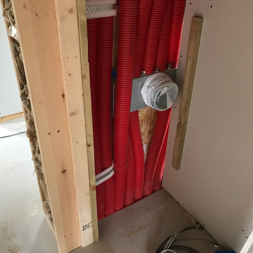

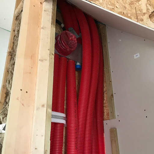

Anyone care to share a photo of their distribution box installation? Would like to see how much space is really needed to connect everything together
That is at the top of our linen cupboard which is 1270 x 870.  We have a vaulted ceiling so it's taking up the top 1000 or so
The other manifold is hidden behind the stuff I have packed round them and is on the side wall.
If you need tonyou can squeeze them in quite a small space...
Thanks chaps, all most useful!
@jamiehamy Yours is probably closest to what we have - I think we have something like 10 extract and 14 supply ducts, all coming out of between ceiling and wall. The challenge I have is that if I mount the distribution box on the wall horizontally then I struggle to get the ones underneath to connect neatly and if I mount it vertically or on the ceiling then I get many pipes trying to cross over each other. A day of 'playing'awaits! :D

Yup, I disconnected and reconnected mine quite a few times before being happy.
My tip is not to cut the ducts too tight to the distribution box initially but when you're happy with the final arrangement, do get them in tight as excess duct will push your box out, especially if you have them coming in both sides.

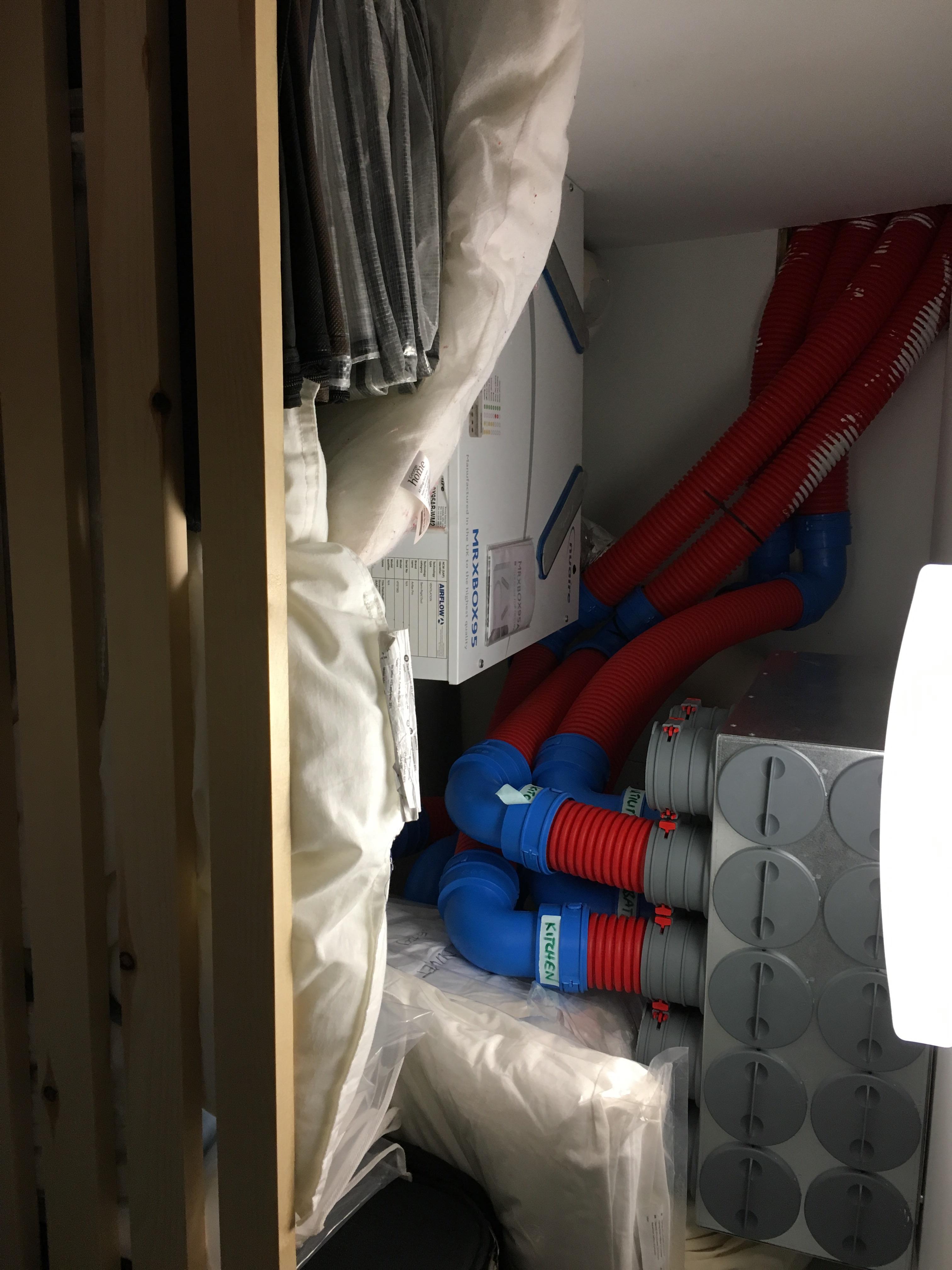

7 hours ago, readiescards said:
And mine
Can I come round and pick those random bits of foam off? Driving me nuts :)

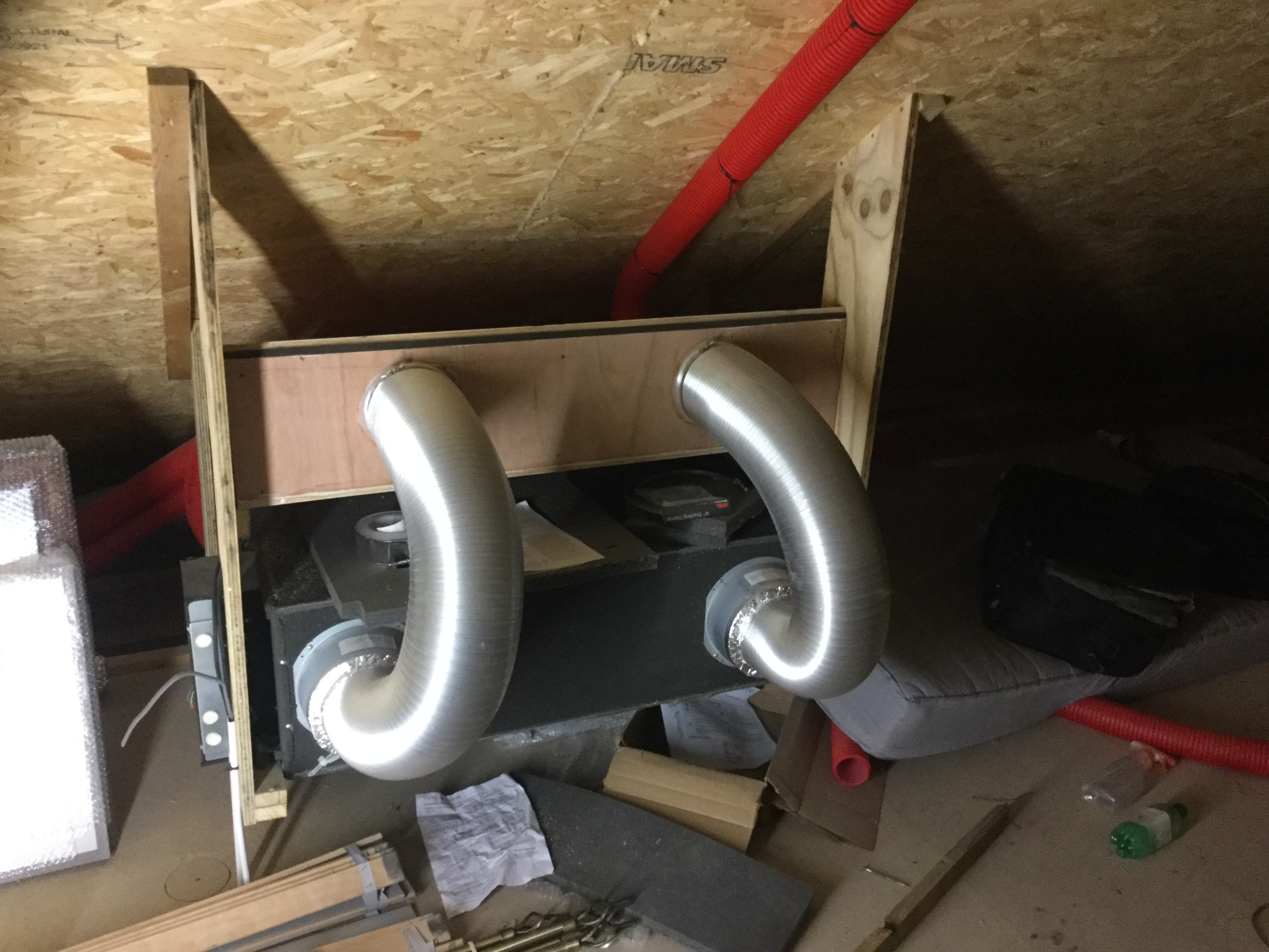

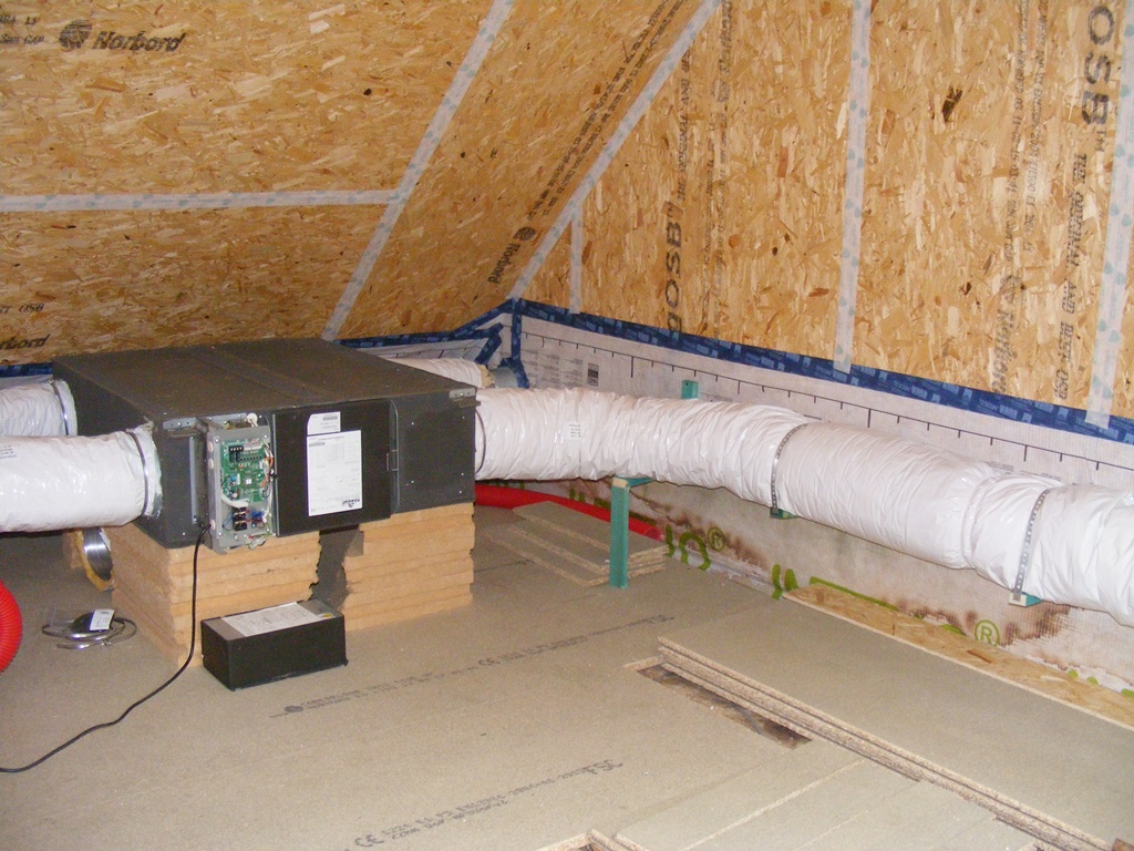

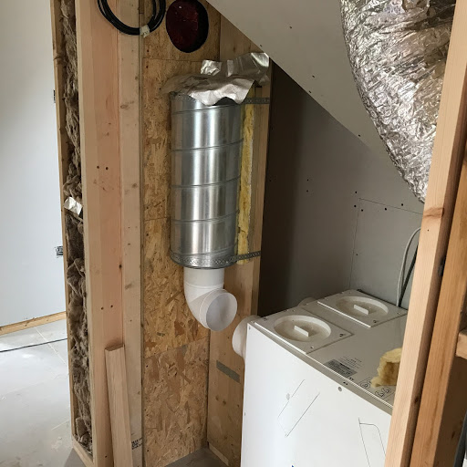

Not seen this thread before but I have installed mine in a warm loft, hung from the roof on rubber mounts so no noise should track down onto bedrooms.

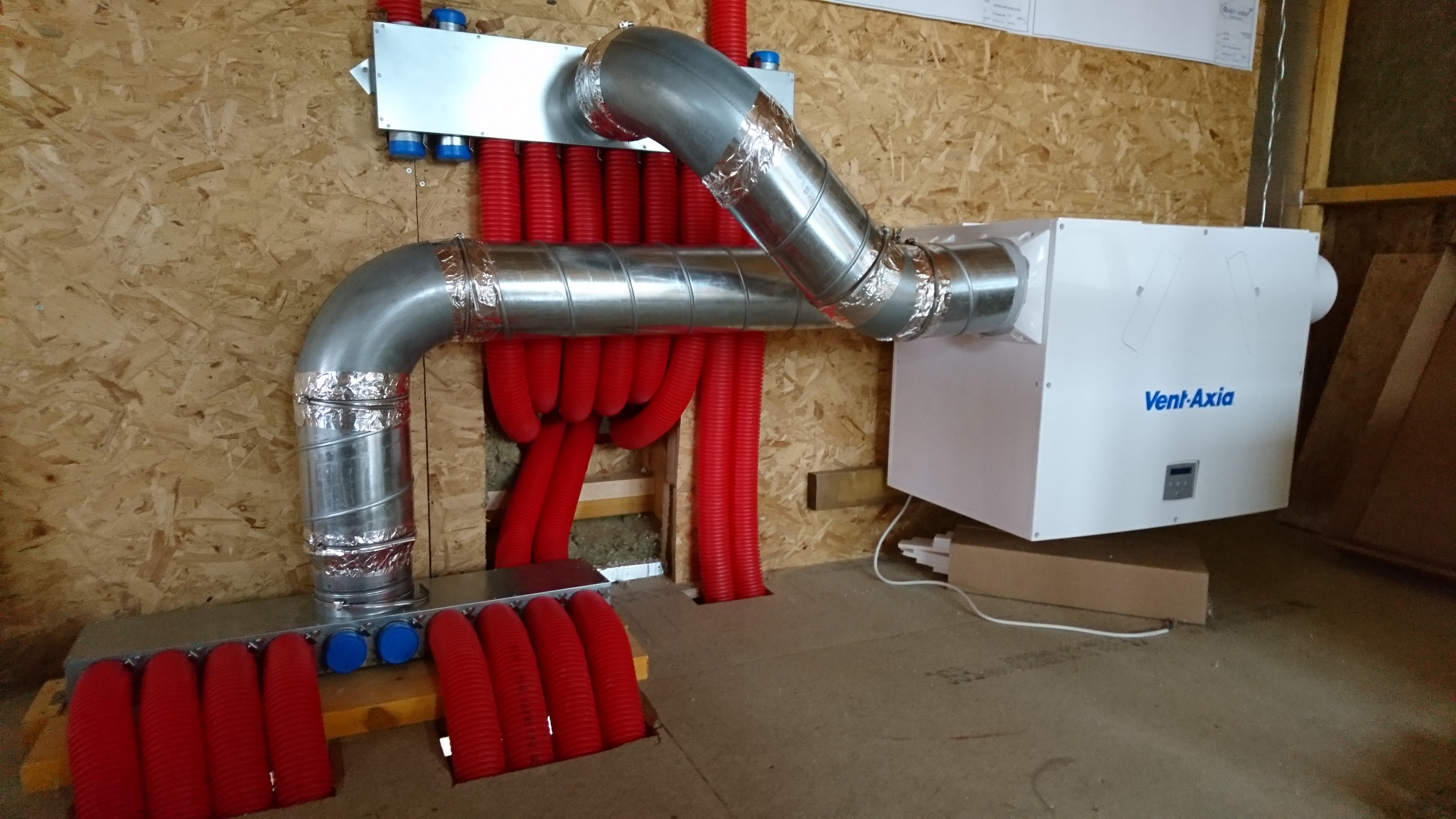

Mine wasn't done when this thread was new, but it is now.
is that the highest element in the system or is something taller out of shot? We have limited headroom in our proposed space but this looks like it would work fine assuming nothing taller out of sight.
sounds like a possibility headroom permitting. Are they MVHR specific mounts or ones that had just happen to do the job? I've seen a few suggestions of hanging from bungee but longevity sounds an issue.
I used a wooden structure hanging from  the roof but unit actually mounted on rubber mounts bought from ebay. Note the home made manifold / silencer on top made from ply and accoustic foam. My unit is larger than most , another ex Kingspan unit bought on Ebay.

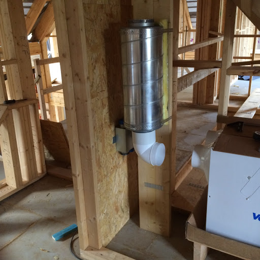

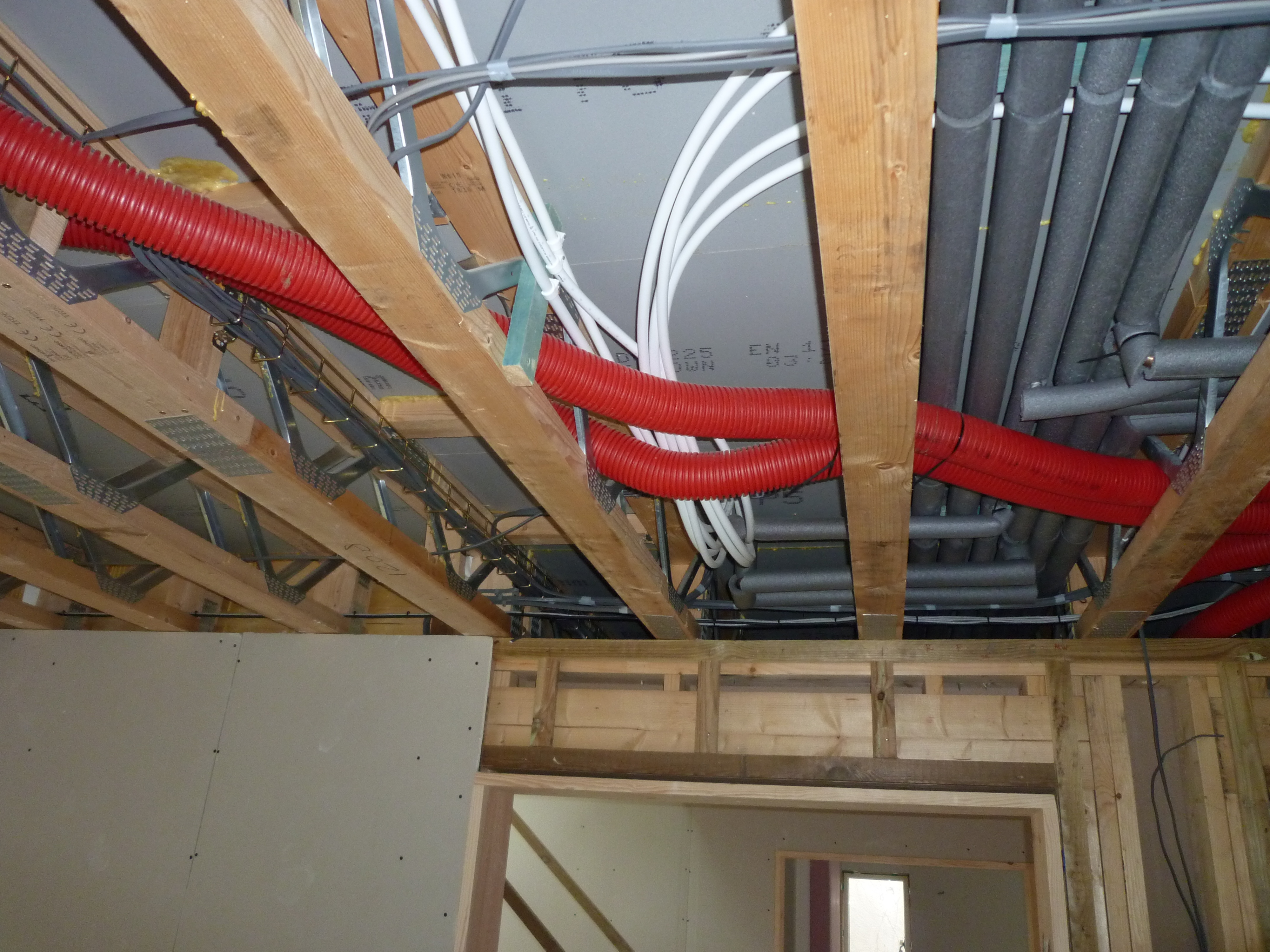

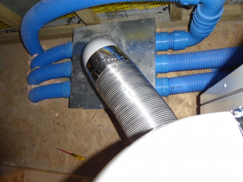

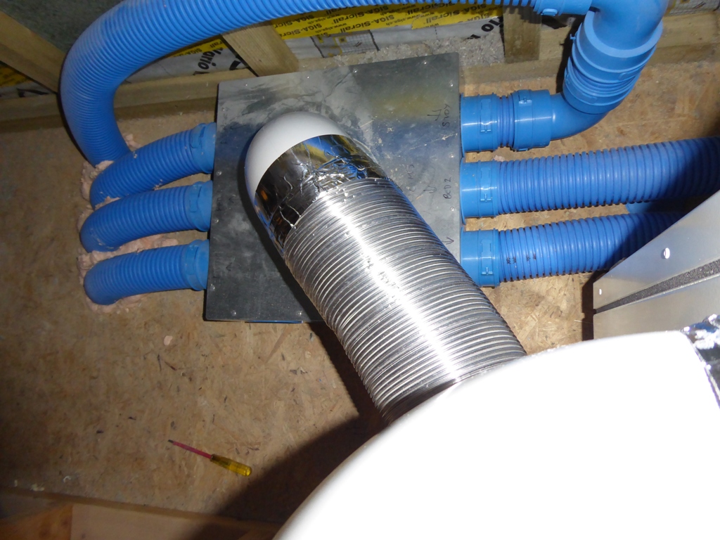

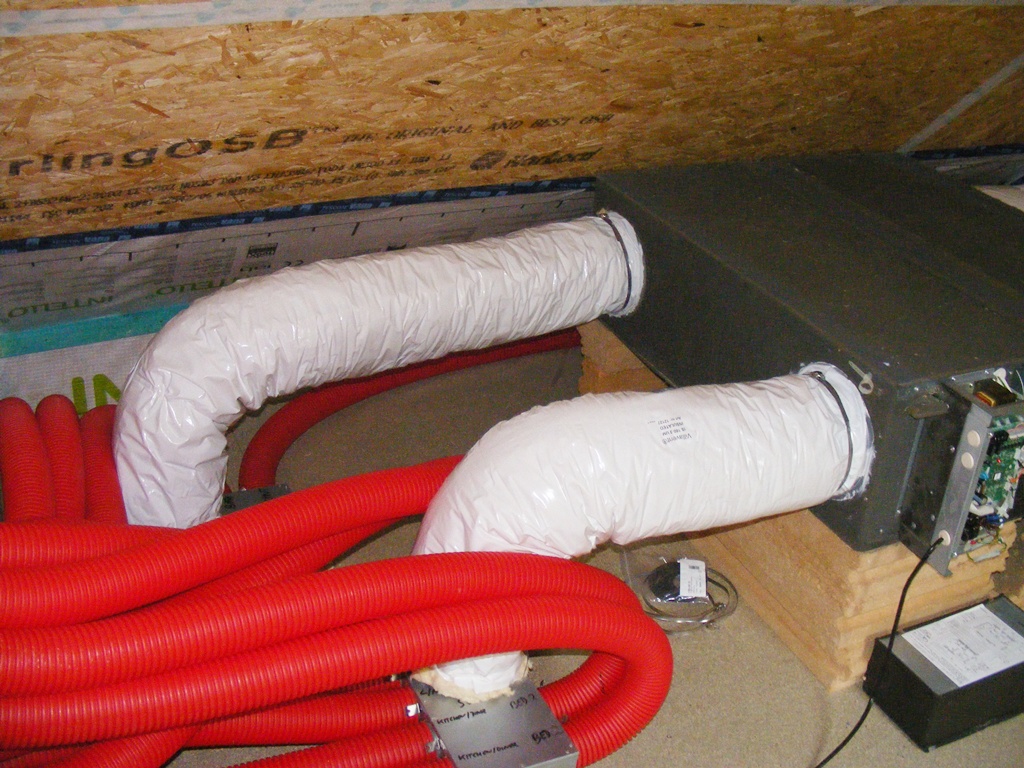

Here's a few of our installation. Running at the normal setting (30%) you can barely hear it.
Edited by RandAbuild
That's the highest bit in the plant room. I only set the mvhr unit that high off the floor so it matched the inlet and outlet vent levels, and that was an arbitrary decision when cladding and rendering the house. It sits on a stack of offcuts of wood fibre board thinking that would make a good anti vibration mount.
The two distribution plenums are on the floor. From there the pipes run up or down in a service riser, some to the loft for the upstairs rooms and some in the first floor void for the downstairs rooms.
The plant room will eventually double as a workshop, and I will floor over above the mvhr unit to make a storage platform.

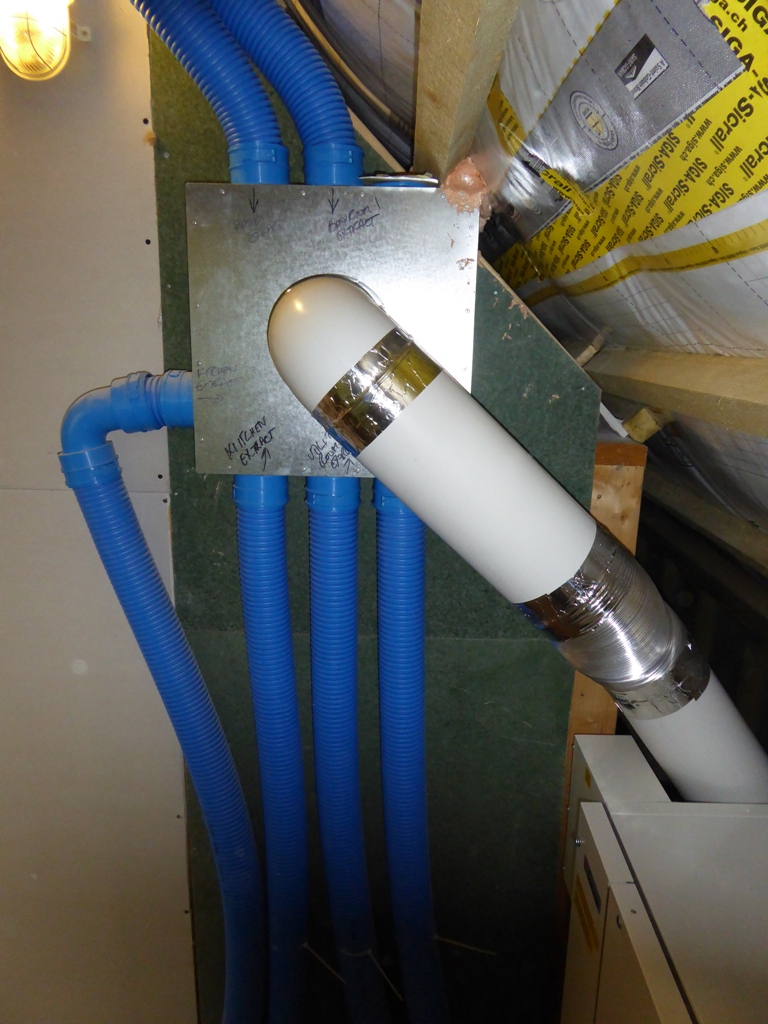

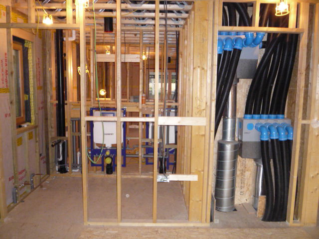

I  attach a photo of the supply and extract distribution plenums and supply silencer installed  in a service cupboard, which is located one of the 1st Floor bedrooms. This is remote from the MVHR unit. which is located in a Ground Floor Plant Room.  There is no issue with noise from the plenums.
