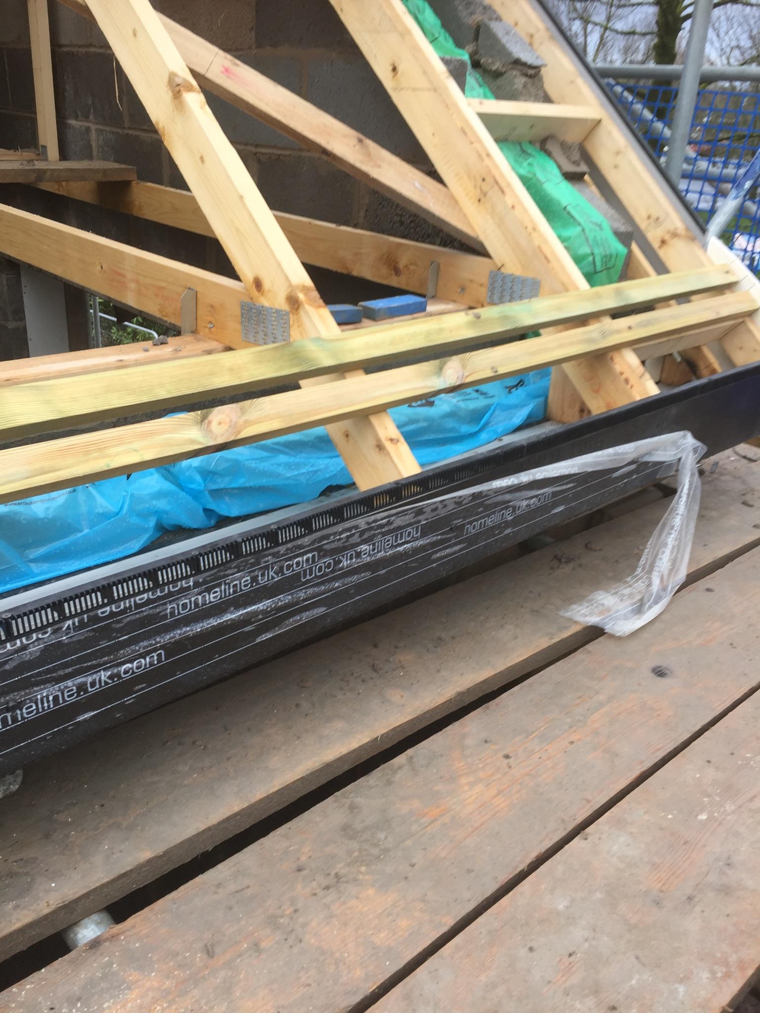

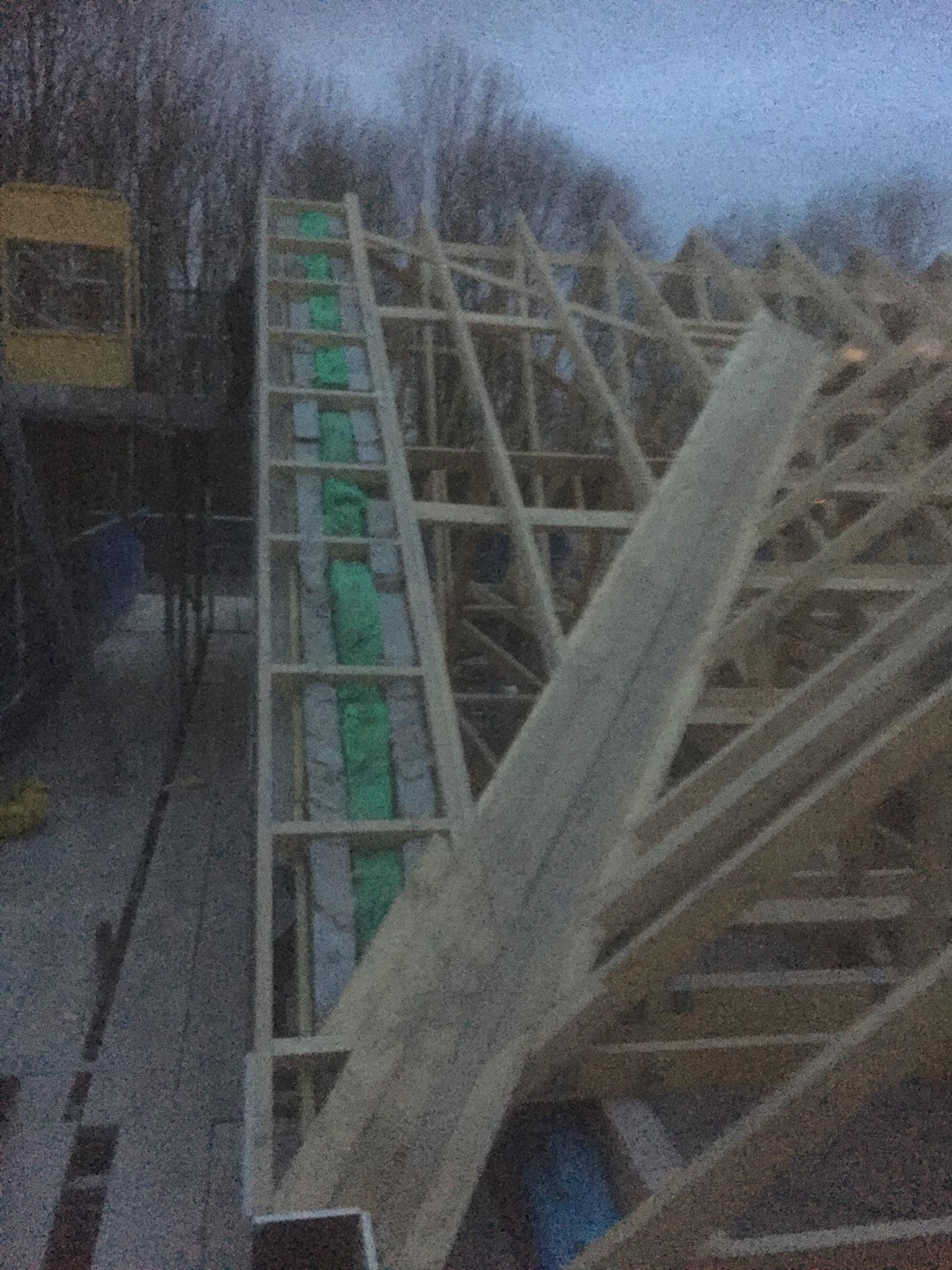

nod Posted June 14, 2019 Share Posted June 14, 2019 6 minutes ago, Triassic said: I’m at the cladding stage on my timber frame construction. Following the Grenfell disaster I changed from larch to fibre cement Cedral cladding and part renderboard and render. The TF company supplied lengths of fire stop, insulation in a red plastic sausage. Where does it go within the wall build up? Around the top of the roofline Pushed into the cavity There to stop fire entering the roof via the cavity Normally puncture each one as you put them in Link to comment Share on other sites More sharing options...

nod Posted June 14, 2019 Share Posted June 14, 2019 Link to comment Share on other sites More sharing options...

Onoff Posted October 8, 2020 Share Posted October 8, 2020 On 14/06/2019 at 09:47, nod said: Around the top of the roofline Pushed into the cavity There to stop fire entering the roof via the cavity Normally puncture each one as you put them in You say "puncture" as in make a hole in I assume. Isn't that defeating the object? Can't the fire get up through the hole? Link to comment Share on other sites More sharing options...
nod Posted October 8, 2020 Share Posted October 8, 2020 Just the way it’s done Just a stab to let the air out Link to comment Share on other sites More sharing options...
Declan52 Posted October 8, 2020 Share Posted October 8, 2020 When your nailing it to the outer frame it gets punctured plenty of times. Without doing it you would never get it down the cavity. Link to comment Share on other sites More sharing options...
nod Posted October 8, 2020 Share Posted October 8, 2020 8 minutes ago, Declan52 said: When your nailing it to the outer frame it gets punctured plenty of times. Without doing it you would never get it down the cavity. Exactly The plastic is just a cover to keep the sock together Throw one on a fire and see how long the plastic lasts Link to comment Share on other sites More sharing options...
