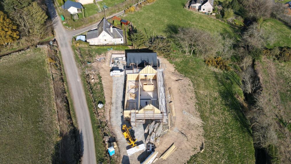

  9. It is. It seems to be the standard build up for HH flat roof. I’ve not done the service void yet so can make it smaller. I am using the mountain of material that HH over ordered. I just fitted the PIR then had a moment of doubt when the last board was in. 😂
  10. I’ll say that again but in English! I tested how big my offloading space was for turning using my Jimny and trailer and quickly realised it was pretty much impossible to turn around long vehicles without having to make multiple incremental turns. It would have quickly wrecked the surface. It already got churning up just with the tele-hanlder.

  13. The other thing to think about is how much hard standing to put down. Any soft ground will get destroyed especially if it’s wet. Same with verges on the road. I put a lot of hardstanding down right around the house so we don’t have a muddy bog that gets trailed everywhere and into the house. The downside is I’ll need to do something with all of this come landscaping time.
