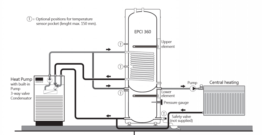

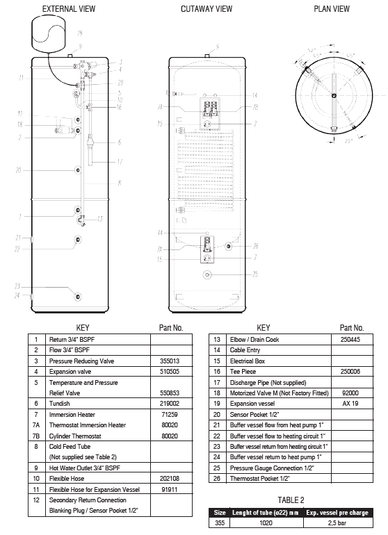

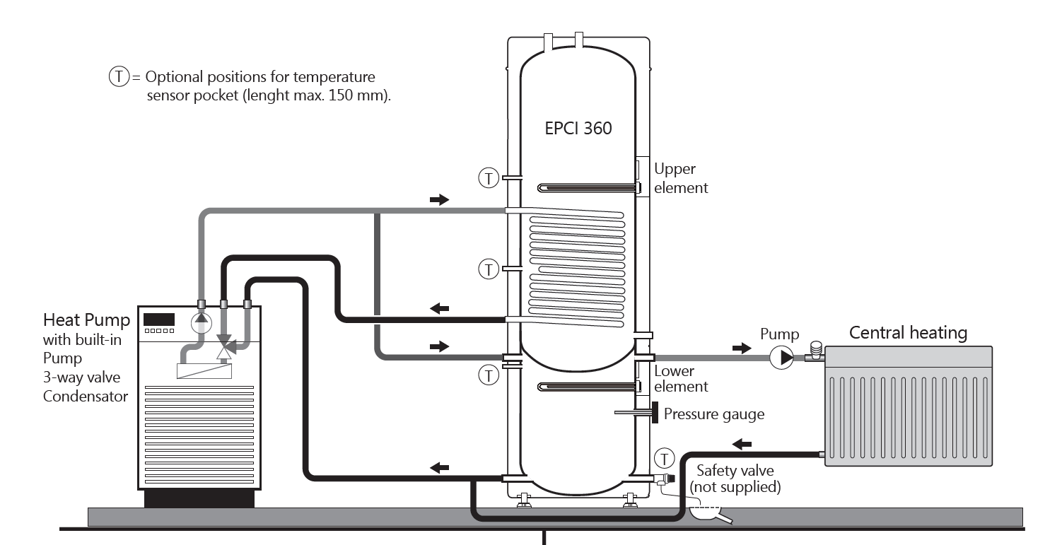

Hi Everyone, Can anyone offer any advice as to if the cylinder I showed is going to be suitable to use with a system boiler and UFH and three small rads. It is attractive as it keeps the two tanks in a single unit, and also has an immersion in each section. Is the fact that it is designed for a heat pump an issue?
Hi Nick Thanks for the reply, very helpful. The tank i am thinking of using is this https://www.ebay.co.uk/itm/OSO-Optima-ECPI-Heat-pump-cylinder-c-w-internal-buffer-store/113741035093?hash=item1a7b7e7655:g:70sAAOSwYkRc0rwF What do you think? I need to buy a new gas system boiler to power it. Was thinking the upper coil would give a faster re heat time, and both tanks have immersion elements in as back up and as somewhere for me to dump the 4Kw of PV to. I am struggling to 'design' the pipework to make it all work, not sure what needs to go where. So presume the boiler pump will supply to both upper and lower tanks, so a zone valve on each feed? Boiler controlled by stats in each tank Will I need a pump to pump to the UFh and Rads manifold( rads manifold on first floor) or will the pump on the manfold pull the water from the buffer, so a manifold pump on the rads manifold as well. Presume this one will not need a mixing valve. Going to duel fuel the towel rads, so electric in summer, or could divert PV to buffer immersion? Do I need some sort of bypass or non return valves in the system I have piped up all the potable stuff on a Hep20 manifold, and pressure tested with mains supply and it all works, so far so good. So now about to start piping for the towel rads and rads in 10mm Hep20 Do you have any recommendation for towel rails, was going to use stainless steel, seen these https://www.towelradiator.co.uk/stainless-steel-towel-rails Sorry for all the =uestions, trying to push on but wary of making errors in spec Found the forum to be very useful and insightful
