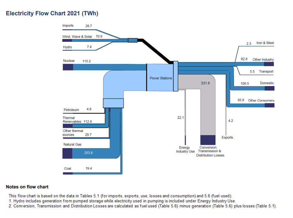

That's overwhelmingly conversion of fuel into electricity. Fuel -> heat is pretty efficient, but heat -> electricity is not. Efficiency for the latter process varies from ~30% for nuclear stations up to ~60% for the very latest gas stations. There are transmission and distribution losses, but they're pretty small in comparison.
