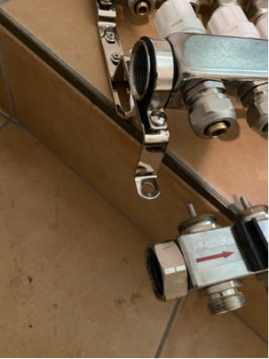

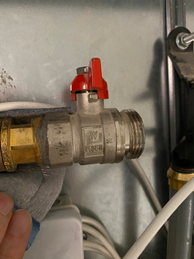

Thanks both. Seems to be a conventional thread. I will give Wunda a call and see what they say. Thanks!
Thanks for the response. Sadly it appears not - no hex or flats: it seem to be part of the casting.
After much procrastination I have started the replacement of one of the UFH manifolds with a shiny new Wunda one. Having removed the old manifold I can now see that it had a captive nut (probably the wrong term) to connect to the isolation valve - the Wunda manifold is just a fixed female fitting... since neither the isolation valve nor the manifold can be wound on to the other, I guess there must be a fitting I need but not knowing the name means a lot of searching has yielded nothing. Can anyone help me please? (Based in Luxembourg I will then need to hope whatever the fitting is translates into German and is available here - not always guaranteed...) Thanks for any help.
