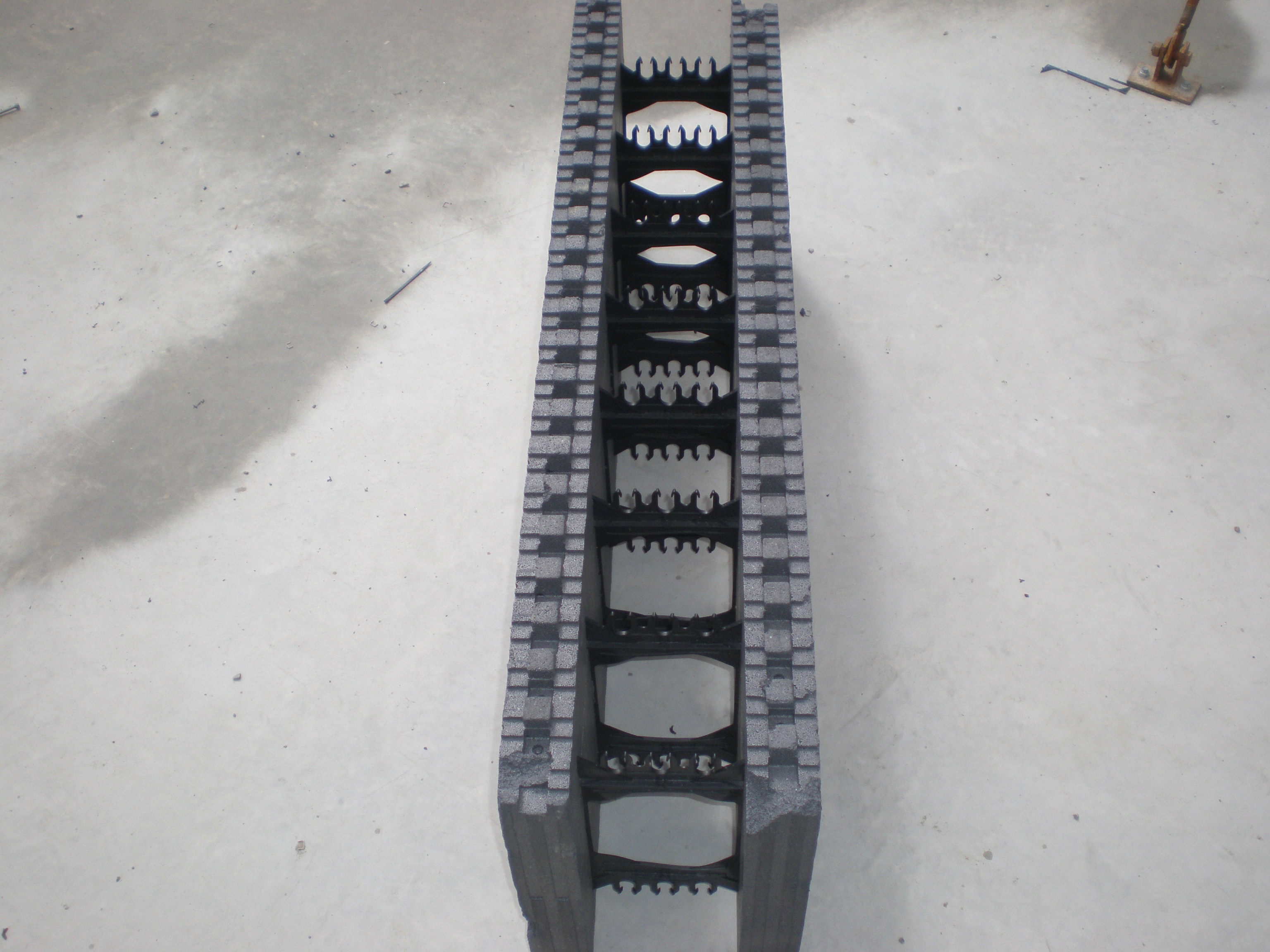

Our build uses the Amvic system. Don't see why you couldn't screw direct into the plastic ties (albeit longer PB screws needed) if you wanted. I'm guessing my contractor has stuck with battens and a service void as it is easier / more cost effective (as he believes strongly in both!) from his perspective.

Could do, although I suppose it comes down to preference. Both will take time to do. I suppose the main advantage of battens is there is then something easy to put fixings into, and makes screwing on plasterboard easier?

No, not at that stage yet, however it isn't especially complicated. Battens will be fixed through the polystyrene insulation into the plastic ties that form the core of the ICF block. My contractor is going to be using 25mm tile battens.

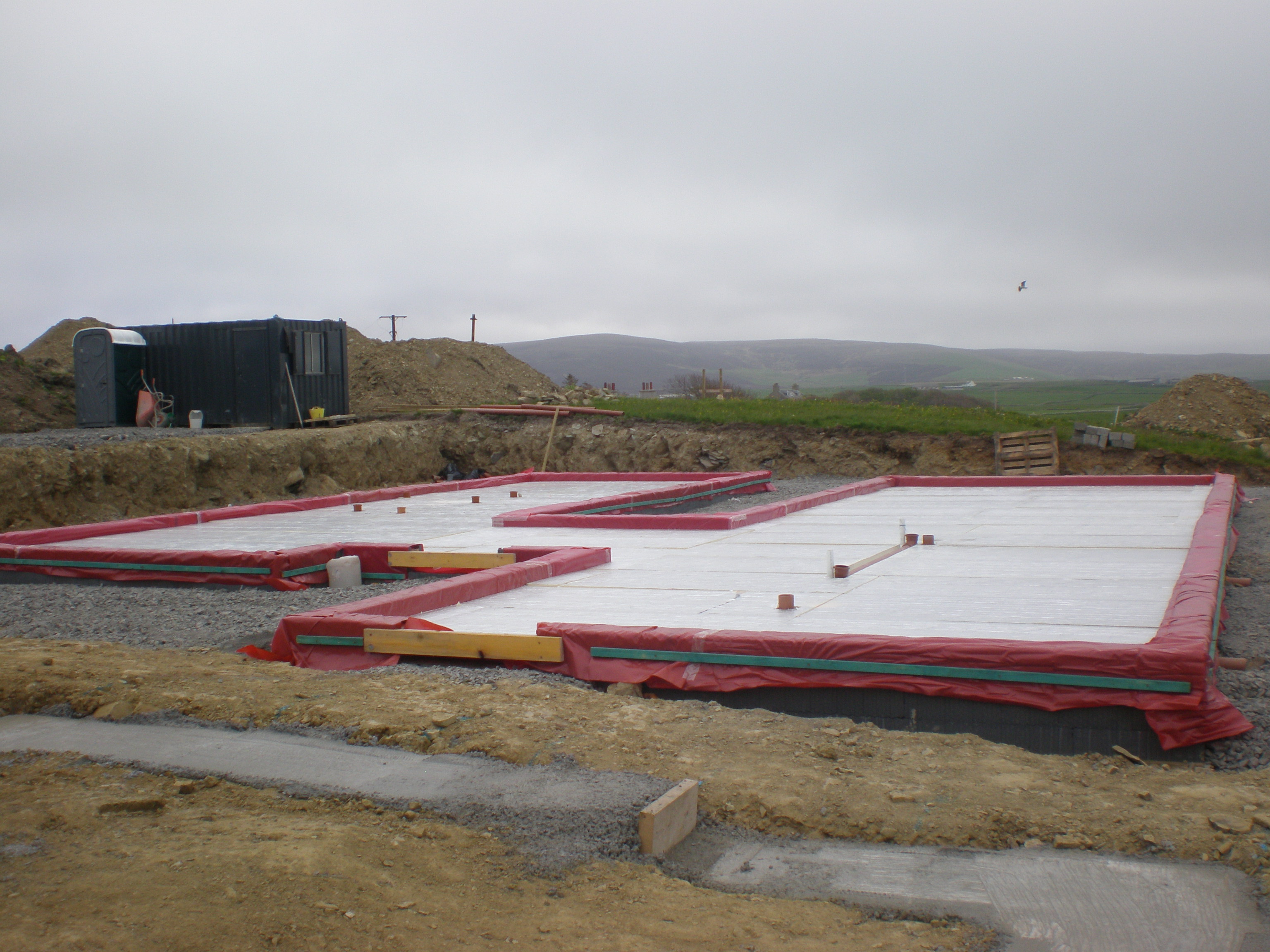

We are running the main runs of our pipework and wiring in the roof space, dropping down into a service void created using battens onto ICF exterior walls, or through internal partitions as appropriate. My contractor certainly believes battening out to create a service void is far quicker than chasing out the ICF block. We also have a kitchen island, and as suggested above, we have run two ducts in the under slab insulation to get electricity and water to the island. The water duct is a length of drainage pipe so should be big enough to take both hot and cold water pipes that have been insulated with armaflex or similar. You can see the two ducts sitting in the underslab insulation ducts in the picture below.
