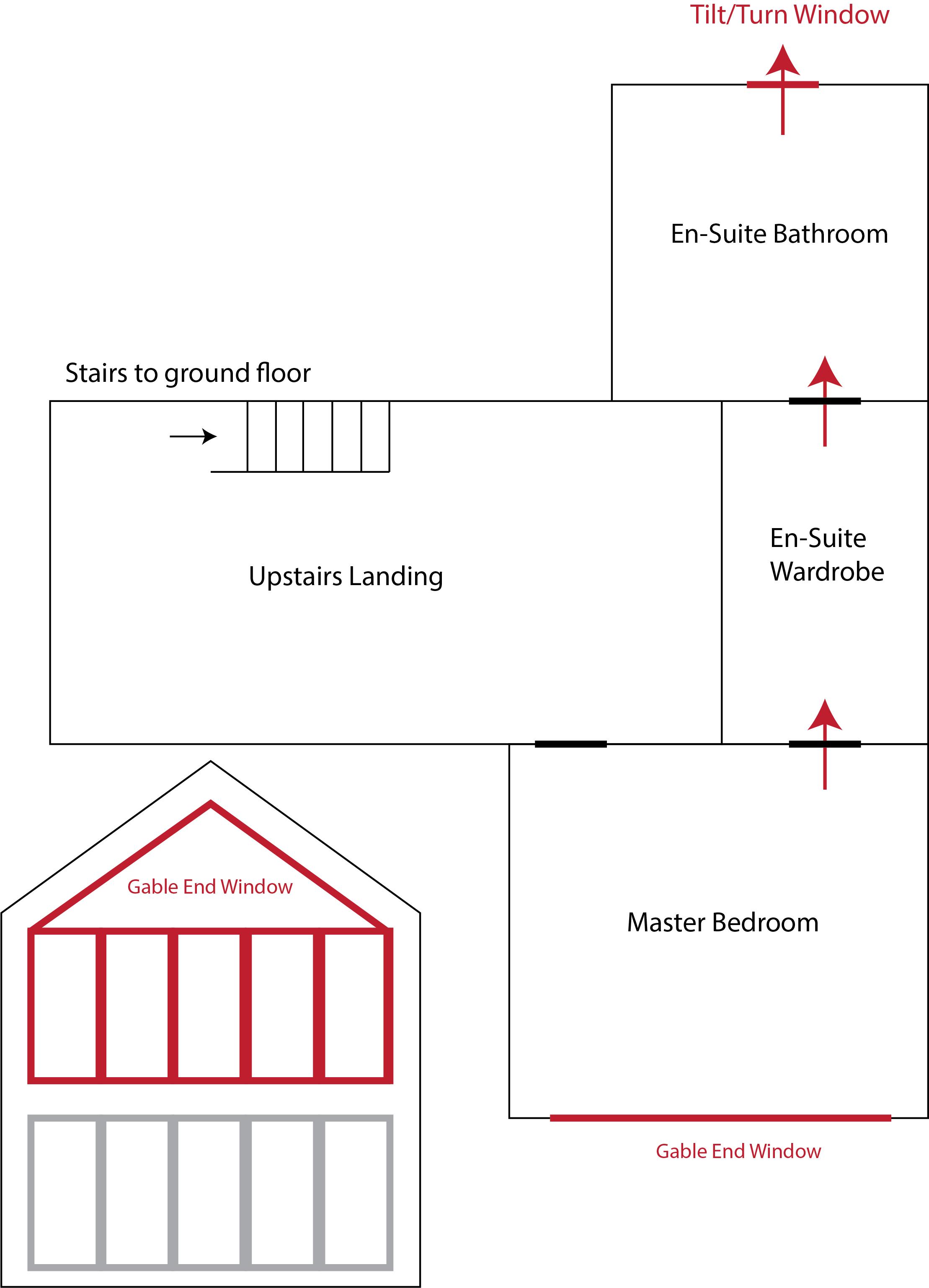

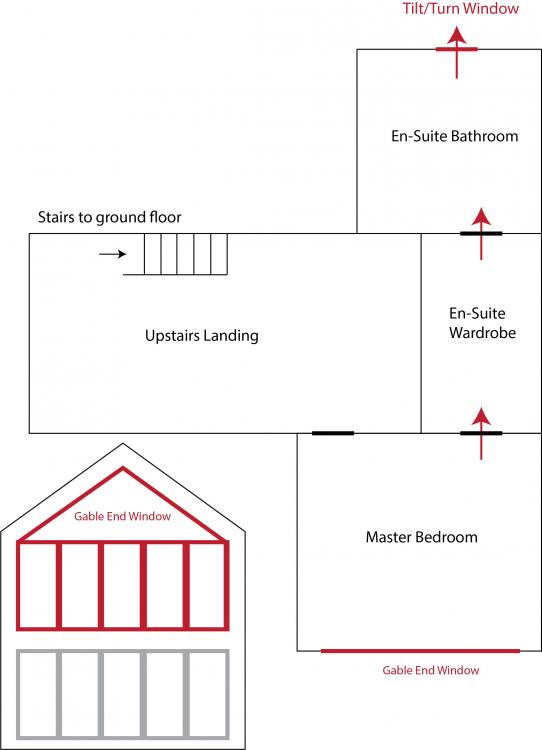

Thanks. Just to clarify we have a another bedroom below the en-suite bathroom with an escape tilt/turn directly below. Sorry can I ask what you are referring to as the DR, BR and US? ? Perhaps if we remove the door into the en-suite wardrobe we may get away with it...I would try anything to stop having a lump of a door on the top gable window!
Hello Folks, So its slowly getting to the stage where we need to decide on our windows! One area which we have been banging heads over was what arrangement we wish to have with our large gable end window which incorporates the ground floor living room and upstairs master bedroom. As per building regulations we are aware that every 'habitable' room is required to have a means of escape. In our case for our master bedroom the only means of escape appears to be the gable window which is comprised of 5 panes, therefore one or more will have to be tilt/turn windows. This is something we are trying to avoid as it will add a certain 'bulkiness' to the gable window to incorporate the mechanism which tilt/turns have. However after further investigation into our building controls policy they state 'Escape windows are not necessary from rooms where there are alternative routes from the room to circulation areas or other rooms' - therefore given our master bedroom leads to an en-suite wardrobe then onto a bathroom which has a tilt/turn window suitable size for an escape window could this possible be an alternative option opposed to using the gable window as fire egress? I have put together a very basic diagram (attached) to show our layout, apologies for the basic drawing however hopefully it shows everything! Would really appreciate any input or advice. Thanks
