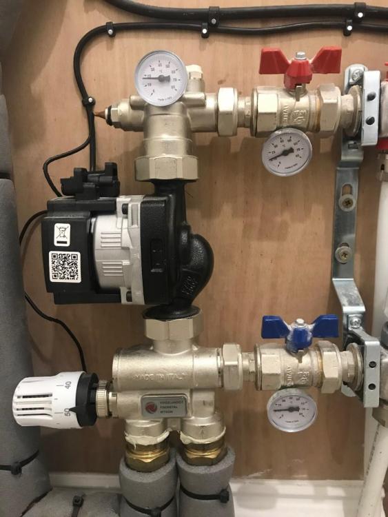

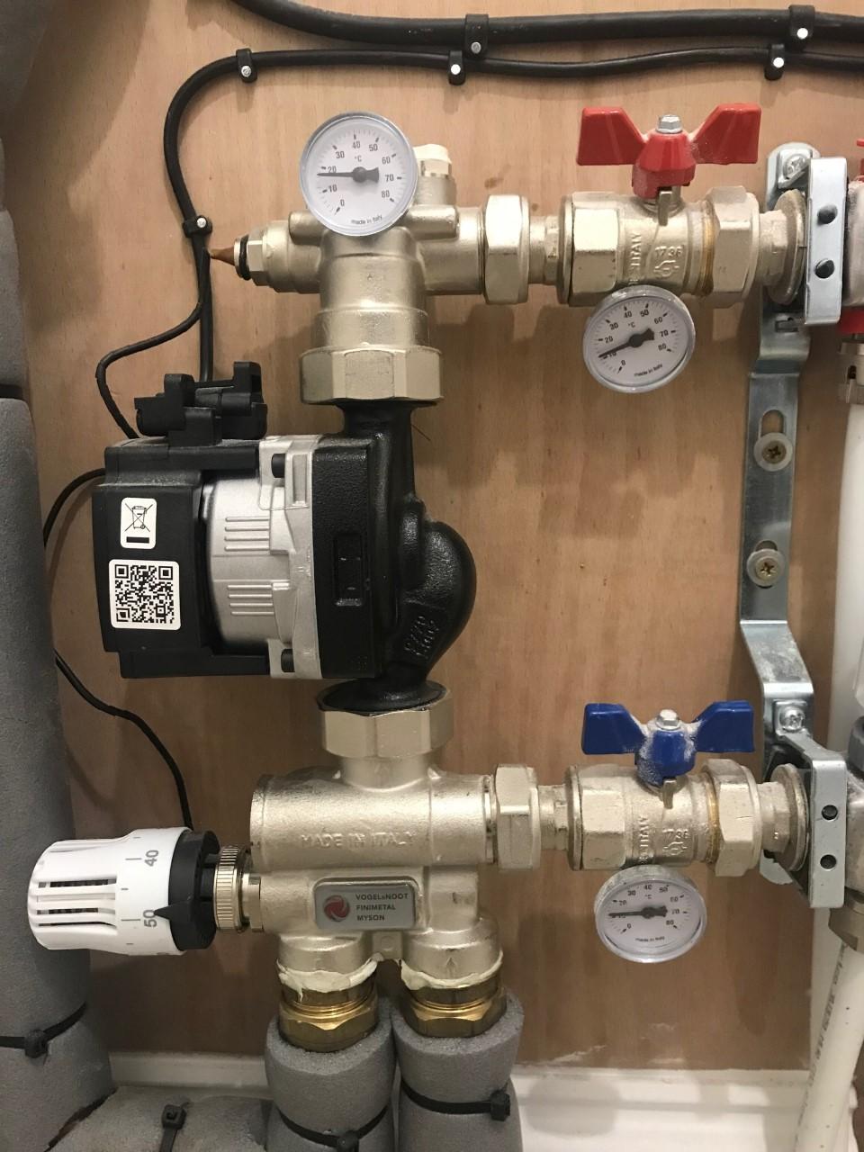

Thanks @Ultima357. I can confirm we are running oversized radiators with a 50 litre buffer tank. I have attached a picture of our UFH manifold setup. The thing that confuses me is if the ASHP is set at 50 degrees for heating will lowering this thermostat contradict the ASHP and cause issues? Where will the 'extra' heat go if we were to set the thermostat to say 45 degrees? -

I have noticed by reducing our heat setting lower overnight does indeed save us money, all be it small but it is a saving! Can anyone shed any light on the query regarding the UFH temperature? I would like to know what determines the correct thermostat setting at the UFH manifold if our ASHP output is 50 degrees for heating - therefore should the UFH heating be set at 50 degrees also? -

Thanks @SteamyTea Is there anything which can assist me in calculating the heat loss? On another note I understand there is a thermostat connected to the UFH manifold which is set at 45 degrees - how can I determine if this is an adequate temperature? I assume if this is set too low the ASHP will struggle to heat the rooms to the set temperatures and never be off. On the other hand what are the consequences if this is set too high? -

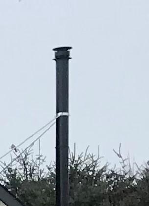

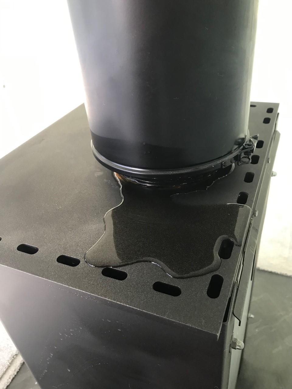

Yes twin wall. At first the liquid was quite oily/watery to touch, when hot it stained the stove white. Now this time it seems to be just water, there is no oily consistency to it now. It certainly isnt black or sooty coloured Your theory seems the most likely actually. It would make sense as there is no wetness inside the stove. What exactly is inside the insulated part of the flue, would the water be absorbed into anything? Hence the time it takes to reach the bottom of the flue?
Sorry I am confused with this bit, do you mean the flue diameter shouldn't reduce before the stove?
The last time we had rain was at least 3/4 days before this and we last had the stove lit around 1 week ago. The flue pipe goes through a rubber seal at roof level. @TonyT far as im aware its just solid twin wall flue pipe sections straight up Either way I will get the installer back out, I just wanted some advice encase I get told some BS
Hi @Carrerahill That does make sense what you are saying about damp wood. We aren't in our house yet so have been trying to burn off the 'new smell' you get from a new stove with only logs, no other fuel. This wood should be very dry, I wouldn't say its 100% dry but it was cut 2 years ago and left to dry under cover. The only thing perhaps is because we haven't got the stove up to max temperature yet? We just light it with a couple sticks now and then, given we aren't living there we don't want to be waiting for hours until it goes out! Thing is this water doesnt appear the day after we light it the stove, its more like a few days or even over a week. We do not have any moisture or wetness inside the actual stove, only on the top. The stove is only a 4.1kw so not massive.
thanks @ProDave I assume this would mean if water is getting out then smoke/gas will almost certainly get into the room?
Hi Folks, Recently had our wood burning stove installed (all above board) by a qualified stove fitter and noticed the other day we have moisture on the top of the stove, didn't think much of it as we have hardly used it (maybe twice before this) and thought perhaps its condensation etc. However yesterday we now have a little pool of water sitting on top of the stove (picture attached), strange thing is we haven't had rain for a few days - only frost. Twin wall flue with cowl on top etc What on earth could cause this to happen?! ?
