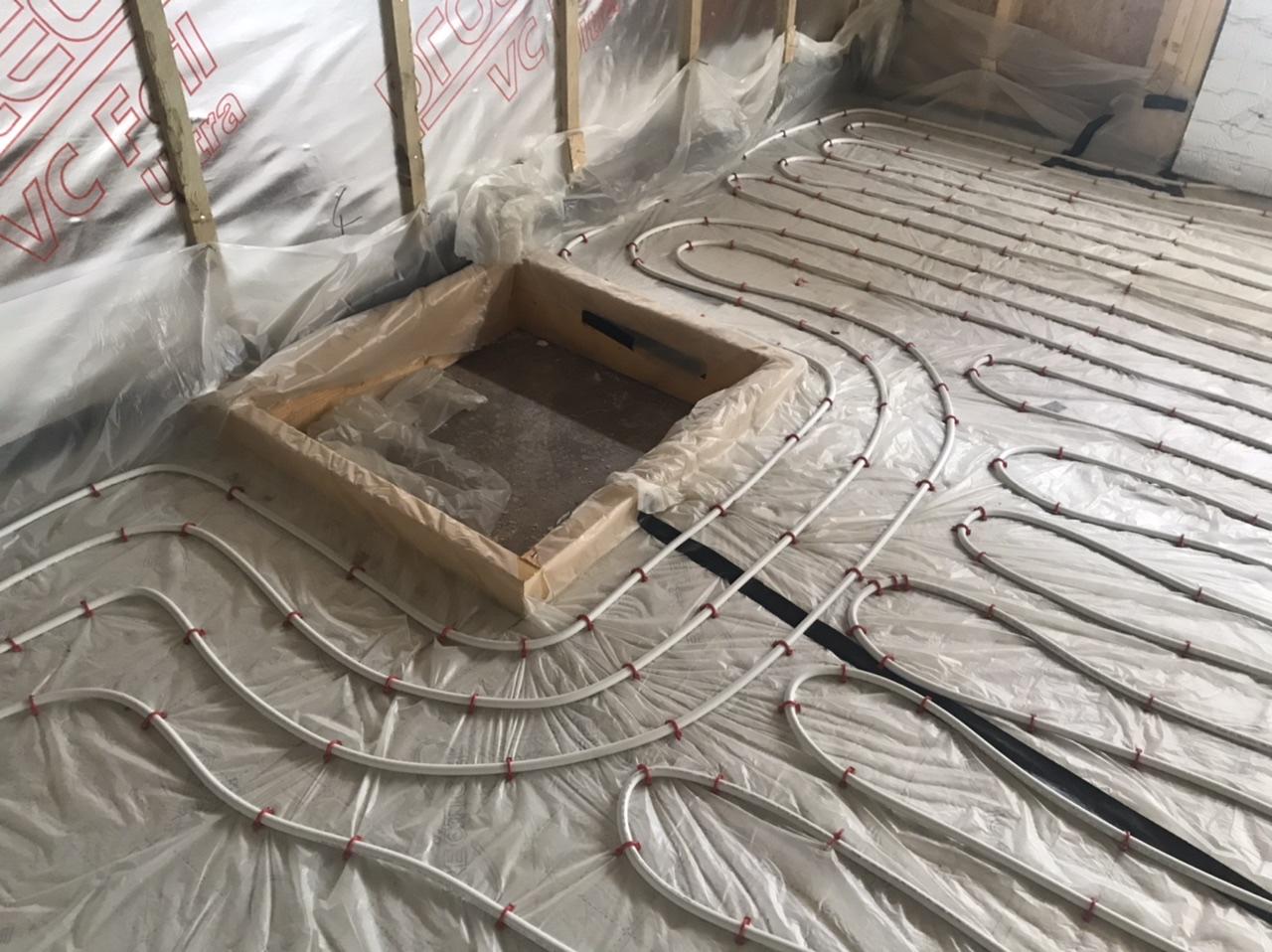

  6. Thanks everyone for the helpful information and links. It would seem this constructional hearth isn’t really required given many stoves seems to reach a temperature less than 100c. so I guess my main question now is can the slate or whatever material we choose to sit the stove on go over the UFH pipes below? For example is we have a slate slab which is say 2m in length. Our constructional hearth as in photo is 1m wide meaning 500mm overlap either side which would be overlapping the pipes somewhat. Would this be ok?
  7. I am not 100% on the depth of the screed but 100mm seems about right. This begs the questions what is the point in the constructional hearth if the screed + slate will be sufficient?
  8. Thats concerning - what size would you recommend? I was hoping a 1m x 1m constructional hearth would be enough to contain the heat from the stove and we would be ok to have a slate slab wider than this which may overlap the UFH pipes?
  9. That’s interesting thanks, your hearth looks nicely proportioned with your stove. Our stove will be free standing. i believe the ‘visual warning area’ is basically what defines the ‘danger area’ around the stove, so in your case it would be the black block. The constructional hearth is the concrete below the floor. From what I can gather if your floor does not have UFH the constructional hearth is basically the entire floor given it will be concrete, however if you have UFH pipes the constructional hearth needs to be dug out as in my picture.
  10. Hey Folks, On to the wood burner now! Question relates to the constructional hearth and what is referred to the Visual Warning Area - from what I gather this is usually the raised area around the stove, usually made of slate etc. We have the constructional hearth in which is 1m x 1m, this was done before the UFH pipes were installed for obvious reasons. However I am concerned this will be quite small to sit a wood burning stove plus all the other utensils etc. Given we have UFH pipes around the 1m x 1m area can the VWA (slate slab) be wider than the construction hearth beneath and partially cover some UFH pipes? The screed is to be poured on top of the pipes obviously with the wooden shutters to construct the hearth. I have uploaded an image for reference! thanks

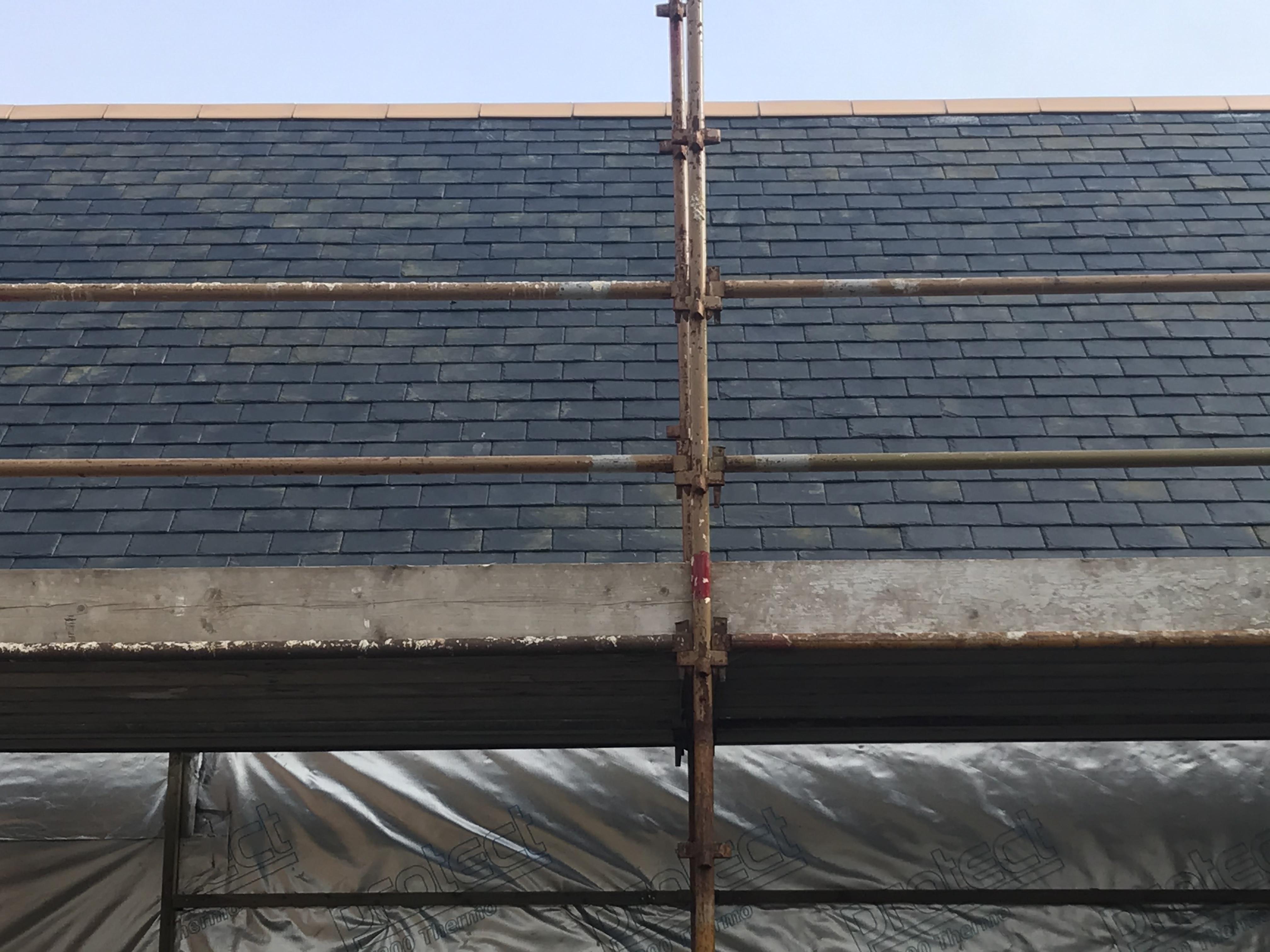

  11. To conclude this for anyone interested in the future it would turn out you get what you pay for, the Cupa Heavy 3 is an excellent looking slate with no discolouration. Apparently this occurs when there has not been adequate quality control with there being too many 'oxides' present in the slate causing a rusty look.
  12. Anyone have a rough idea of the going rate of the Cupa Heavy 3 right now?
  13. Yes would be interested to know what experience you have had with them...it would seem you really do get what you pay for when it comes to slates. Although from what I can gather it can be down to having a skilled person to fit them, it’s just not a case of throwing them on..they have to be sorted to an extent by thickness and get rid of the odd bad slates? Maybe someone can explain the process further!
  14. Thanks. i do realise there’s will be variations however why do some houses have flawless slates which don’t have too much variation. Would this be due to a cheaper slate? No so stringent selection process compared to say Cupa Heavy slates? I am a fan of @Thedreamer house and the Cupa Heavy 3 slates as shown on their blog, it looks really good and no ‘patchiness’ to the roof...
  15. Hello, Quick question regarding slates. Can anyone describe why the attached picture of slates has discolouration in some of them? Making the overall look very ‘patchy’? Is this common? We are looking out for slates for our build, originally we wanted Cupa Heavy 3 (not pictured). Has anyone used this slate? thanks
