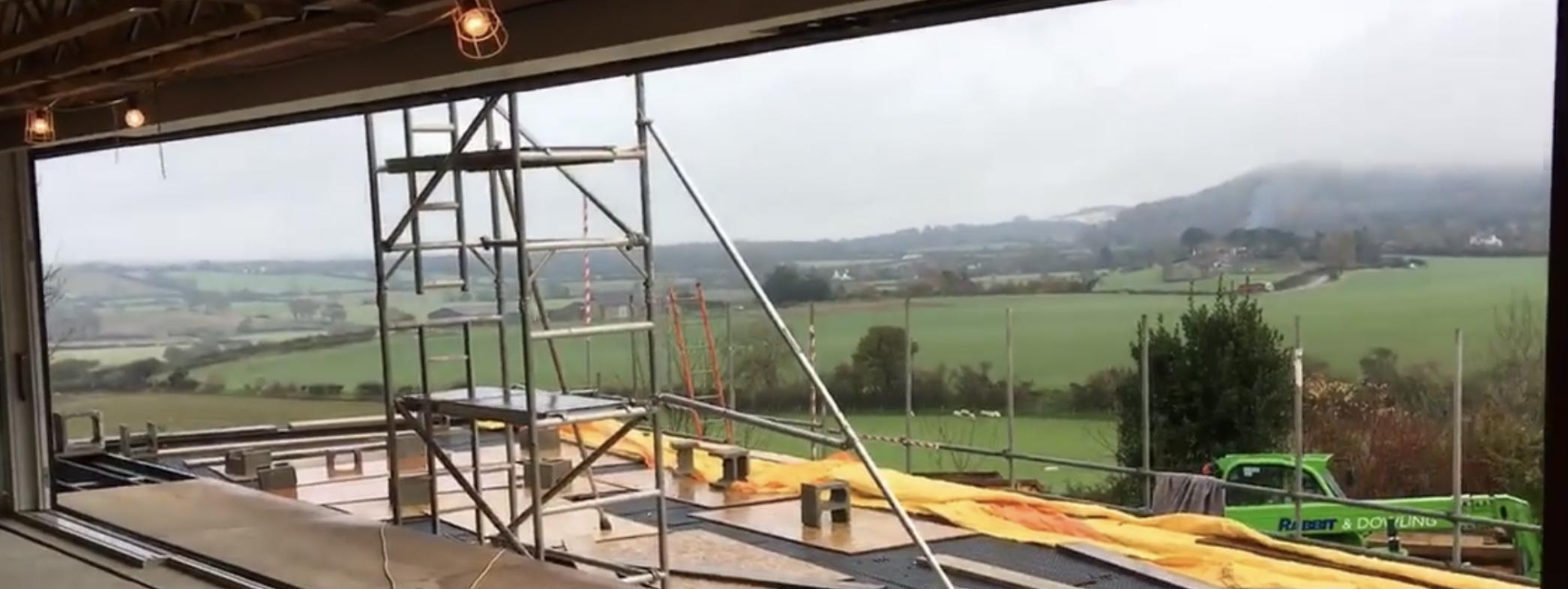

It’s 19.5m overall ? Edit: I should mention, I was against this. It was the client who was insistent but we knew we could do it. It is a custom made slider and won’t be done again.
When the correct checks and tolerances etc. are done, they are a thing of beauty (this is a 12m clear opening). When they aren’t they can be a pain in the a***

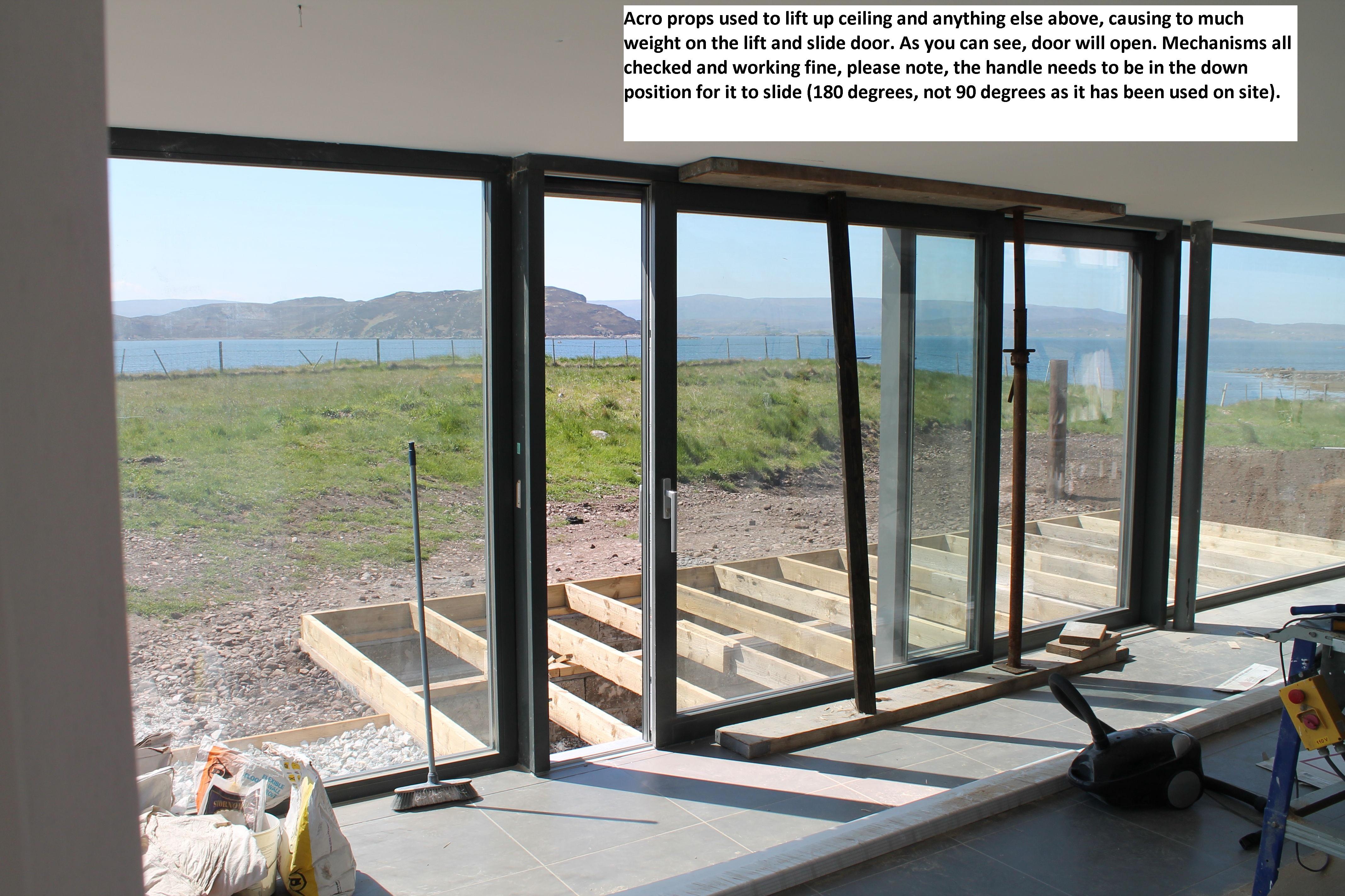

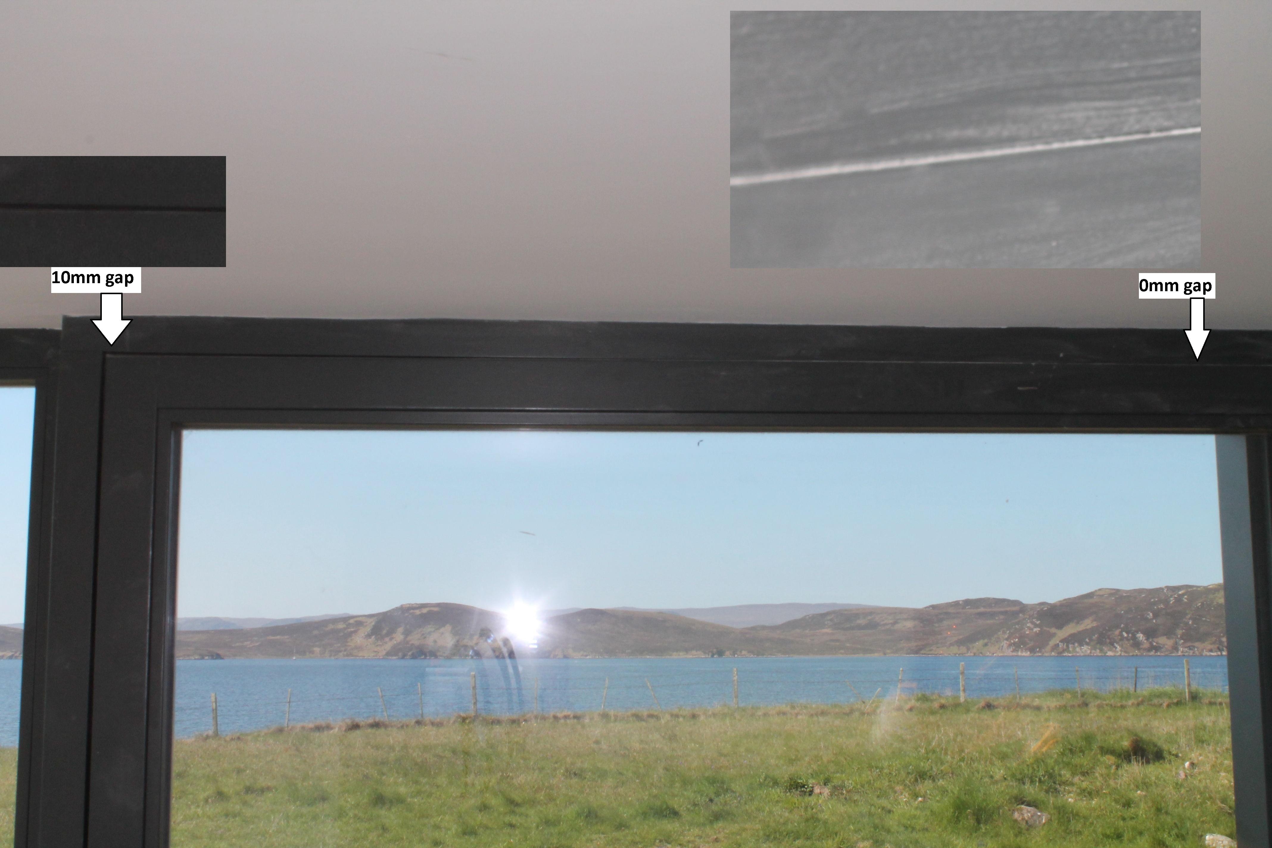

Resolving the weight issue above was down to contractor. However, we advised to remove all the PU foam that was used above and replace with Compriband. Second option was remove the sash and either take 5mm off the top of the sliding sash or take the rollers out of the sash and rebate them in further (5mm) to give the clearance required. A quick fix, is sometimes you have the guides that sit in the sash and in the track. You’ll have them at the top of each vertical section. These are plastic usually and if you remove one side at a time. You can shave them down a touch to give a little extra clearance. The issue was resolved and doors work freely and have done for 10 years.

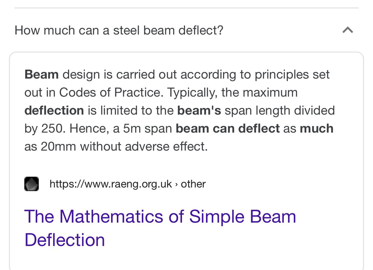

I'd be expecting the steel to deflect in the region roughly of 10mm/15mm but would need to be confirmed by structural engineer. Where's the sliding door being installed? Directly under the steel lintel? If yes, what tolerances have been allowed for? Did they ask what the steel deflection was? What is the material being used for the insulation by the install team? A solid PU foam or a compriband only? If they've only allowed 10mm and the steel deflects by 10mm and they use a solid PU foam. The steel pushes the PU foam, which pushes the head of the slider, which then compresses down onto the sash and then it won't open. Here's a prime example, one of my projects but a supply only. We don't always get it right. However, no one could supply the deflection of the lintel, builder didn't follow our instructions and I allowed 20mm tolerance in the head and 10mm threshold (30mm overall) just in case. Still wasn't enough.
Post some pictures and I'll give you my professional advice. What I'd be looking for picture wise/measurement wise, are the following. Manufacturer and model of sliding door Measurements at 3 locations from the inside threshold to the top/head (underside) on the left, middle and right (i.e. measurements within the frame) If lift and slide, when door is closed, measurement of the gap at 3 locations (left, middle, right) and the same measurement when the door is lifted (open) Does the door slide freely or does the door move freely for a bit and then become stuck and then move freely again? Does the door move freely when handle at 90 degrees but difficult at 180 degrees (lift and slide model) Level on sides (laser ideally) Level on threshold (laser ideally) Level on head (laser ideally) Measurement from corner to corner to check for squareness of frame and sash(s) Level if possible to check if the door is straight - being out 3mm/5mm can cause operational difficulties I would say, that 90% of the time it is a deflection issue or something has cause the threshold to rise at a specific spot. No one seems to take into account that as the roof is put on, other items are installed etc and over time. The building will settle, that's why tolerances are important and deflections taken into account. There could also be warping/twisting of the frame at play, which would be a manufacturer issue. It's not always as straight forward as it being an installation issue, numerous factors can be at play and generally could and should be prevented during the planning/detailing stage by asking the right questions. Which in my view, becomes a supplier (not necessarily manufacturer) issue. Irrespective of who installed the product.
