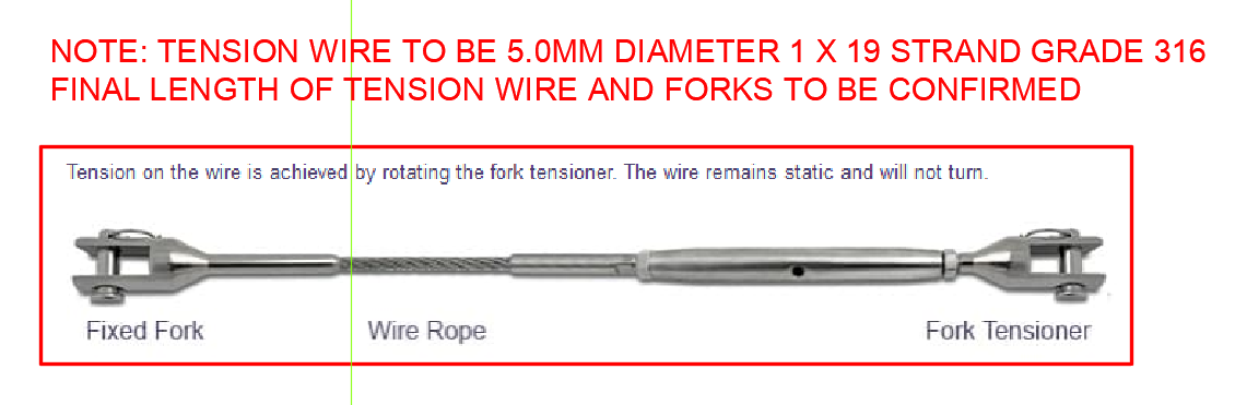

Hiya. Been busy with the day job but saw this post. Here are my thoughts.. It's got to start with the Architectural appearance.. I think when you look out the doors you need to see something slender on elevation. In other words you don't want to be seeing a heavy top hand rail on elevation or heavy ballusters. I thought.. try horizontal tension wires for the ballusters.. but they are climbable for kids.. rule that for now.. but look on the internet how pubs etc do it where they have a heavy handrail and cantilever it in to make it difficult to climb. Structurally I would look at taking some pretty slender corner posts up from the side walls (to the left and right of the doors at the green roof end) say 50 x 50 mm box section as it allows you more scope for fixing them through the cladding at the bottom. I would then form a standard welded guard rail / balusters with a bottom runner, maybe 20mm box section as ballusters and a top rail of your choice. This will be pretty stiff and will carry lots of load along it's plane. Normally we design these things to resist load perpendicular to the hand rail. We still do this but do some extra checks to get the hand rails to deliver more. This is the key as now you have something cup the side to the left and right of the doors that will stop the section parallel to the green roof form moving towards or away from the doors. To design the bit that separates the green roof from the balcony I would do the same as above but make the top rail out of.. (I'm guessing here as don't know the length) say 180 x10mm steel flat plate. This on elevation is a thin profile and would also give you a shelf you can sit you morning coffee and croissant on.. or whatever. To design this structurally it's quite complicated as you need to know about fixings and stiffness of a typical hand rail / balluster assembly. One secret is to avoid bending forces in and around the fixing location and convert all the forces to shear forces that better suit fixings. Proving it takes a bit of effort. Design cost say two and a half days to; draw it Architecturally and get the look right, do the calculations including fixing design, do a steel fab drawing and explain to others what they should be doing and answer any later questions that folk phone you up about and a bit of a hassle factor. Call that £1200 ex vat.. seems a lot but you pay for the expertise and knowledge. You can save the vat if you find an SE / designer that sticks below the vat threshold. Mind you you could easily blow much more than my budget design fee if you get it wrong.. also you'll have to live with it if it looks rough. Think of slender, breakfast or some G&T on a nice night sitting on that flat handrail plate.. no worries about puncturing the roof and it leaking in the winter! -

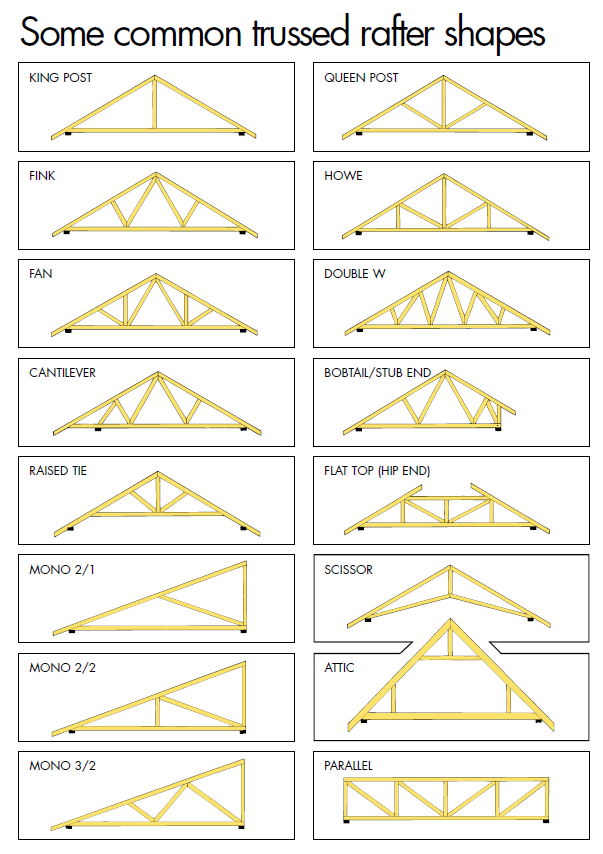

Hi Chris. Had a look at the link to your blog... looks a great project... keep posting! I'm wondering if what you have is really a true bow string truss in the Misson hall, it looks more like it could be what we would call a traditional raised tie truss. Once the amount of "raising of the tie" gets beyond a certain point they often rely a bit on thick walls to prevent some of the spread. What's the wall construction? Below is a diagram of common prefabricated trussed rafter shapes which can be handy when trying to describe roughly what you think you have. There are many different types and variations of roof. Traditional roofs often work in a similar way but common ones are the King / Queen and raised tie. I think I can see where you might be wanting to do re hanging a part Mez floor from the roof assembly. I take it the floor would fly past the windows so you have part of the window below the floor and part above? You've got me thinking. There are a few things worth having a look at..but all this needs to take account of the location and material delivery. My Sister lives on one of the Islands.. some folk buy a camper van and use that to transport materials to the Islands. Be careful as if your van is sitting on the axle stops and you're all dressed up in you building gear Calmac (ferry operator) et al may ask to look inside and make you pay for a commercial vehicle. Anyway within reason you could have a look at forming a ridge beam to run gable to gable with a bit of intermediate support to support the mez floor. It would be a long beam thus not practicable to get to the Hall in one length. You could use short steels (that fit in your van) and bolt them together.. messy. Another option is to turn this into a joinery excercise and see if you could form a parallel timber truss (see diagram below) on site to run gable to gable. You would form the connections with plywood gusset plates and a structural glue (Cascamite or similar). This is much more flexible as if you make a mistake it's easily rectified as you're using off the shelf timber and ply. The mez floor could be hung from this.. Your in the middle of the ocean so Architecturally a Nautical approach is a good approach? I don't know if you going for a traditional look or would consider a mix of old and contemporary? Anyway say contemporary. I'm thinking tension wires may be a good option for hanging the mez floor. I've got a job on at the moment and I'm using wire assemblies to strengthen a roof truss that come as a kit as it's a small domestic project. The loads I have on this job are pretty small so I was looking for the thinnest wire I could get away with architecturally. Have screenshotted a bit out my CAD file below and the web address is: https://www.s3i.co.uk/fork_fork_tensioner_wire_rope_assembly.php# Caveat.. I'm not affiliated to the supplier, don't warranty their performance etc. However a big plus point is they provide declared loads for their assemblies which we as SE's need to have and as the come pre assembled we don't then need to test them on site etc. Surprisingly the prices are pretty reasonable for small quantities and they deliver.. well hopefully they will when the Client buys them.. At some point is does look like you'll need an SE to guide you and make sure what you are doing is safe. As your on the Islands you'll need to stick to the book regulation wise or the locals will shop you if a newcomer, until you settle in an become resident. That's it for now.. hope some of this helps.
