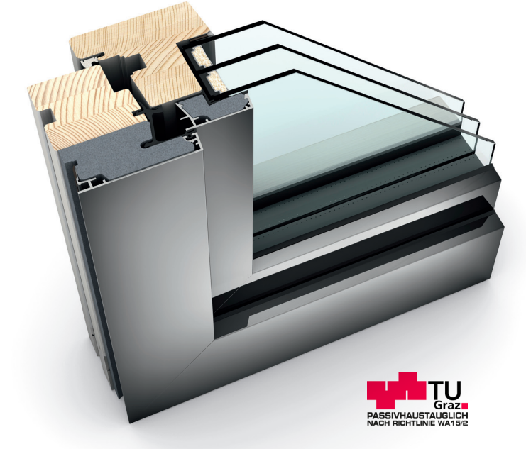

If internal temp is still at 20°C, then dew point is up to 13.7°C with 67% RH. So, yes, inner pane is above dew point. https://www.calculator.net/dew-point-calculator.html

RH inside will tend to drop when it's cold outside. Mine is in the 40% - 50% range at the moment. I'd normally be at around 60% in the summer.

I've got the 310's with the foam under the cladding, which is what I thought you meant by "thermal breaks" Looks like most of their Aluclad options now have something similar. It wasn't on all their ranges when I purchased.

How odd, I have the same windows, with the extra foam between cladding and timber frame.

Is it an Aluminium frame? Obviously thermally broken, but the thermal breaks can be quite thin, I wonder if there's a small cold bridge.

If those are the conditions when condensation appears, it would need the inside pane to have dropped to 12.7°C to condensate. I can't find the reference now, but I'm sure I have something that shows the inner pane of 3G only dropping a couple of degrees when 0° outside. Hence the improved "comfort" over 2G. Is the condensation at the edges, where a cold bridge through the frame may be having an effect?

I've not experienced condensation on the inside in 4.5 years. What temp do you run your house at? and do you know the relative humidity in the rooms showing condensation?
