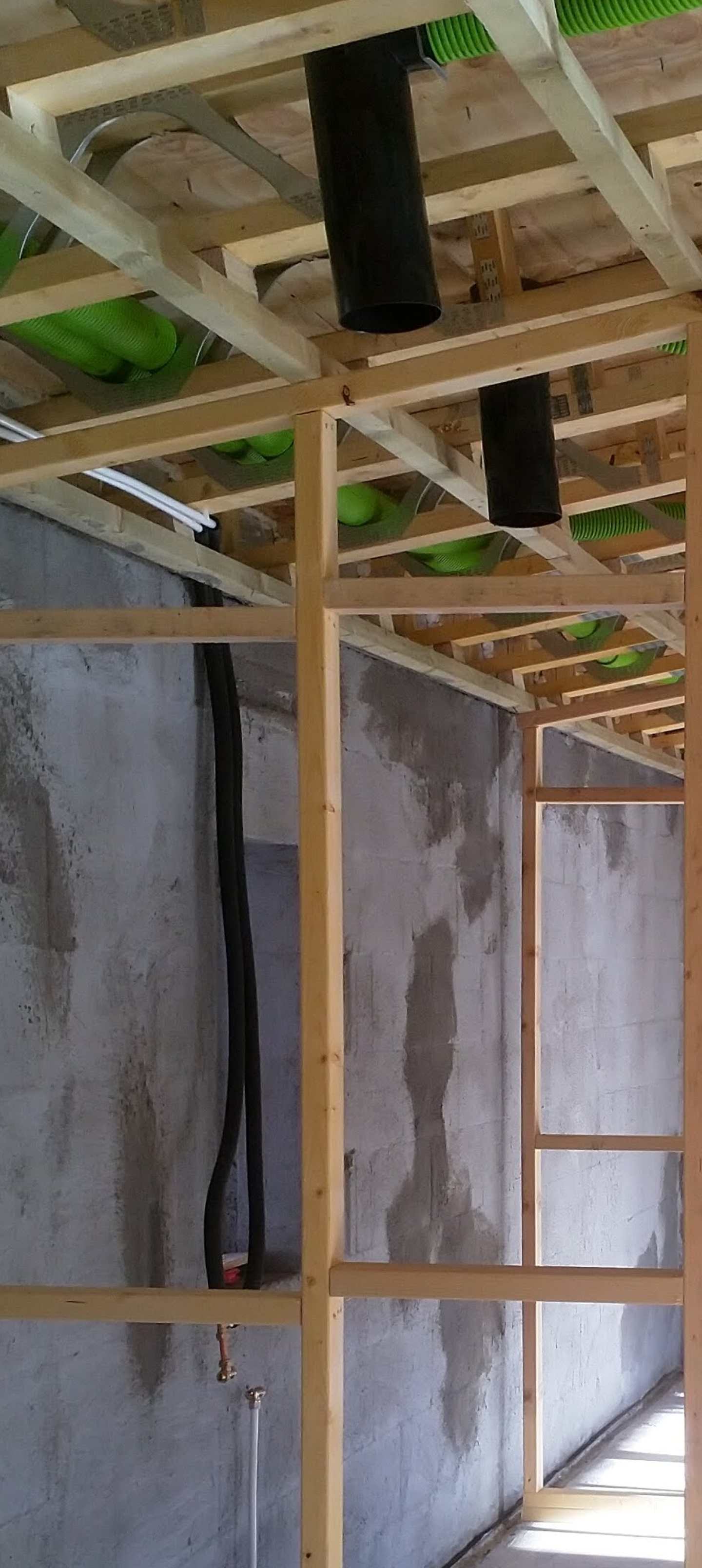

  3. I used a mix of manufacturers to get what I wanted (all 90mm). If an adapter is available or doesn't suit nm it another manufacturer Zehnder etc. Ubbink 90mm duct to Zehnder adaptor

  10. An English video by same person, but doesn't mention anything other than humidity activated? You do need to watch the mm² area, no use putting a small vent in each room, follow building regs for sizing. In Scotland they are pretty huge.

  15. I have also found these through wall inlets look a bit nicer. https://store.beamcentralsystems.com/collections/mechanical-ventilation/products/dcv-intake-air-valves
  16. If you don't need to airtest I wouldn't, you end up boxing your self into a corner. Especially if you live in Scotland? I would progress the way you are planning. Tried a couple of dMEV fans in our summer house - Greenwood were head and shoulders better than other fans I tried. And cheap enough on eBay. Remember you need to have all internal door under cut at the bottom for dMEV to work correctly. I would add a co2 sensor to main bedroom as well so you can fine tune your system.
