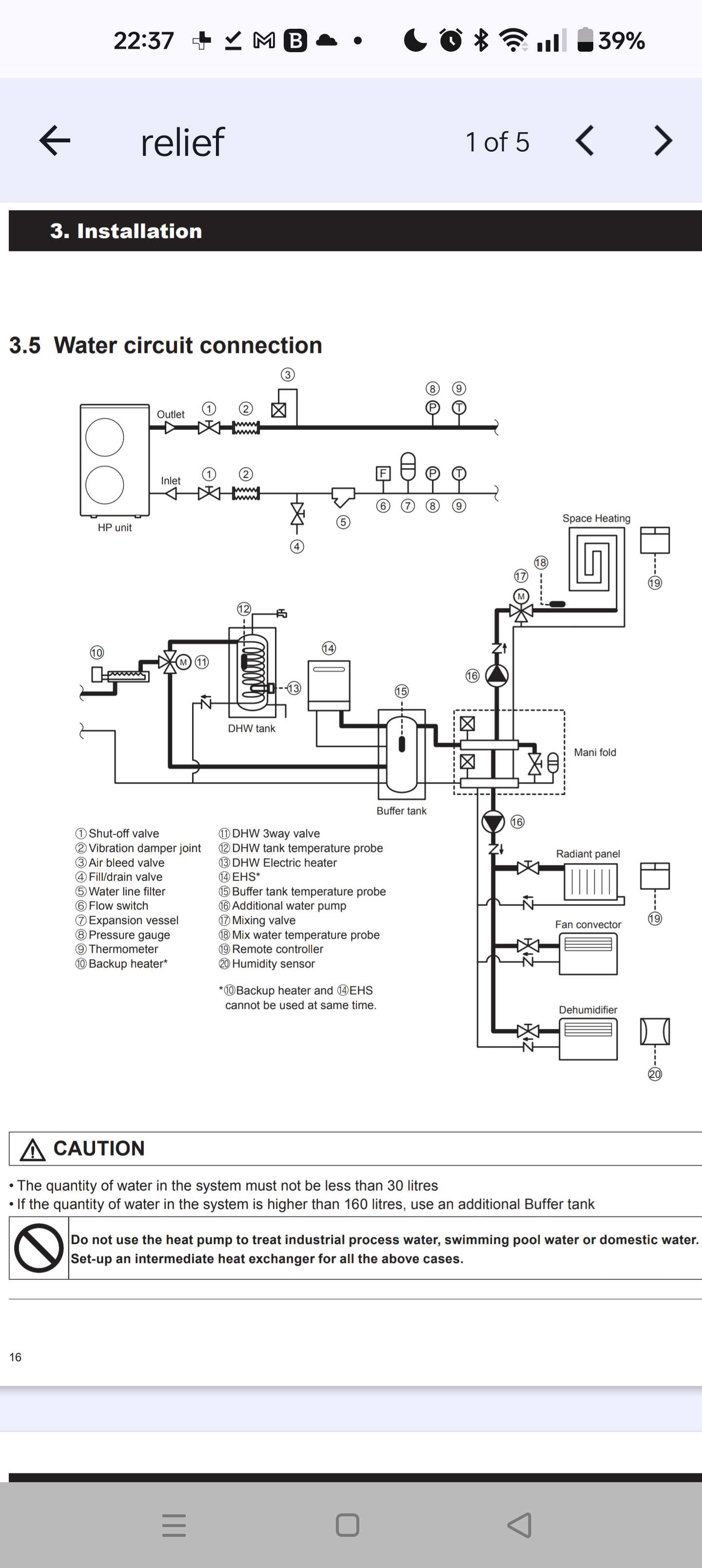

You don't need a buffer with UFH, especially so on a single zone. UFH (cooling mode) will not have any condensation issues, as long as you keep flow temp sensible. Sorry that price is bonkers. Priced up the materials for mine the other day (192m2 worth) well less than £1k, took me on my own two days to install. You need 16mm Per-Al-Pert pipe, pipe clips and a manifold for each floor, you should be able to drive the whole lot from you heat pump, circulation pump. If you don't want to go to bother of balancing or paying someone to do it, install Salus Auto balancing actuators and connect so they are all powered all the time. Once you get well insulated and especially with UFH 22 deg starts to get uncomfortably hot - that's anywhere in the house. Fan coils alter output by varying the fan speed, they have a fixed throughput of water, so keeps the heat source happy. So not comparable with a normal UFH where the circuit is either on or off. We started with a thermostat in every room, it just made the system so expensive to run. At the time we were on a boiler and its gas consumption was double what it should have been due to short cycling. Slowely removing the thermostats go us to calculated gas consumption. In the end we had one thermostat. Have single wireless thermostat, so you can move once you move in to best location. Do not accept a thermostat that does not have a 0.1 deg hysteresis option. Computherm Q20RF are nice and do cooling and heating and drive multiple receivers if needed Your certainly being taken for ride on pricing.
