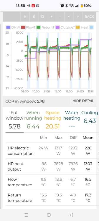

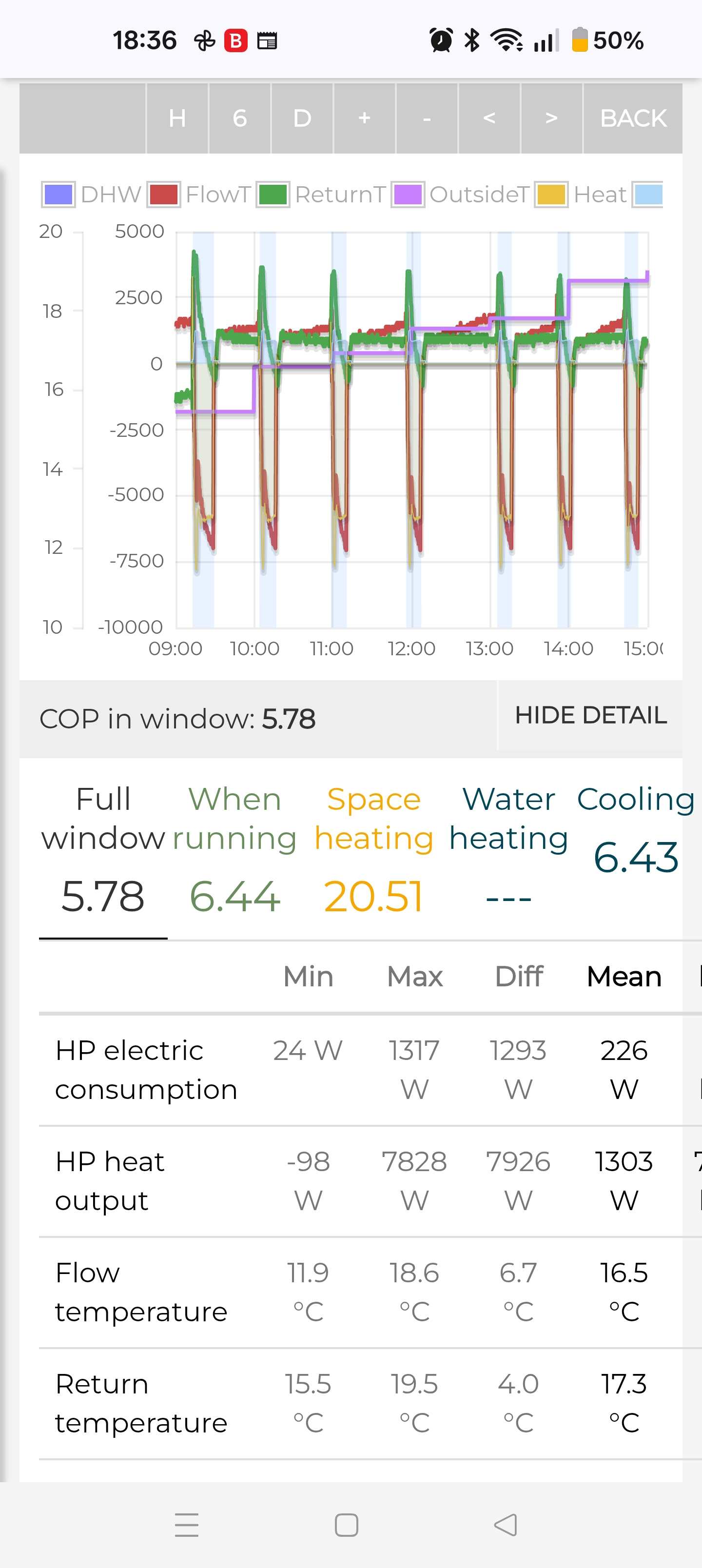

Maxa running cooling. Here is a shot of ours. With the cycling I sent the target down to 12.5. it made a big difference. Yes manifold got a little damp at the end of the cycle, but only for a few mins. Start from your 15 and lower it down a little at a time. Don't be surprised if the installer has little or no experience with UFH cooling. What size heat pump do you have?
