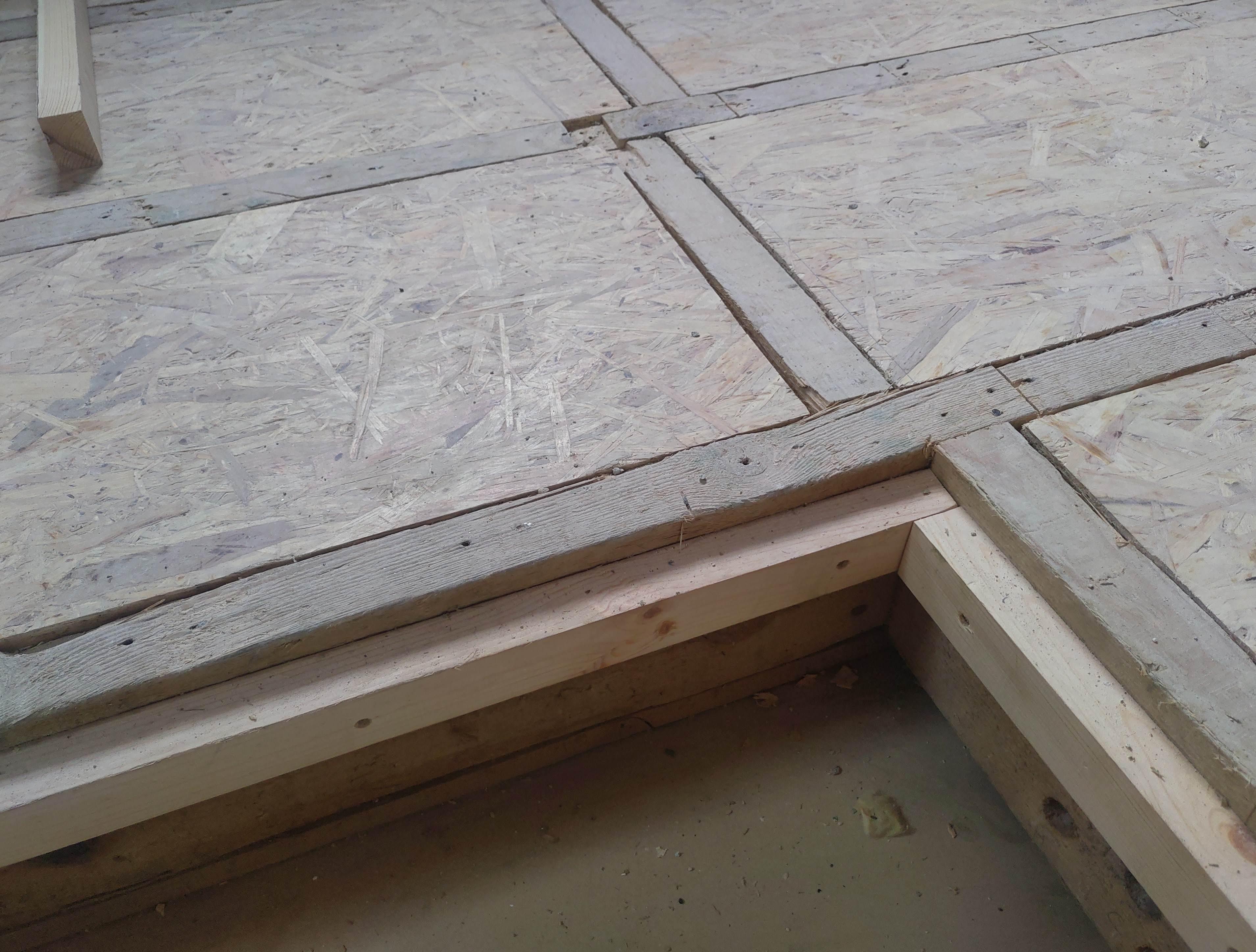

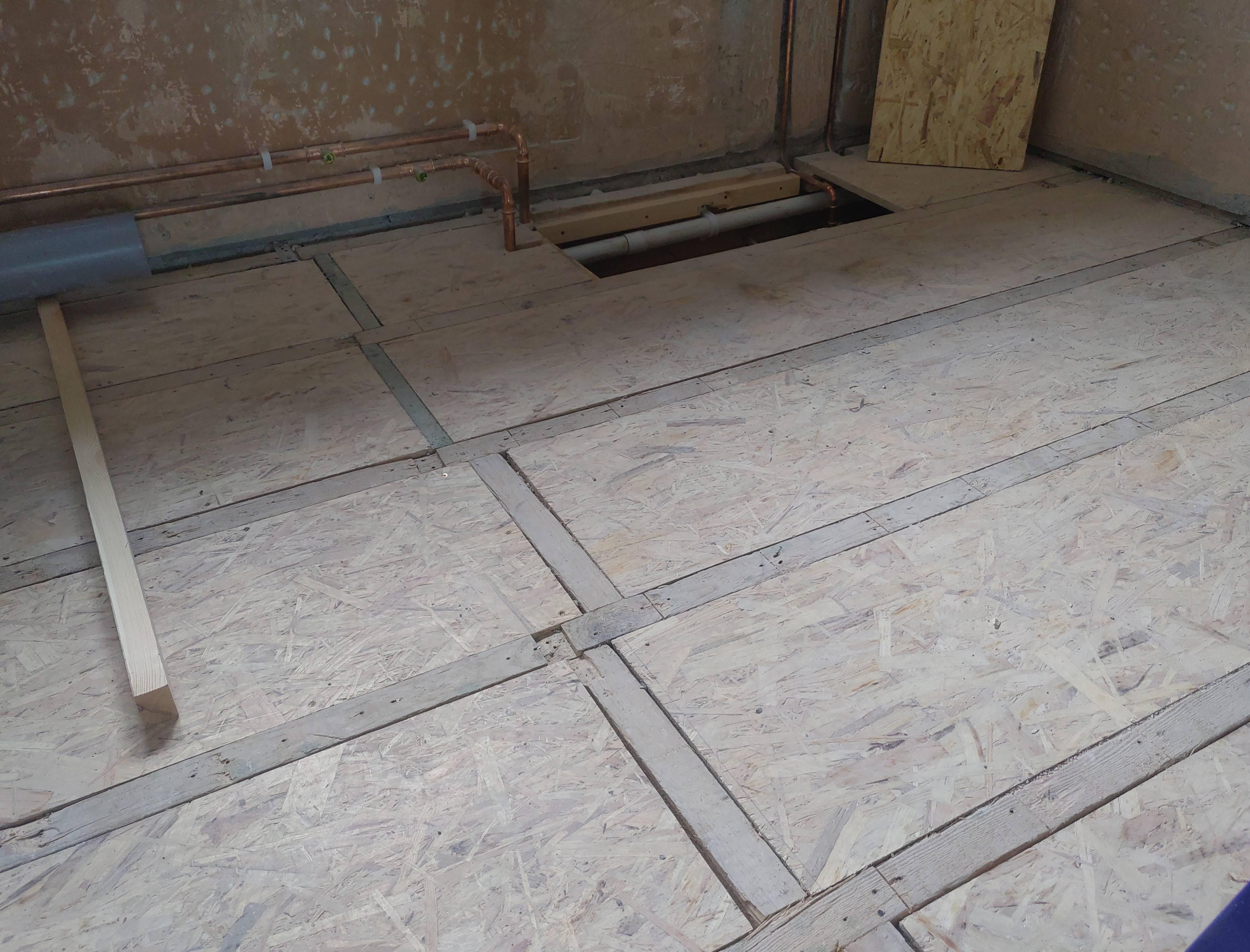

Been doing a lot of reading - and it seems like its entirely acceptable to go with the following sandwich: wooden substrate (see below) Ardex AF200 matting bonding adhesive Dural CI FH (decoupling membrane = Ditra Heat), with embedded UFH loose cables eg from warmstar) tile adhesive 9mm ceramic tiles 'wooden substrate' 1970s two storey bathroom extension on an old Victorian house. 7" x 2" joists at 16" (400mm) centres. The 20mm pine floorboards were were taken up. 20mm OSB sections were cut to go between the joists, being supported on battens, to give a solid, fairly level floor. During the ordering of the above components, my tiling material supplier said "we cannot recommend using our products on an OSB substrate, as you have described". I have been reading a lot of posts on this topic from long time posters such as @nod, @Nickfromwales, @PeterW and it was their experience and suggestions which convinced me that the sandwich ingredients listed above would give me a warm, solid, trouble free and tasty bathroom floor. So this Is where I am: do I need to insert another layer in my sandwich? and if so layer of what? 6mm tile backer board? ply? Or can I assume that the combination or Ardex and Durabase will be sufficient to cover any depressions in my wooden substrate (or whatever its called) ?
