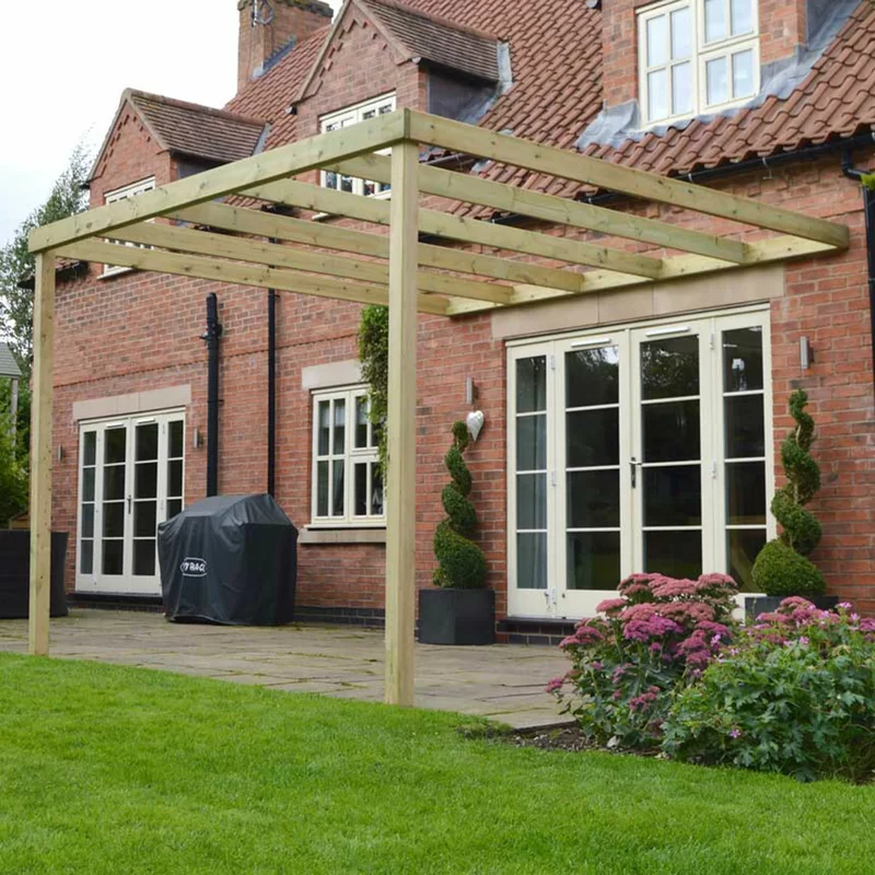

Down Pipes can you hide them
Haylingbilly replied to GrantMcscott's topic in Rainwater, Guttering & SuDS
You could have some sort of pergola type or lean too type structure if front of the patio doors (or a glass roof or even tiled roof structure - I was thinking of something below might be a really cost effective solution). You could then run the drainpipes down to a gutter which runs along the top of where it joins the wall. The downpipes at the end of the building could be at the sides. Hopefully this makes sense It wouldn't eliminate the downpipes but would certainly make them less dominant -

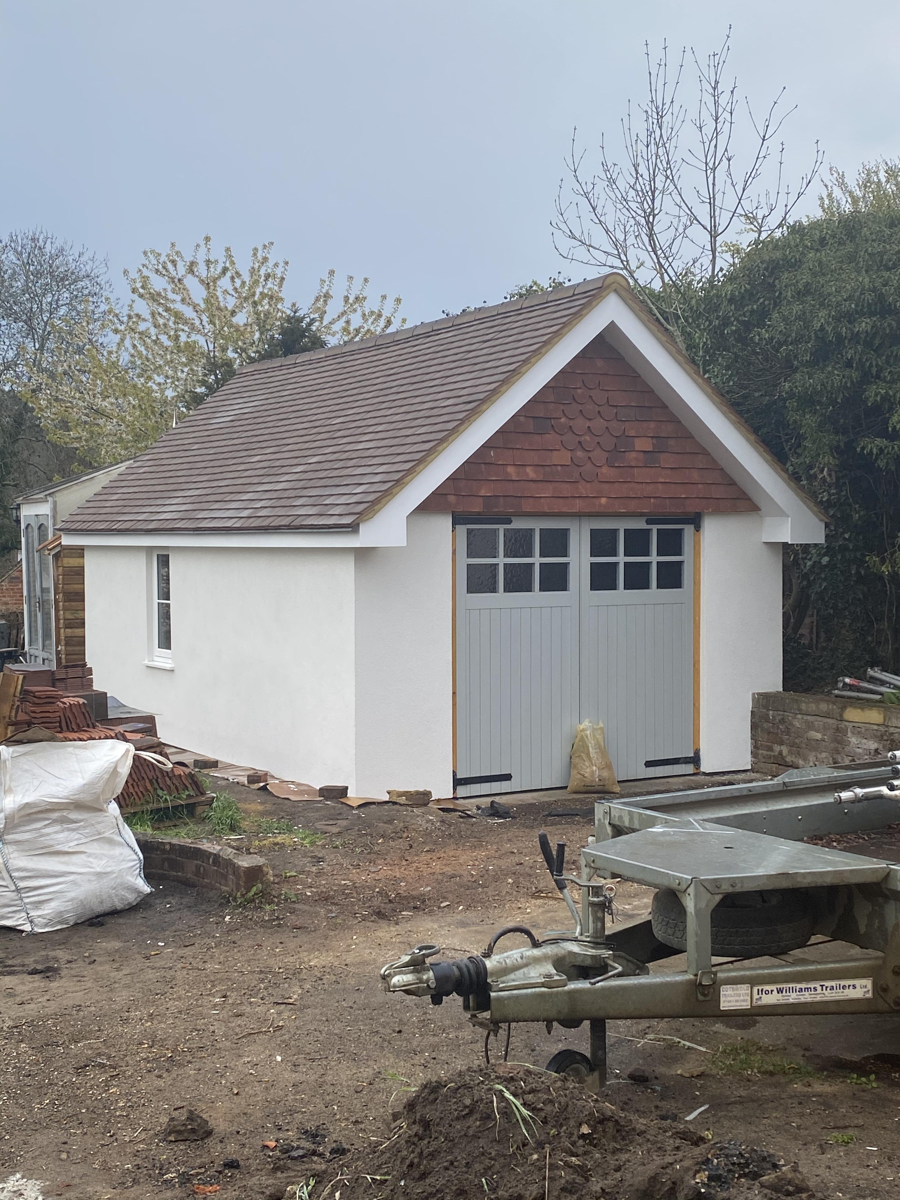

I have been agonising over timber vs uPVC flush casement windows for a while now. Just took an advance delivery of one for my garage which I am building ahead of my house. It is a wood grain effect white window and I love it - can't tell the difference from a wooden window and 1/2 the price! I am not far from you in Farnham if you want to come and have a look! Sorry the photo is a bit distant
