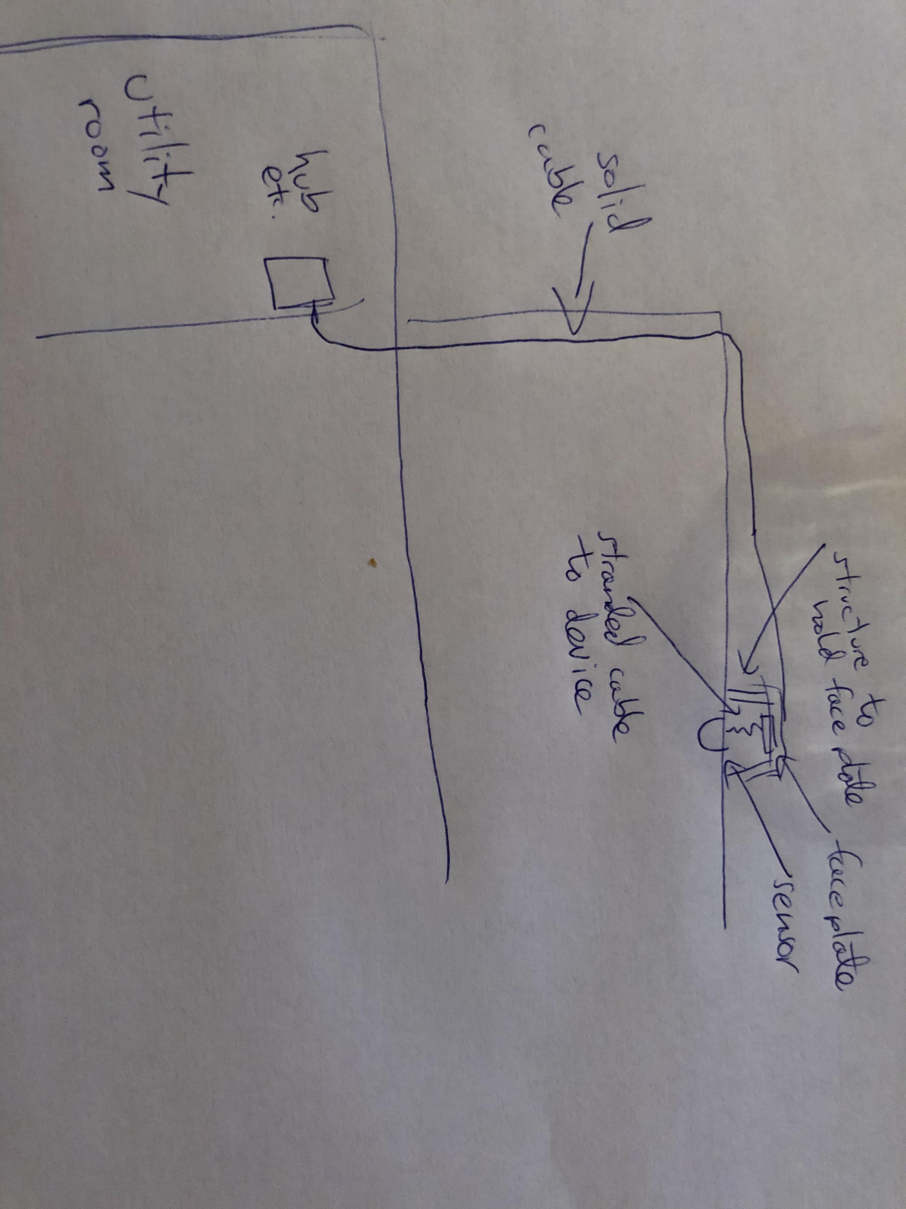

  13. So ! After some ? - purely to lubricate the thought process . I could do this - seems like a lot of fuss to make a ‘stand’ just to hold a solid cable connector - which can be accessed through the ceiling hole in the event of an issue .
  14. Ok ! I guess my real issue is ... I run a solid cable to say a sensor in a ceiling . Then keystone to a stranded patch to device . But that means really the solid termination point should really be a faceplate - so fixed and unmovable . What if at a later date there’s an issue at that point ? . No loft access . Tiny hole for device in ceiling so can’t access solid cable faceplate . I could do solid just to Wall faceplates and stranded to sensors . But in reality there won’t be any wall accessible faceplates !

  16. Hmmmm, https://www.ebay.co.uk/itm/264335179750?ViewItem=&item=264335179750 But isn't this all fiddly do???. End my solid cable (hurray) then stranded to device???. I can see me getting annoyed!! £5 a pop with presumably 1 at the other end. So each run will be costing £10 per device.......

  18. Previously I used my special fantastic crimper with thru rj45. So I can see the wiring before I crimped. I liked this a lot!!! It's all very confusing because though you could argue solid is better for transmission speed and distance it's also less flexible and therefore more prone to damage . As I'm wiring the 'backbone' effectively for best of both worlds surely I go cat5/6/7 stranded ????? Internet offers very little clear "use this one" . Yeah I'm confused now!. So... solid as 'backbone' then drop to stranded to connect to device or bridge - whatever? Never 'fitted' a solid rj45 - don't want it to be a pain! - like my through crimper!! - fiddly diddly stuff going to drive me mad! - and I have a lot of cabling/crimping etc. to do...

  21. Right! I need to start putting in my cat6 cabling everywhere. I really want to crimp everything - so therefore I think it must be stranded cable as opposed to solid. So I'm not intending to use this just for patch cables but for the entire house. Anyone see an issues with this? (assuming I purchase a decent brand - presumably shielded ; links welcome ) Stranded just makes things much easier - as most cable runs will have a poe device hanging off the end rather than a wall plate. Seems pointless to run solid cat6 to a plate (say in a loft) then make and run a cat6 stranded to the device. I just want to go from router/bridge direct to device.
