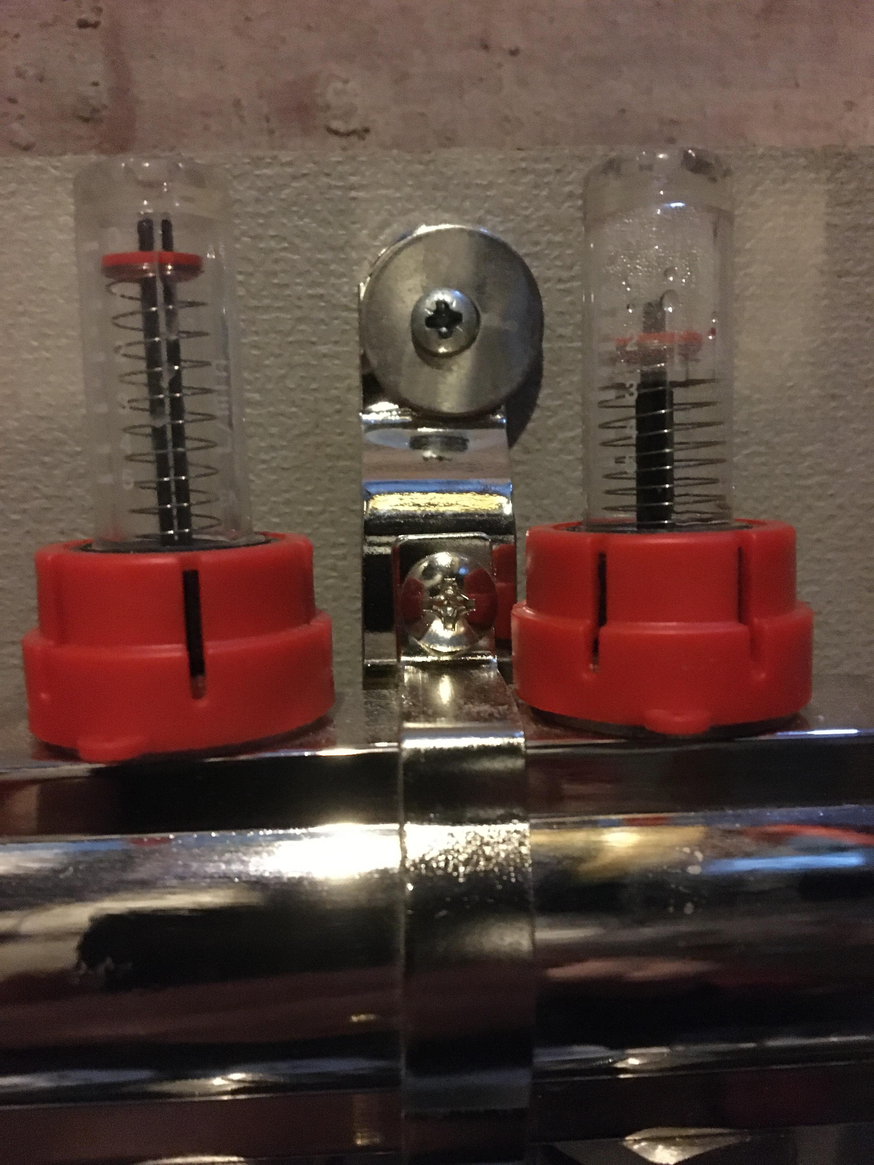

I’ve purges all the loops and they are all fine. I then applied pressure to the hot manifold and got water out of all but two of the points. Having removed the red collar from round the flow indicator I found that if you unscrewed the plastic flow indicator about 1/2 a term the port opened and water began to flow..

I’ve recently commissioned my UFH and two of the flow indicators aren’t working. In the photo below you can see the left hand indicator has no water in it and the flow and return pipework is cold, even with the valve fully open. Has anyone got a cross sectional diagram of these valves and flow indicators, as I need to strip them and get them working.
