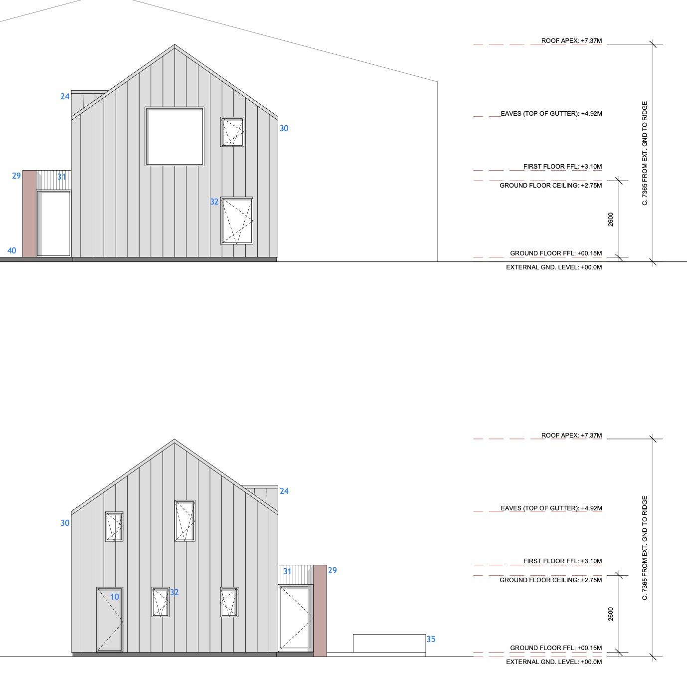

Thanks for the advice I had did quite a lot of research about 2 or 3 years ago on ICF but kept changing my mind on the system to use for the structure. The architect recommends the twin stub timber frame with blown insulation. I have always liked ICF, with our damp Scottish weather and exposed site concrete seems more long term than OSB and cellulose. The downside is the concrete enviromental cost that makes me feel guilty considering it. The current plan for the structure is Insulated slab ICF Walls Twin stud engineered timber roof with wood or glass wool insulation between the studs and outer sheets of wood fibre insulation. Glulam ridge beam supported on ICF walls on outside and timber internal wall supports inside the house. Have looked at Polarwall in the past. @Conor what ICF system are you planning on using @Vijay. Are you building an ICF house? Are you using Polarwall? -

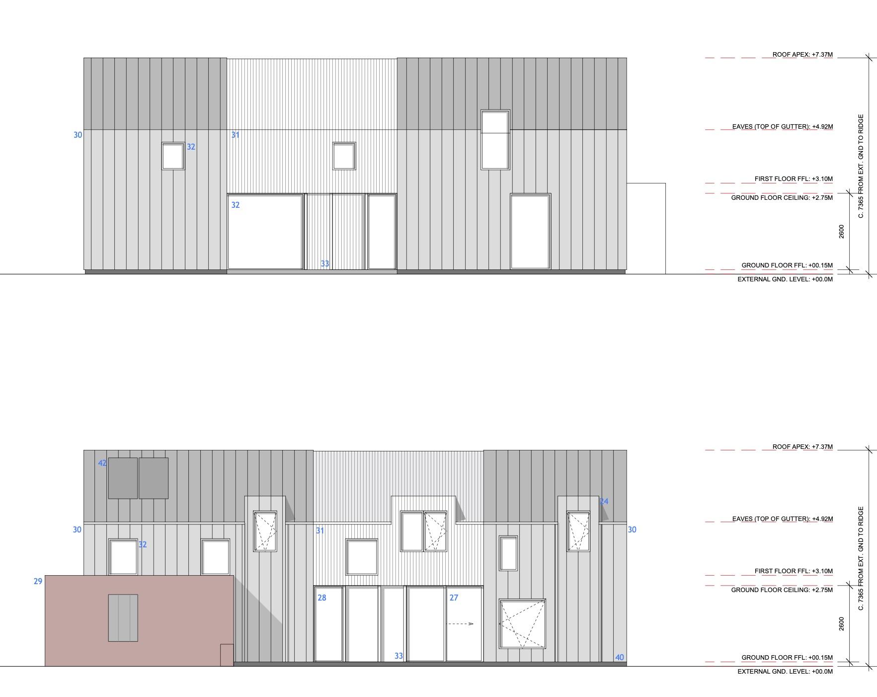

gavztheouch posted a topic in Insulated Concrete Formwork (ICF)
Hi there I am currently trying to decide on a building method for the house shown below. I have always wanted to build a house from ICF but this type of house with multiple windows at different widths and heights may make it too tricky for ICF. I have decide to remove the two outer dormer windows to help simplify the design regardless of construction method. In terms of ICf do you think this house is impossible to build this way. One idea I did have to get the window positions accurate without changing the design is to construct the window openings close to were they need to be using the standard ICF Block height and the fill the remaining void with timber or similar? -
