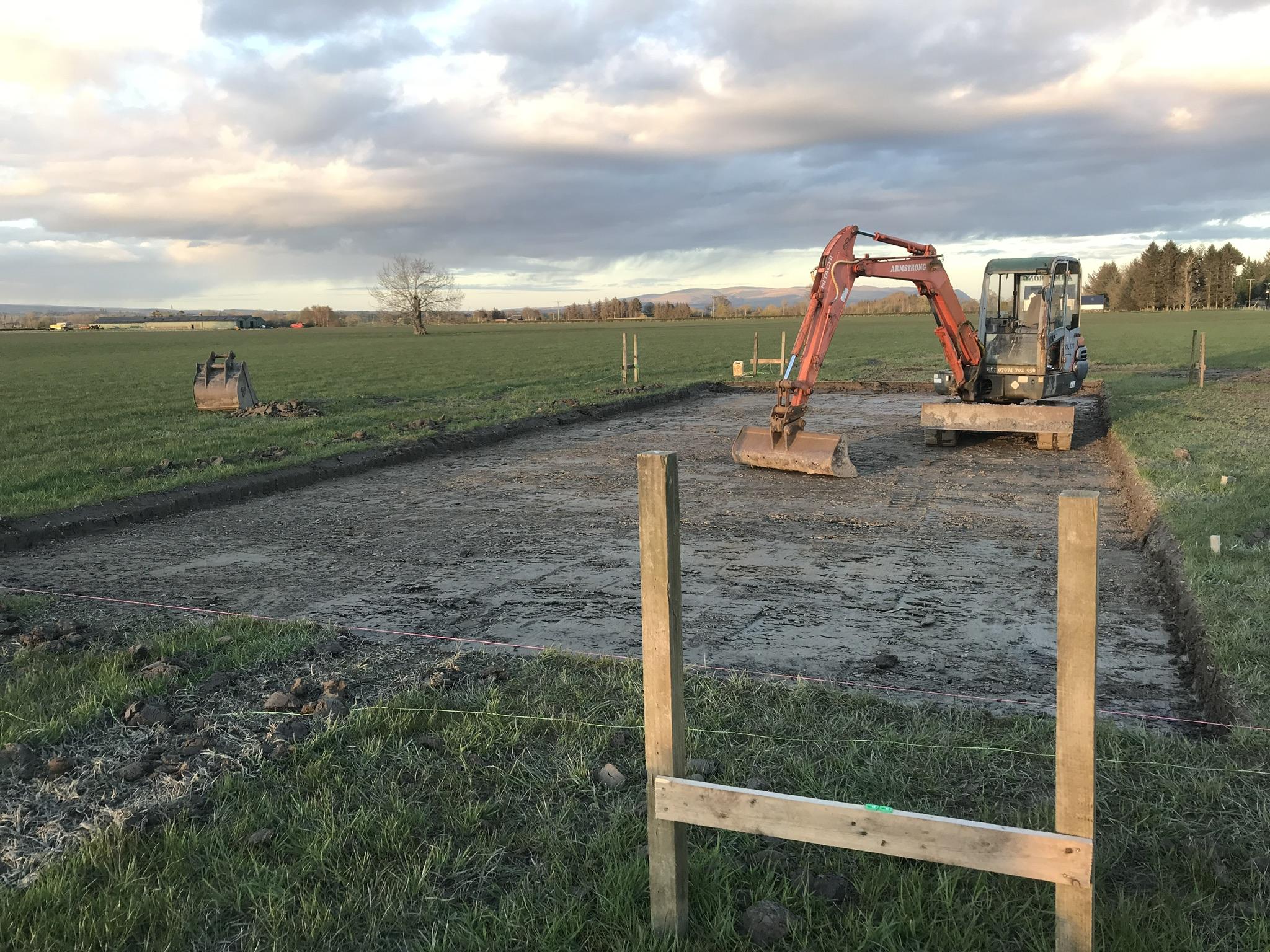

  12. stripped the soil off today. We are only going down 200mm to try and stay in the stiff clay near the surface.

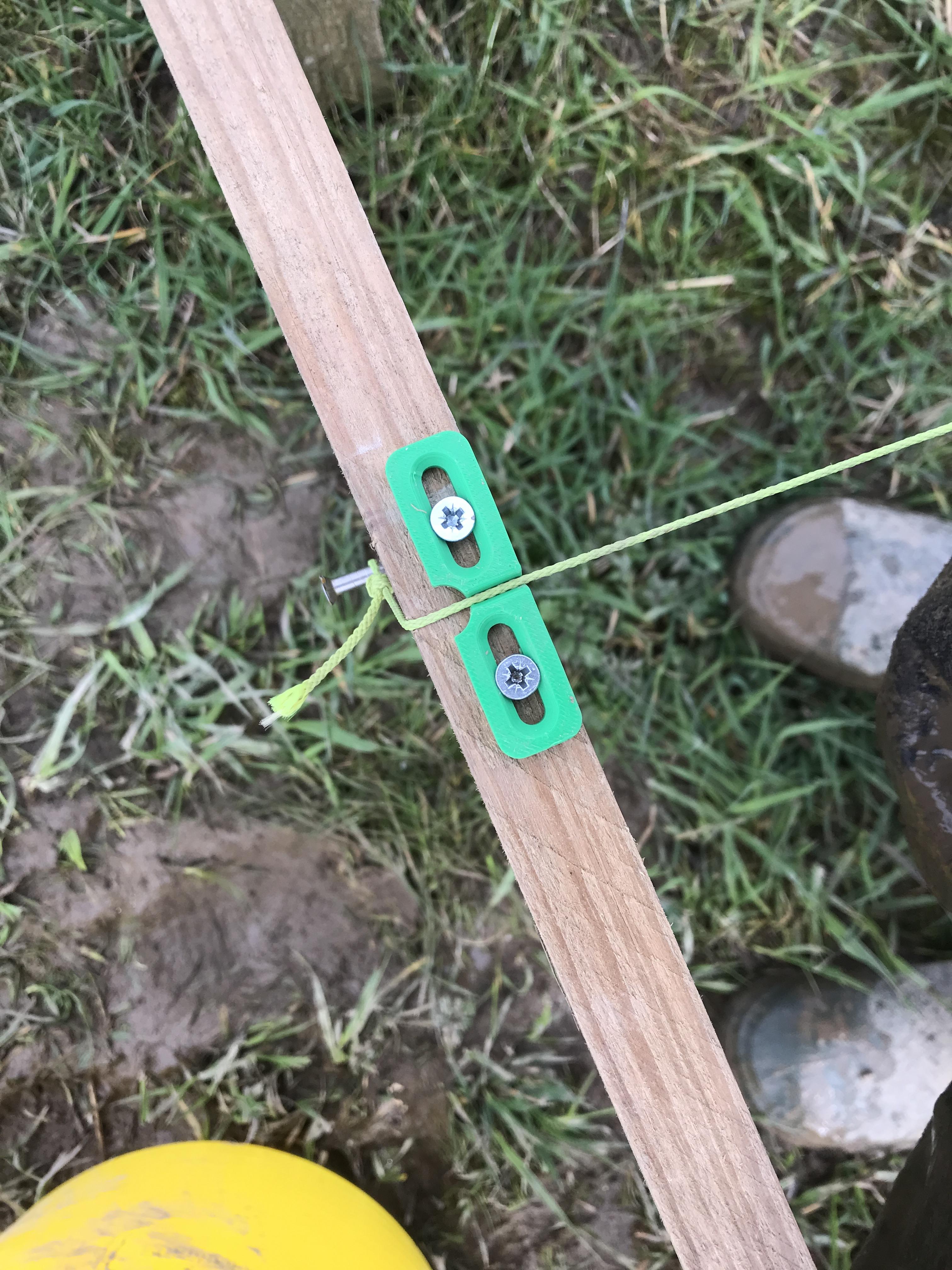

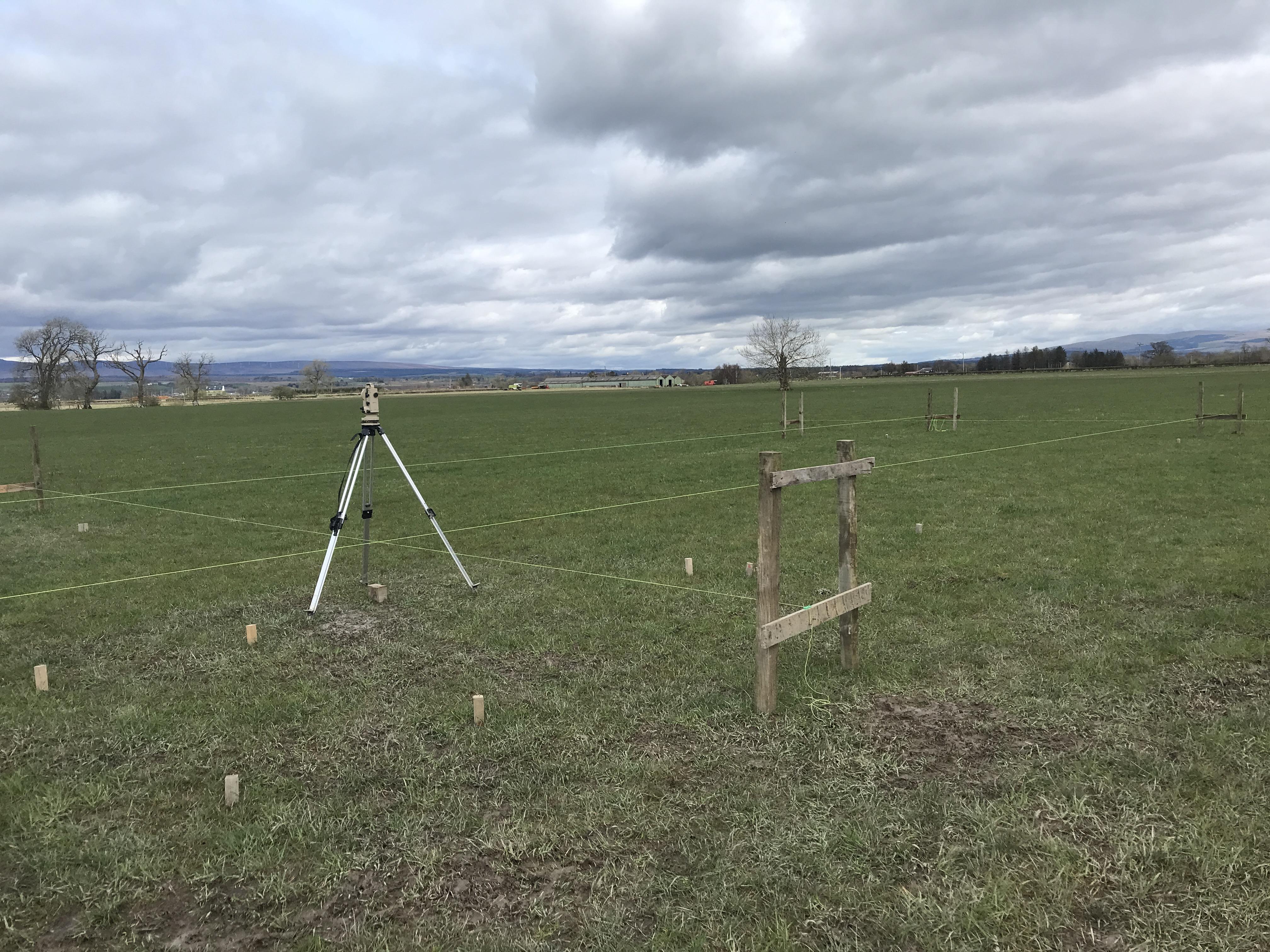

  16. I used my theodolite’s optical plumb to sight over my corner markers and help get my strings in position. 3D printed some adjustable string holders to move the strings into position easily. Now I’ve transferred the points to strings it’s time to strip the top soil and add the type 3.
