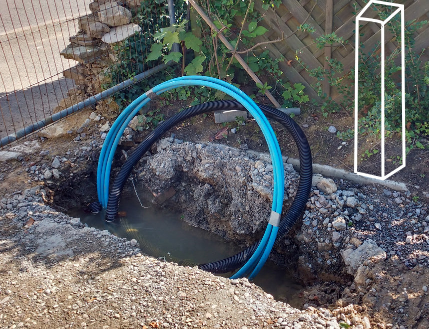

This was an occasional but recurring topic on eBuild, including a topic that Jan and I initiated. Our water supplier (Anglian Water) has a strict policy to the effect that: the pipe into the house must be a min of 75cm deep and their surveyor must review the house installation for compliance before scheduling any connection works on the public highway. (There is a waiver for approved installers but in practice these guys only deal with large installations.) The standard way to get around this is to do this installation in 2 phases: Install a standpipe and request connection to the standpipe. This triggers digging up the road and connection to your property including the installation of a meter, stopcock and double check valve at or near the boundary. This has a 6++ weeks lead time. When the house and plumbing is "finished", then apply for approval to connect up the final supply to the house. This has a 1-2 week lead time in our area. So you can parallel up the external works and 1st / 2nd fit with the roadworks for the costs of a standpipe and the extra site visit, which is often worth doing even if you are never going to use the standpipe in anger. What is crazy is that our water table near the boundary is about 150mm below the street level so IMO there is no way that A.W. will put their meter and stop cock at 750mm because it will be permanently covered in ½m water. I did suggest just making the standpipe available and fitting it at the same time as the digging, but no: there is an absolute rule: the Anglian survey engineer has to review the installed standpipe and standpipe tail for compliance with their guidelines before any groundwords can be scheduled.) See attached photo where I've marked the position of the standpipe; there wil be a second coil of MDPE from the standpipe. The black pipe is for the electricity supply. You can buy made up standpipes such as this one: PL34 Standpipe which costs £235+VAT and is as per attached image, but I will buy the bits and make up my own for about £30. One wrinkle is that A.W. insist that the bibcock must not have a hose connector -- so I can either spend ~£30 for one without a hose connector of use a £7.50 one and angle-grind off the hose connector. Hey-ho!!
