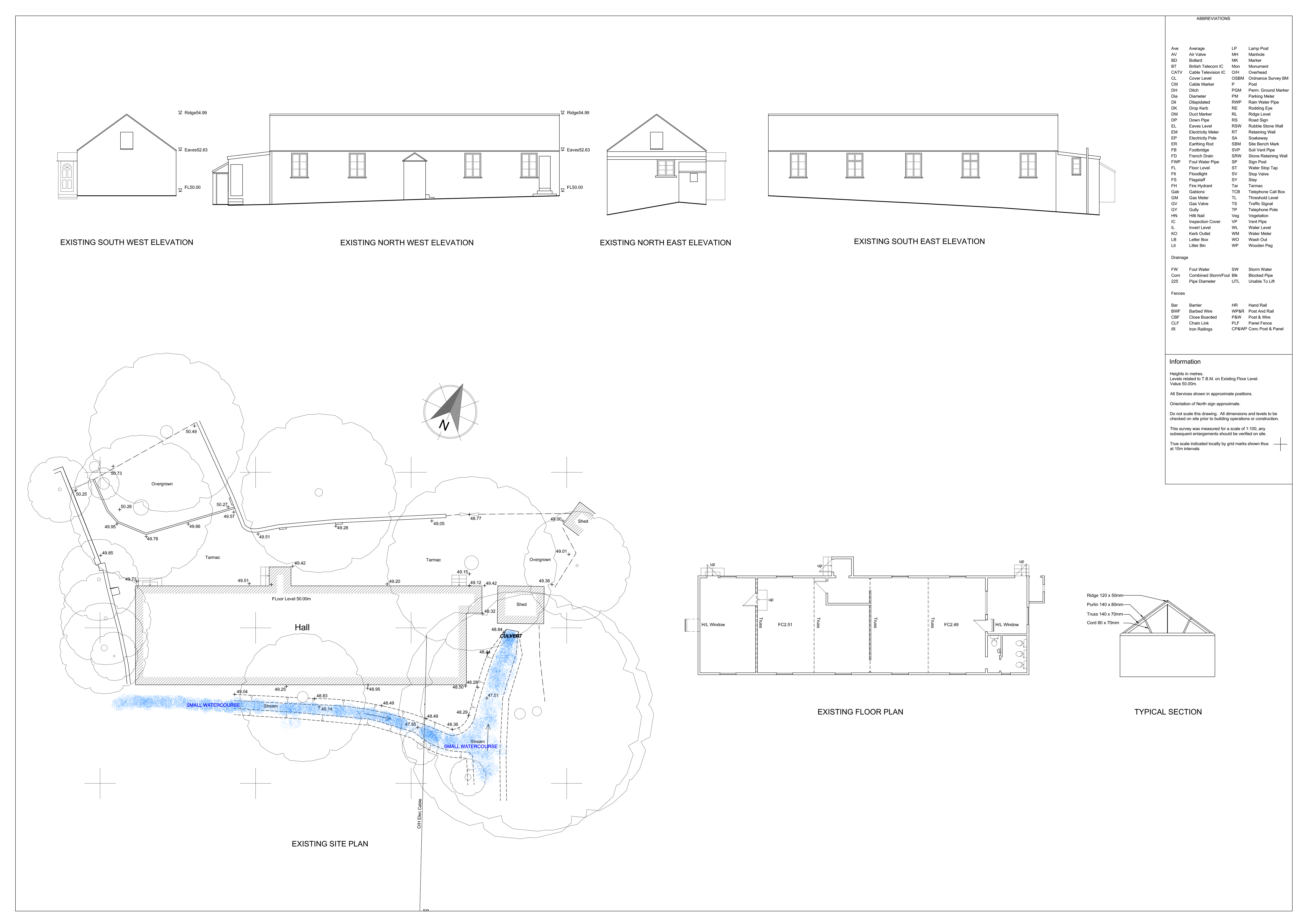

it s moving water, even though very small ( it s a little stream , around 0.5meters wide, 0.3m deep max.) . Good Idea , I will look into this

That would be a great option, it is a bit similar then @JSHarrisdone it with his Wall in order to get the plot level. I think the small problem I have got is space- there is around 0.5-1 meter between the building and the Watercourse and there is a drop of around 0.8-1.2 meters . Would be obviously better to build a bit further away, but thats also not possible. I do however follow up on some advice and get Guys from MSS `mini`soil surveys in to give me advice with how to proceed . He has been recommended more then once on here .

I know this has been discussed at some point, but it was on a very tiny slope and I have found nothing about anyone trying near a Watercourse or similar. So my question is: Is it possible under any circumstances to build Passive Slab on a slope of ca. 1.5 meters next to a Watercourse. My guess is "No" But i still think it s worth a try, as this would be a good slab solution. Here is some measurements (see Pic below) . House will be on a slope of 1.5 meters over 21 meters distance. But the bigger problem probably is the Watercourse directly next to it - oh, and I forgot- a few trees as well. I will ask Structural Engineer the same question, but her solution so far is not really a cheap one (Pile and Beam with slab , first quote coming is : 47000£+VAT ? ?) Thinking by now that it might be best to leave concrete out and just put suspended Timber Floor on Screwpiles. Anyone in here got experience with this? Even Though Helical Piles are not cheap, might still end up much cheaper. Has anyboday ever tried installing helical Piles themselves ? I just had a quote for the Piles themselves - just material - 1600mm length excl. shipping for 15USD each (100/pallet) , seems cheap enough to me ?
