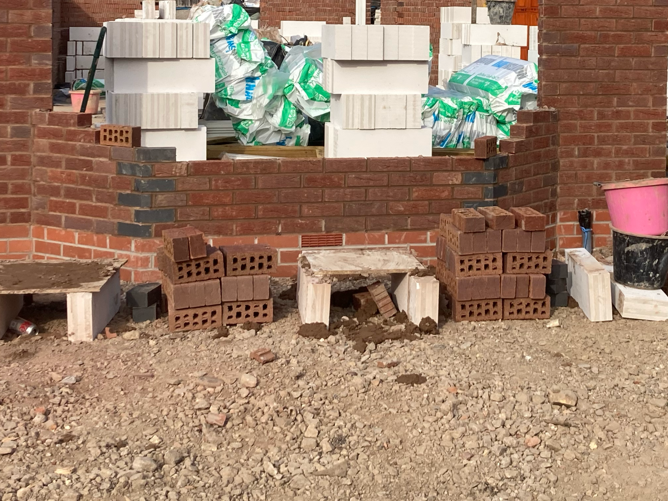

  3. I used blue squints AN 1.2 on the front of my bays. Contrasting brick but the match the soldiers over the windows. I took one of my bays down after building it because I wasn’t happy with it. The designer hadn’t worked the return to the bay in brick dims so it was a pain in the arse to get right.

  5. Splayed bays are very difficult to get right without the correct materials. I have ripped one of my own down recently because I wasn’t happy with the end result. Having said that the one I took down was better than yours. Have you checked that the dimensions and angles on the splays are equal ? It doesn’t look like it from the photos.

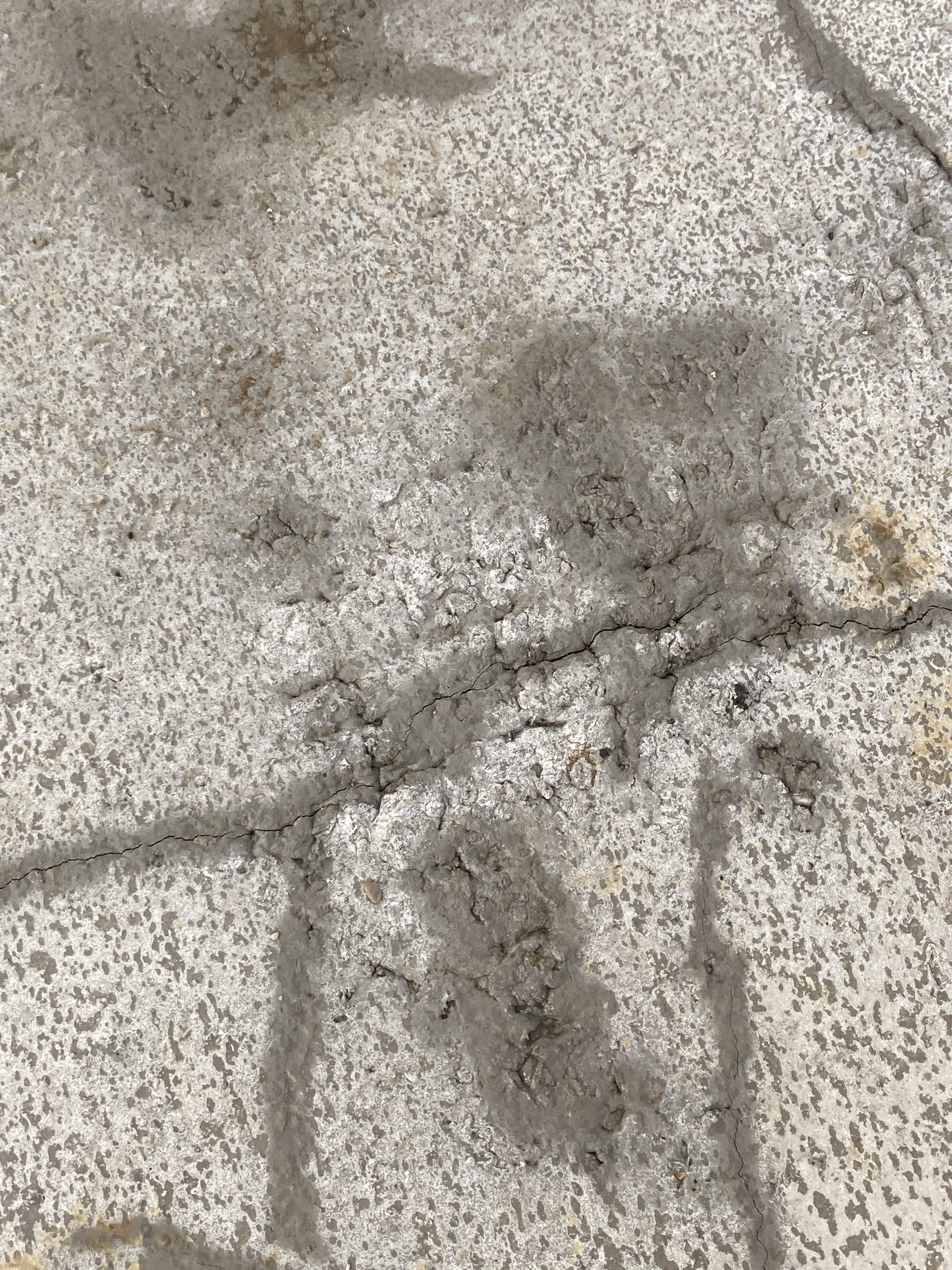

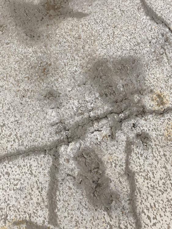

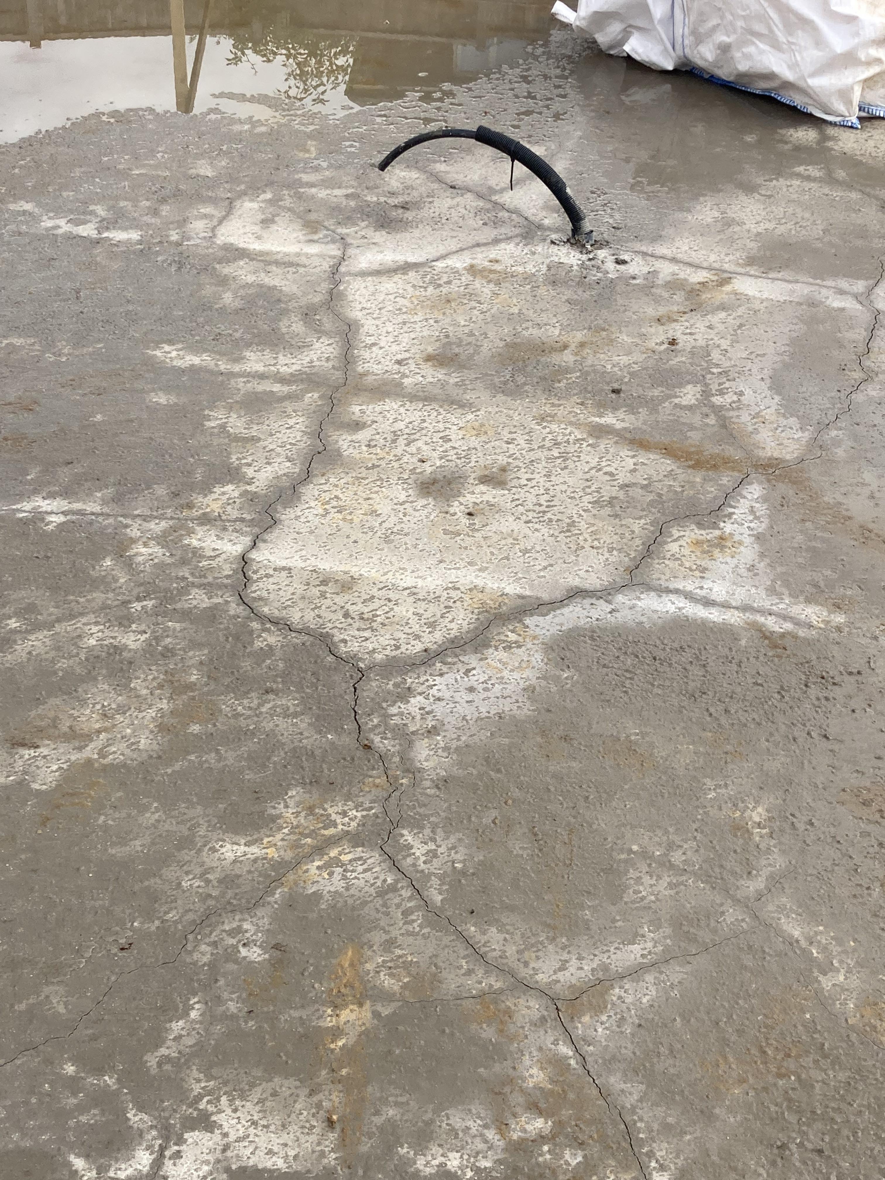

  13. The contractor admitted that they added water. I’m still waiting for the delivery notes which ‘they say’ are with the concrete supplier that they engaged. They asked what I’d like as an outcome from this. Well 🙄🙄 supply and fit ditra to the whole ground floor and some sort of finish to my garage maybe ?

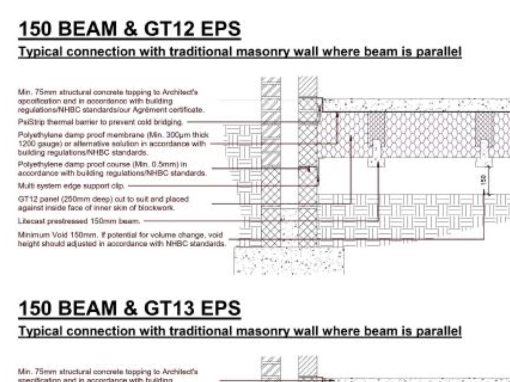

  14. Thanks. Yes I have asked for the delivery receipts and asked them to pop out and take a look. Underneath is a beam and insulated block floor. Litecast GT12
  15. and it still wouldn't work on an insulated beam and block floor
  16. Doesn’t work as a structural topping unfortunately.

  19. I have just excavated 1m below ground level and filled it to 600 mm below ground so 400 mm of concrete and LABC and the warranty inspector were happy with that, then had 375mm to the underside of insulated beam and block then 300 mm of beam and insulated block leaving 75 mm for cemfloor screed over the top to DPC. Like Dave says work from the top down.

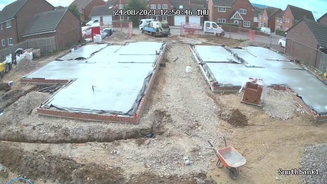

  22. Both plots are ready for the oversite pour now. It was planned for last Thursday but due to the heavy rain that was forecast I postponed it. There will be a small cost involved but better safe than sorry. It’s not going to cause any delays as I had planned to get all the foul drainage in next week (I’m still waiting for my sky plastics delivery after 4 weeks) and to stone the site up ready for brickwork and scaffold. It’s also a shame the supplier of the hardcore has re discovered the beer glass and has gone awol. I’m on to plan b with a more expensive supplier. This has been a frustration since demolition because the demo contractor was supposed to leave me 100 tonnes of crushed brick as part of the deal. I’m now learning that many people don’t do what they promise. I need to go back to some paid work for a few days ( for a rest mainly) today is my first day off in 5 weeks.
