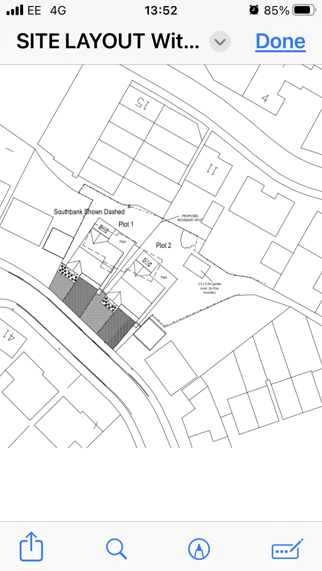

  6. Thats right it's in the middle of a new housing site and set at an awkward and wasteful angle. ( See photo) This is why the site is ideal for two new builds that fit in better and will be pleasing to the neighbours and far more economical to run. I hope I have all the ducks in a line but this is the first build for myself and you guys in here who have already gone through the self build process have more experience in this area than me. I have been in the industry for 40 years as a brickwork contractor but I feel that I have learned more in the last year ( much credit to this site) than the 30 previous years. I am never usually on site after the roof coverings go on.

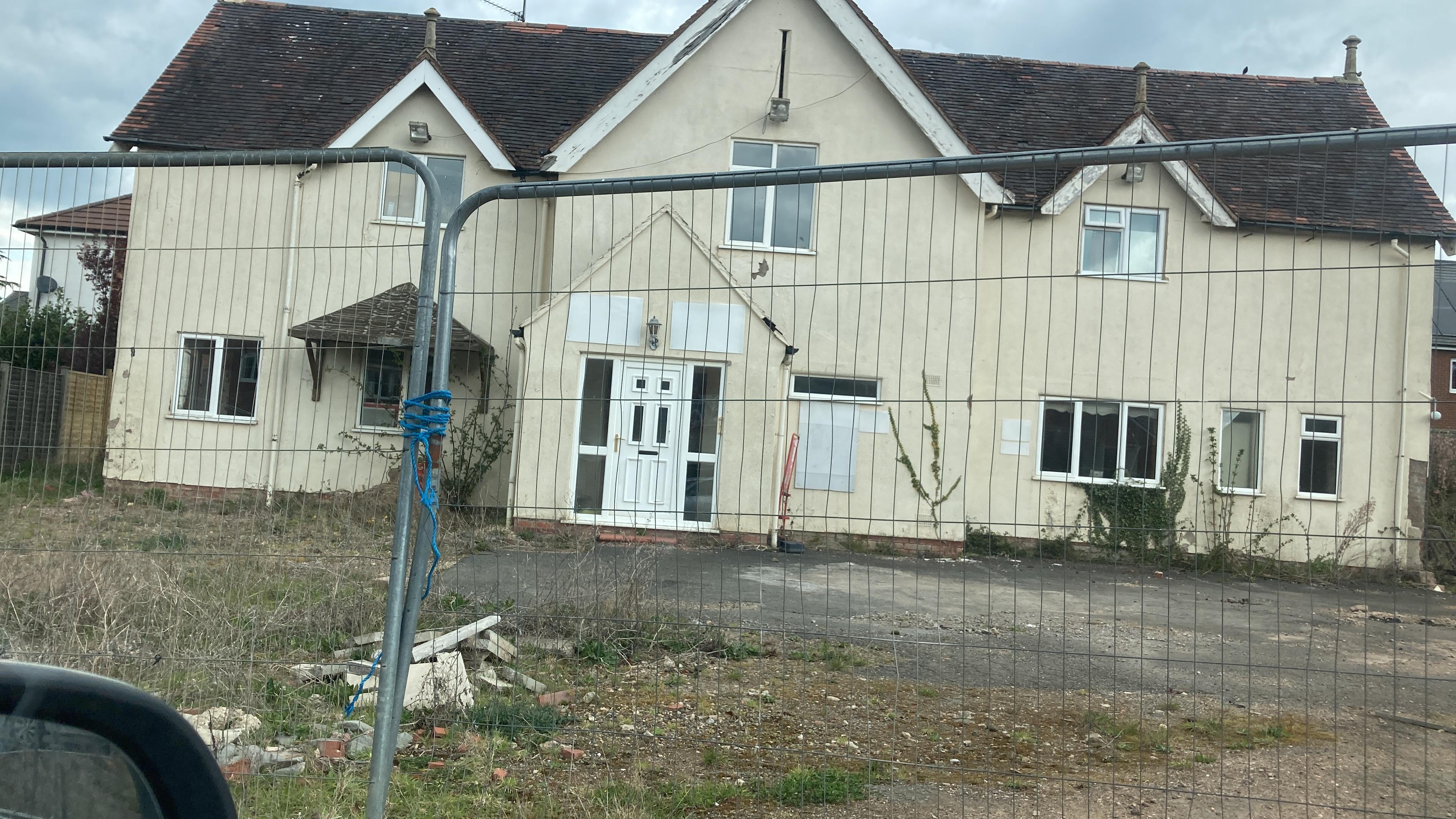

  7. Hi all, I have spent a few days at my site ( 2 virtually identical plots) bird and bat spotting over the last few weeks and it looks like I am clear of creatures so I spoke to my ecologist and have arranged a destructive roof survey for 19/06 and lined up the Demo guys for 21 /06. I am now in that stage of what have I forgotten. It has a been over a year of pain since I first bought the site. Due to :- Ecology survey needed before application for PP Bats discovered in the last 30 minutes of 4 surveys (The only time that I wasn't present for the survey) Application for PP Bat mitigation licence required. Bat pole and multiple temporary bat boxes required as part of the mitigation process Section 106 agreement required for affordable housing (this was an unexpected £13 k surprise) 10 weeks delay caused by the section 106 which led to ... Nesting birds and a further 6 week delay Requirement for an extension of the mitigation licence 4 week delay DNO multiplying their quotes for connection by 3.5 x ( this is ongoing) But now it looks like we will get the go ahead subject to a destructive survey on 19/06 So I need to go ahead with my warranty application a couple of weeks before construction. I'll get this sorted this week coming. Section 80 and Section 81 Demolition applied for and received. Asbestos survey completed. Building regs approval obtained with LABC HSE informed of construction works Service Connections applied for but electric not finalised, Water and openreach are fine Foul & surface water sorted with Severn Trent. ( a most helpful company) All quotes in for the build that I can think of. concrete, floor beams and oversite concrete,UFH will be installed by my buyer of the other plot, bricks and blocks, insulation, joists, scaffold, roof trusses, windows are in progress, garage doors, All brickwork ancillaries are in my container ready Demo guys set up to go Engineer for setting out on stand by Digger driver and machines on standby. To crush on site or remove and re deliver to be confirmed Temporary electric connected from a nice neighbour Site insurances in place Welfare ( porta loo) in place. first aid box and accident book in place. Garden office ( site office 50 % instructed but had to halt in case the demo guys get over excited. I can't help feeling that there is something that I have forgotten. All comments are welcome. Does everyone go through this phase of anxiety before the build ? I can't wait to see the back of this ugly building and get cracking with my new residence.

  11. I don’t know is my simple answer to this. I’m not an electrician. The site is an infill site on a 5 year old housing estate and I believe that all the houses are on 3 phase.
  12. Thanks Dave. So I think I will go back to them and ask for a quote for 30KVA 3 phase per house and I should be covered or should I go in lower ? I didn’t mention (and not sure if it is relevant) but the supply is on the other side of a quiet road about 9 m from my boundary and then each supply would need to go about 15 m to the meter box on the houses. The water will need to cross at roughly the same point. Then I would need to try and get them to co ordinate the works to prevent disruption to the road users. This will no doubt be difficult.
